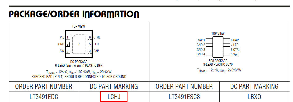

Sounds like you are on the right track. Just to double check that there is not an issue with the keyboard backlight itself dragging the voltage low I would try removing the cable from the connector and then shorting the 2 sense pins together to fool the circuit into thinking a cable is connected. Then measure the DC voltage between the other 2 pins. If it is still 5V then you do have a problem with the LED driver.

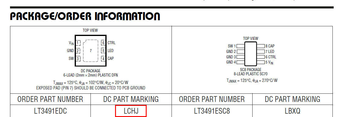

I do not know where the particular device is but the datasheet excerpt I have attached below suggests you are looking for a small package, (most likely the DC package knowing Apple) and the markings on the device would either be LCHJ or LBXQ.

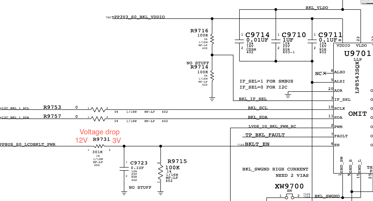

Hi!

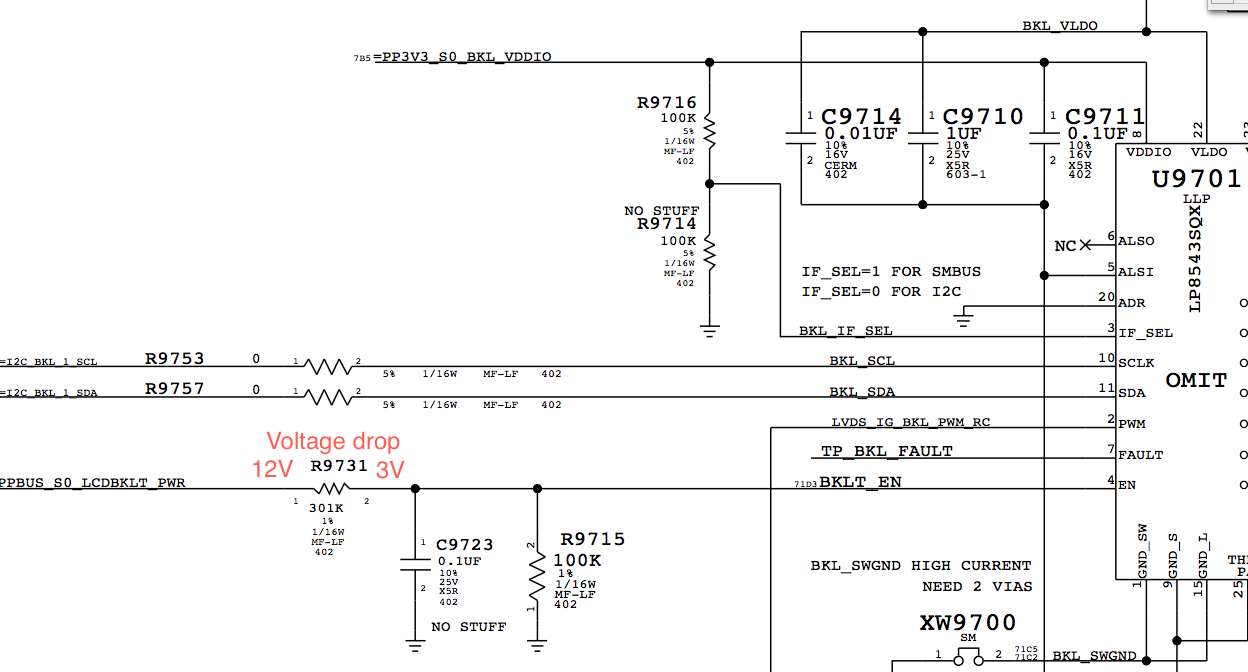

I have a Macbook with no backlight, already replaced the LP8543, the fuse is ok. The backlight only flashes for less the 1 sec when manually shutting down the Macbook. I found a voltage drop at the below marked resistor, the resistor itself is ok but the measured voltage before and after it is not the same. Would really appreciate any help!!
attachment.php
Hi!
That is correct operation. That resistor is part of a divider network 301K / 100K resulting in a drop of the 12V to 3V (the ratio of the resistances) which is the proper level for the enable pin on the WLED driver.
Ok thanks very much for the quick reply and sure this looks like a voltage divider on the circuit diagram, I just measured 12v on both sides on another half working board...So this means the led driver I picked up from a dead board is bad...
If you measured 12V both sides then it suggests that the other board has an open circuit 100K resistor or the ground on the 100K resistor is disconnected. The WLED driver enable pin could pull it lower than 3V (possibly) but it could not cause it to stay at 12V.

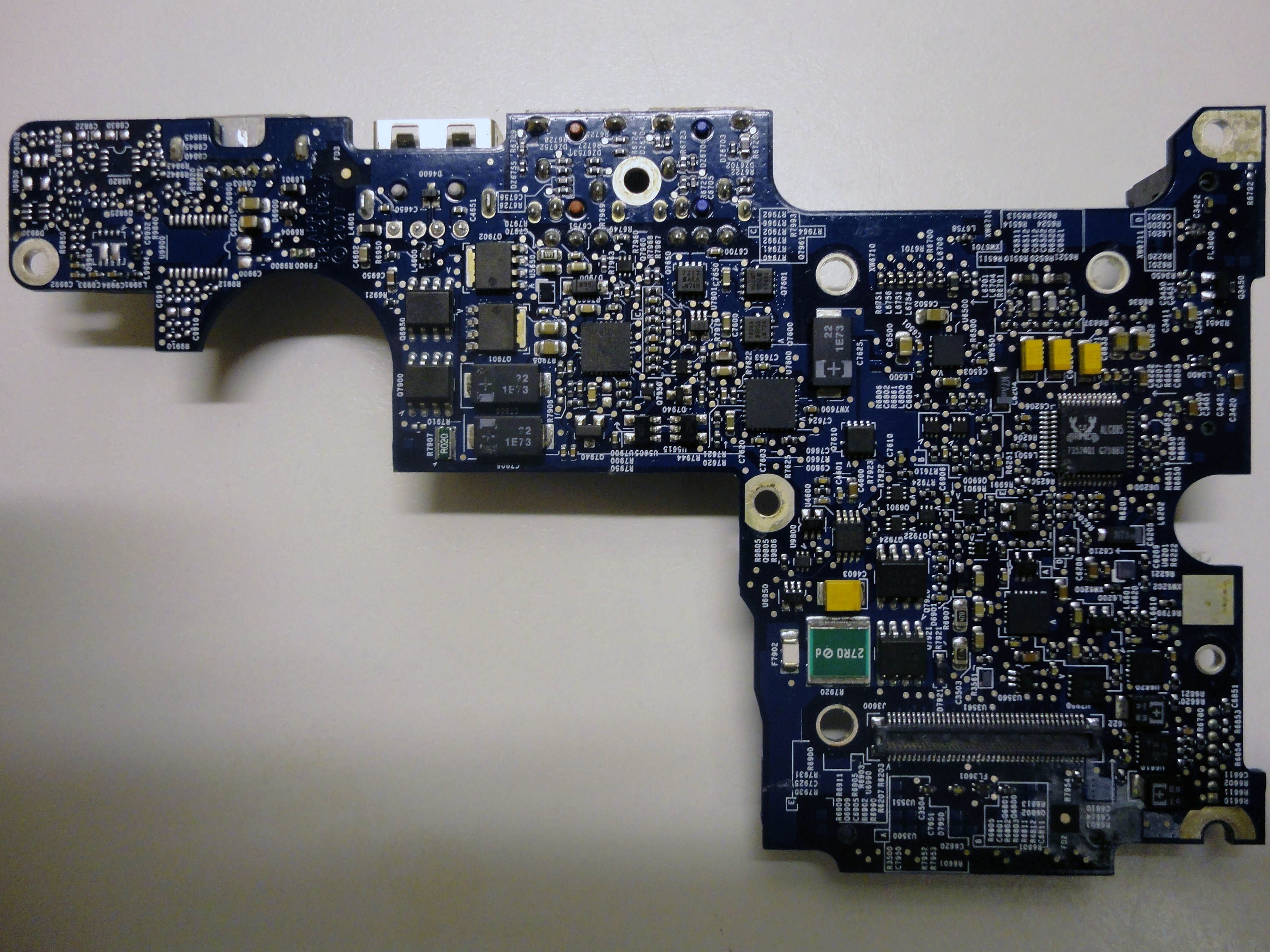

Hello everyone and thanks to all for sharing on this thread !
I actually do have an A1260 with the backlighting problem. My display is fine but completely dim ; I tested with 2 spare LCD and cables, 3 spare LED driver boards, without result. So I am sure the problem comes from either the LIO board (model 820-2273), or the logic board.
I searched for help a few months ago, but there were no experts on this model on the thread at that time... So I hope someone can help me this time 🙂
I read the voltages on the output connector of the LIO board, and they are different if the LED driver board is connected or not. If it is disconnected, I read :
PIN 1 : GND
PIN 2 : 12.6v
PIN 3 : 3.3v (should be 5v according to schematics ?)
PIN 4 : from 0v to 3.15v depending on the lightness choosen on keyboard
However, when the LED driver board is unplugged, I read :
PIN 2 : 5v
PIN 3 : 2.4v
PIN 4 : from 0v to 3.15v (identical)

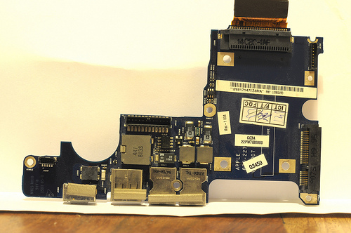

Here are the pictures of the LIO board :
IO board top par arakira, sur Flickr
IO board bottom par arakira, sur Flickr
I took the schematics for the LIO from : http://wenku.baidu.com/view/2c7a076427d3240c8447ef14.html
LIOschematics par arakira, sur Flickr

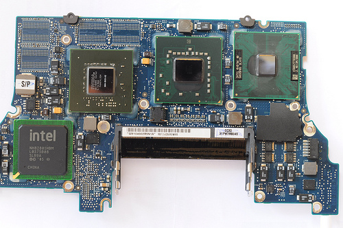

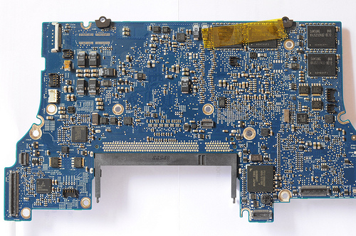

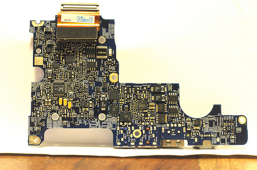

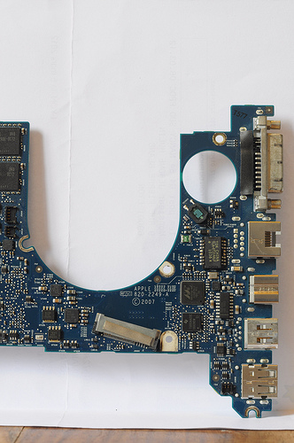

In case, pictures of the logic board :
logic board top right par arakira, sur Flickr
logic board top left par arakira, sur Flickr
logic board bottom right par arakira, sur Flickr
logic board bottom left par arakira, sur Flickr
If someone could gently show me what component may be faulty (maybe l.a. rossman or wedgeman ?) I would really appreciate.
[url=http://farm9.staticflickr.com/8024/7425740504_4303f0aee3.jpg]Image[/url]
[url=http://farm6.staticflickr.com/5271/7425740844_de364a63aa.jpg]Image[/url]
[url=http://farm6.staticflickr.com/5075/7425739718_e9c17f16e4.jpg]Image[/url]
[url=http://farm8.staticflickr.com/7137/7425740082_9eab365b83.jpg]Image[/url]
[url=http://farm8.staticflickr.com/7255/7425741412_f2606ae025.jpg]Image[/url]
[url=http://farm9.staticflickr.com/8150/7425741822_fb10f33fca_n.jpg]Image[/url]
Many thanks !
