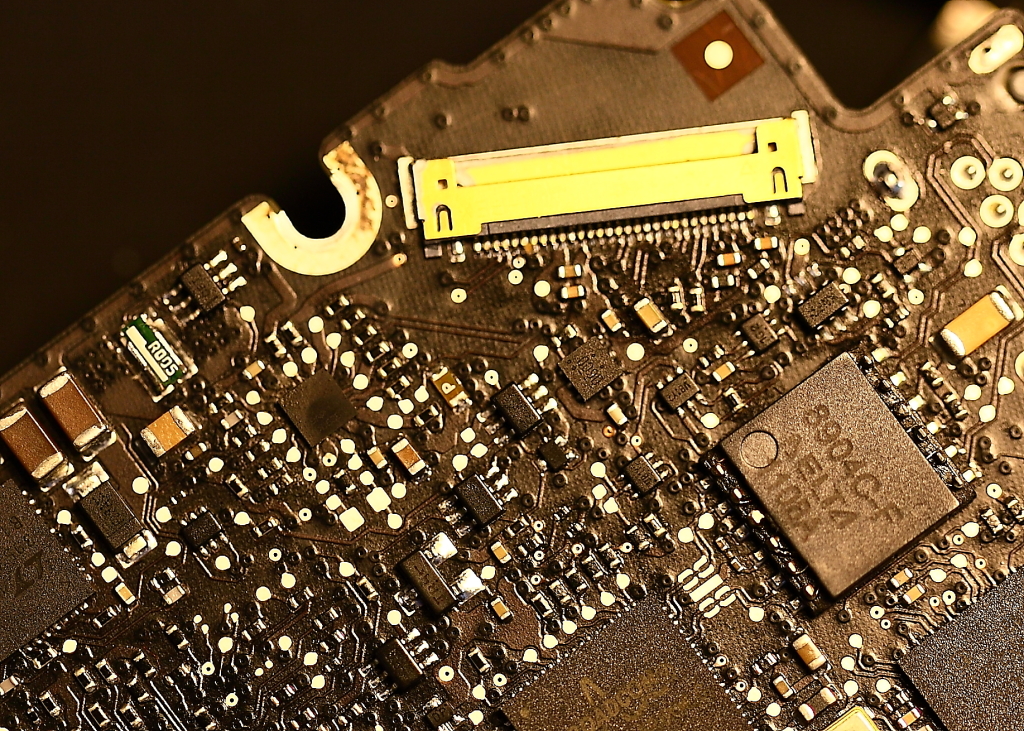

As you can see the last two Pins look like crap.according to the schematics posted here those are the pins for the backlight(correct me if i am wrong).
My question is.
What do you suggest me to do?
Try disassembling the lcd and locate any fried component?
Try replacing the lvds cable hoping nothing else has gone wrong?
Or buy a new display assembly and get it over with?
Thanks again for all your help!

In all likelihood it is just the LVDS cable that is bad. The good news is those cables are fairly cheap now on eBay. The bad news is you have the glossy display then getting the glass off the front is a bit of an art form. Reeeeally easy to break the glass if you are not super careful. I would say, read a few guides, get yourself the tools (heat gun, suction cups, iPhone spudger tool) and have a go. Worst case, you break the glass and you are no further ahead.
Thank you.
I actually have the hires antiglare display so i think it's a little bit easier.
Think i'll give it a try,maybe tomorrow.
Thank you for your opinion.

So i went on with the operation!
I opened the display and removed the lvds cble.
The other end of the cable(the side connected to the display) looks like new and shows no sign of wear or any thing.the connections on the display also look perfectly normal.
Do you think it was just a matter of those two "bastard" pins i showed earlier?
Or maybe there's something else wrong inside the display?
Please share your opinions.
Thank you

I just wanted to let you know i just installed a new LVDS cable and the screen is back to life...now i just gotta wrap everything up!
I want to thank you all for the help!

Dadioh, here is the picture
I am so worry that the LED driver or WLED chip is dead.
Thanks
It looks pretty messy around the WLED driver. I assume this was a liquid spill? I would take a new toothbrush and some 99% pure isopropyl alcohol and give that area a good scrubbing to remove residue (with power removed and battery disconnected). It is possible that there could be some leakage through the residue causing an issue. Worth a shot anyway and you really should remove residue anyway to avoid future corrosion.
I used super alcohol to clean it twice before taking this picture. I also used head gun to dry it as 120 celcius degree. It worked for two hours then back light problem occurred. The P fuse is still good. Do you think the wled chip dead?

Wow those dark spots on the board looked like dried up coffee or cola and isopropyl alcohol will not remove them easily. If I were you, I'd disconnect everything on the board that can be unplugged/taken out, stick it in the dishwashing machine and do a short cycle. Let it dry and then some more air dry ( a couple days). the board should be as clean as the rest of the area unaffected. (I've done this with a Macbook a1181 LB in the past to clean it). Note that these LBs are wave soldered during manufacturing and go through a flux cleaning solution bath, so doing what I suggested is not far-fetched.
There are some deposits for which isopropyl alcohol is not a good solvent. In those cases water may dissolve them. Dishwasher could work but it depends on the hardness of your water. You don't want minerals left behind on the board when it dries. An alternative would be to get some distilled water and scrub the area in question to see if water is a better solvent for this particular spill residue. Then dry with your heat gun before powering up.
The problem with liquid & QFN packages is that all too often, alcohol and a toothbrush don't do anything good. All the connections are under the chip, an area your toothbrush doesn't get to. This is where ultrasonic cleaners come in. Heat the right liquid(a combination of bran-sonic EC & distilled water at 60c always does it for me), put the board in the bath, run the ultrasonic and little bubbles will get under the chip and rip all the crap off.
If you have good soldering skills, remove the WLED driver and look at it. It could have some ugly contacts. Remnants from liquid spills often move around over time which causes the problems.
My procedure on a liquid spill is to put the board in the ultrasonic bath with bransonic EC & distilled water at 60c for a few minutes. I turn it on and off while rotating the board.
Then I sit the board in a tray, which is a bath of isopropyl alcohol. Alcohol displaces water so this gets rid of all the distilled water. Then I use an alcohol bottle with a squirt-nozzle top to squirt the board while holding it, and squeeze to increase pressure to get underneath the chips. I'll point at the QFN & BGA packages and squirt into each side.
After this, it's off to the air compressor. The compressor is at 100 psi to 45 psi depending on what area of the board I am on so as to not cause damage, and this compressor did have a filter installed to ensure no dust/dirt/liquid comes out at the nozzle. The board is dried to the point of there being no trace of the alcohol on it, or under any chip.
At this point, there is no chance of further corrosion, and any minerals that may have been left behind breaking connections or creating new connections are gone. It's off to replacing components that have failed, and usually you have a good board.
Try to mimic this procedure in your own setup. I see boards where people have taken alcohol and a toothbrush to them everyday, but a lot of people don't do this effectively, which causes the laptop to still not turn on and function because the board is not yet clean. Beg, borrow, or steal a jewelry cleaner if you have to! See what you can do. If your backlight works for a few hours at a time, you are ahead of the people who have rotting LVDS connectors & blown fuses. All you need is a push in the right direction to have a working machine.
