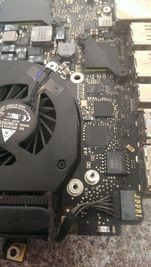

Hi, I bought this MBP on ebay with no backlight and reading your posts I was able to sort this out but I'm getting one problem every 4th or 5th diode does not work 🙁
So to get in to this place where I'm now, I've replace already resistor 300k & 6 leg smd 638z next to the wled driver and I've replace also 40 pin lvds connector and now I end up on one row led not working
so if can ask for help I'll be grateful to anyone. Thx
PS what i did check is that that I'm getting 37v on 38,39,40 pin on lvds con and on 2, 3 2.5v, on the boost diode next to the wled D 33v
resistance on wled driver looks like is ok compare to the thread on the first page

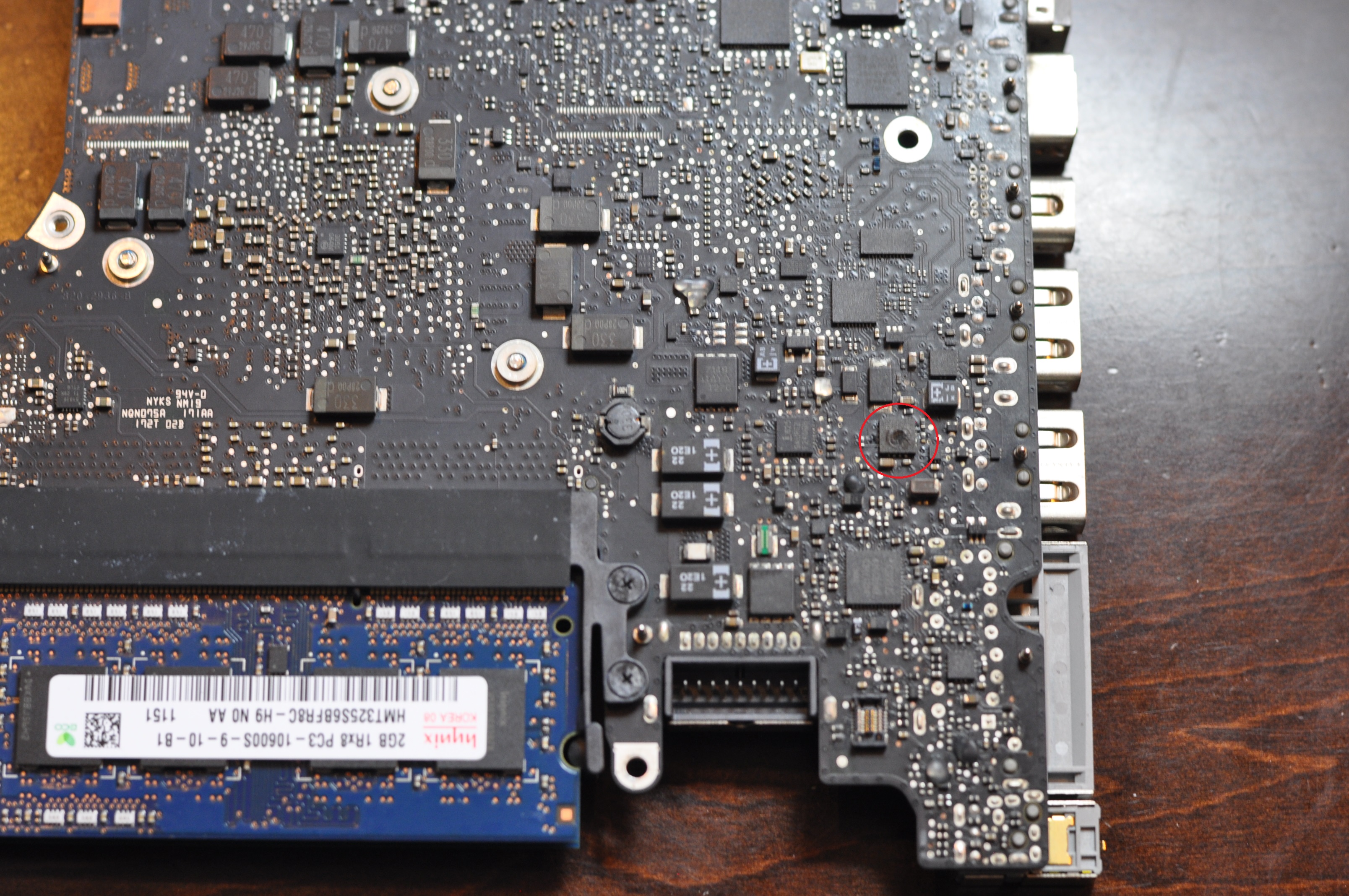

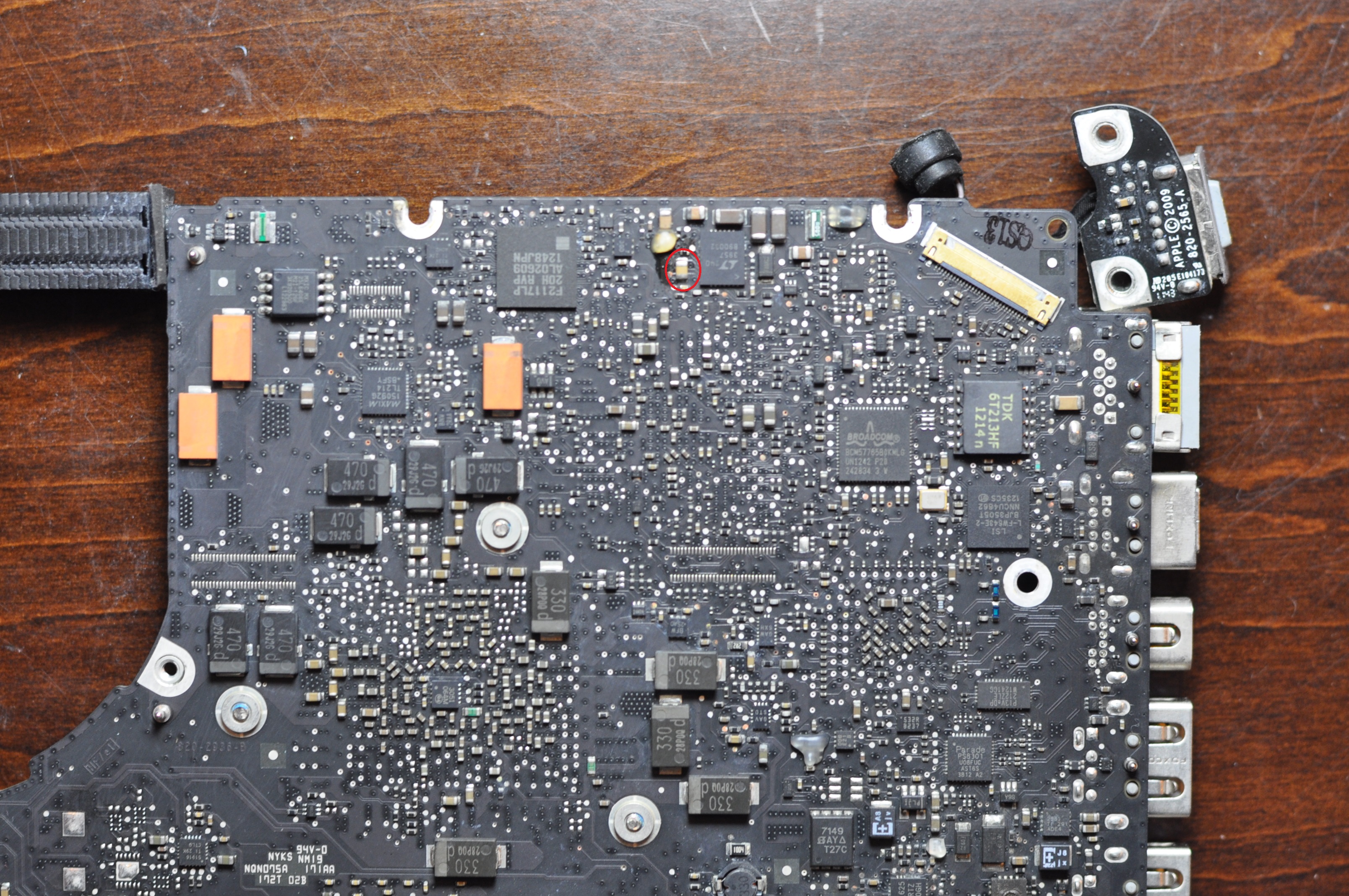

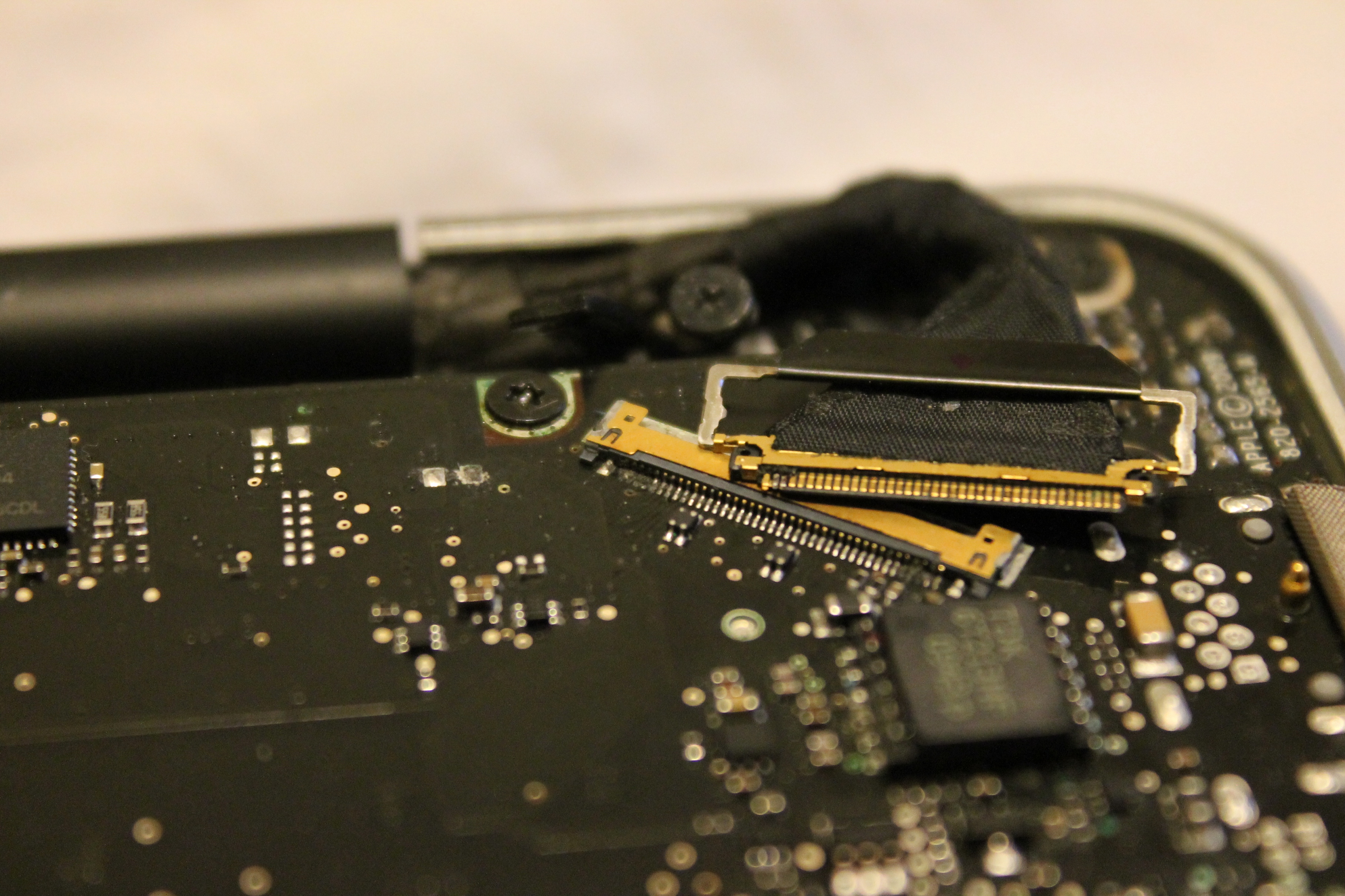

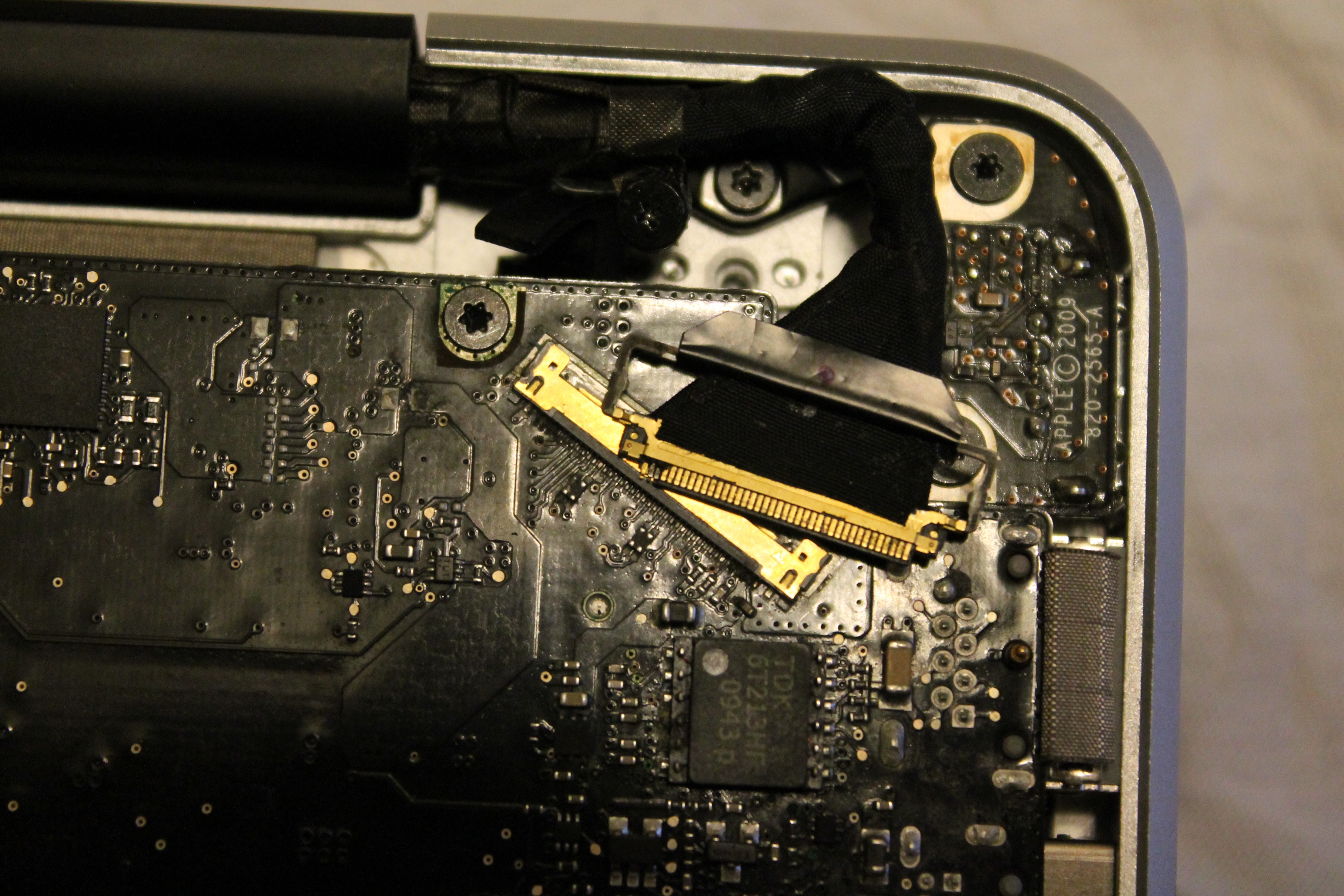

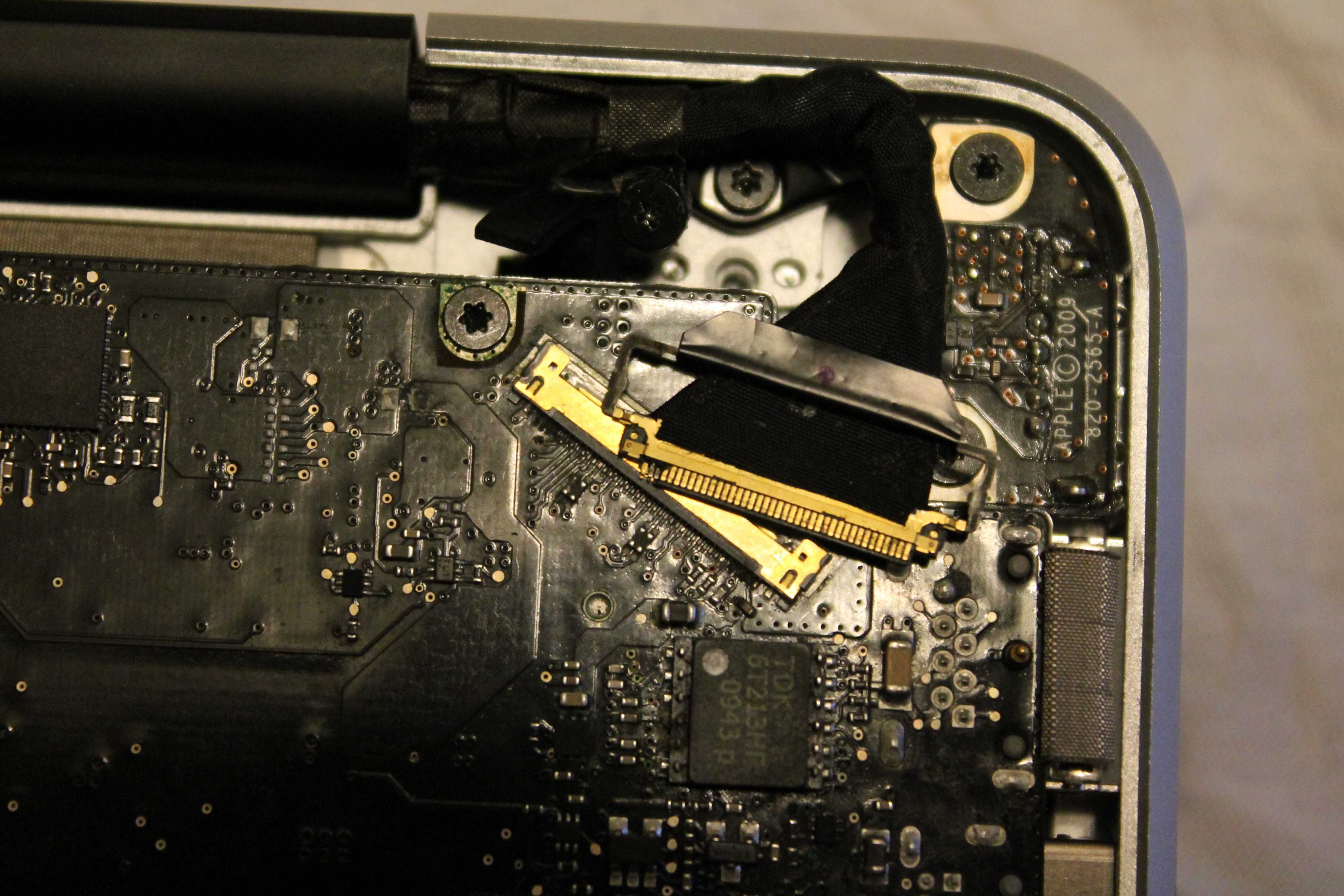

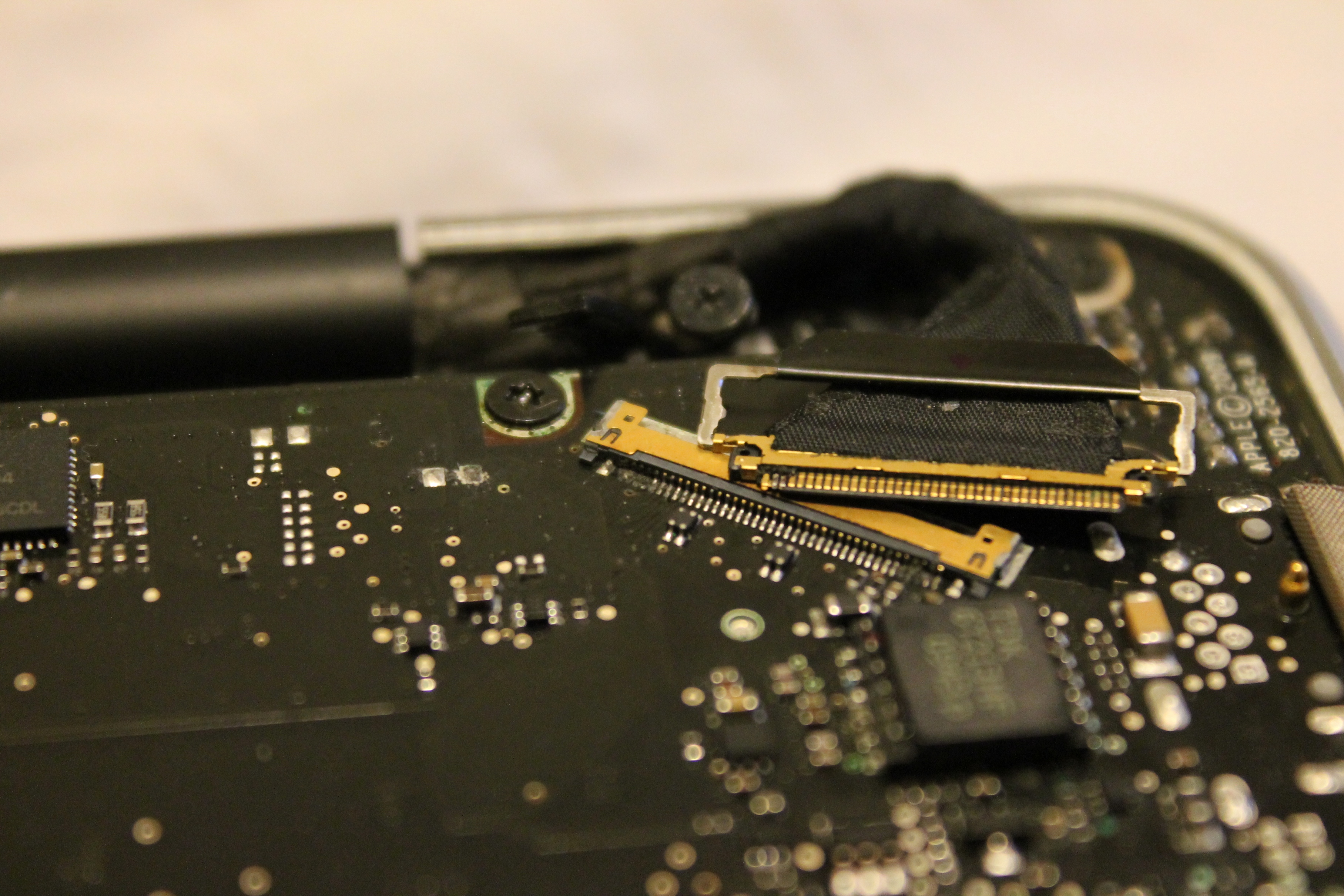

Here are some snaps of the motherboard near the VLED (I think that's what it's called...) connection.
I think that the fuse is the small white part near the edge on the underside with the sign that looks like a rounded A but without the horizontal line, but if someone could confirm for me, that'd be amazing.

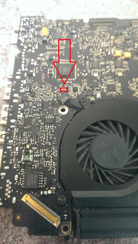

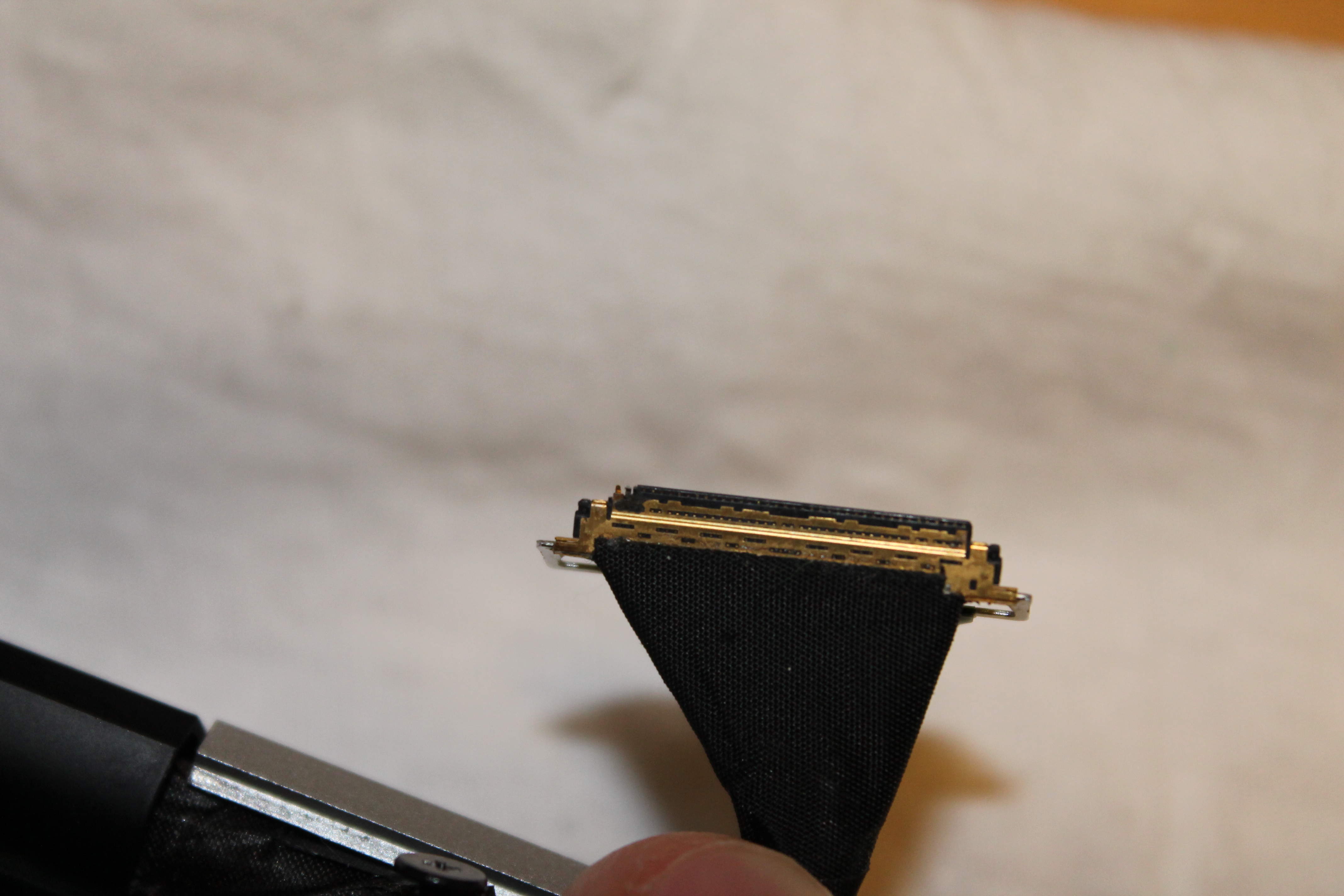

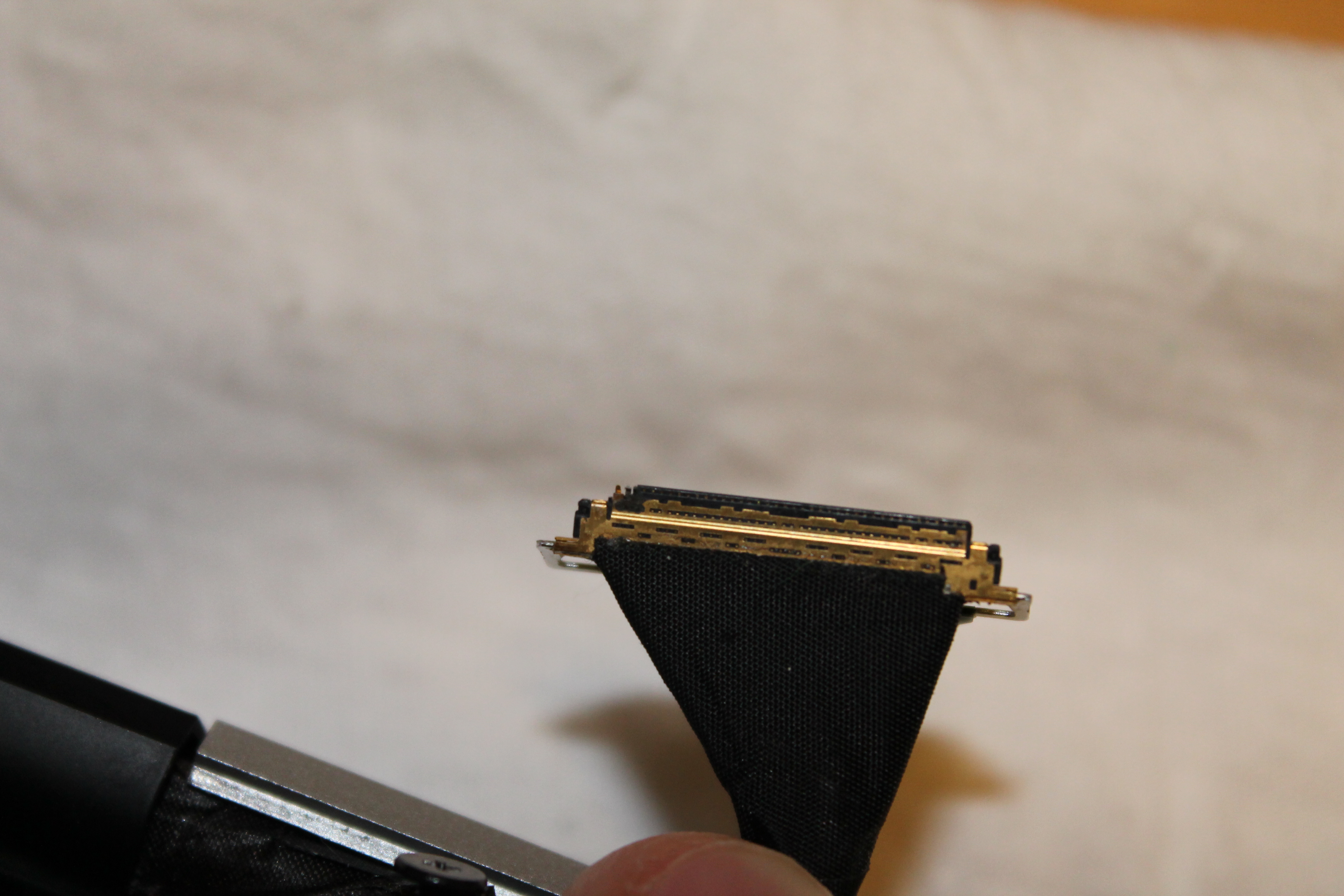

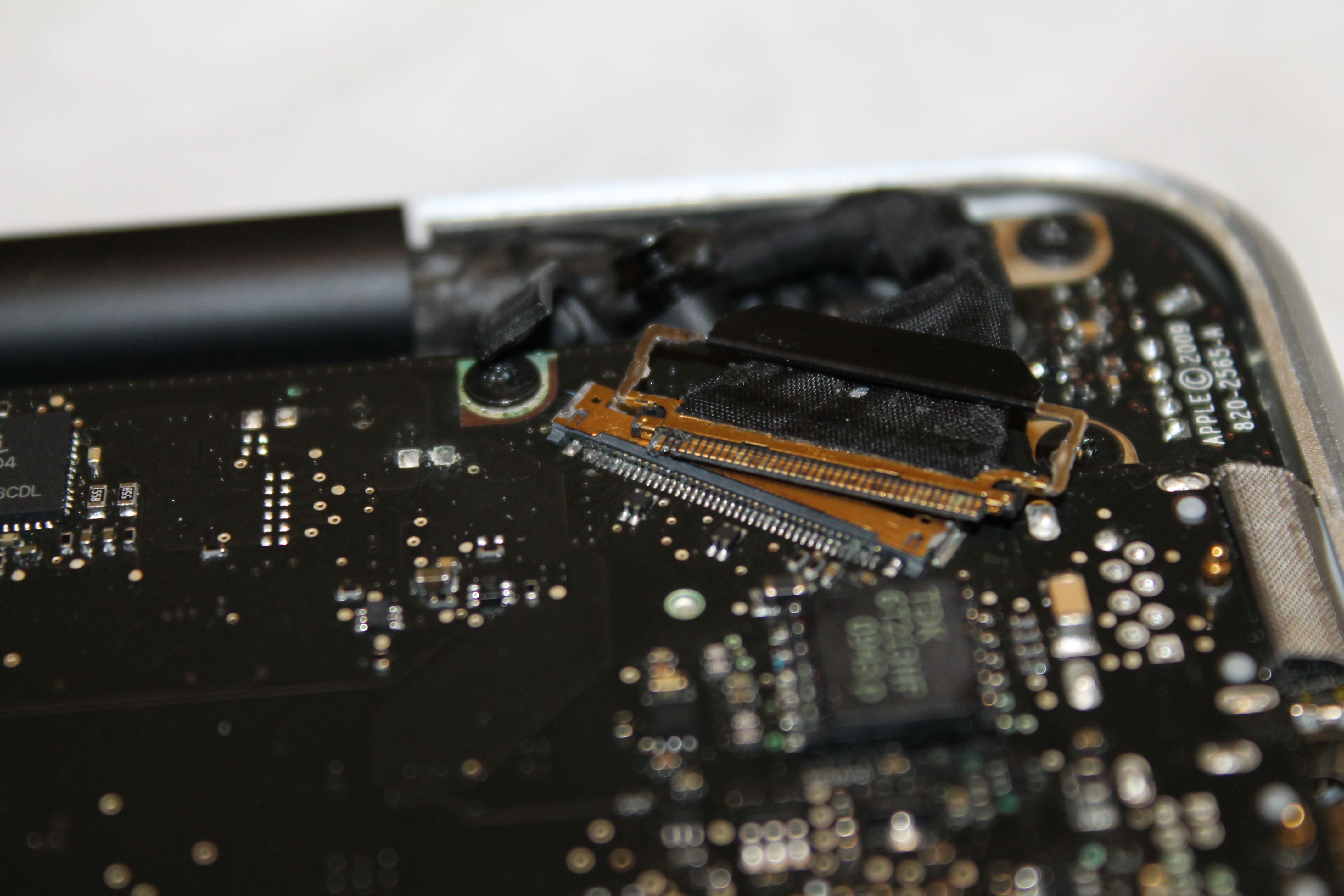

What do the last 3 pins of your LVDS connector look like? Same for the cable.

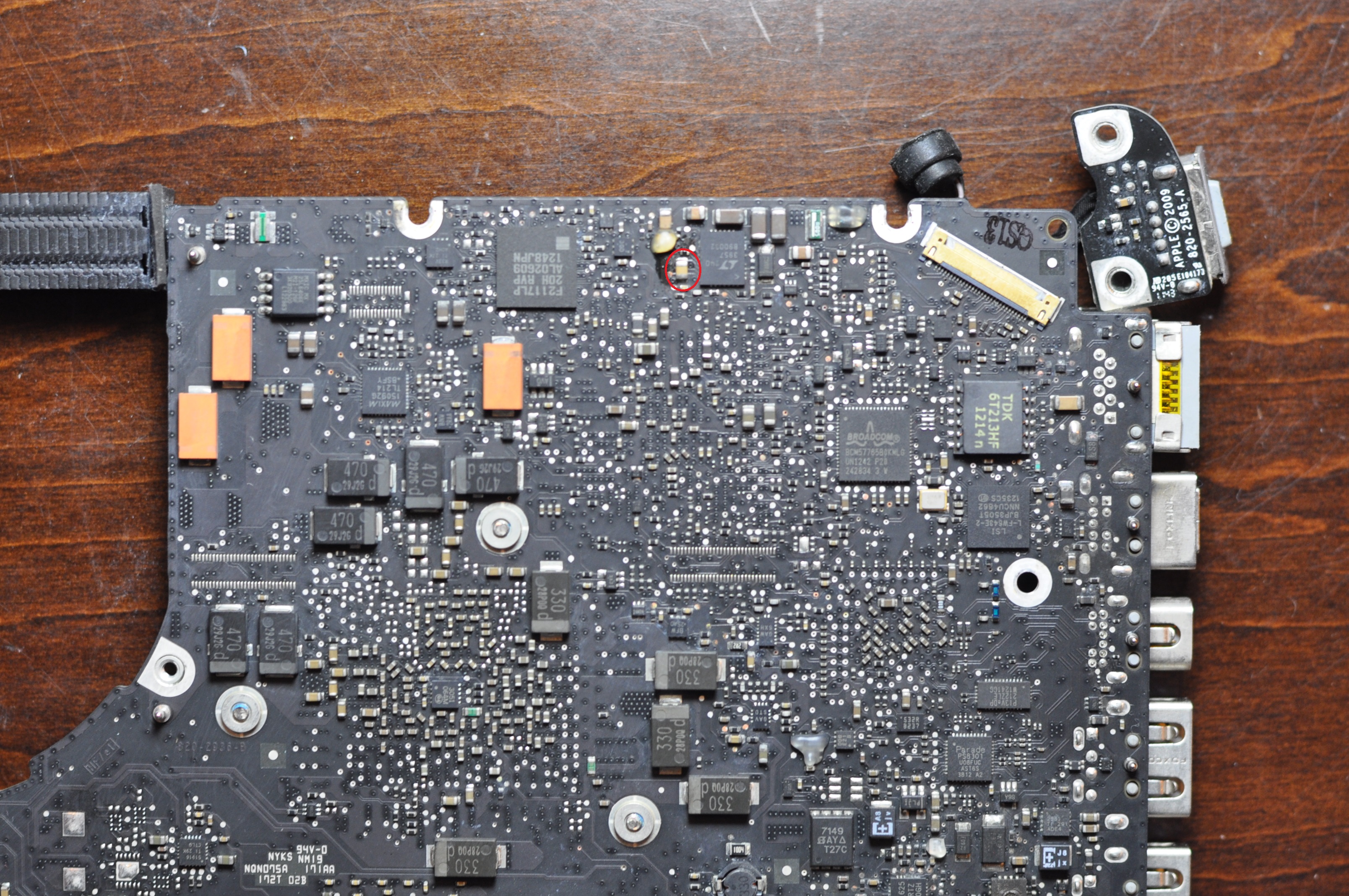

Please confirm that your board is an 820-2915 so I know that what I squared in the picture is correct. I am going based off of memory, I cannot tell much from the picture due to the lighting, side angle, and general blurriness. If that is an 820-2915, that is your fuse. if that is another board, then I have no idea what I just circled.

Aha! Thanks so much! I can see it now! With the 'P' on it!
Sorry for the bad pictures, I assumed it would be closer to the video connector, and didn't want to block the light as I'm in an office and it comes from above.
Thanks again, you guys are the best, I'll let you know if replacing the fuse sorts everything out.

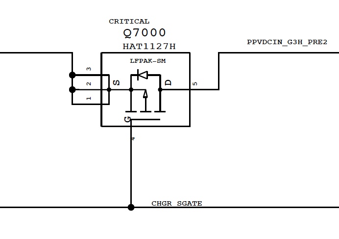

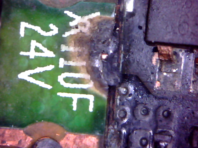

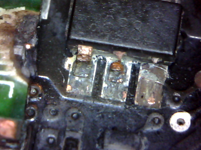

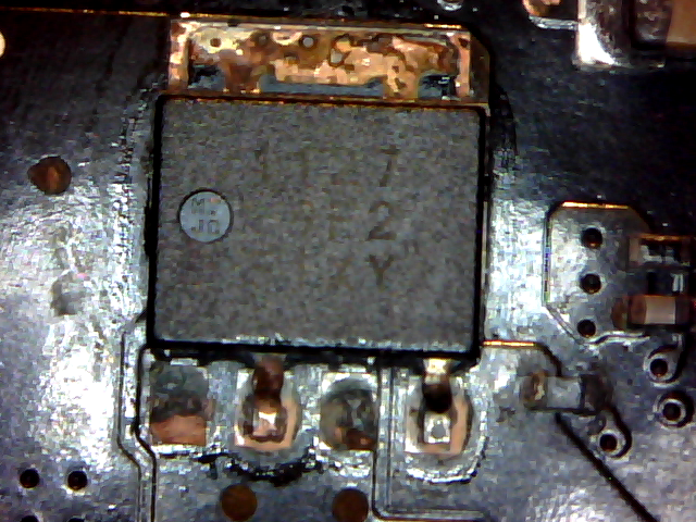

Hi everyone, I have a water damaged MBP 13" late 2011 and what sucks is I have AppleCare until 2015 🙁 Being a poor uni student I can't afford to purchase another laptop, so I pulled out the logic board (820-2936-B) and cleaned it with 100% ethanol and a toothbrush.
When I put it back together and plugged in the magsafe charger, the light turned green! Great I thought, but instead of trying to turn it on I plugged the battery back in and to my horror two components started smoking and glowing RED hot! Needless to say I immediately unplugged the battery. But now the magsafe light only glows a very dim green and the MBP won't turn on.

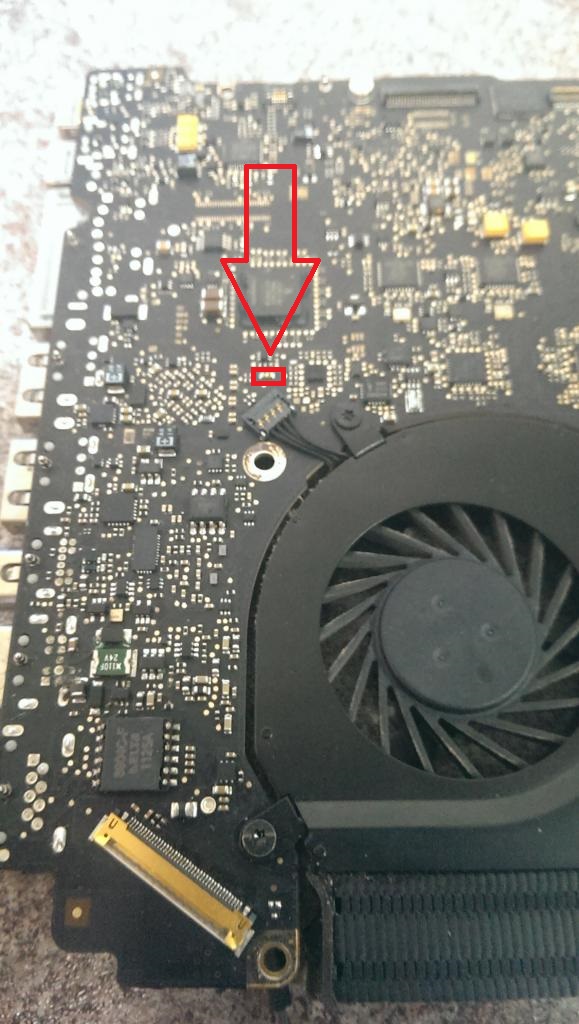

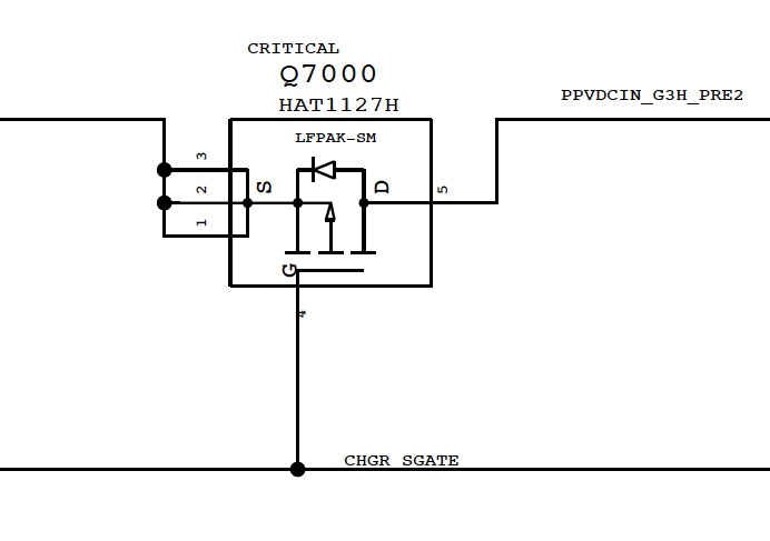

I've attached photos of the logic board with the burned components, is anyone able to identify them? The top one I think is a capacitor and as you can see in the photo the surrounding PCB is glossy from the heat. The lower IC chip got so hot it bubbled and bits flaked off.
Is it at all possible for me to purchase and replace these two components? As I think the logic board is in very good condition otherwise, the corrosion wasn't very serious.
Thank you very much in advance, any help would be much appreciated!

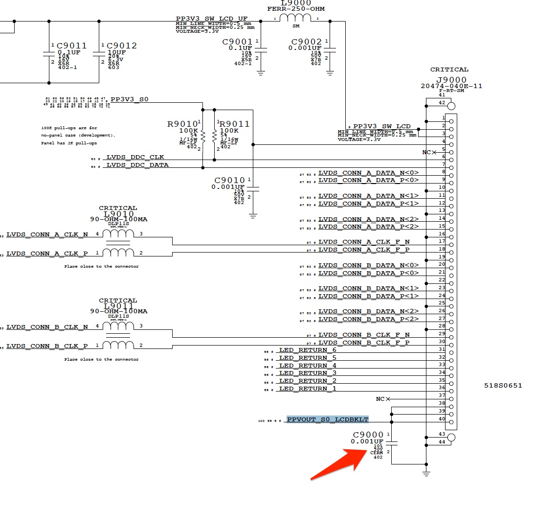

Assuming that the LVDS connector is the same from the earlier 15" MBP then those last 3 pins are indeed the backlight voltage. You will need to solder a new LVDS connector on the logic board and get a new LVDS cable from the sounds of things.

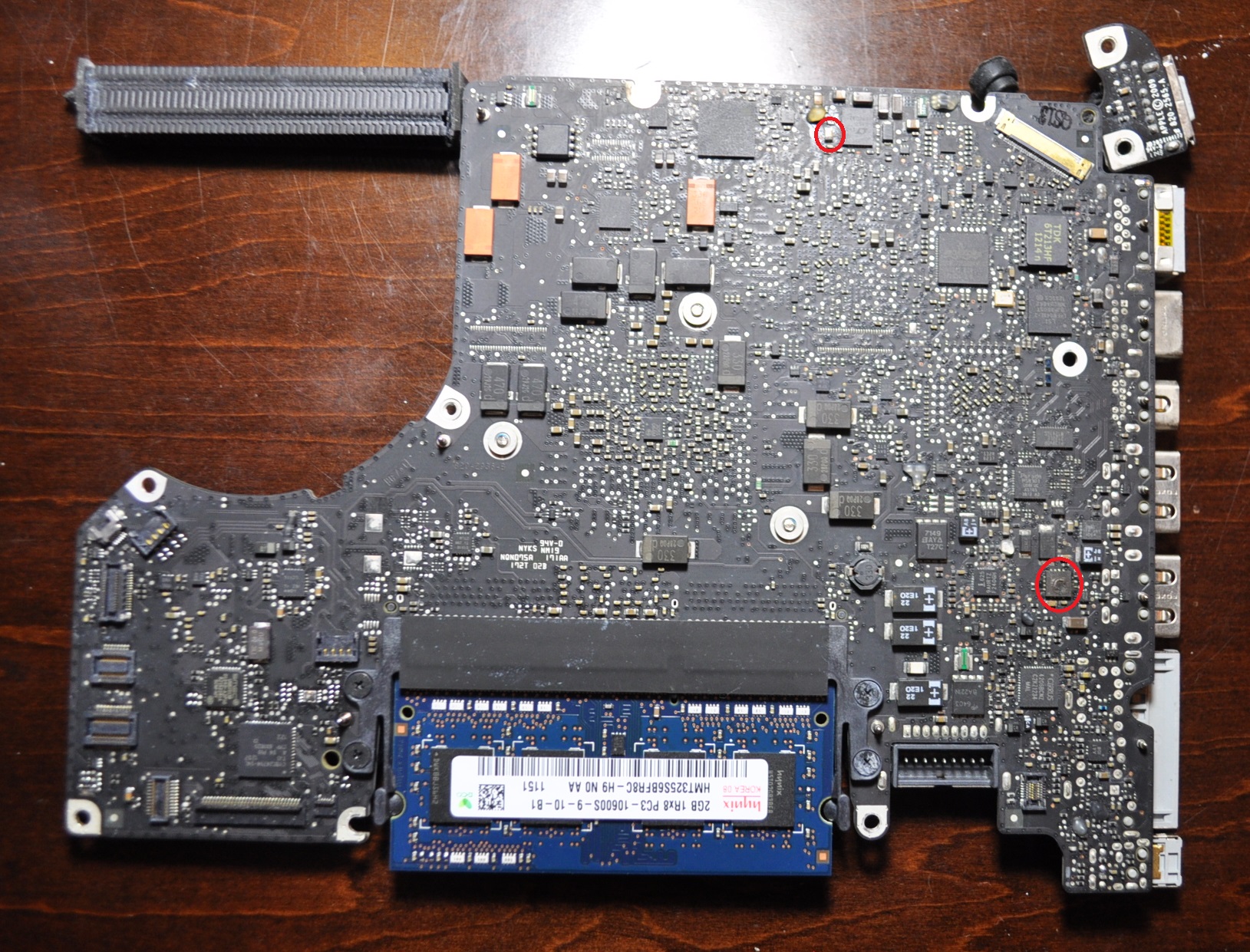

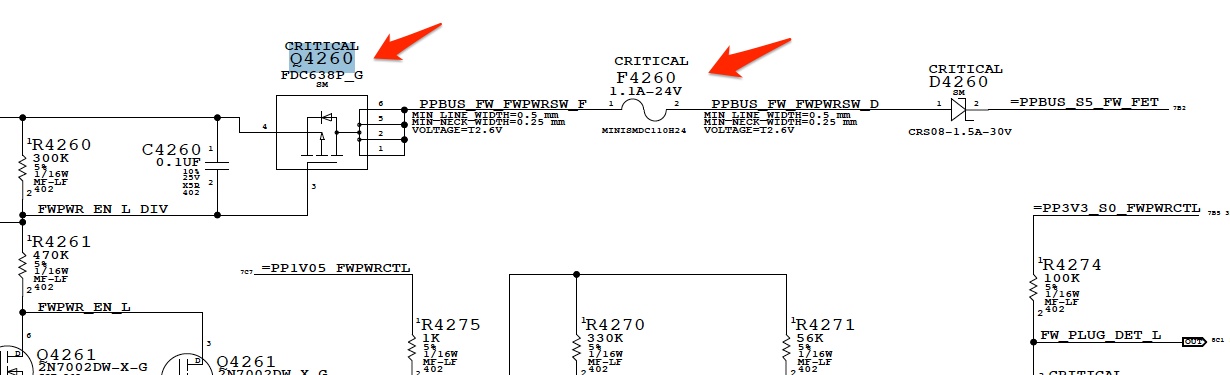

Anyone knows how can I find those SMD's ??? where and what to buy ???

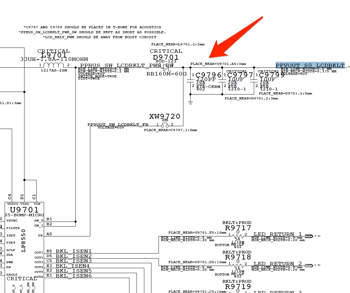

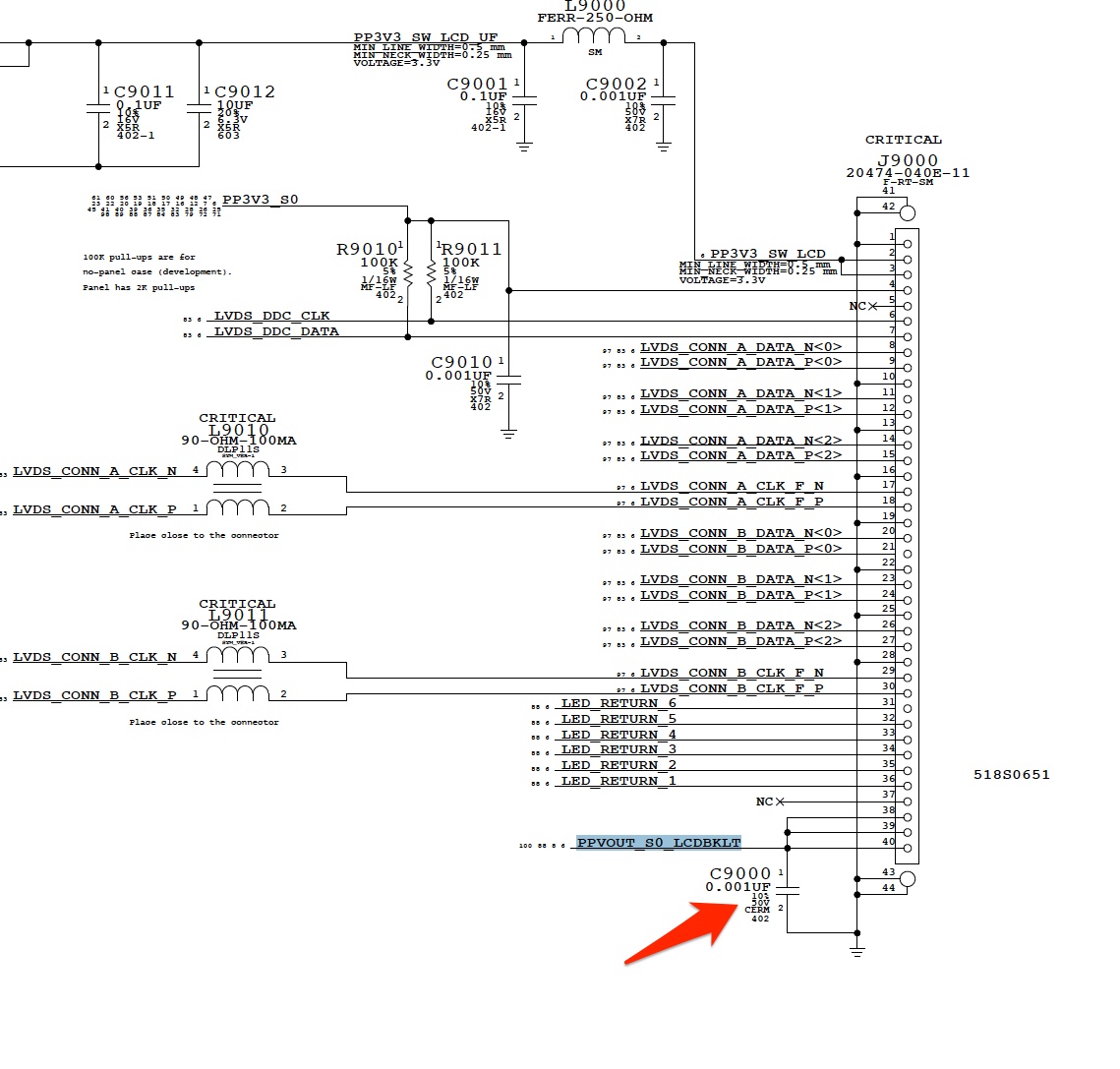

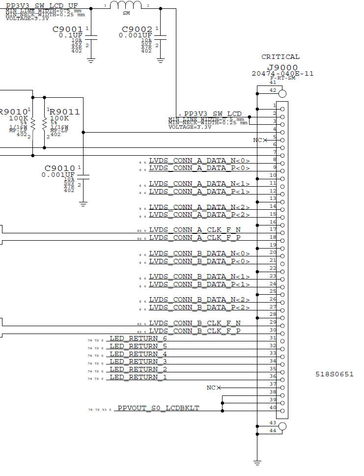

Hi again,
So I managed to find the schematic. How can I show it to you ? because I really dont know how to read this. If you kindly wanna help ... please

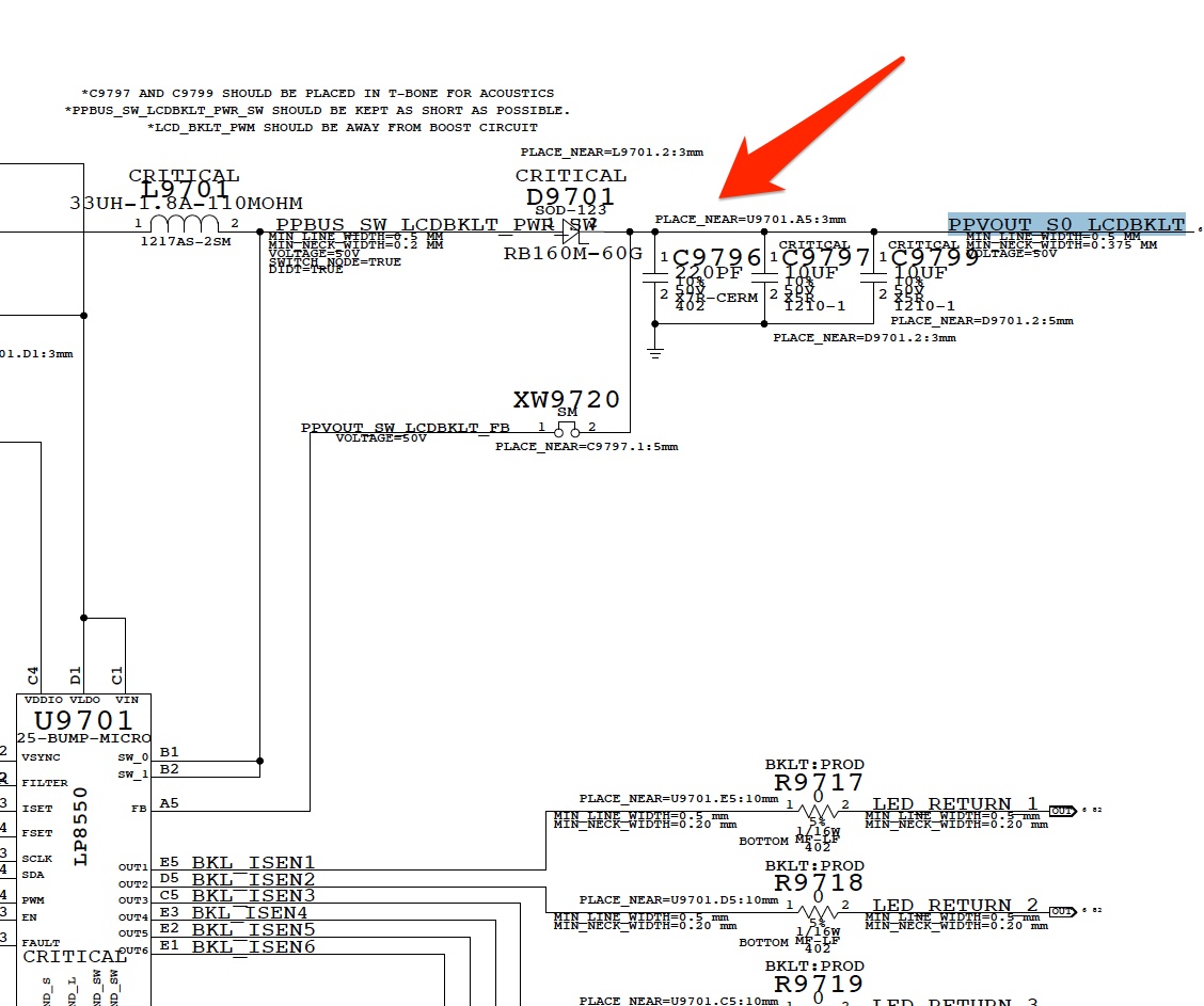

So I looked at the schematic and the backlight pins connect to a cap near the LVDS connector and also to the boost diode and other caps which I assume should be near the backlight driver. The Boost diode should be easy to spot. Make sure you connect to the end with the stripe.

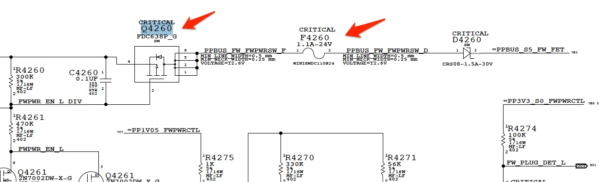

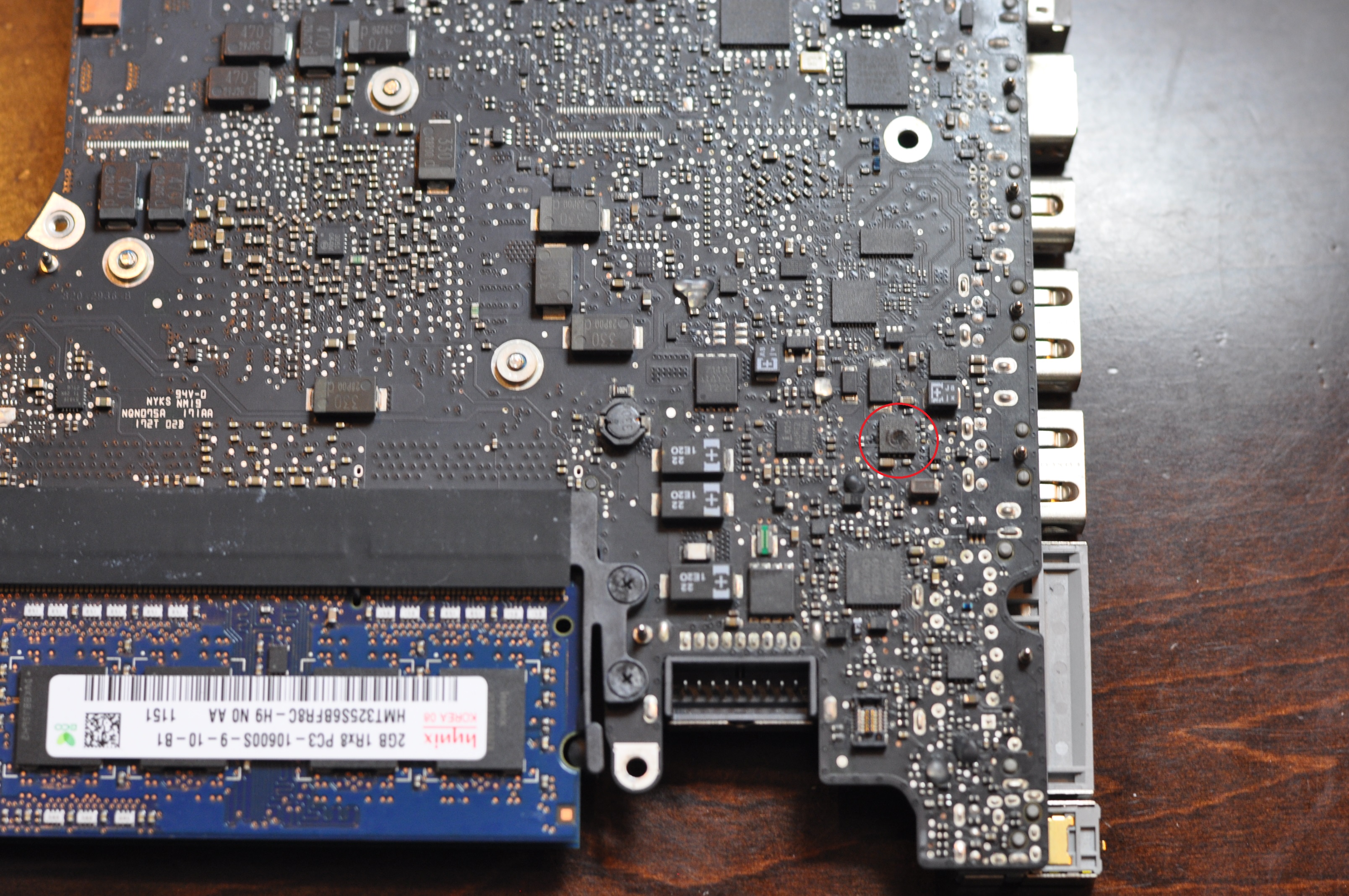

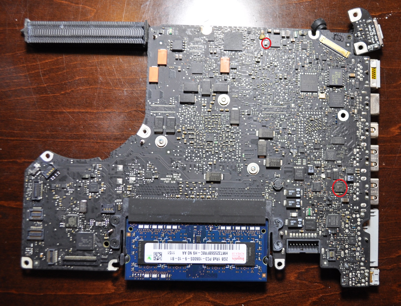

The last 2 pics are the FET and Fuse for Firewire 5V power. You will need to use google to find a source for the parts using their part numbers.
