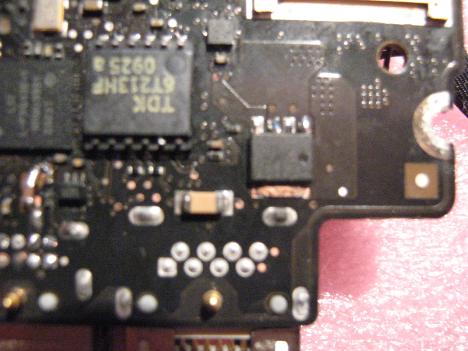

Thankyou Dadioh, for your help. I dont work for clients or for resell those mac's, it's just that I can't afford a new one, so i thaught why not trying to repair one. So thanx again for your efforts ... Everything is clear to me, except onle litle aspect. Those 2 caps, that I soldered, what caps are those ??? Can you find out ???
I tryed to find them in the schematic, but i am not shore if they are here or not.
Thanx again

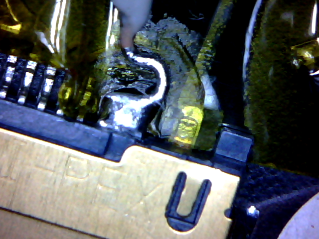

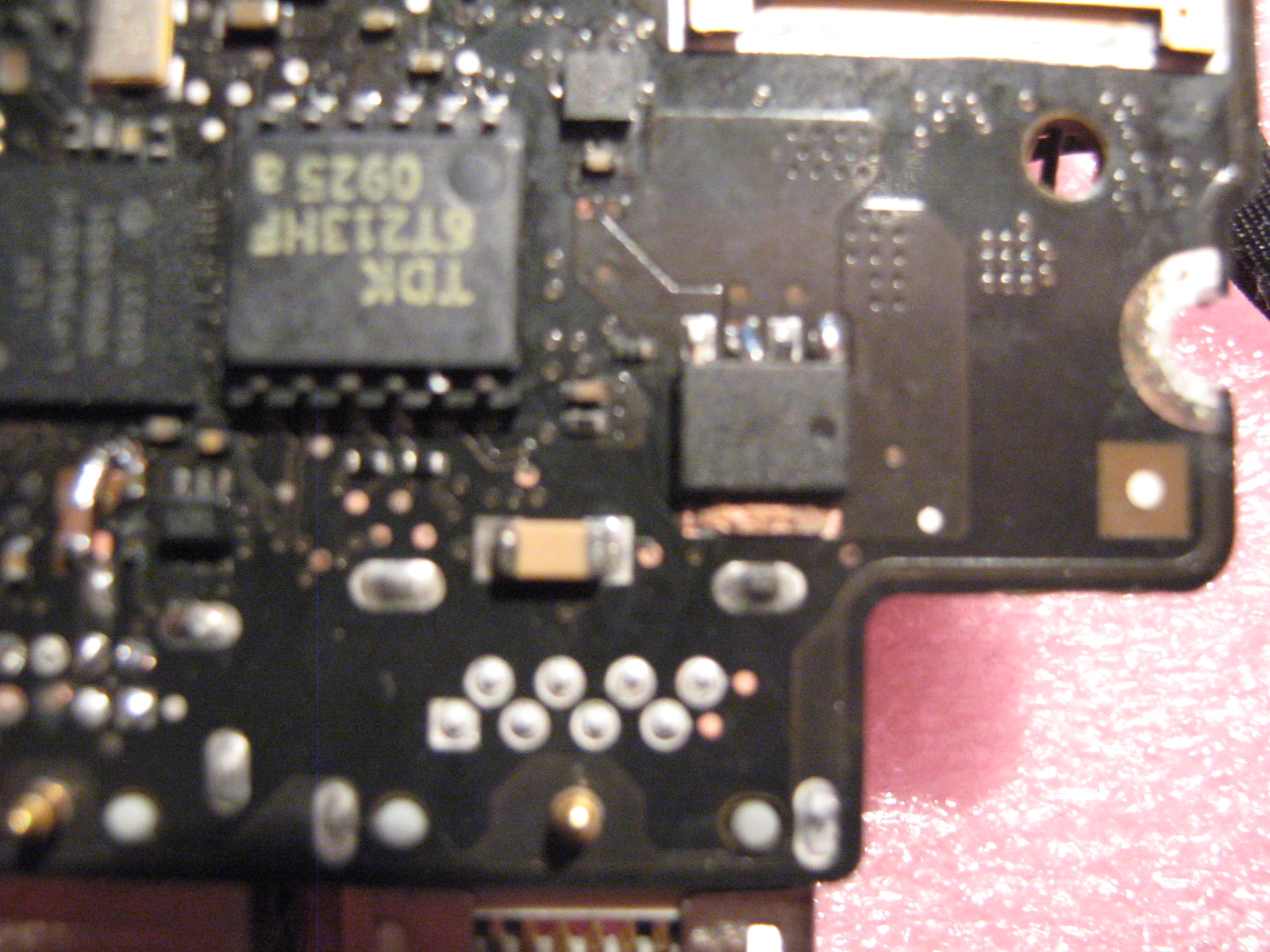

Sorry, I upload another pic cause that one is worst than ever. From What I see, the cabeling goes from the ground to those 2 litle caps, and then to a big one and than it goes to the 3th pin from the output firewire connector. But there are not 3 caps on the schematic. so ...

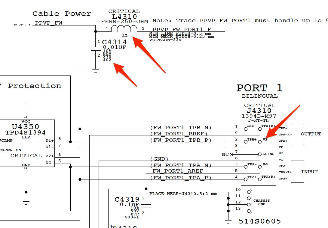

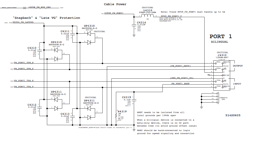

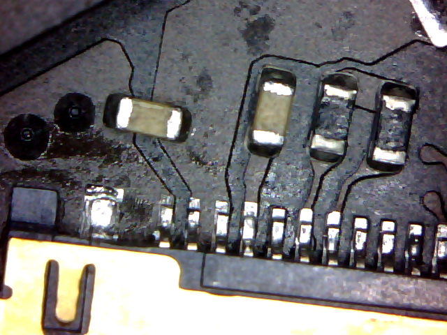

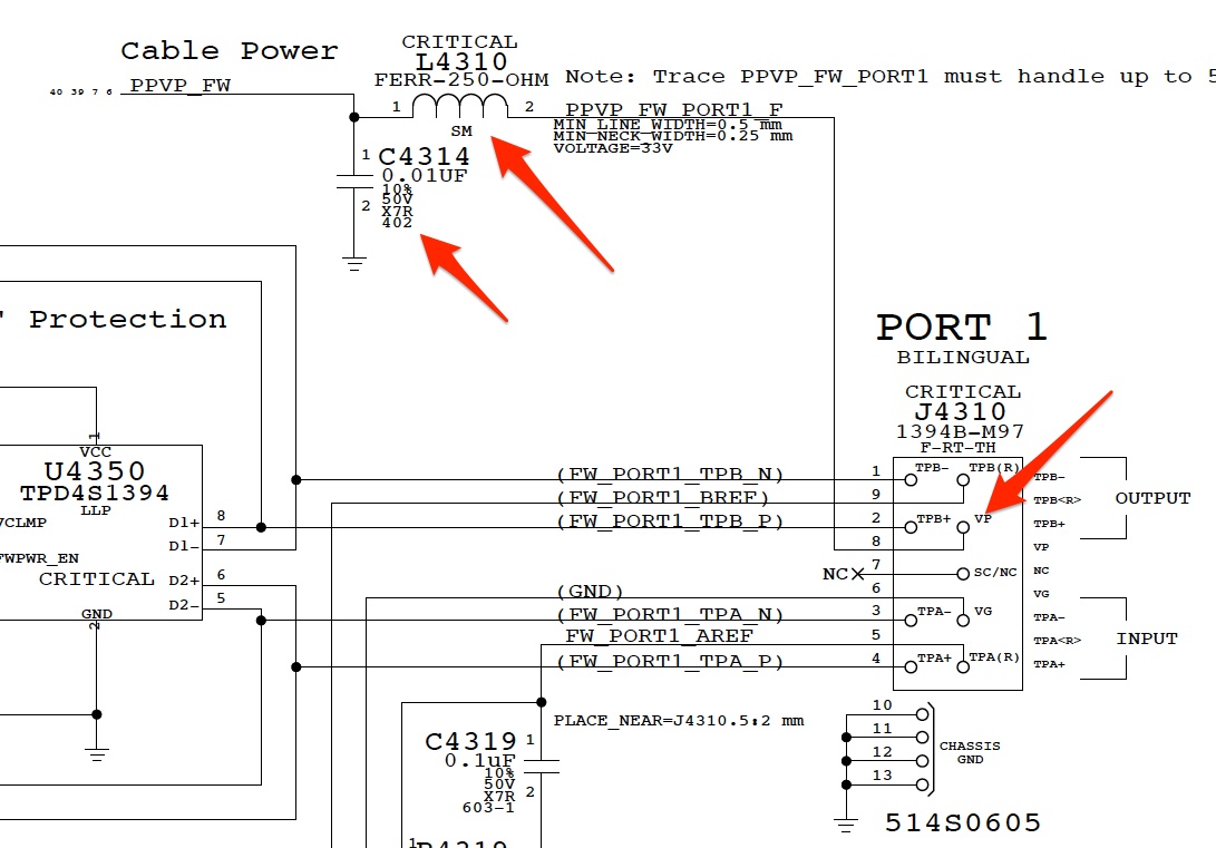

I don't have a board to refer to but looking at the Cap that you added it is supposed to be a ferrite. The pin on the Firewire connector appears to be VP which I assume is Voltage Positive. The ferrite and cap are identified in my attachment. They are an EMI filter for the power.
The ferrite is a 250ohm (measured impedance at some frequency) and the cap is a 0.01uF 50V with X7R dielectric and an 0402 package. You will need to do some searching to find the parts you need to replace them. Or, if you don't need the Firewire port just live without it.

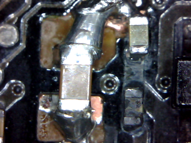

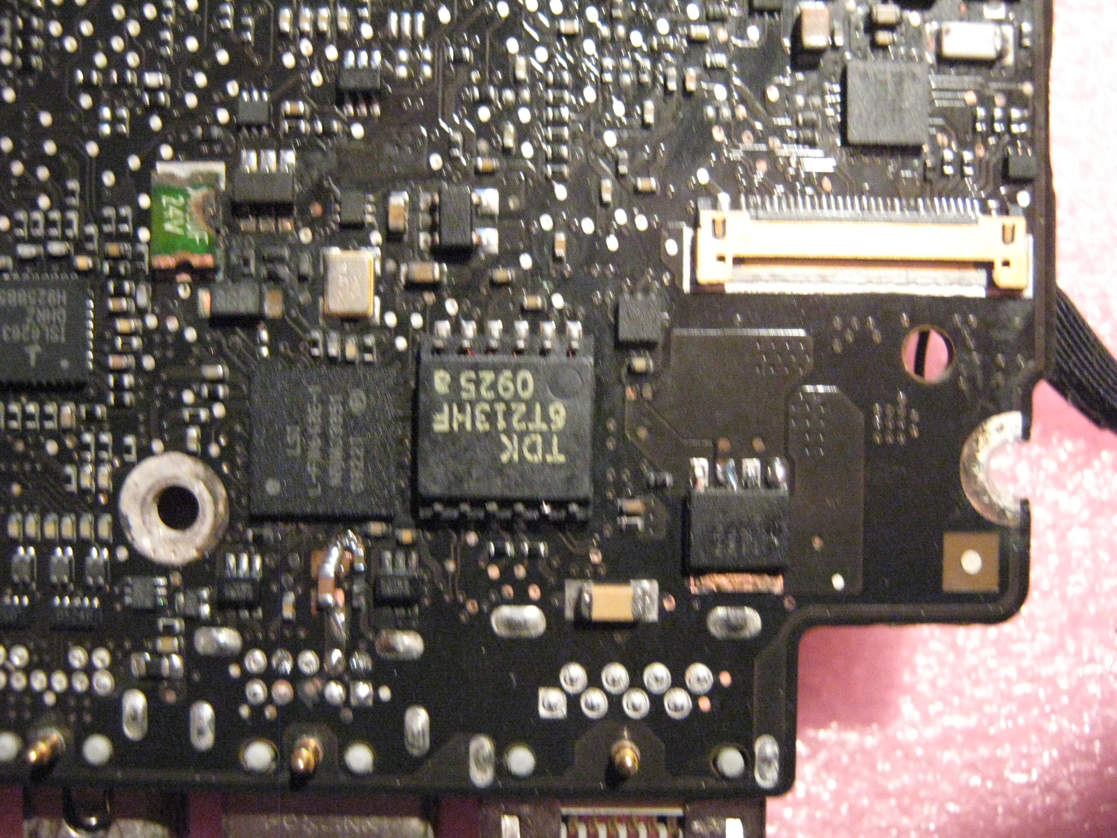

Hello again Dadioh. So I did what you have told me to do with the 15 macbook. I soldered the connector, and the last 3, i soldered them to the other site, where the wires get to the surface. I verified at first and then i managed to take a wire to there. Everything nice, but no video. Still no video. Now, what do I have to do now ?? Verifying that there is voltage on those 3 pins ??? Verifying all other pins to see if i have voltage ? because I dont have a 15 inch screen to test. On the fire-bolt, is working flawlessly . Even the webcam. The connector from the screen, it was clean, because I changed the LVDS cable. so ...
Thanks
That would be the same fuse as used on the other 13" unibody models. 0402 size. 2 Amp. Digikey or Newark are the sources I usually use. You could use the link I provided earlier in the thread.

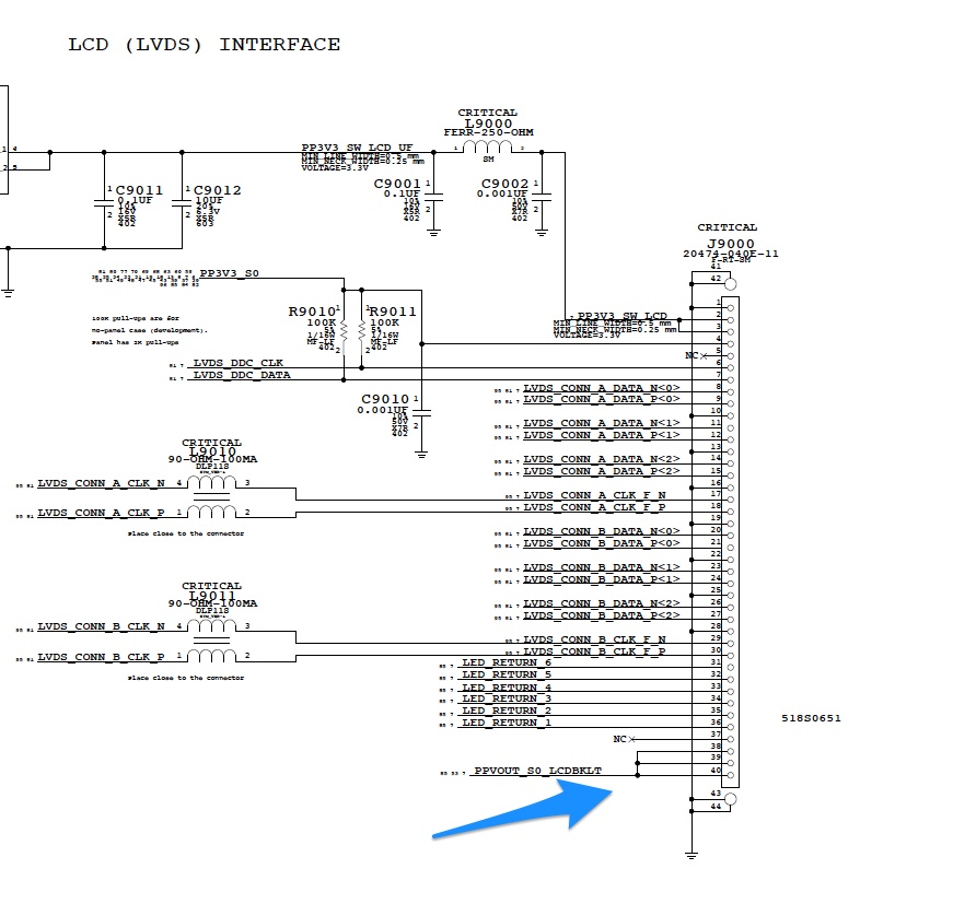

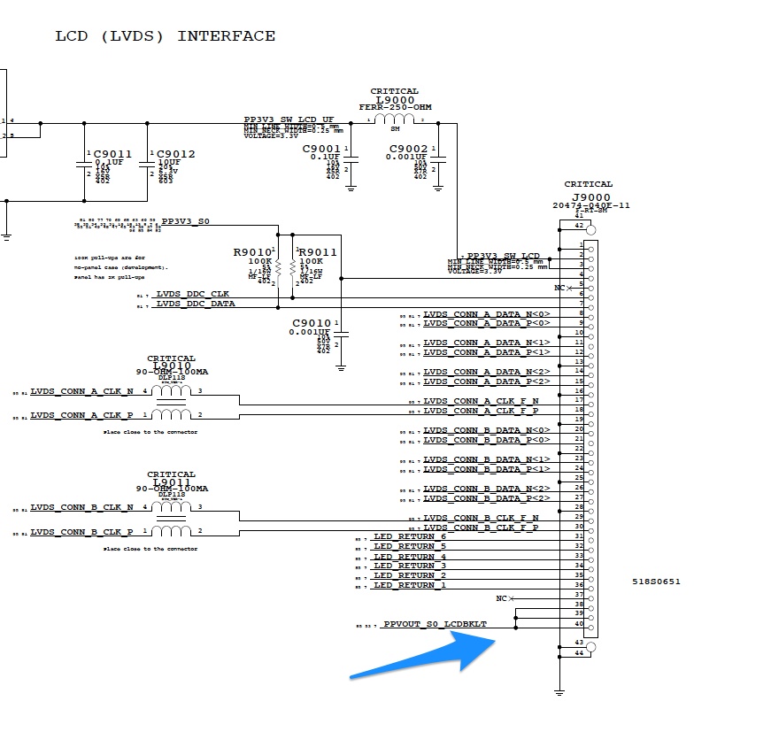

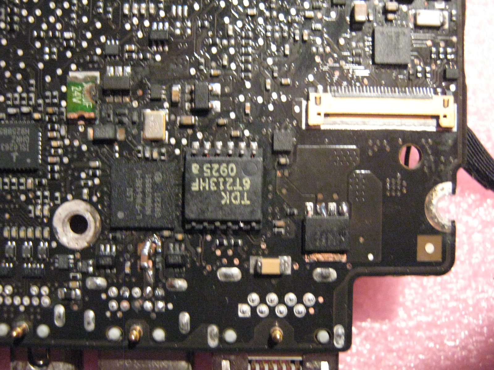

Hey,hello... I use my MBP 13 (A1278) with an external display since 2009, when I had a liquid accident. I don't have the backlight working, but all the rest is ok, I even see a faint image in the display. I don't know how to test the logic board components, and I don't have anywhere so send it (just apple). So, today I tried to connect the LVDS directly to a power source of 24V. Well... I was great, I could see the display working, with backlight. 😉 Now, just a few questions, please...
I connected the 21+22 pins of the LVDS cable to the positive terminal (I had attention to the coax shield), and the 24 pin to the negative. It worked, but then I saw some dark vertical bands on the bottom of the display.
More or less like this (it's not my MBP):
What can be causing this? Are the LED's connected with several rows, and maybe one row isn't working? I know that the pins 24 to 29 are the return lines. I must connect all of them to the negative terminal of my power source? Can it be the problem, because I just have one pin connected?
Thanks.
Hello, anyone can help me with this? have anyone ever tried this? thanks
I am guessing that there are only half of your bottom leds that are working. Are you shore you have only 2 wires for the backlight ??? There are not 3 ???
Do you have the schematic of the logic board ???
Assuming that the LVDS connector is the same from the earlier 15" MBP then those last 3 pins are indeed the backlight voltage. You will need to solder a new LVDS connector on the logic board and get a new LVDS cable from the sounds of things.

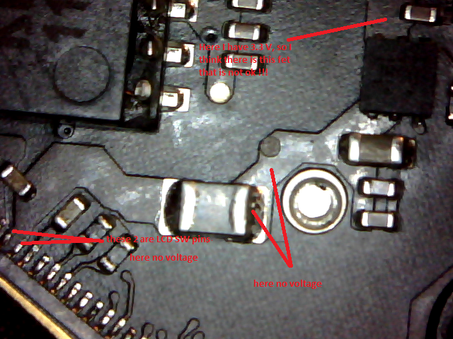

So I measured all the LVDS connector pins and there is nothing. No voltage, i mean in the same time when the mac is functioning. Normally, it must have something, right ??? So what shoud I do now ? Anyone ???

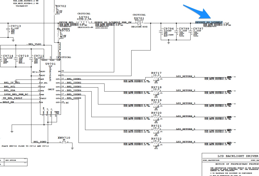

Well I do know that if the LCD panel is not happy it tells the SMC through its i2c bus and then the SMC will respond by disabling backlight and the LVDS signals as well. So your backlight circuit could, in fact, be OK but still not activate if the SMC disables it. You can tell by checking the enable pin on the backlight. It should be 3V.
I would check the resistance between each pin on the LVDS and ground to make sure you do not have a short circuit somewhere. Also check between adjacent pins to make sure the replacement has not shorted pins together.
edit... Make sure you disconnect all power and battery before taking resistance measurements.
Hello guys

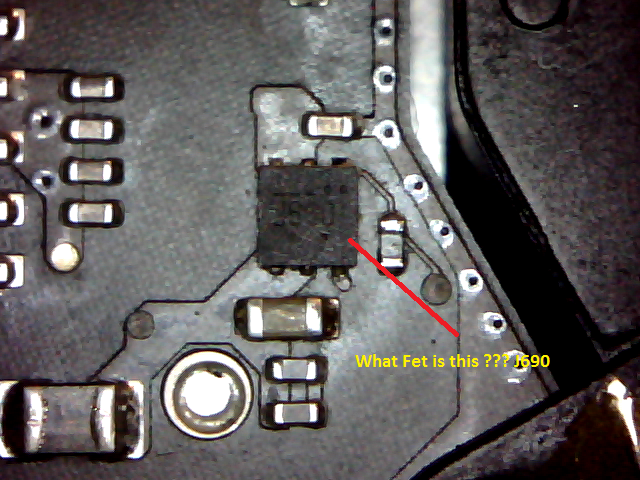

So Dadioh, I made resistance measurements, there are Mega Ohms between ground and two of the lvds pins. There are only those who are ground connected, that are on ground. pins: 1,10,13,16,19,22,25 and 28. Adiacent pins are not shorted so, I dont know where is the backlight enable pin. Lcd sw pin is not pressent. I found that there is a mosfet with 6 pins on the 2 pins lcd sw and I think there is the problem because in front of this mosfet, there are 3.3 v after it, there is nothing. I will show you on the photos.
So the last 3 pins are the backlight pins on the MBP15". You have soldered them together and taken that connection to where? If the traces were corroded away then you can find the Diode or one of the caps and take it to there. Are you getting the 27V out of the backlight driver circuit?

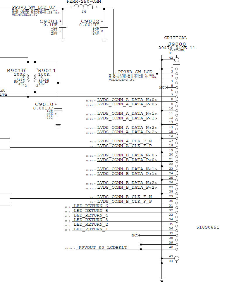

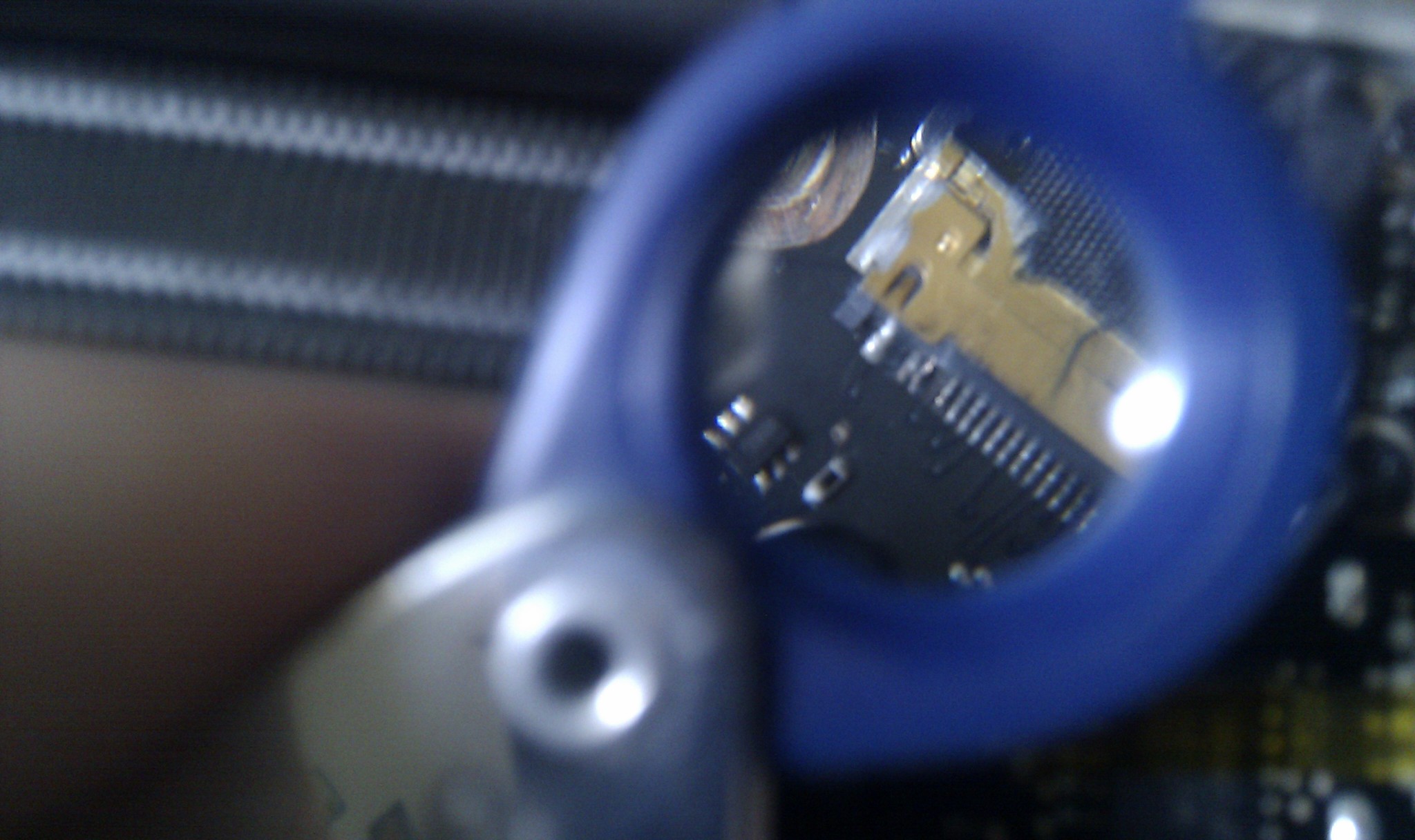

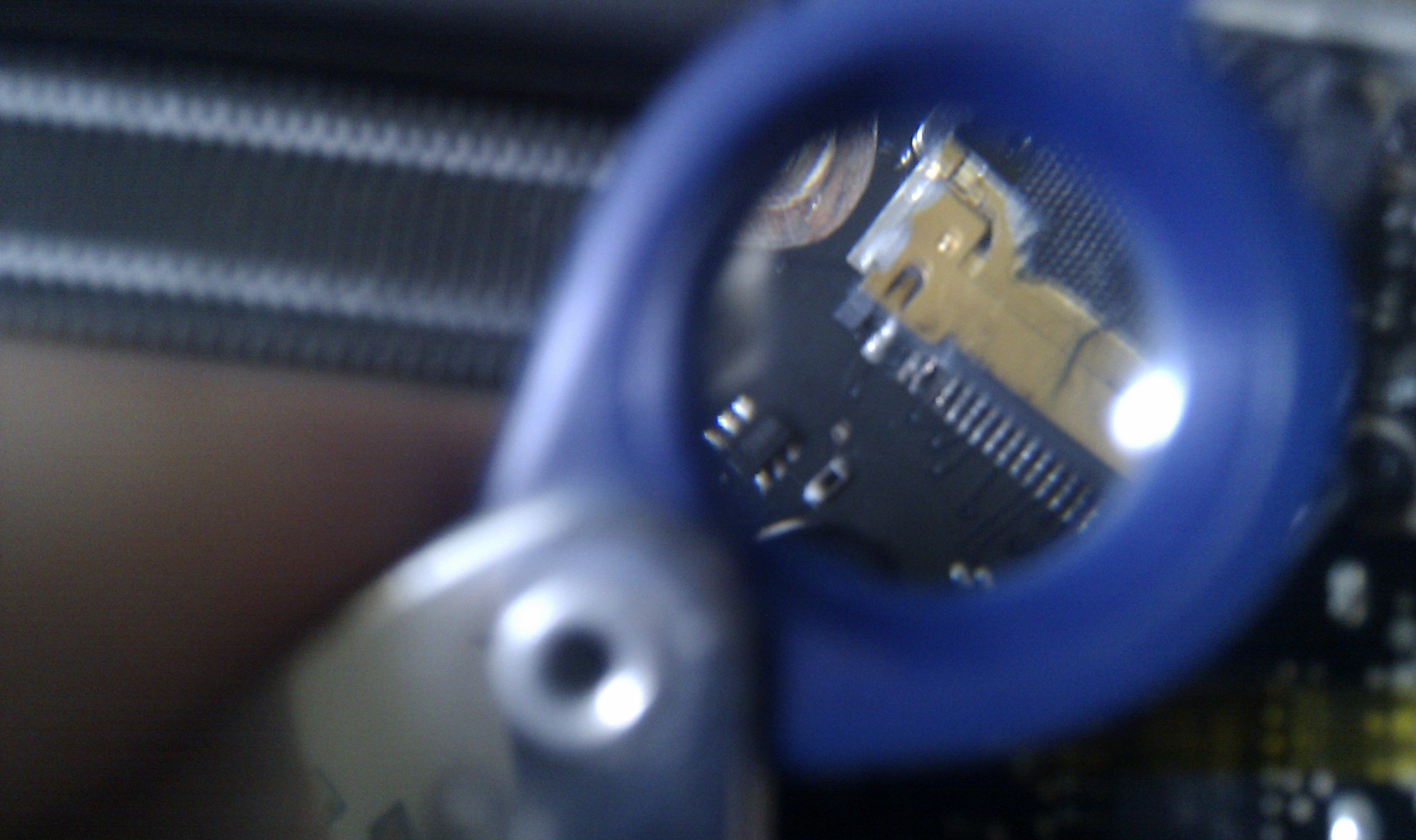

Completely new to Macs in general but bought an A1286 unibody macbook pro 15" off of ebay. It was said to have non functional backlight but the screen still works and I can connect it to an external monitor. Thought I'd give it a shot to repair.
I have done a quick inspection of the logic board and found that the LVDS connector looks like it's missing one of its legs (see poorly photographed image). I wonder if it's a crucial pin, if it isn't then I wont bother fixing that but if that's the cause of the backlight not functioning then I'll look into replacing the connector. Thanks in advance 🙂

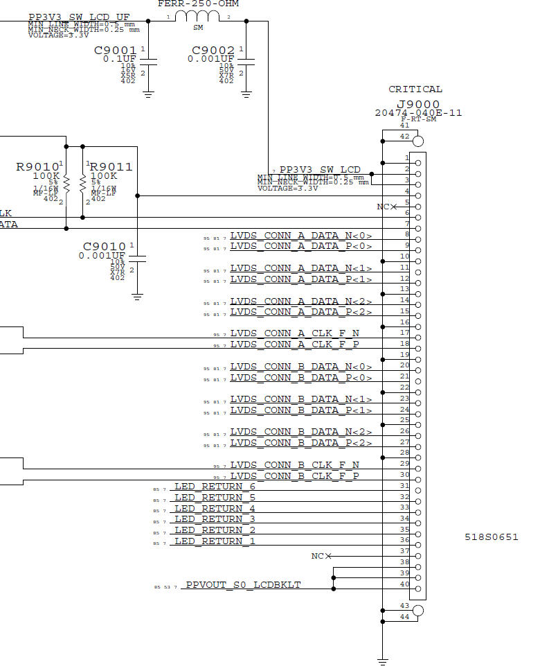

The last 3 pins are backlight voltage. The 4th one is a no connect. See attachment. However, if 2 of the pins are making contact I suspect you would still get a backlight. I would go ahead and repair that... best option is to replace the connector because the contacts inside the connector might also be messed up. Also, check the fuse. Location will be detailed in this thread.
Thanks for the response. I took it apart to check the fuse on the bottom but it seems like one of the previous owners already tried fixing that (got suspicious when I noticed multiple screws missing). What one he/she did was replace the fuse with a wire so there is a connection but no fuse. Guess that messed up some more things and he/she had enough of trying to repair it 😡
Not sure if I should still try to continue to fix it since I'm only assuming the "fix" by previous owner(s) messed up more than might be worth fixing. 🙁
If the problem persists with the fuse light it probably fried the backlighting circuit... But it sounds like a bent LDVS pin (mine burnt out 3 fuses before I realized it was a pin)
Check out all the pins on the female LDVS connector with high magnification and see if it might be the problem. But seeing as how the backlight is out with the fuse wire, you might be out of luck with a burnt out circuit...
