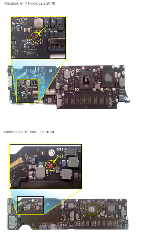

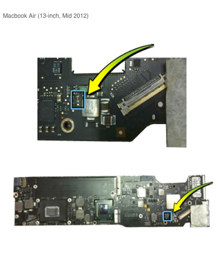

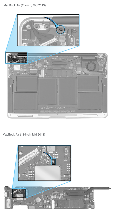

cont-
last post, i promise 😉

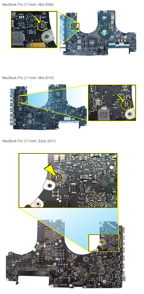

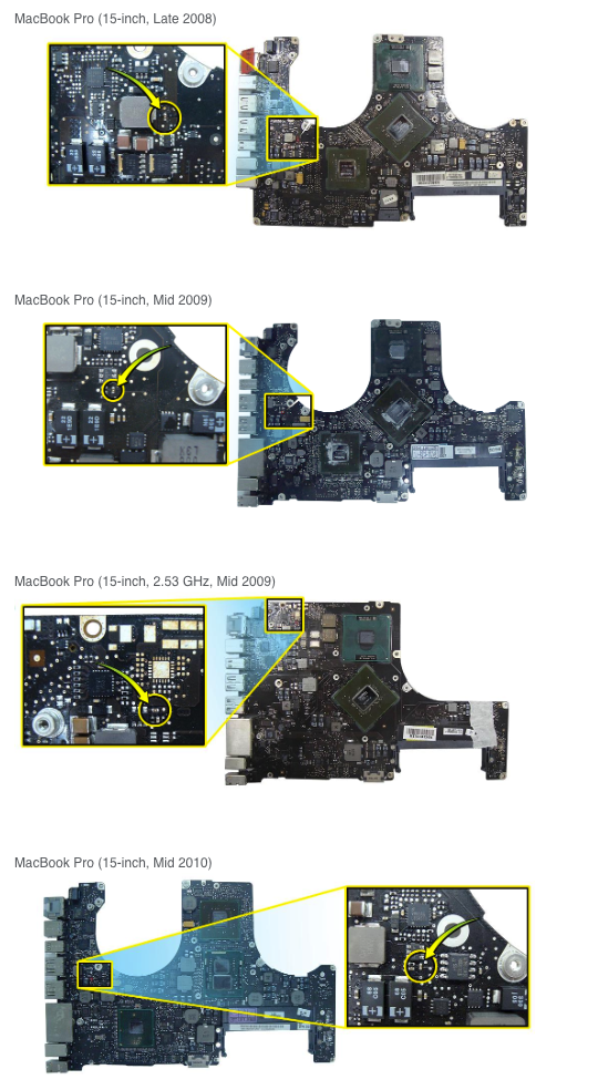

Hello guys.
I am very new to this forum, and also very new with mac. I just have it for 5 days ago. it is Mac Book Pro 17" mid 2009. My friend gave it to me, because he thought the screen is dead. but it's still work with external monitor. So, I think it is not the GPU, so I think I can still using it.
because I am very enjoying to repair my things so I think I will give it a go, though I am not know anything about Mac, well here it is, I found this thread. it's really helping me. thanks for the thread starter Dadioh.
so I just opened it and just found the fuse and it is blown. tested it. but my another problem is I can't order the fuse substitude or buying it online, I don't have much money, don't have credit card or similar to that. and I believe it is not in any electronic part store.
my question is.. is it possible to salvage from PC Motherboard? any one ever tried this?
because I knew if I just solder it without the fuse it is very bad idea.
or anyone have spare one, and willing to give it to me.
any kind of respond will be appreciated.
thanks all.

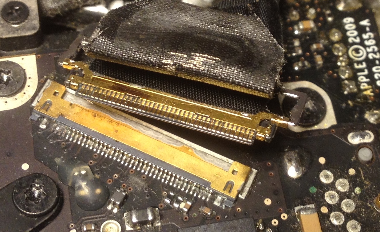

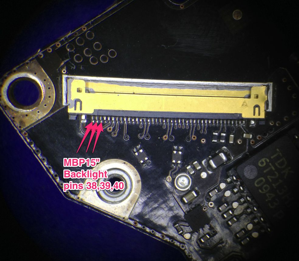

I have a mid-2010 15" MBP. The screen stopped working, so I opened it up and cleaned the LVDS connector, which looked pretty corroded in the top left (the side closest to the rear of the case). After cleaning and an SMC reset, the screen started working again without the backlight. An external monitor also works fine.
The pins indicated here are corroded away:
https://forums.macrumors.com/attachment.php?attachmentid=319982&d=1326598884
Here's the back side of my logic board:
http://i.imgur.com/UgGtiu2.jpg
I tested the fuse shown here and got continuity and 0 resistance:
https://forums.macrumors.com/attachment.php?attachmentid=489861&d=1410367544
My multimeter is nowhere fine enough to test pins on the L8545SQ chip.
What should I do next? Is there a way to test whether those corroded pins on the LVDS connector are the problem, and if so, can I replace the connector on the logic board? Or otherwise fix the traces or something?

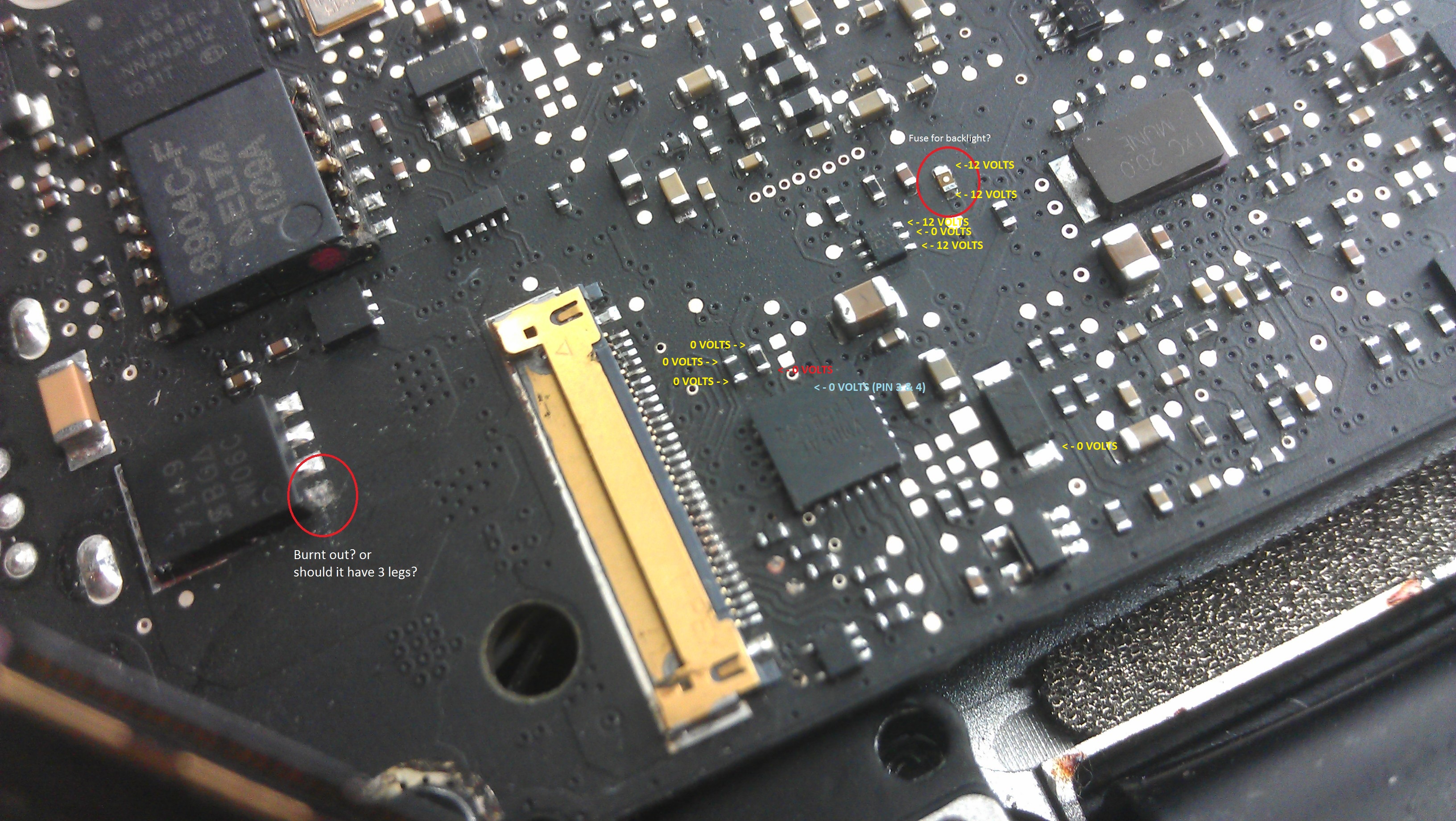

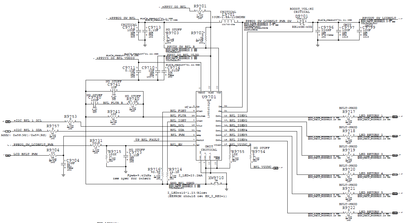

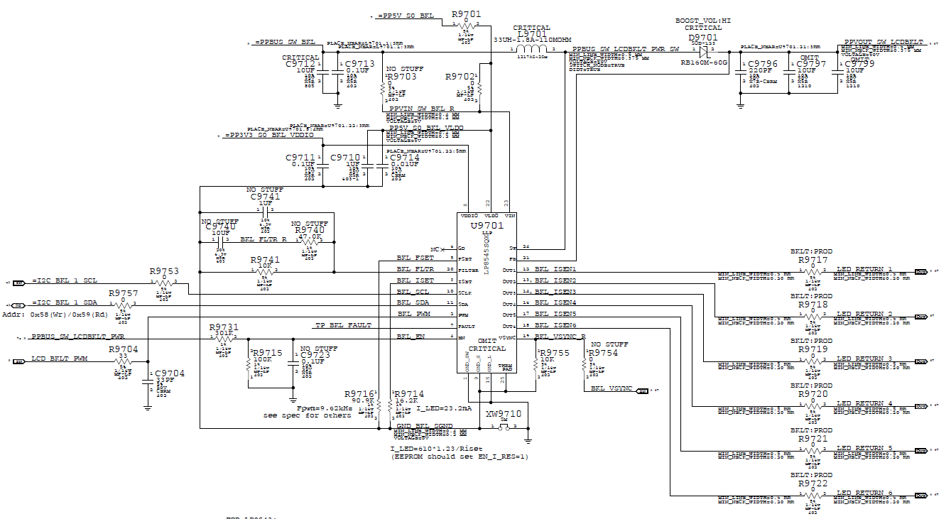

Dear Dadioh
Before anything thanks for your promts in this great forum.

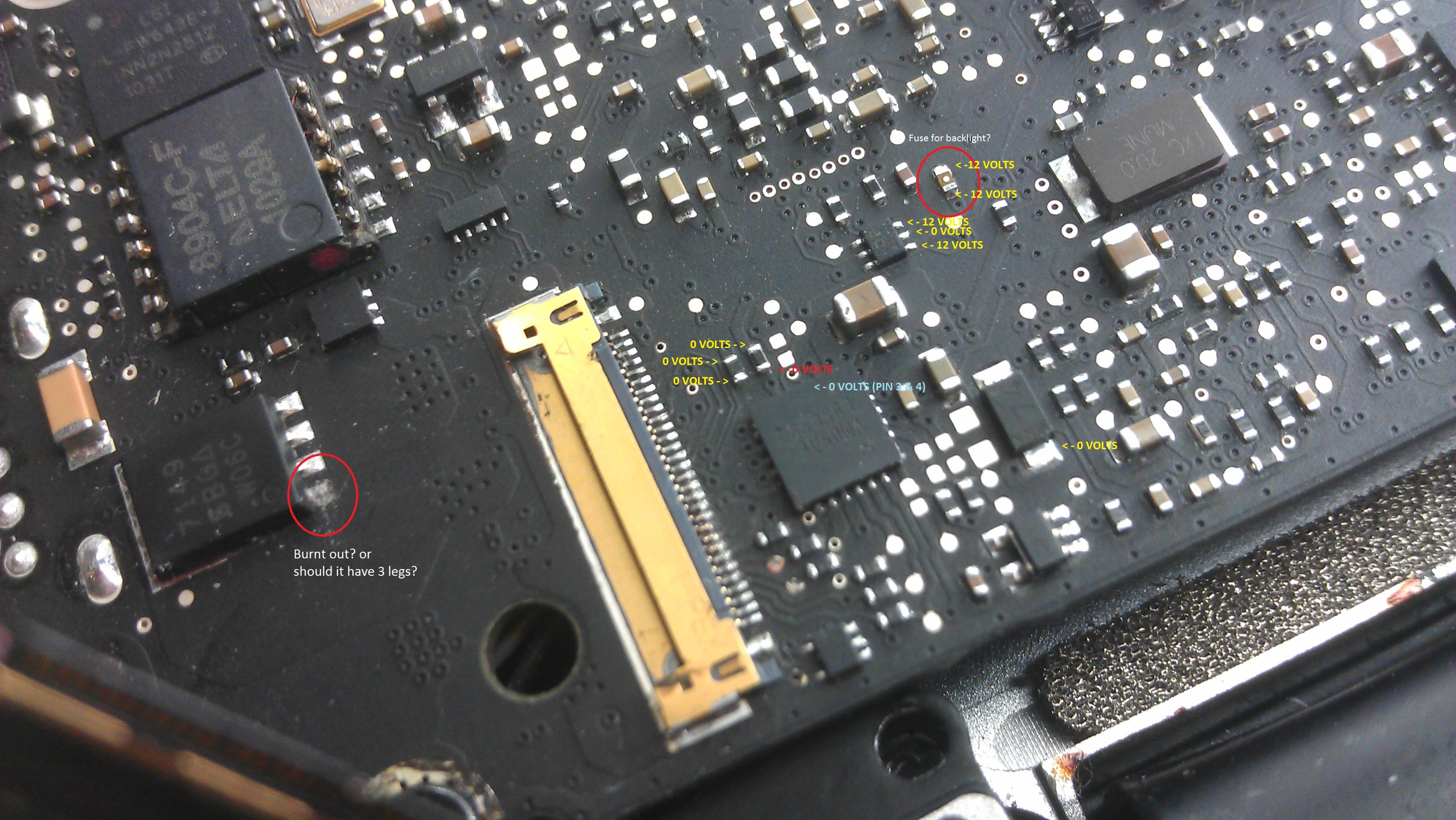

I Have a Mac A1278 backlight issue, yesterday I made some measures (see pic attached) and I've got too much 0 Volts measure points, could you please give me some information about what voltage should I have had in componentes arround Wled IC.
Where can I find the following componets in Logic Board:
R9731
R9715
R9704
I have this logic board (Macbook pro 13'' Mid 2009) and I can't find the resistentces that enable wled pin3, is it located in the other board face?
there is anyone that can help me to find this components.
Best regards
PO

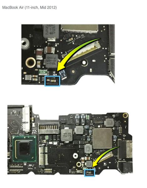

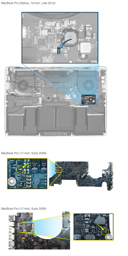

anyone knows 2012 15" MBP where fuse is located?
all works, except LED backlight - due to liquid spill. i cleaned the logic board.
i can boot into to system and see desktop with the flashlight method.
Those are exactly the right fuse characteristics. Different manufacturers use different colors. The "P" indicates 3A I believe. These will work.

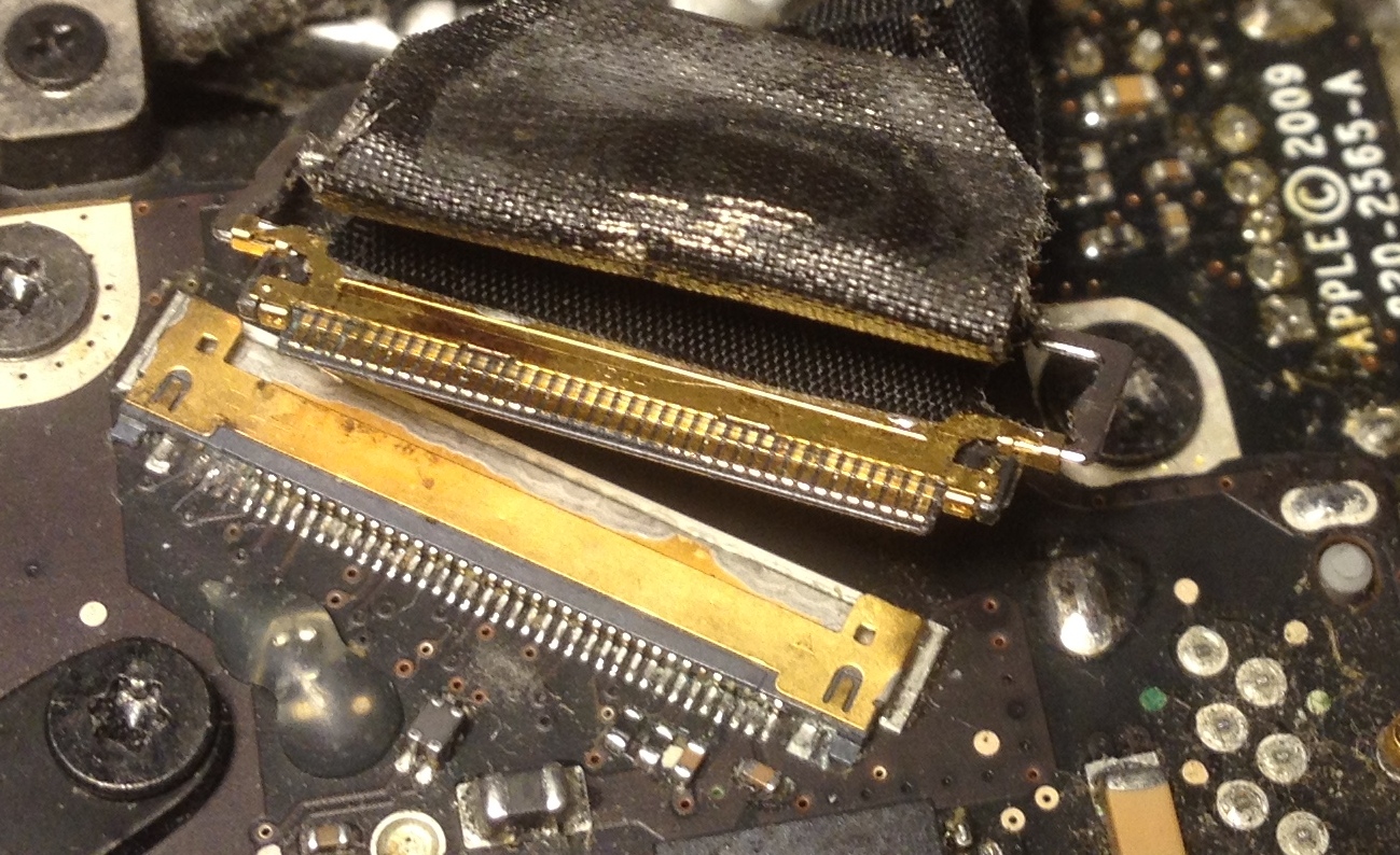

Here's my LVDS connector. The leftmost pins on the connector mounted on the board look corroded. I was able to get continuity between the 3 left pins (I think, it's really hard to target them with my probe). I also got 12V between any of those 3 pins and the ground to the left of the connector. Does this mean the WLED driver is working, if there's 12V there? But if there's 12V there, why aren't I getting a backlight?
Help!

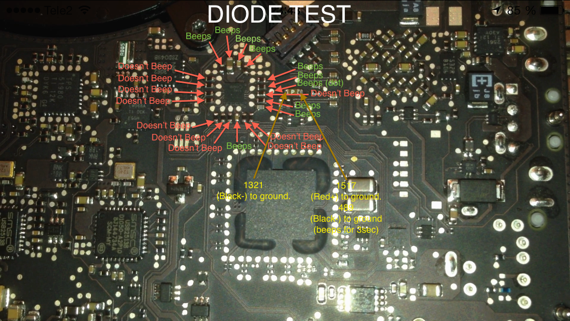

Is there any soul out there who could tell if my WLED driver has a permanent short and needs to be replaced?
My Logic Board:

As I mentioned earlier in my post, the fuse is blown. I replaced the old blown fuse with a new one and it got blown AGAIN since there is a short to ground, I assume. I can open the schematics 820-2915, page 88 (LP8550) but its impossible for me to understand any of that, maybe you could help me?
