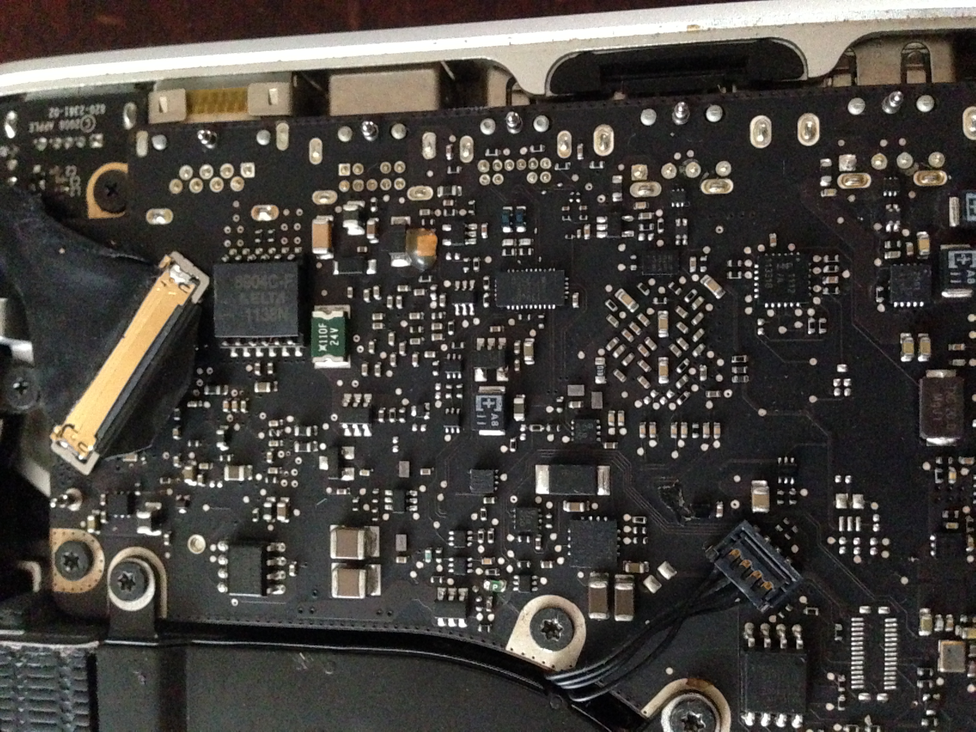

Have you checked underneath the wled chip for corrosion? You may need to reball or replace it...
Also check the inductor, capacitor nearby.. Is it clean??
The LCD connector pins on the board is clean?
under the wled i didn't check but today i clean the board again, same problem nothing changed connector is clean no problem there i didn't mention that the second time when i spilled water i didn't have the fuse, was just soldered

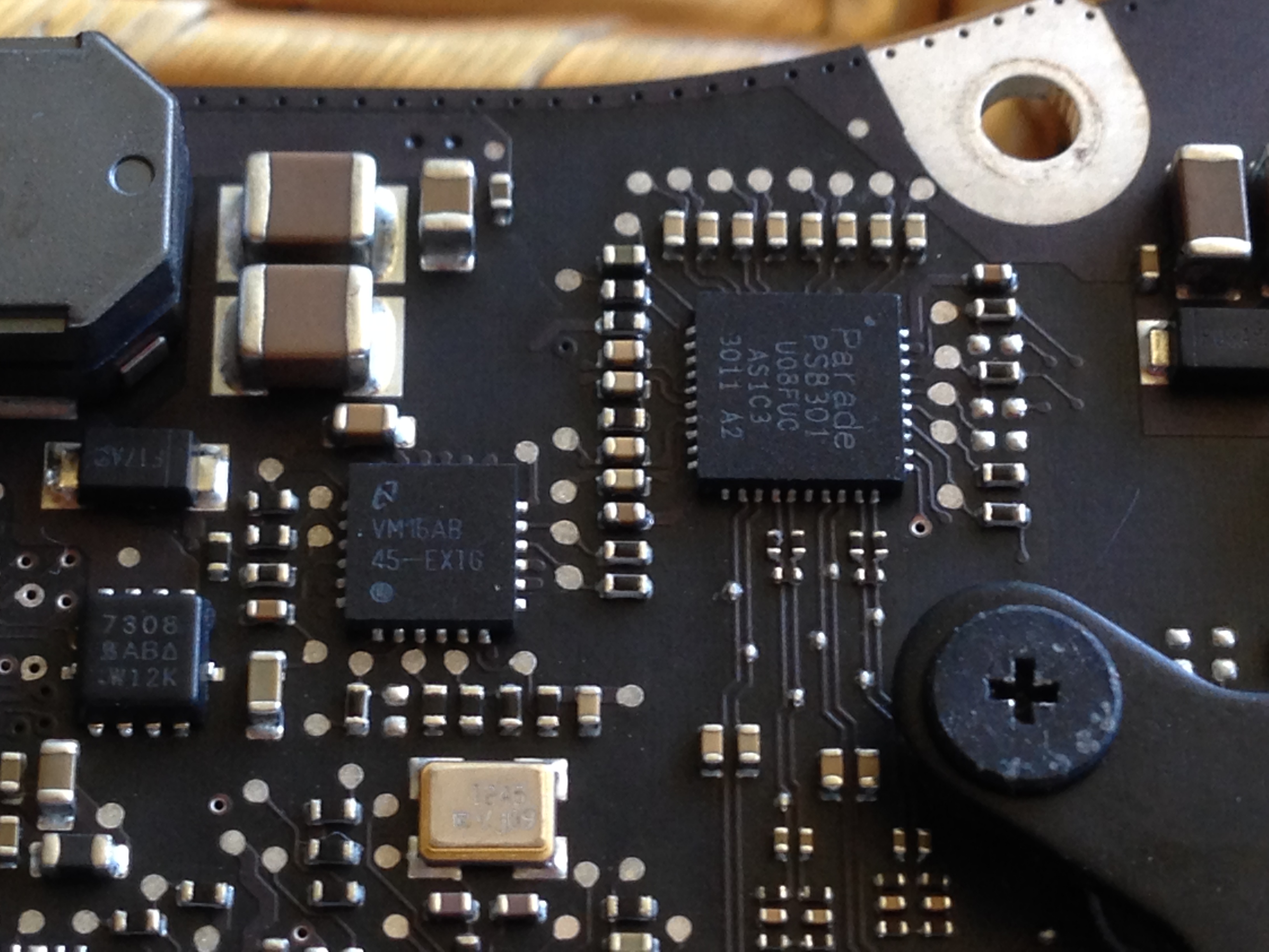

correct me if i'm wrong the wled driver on my board is VM16AB right? any other ideas? all capacitor they are clean no corrosion lvds conector clean wled clean. what should i do?

check schematics, these are fet's, youtube will show how to check, should not be shorted.
Also, your board looks clean, can you find any discolored white probe points?
I managed to open the board viewer and opened up my board, didn't know what you where talking about when you posted it before.
The voltage divider could be the problem, R9731 & R9715 also C9799 which is where the backlight output ends. Should I check these, diode mode?
should get 100 k ohm's at r9715, nothing should be shorted to ground at the cap's, look for discoloration on parts or board, that will give some hints.

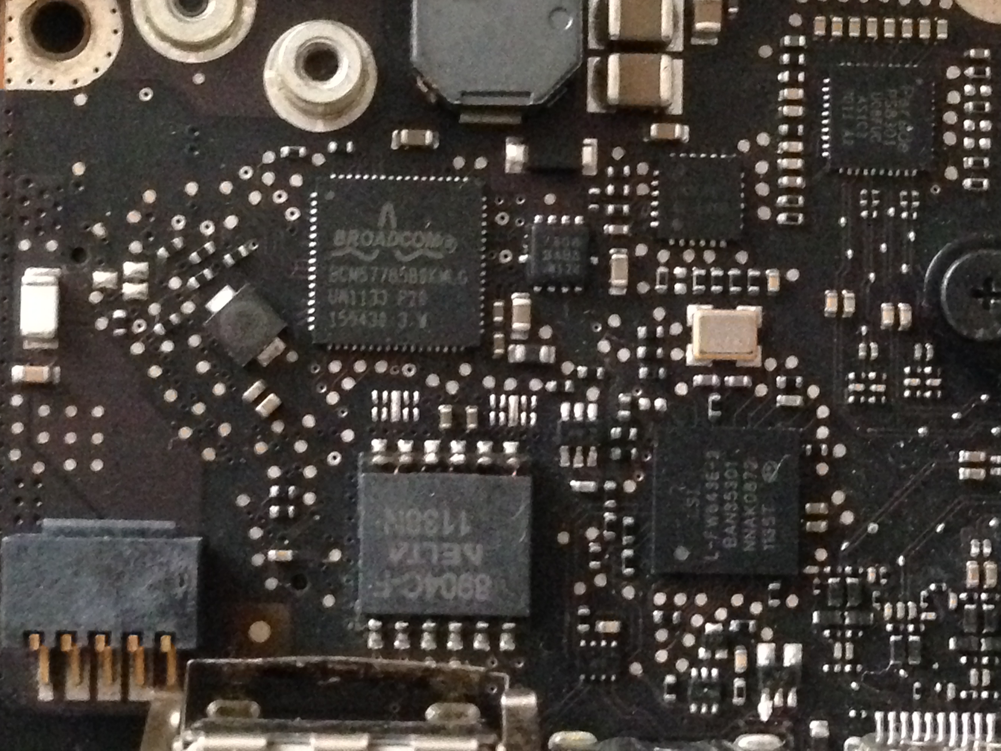

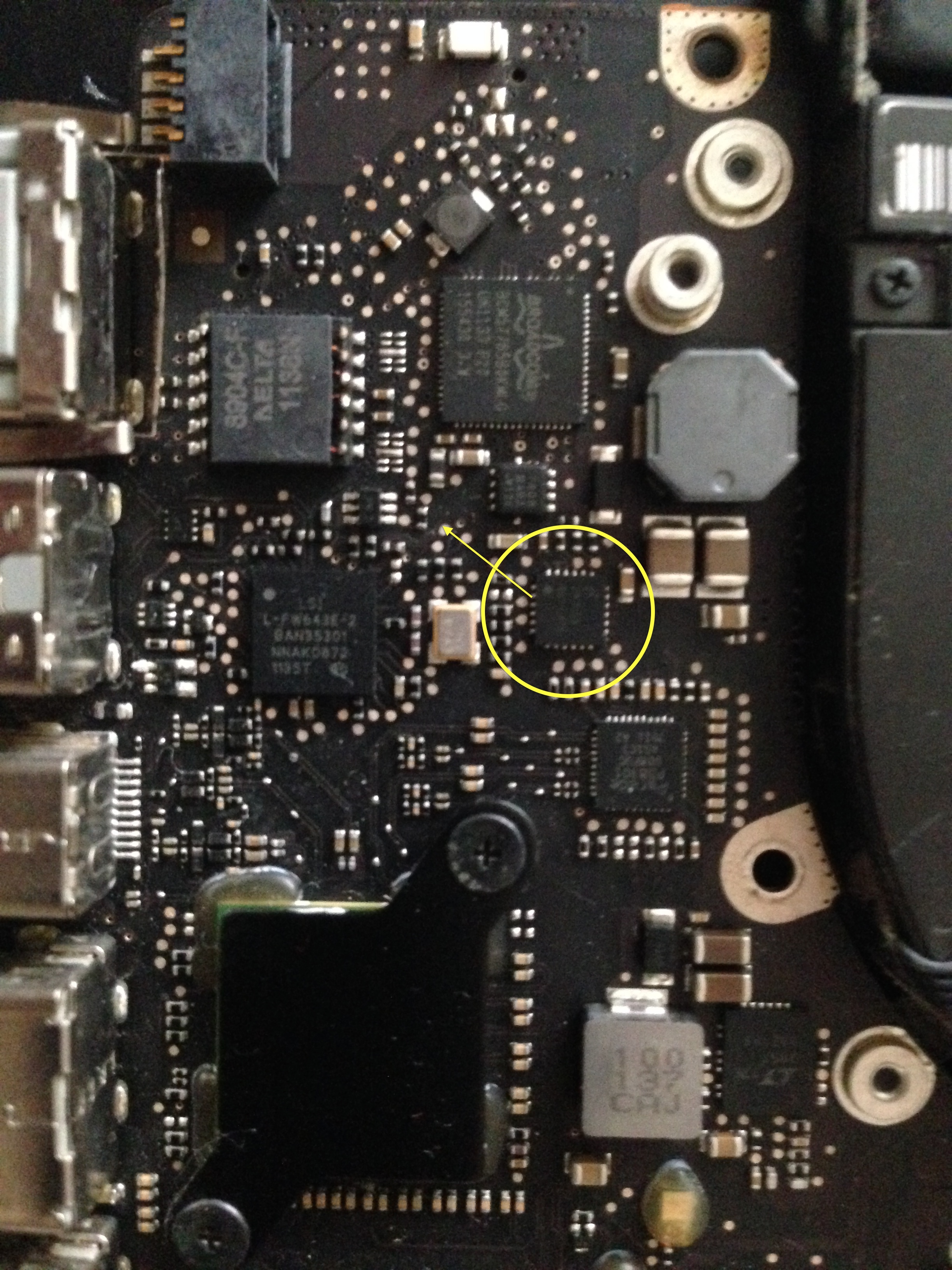

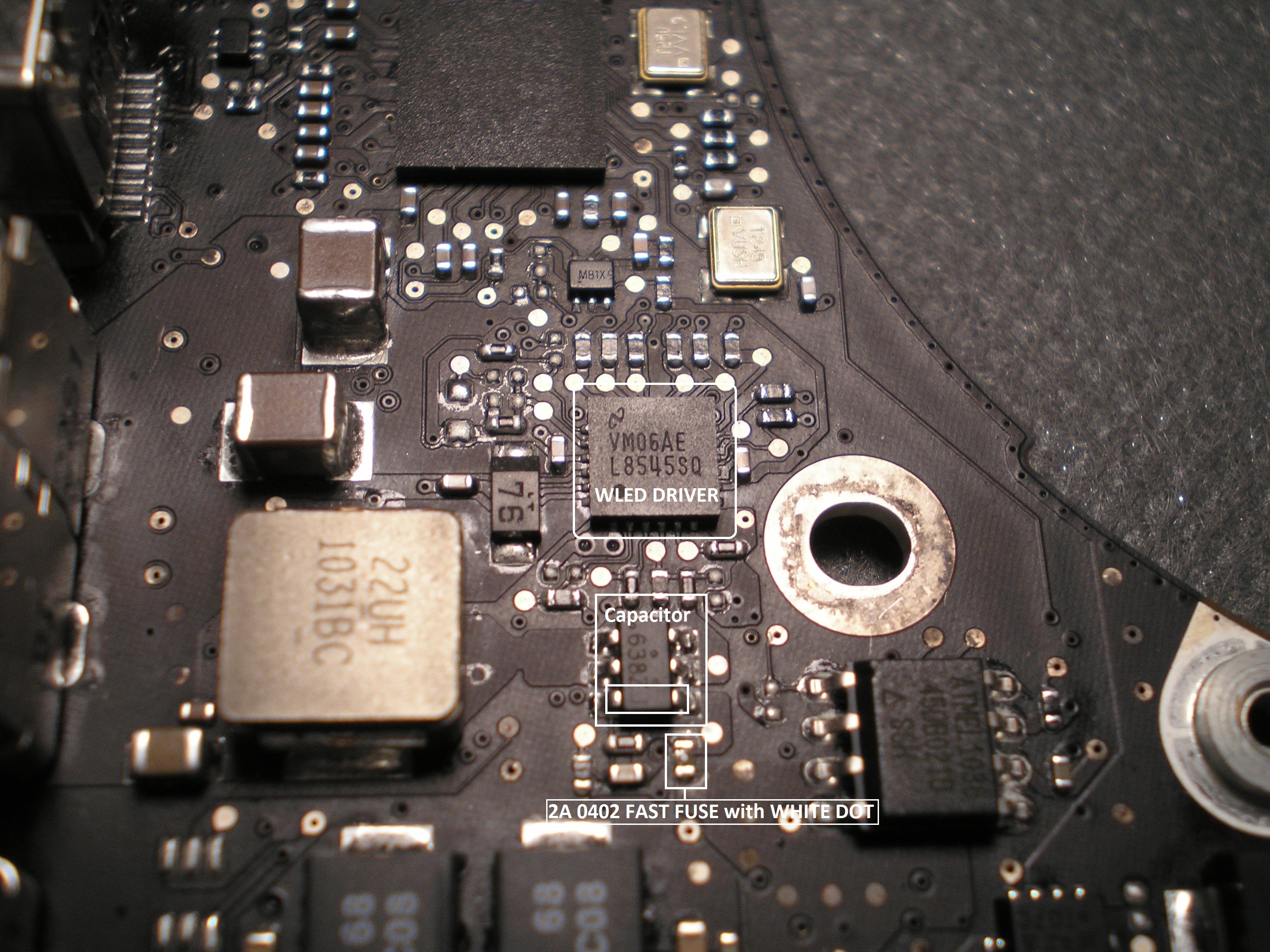

hello, i added a link to a picture of a little component that i need identified. ive done TONS of research and everyone is saying its 3 different things
here is the link
https://forums.macrumors.com/attachment.php?attachmentid=337480&d=1335496570
the one that is labeled capacitor in the picture is the one i need some sort of part # or something so i can order it and replace it. thanks for your help! 638z makes no sense and is not defined anywhere. i even asked digikey support and they were clueless thanks again!
here is the link
need board number 820-? on bottom small letters..

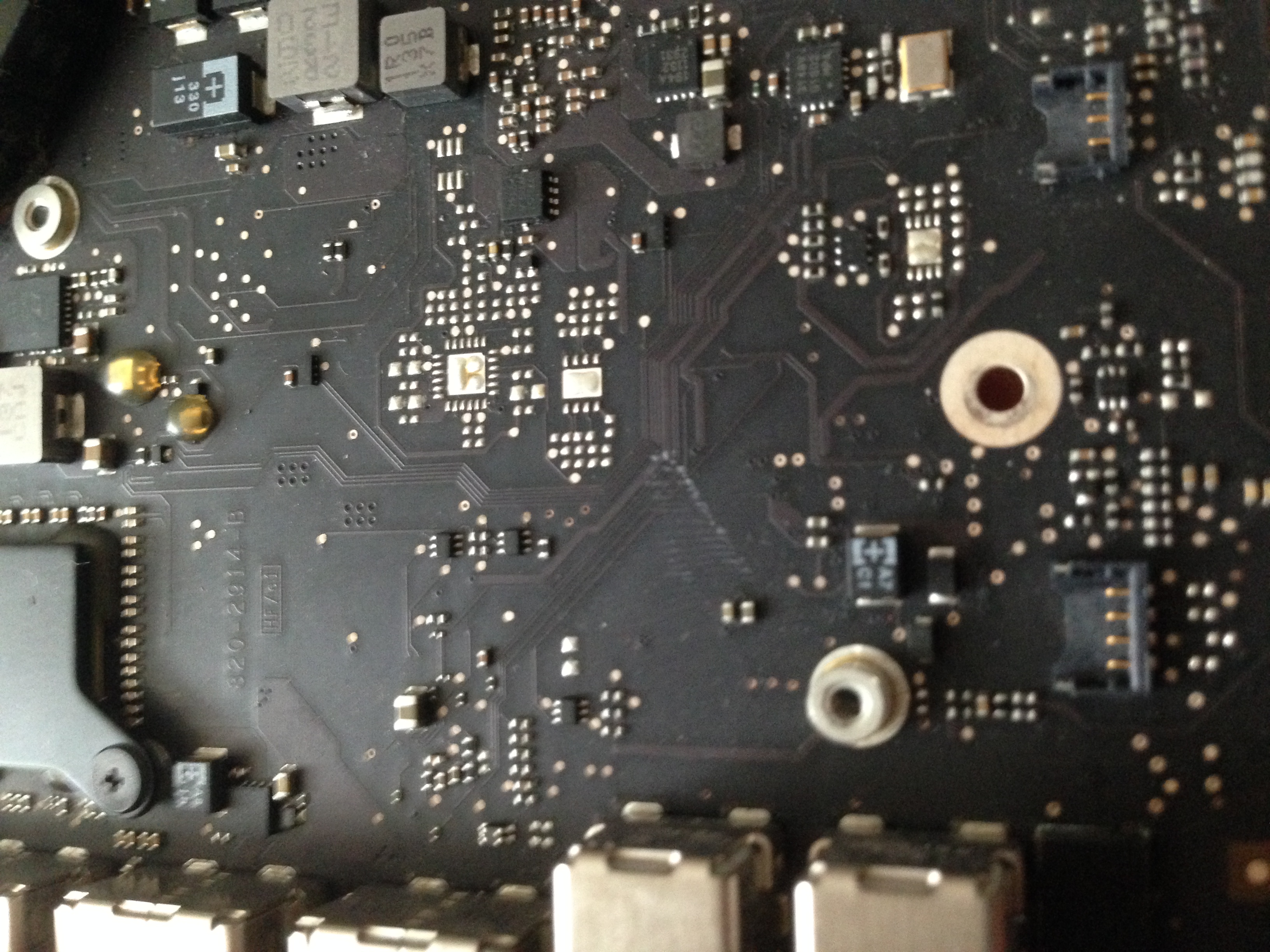

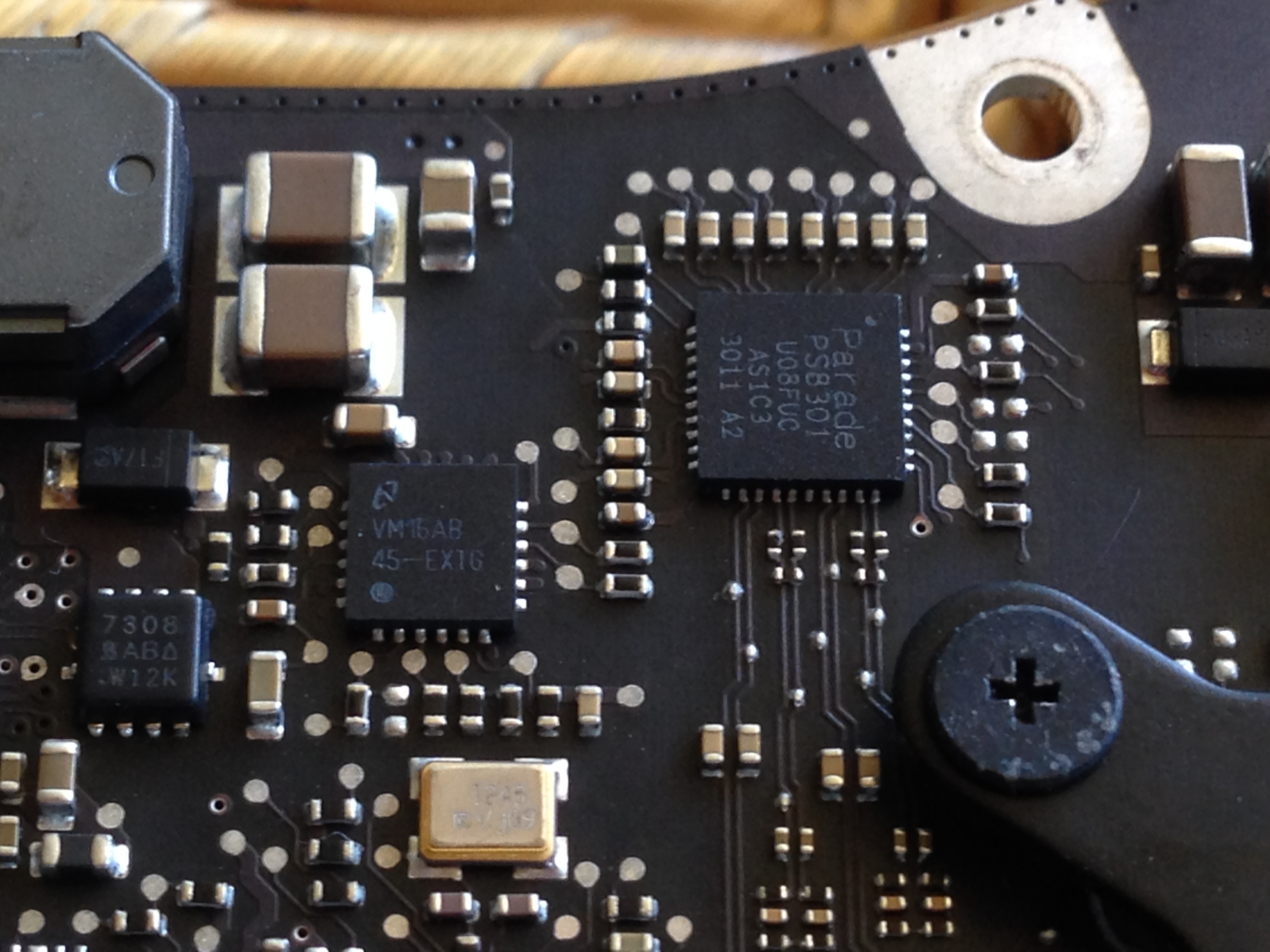

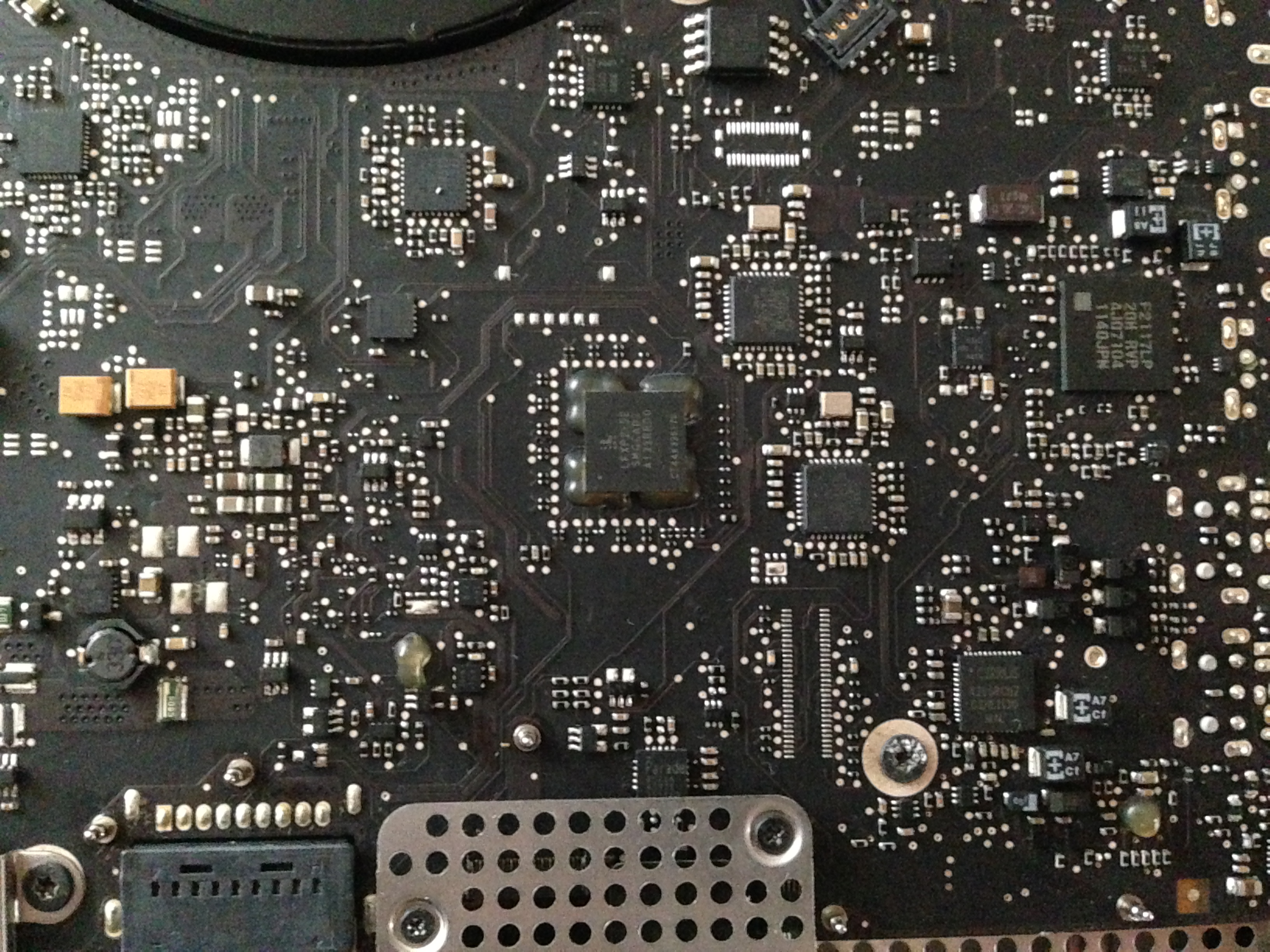

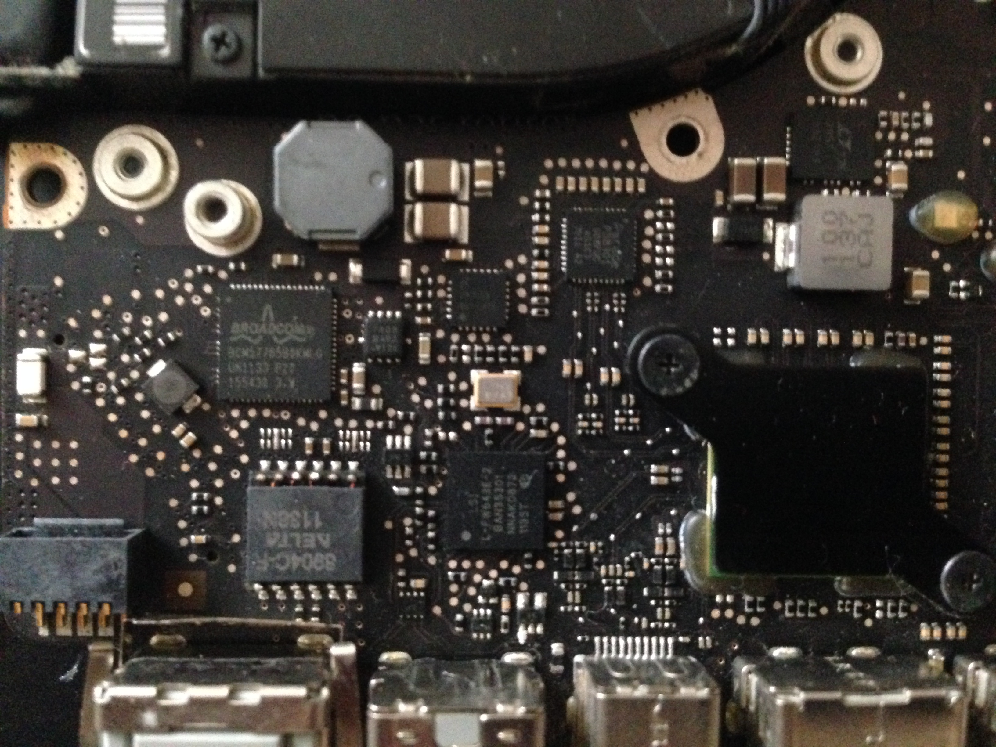

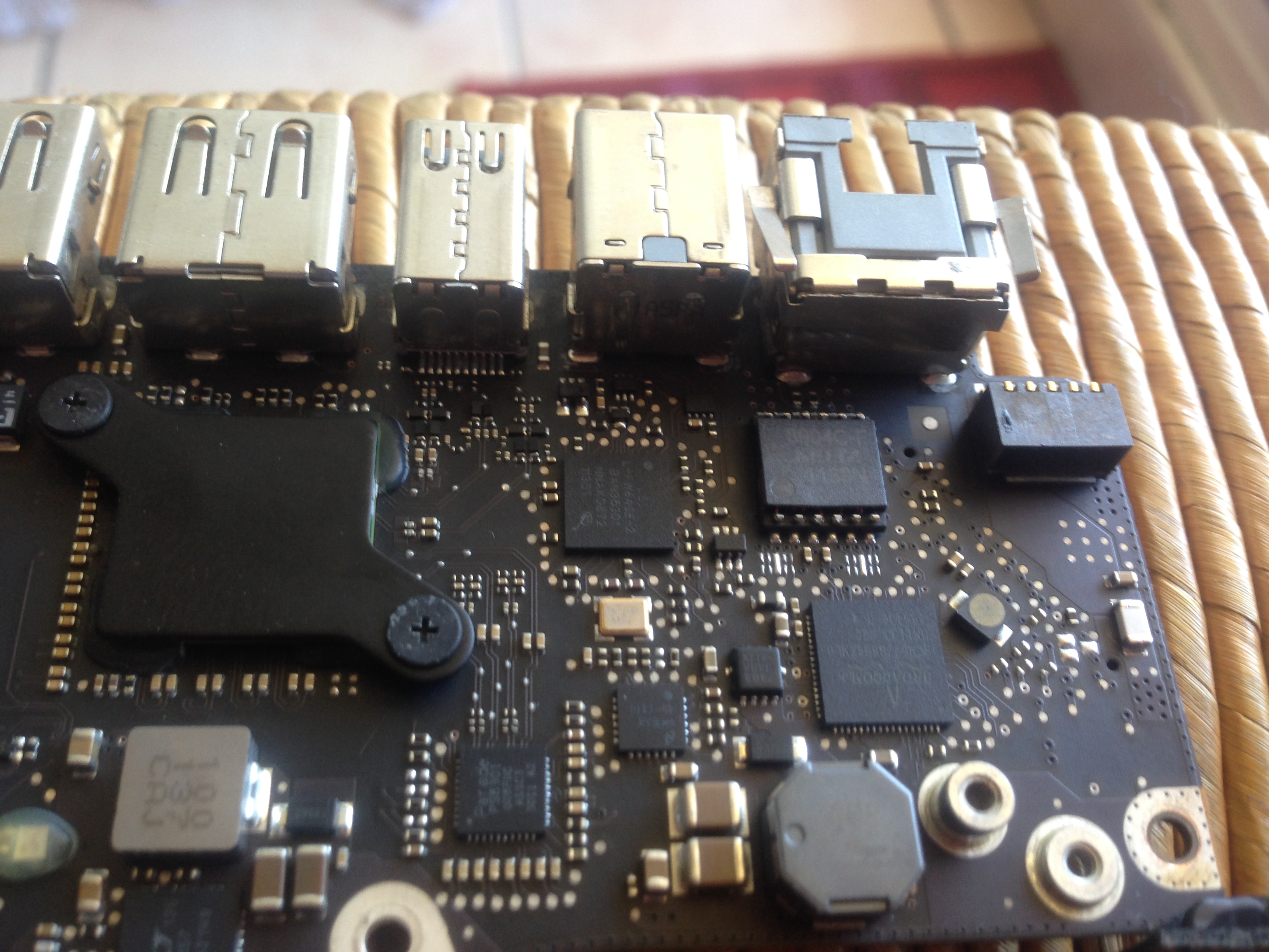

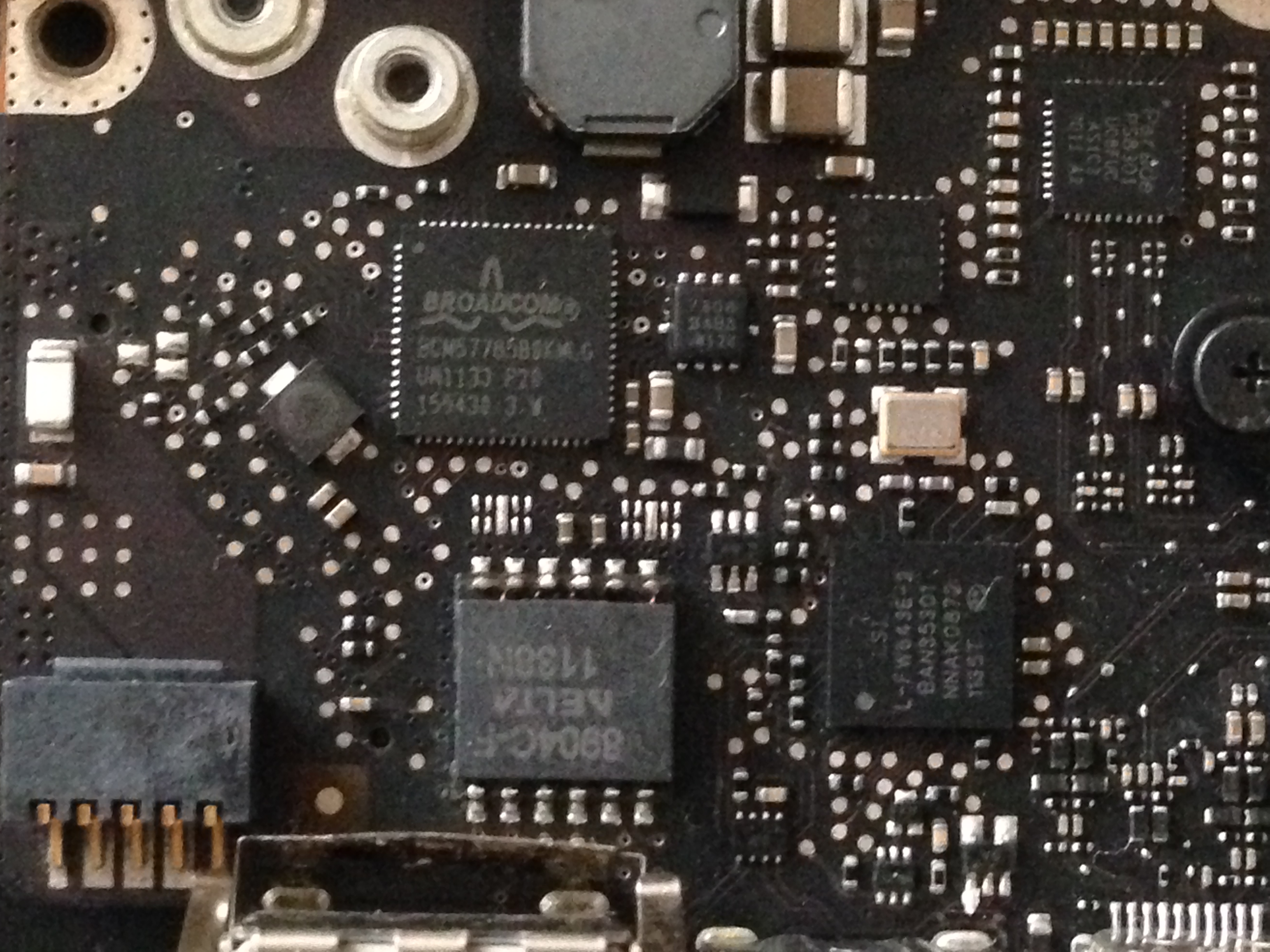

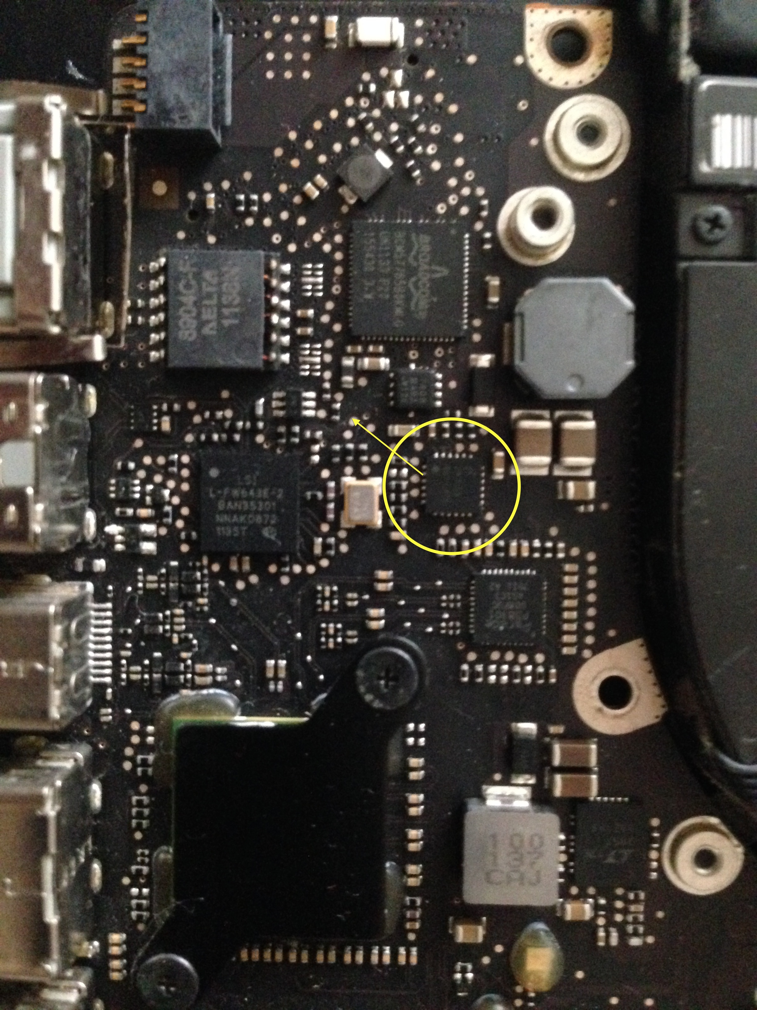

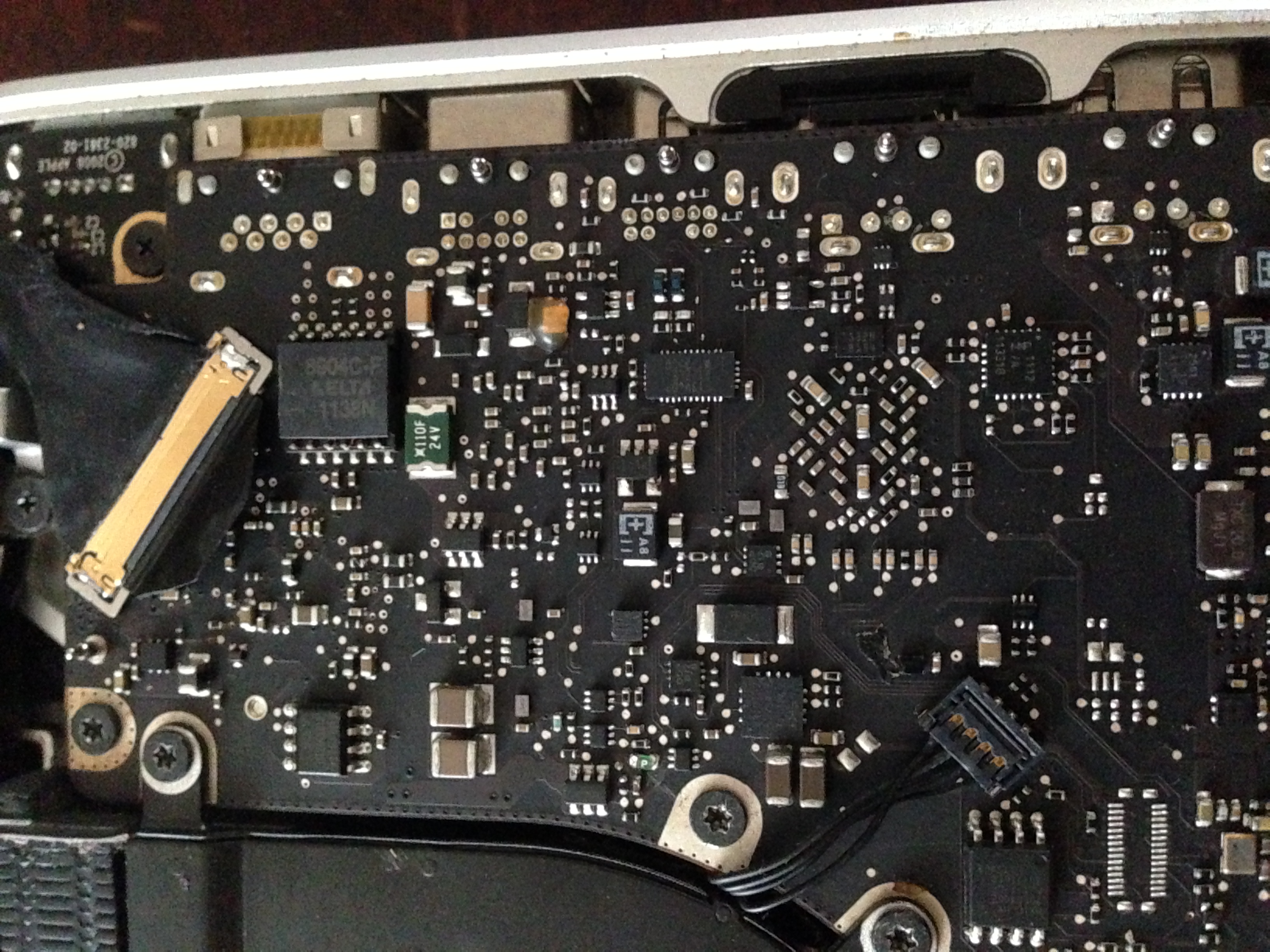

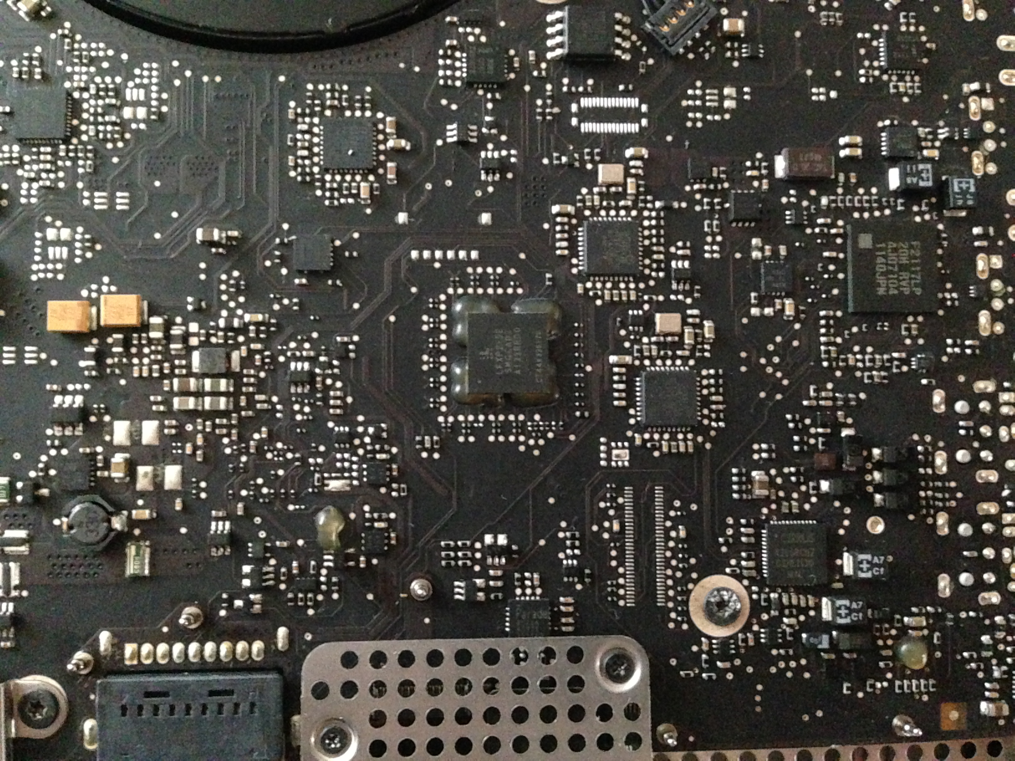

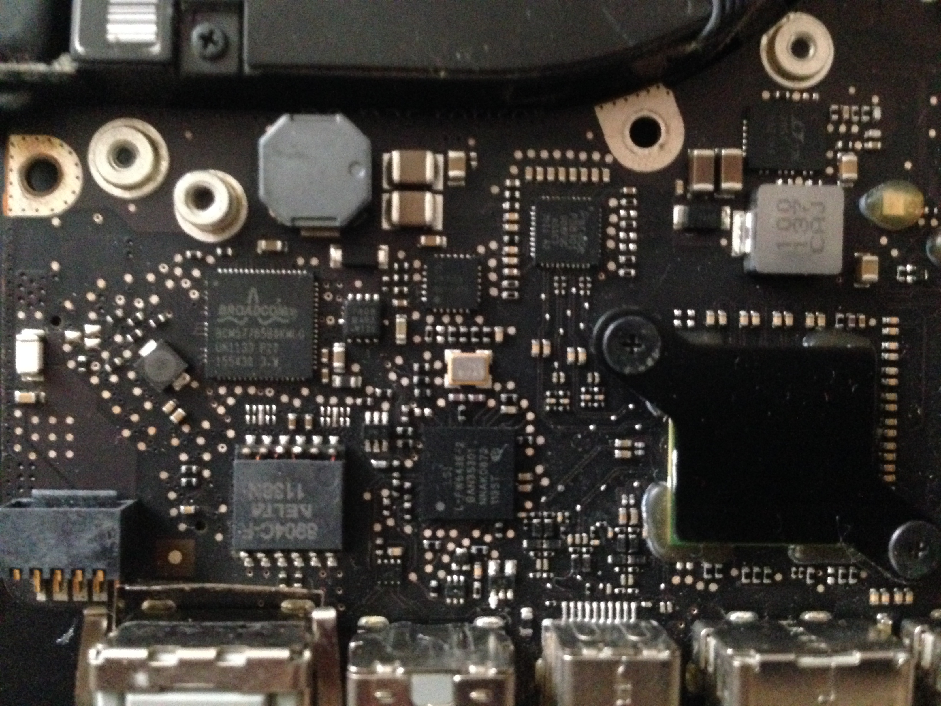

lets try a pic ...
here are the pics and where is the wled? is preston ps8301 or vm16AB?

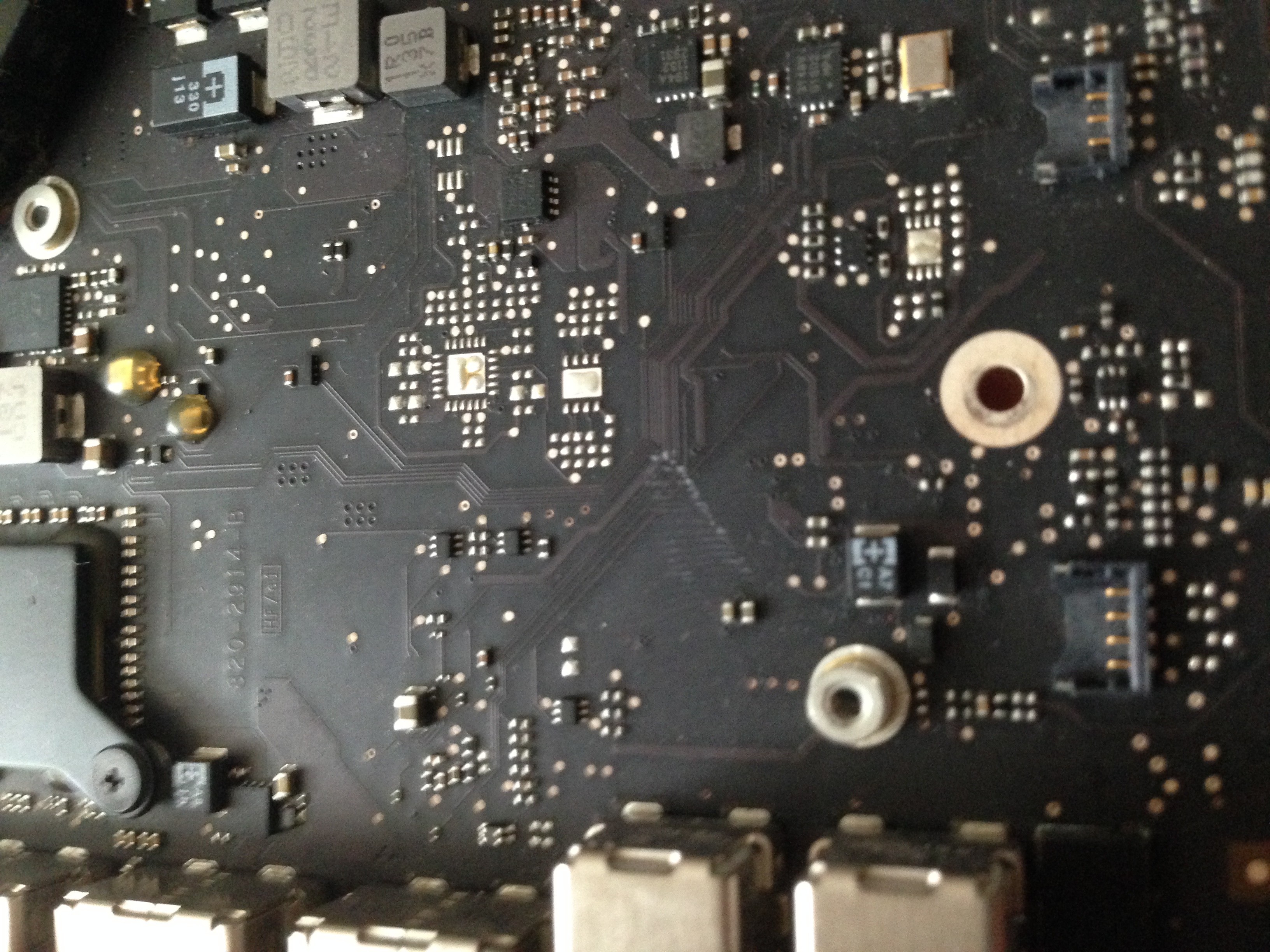

board number 820-2914-B, wled driver is lp8545 u9701. pin 2 is PWM for led. follow pin 2 and check resisters. Correct me if I'm wrong...
