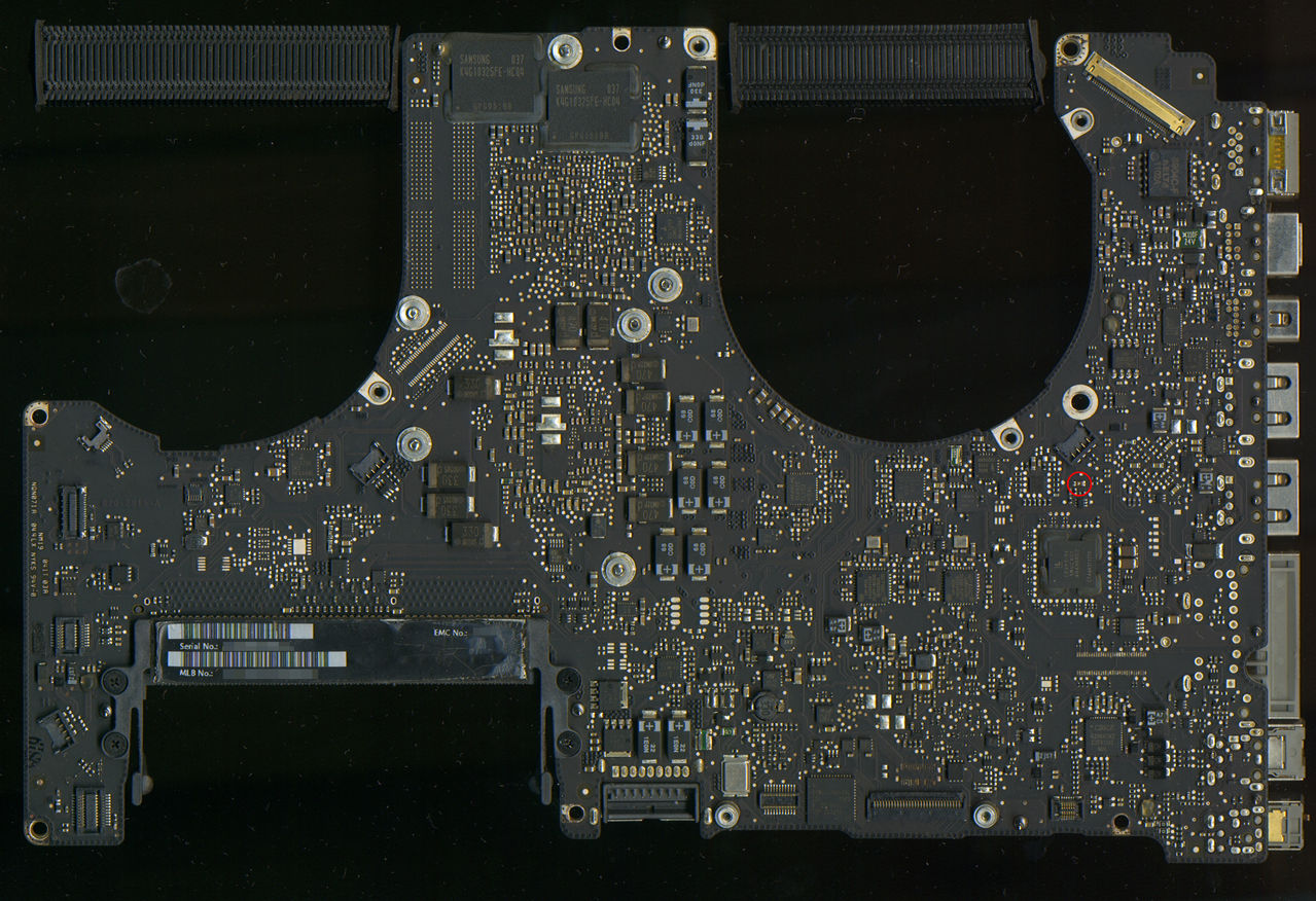

Hello everyone,
I have a Apple MacBook Pro 2.0GHz Intel Core i7 (15-inch DDR3) Early-2011 System.
Due to the famous misconception of this model, the ATI GPU Chip overheat thing (check this petition if you have heard of it ) . I had to reflow the logic board every three months for my board to display graphics correctly. I did it with an heatgun 5 times without any problems. But the last time I did it, I may have overheat the board with the heatgun. Now the computer start, the fan turns but I got the black screen of death (no backlight).

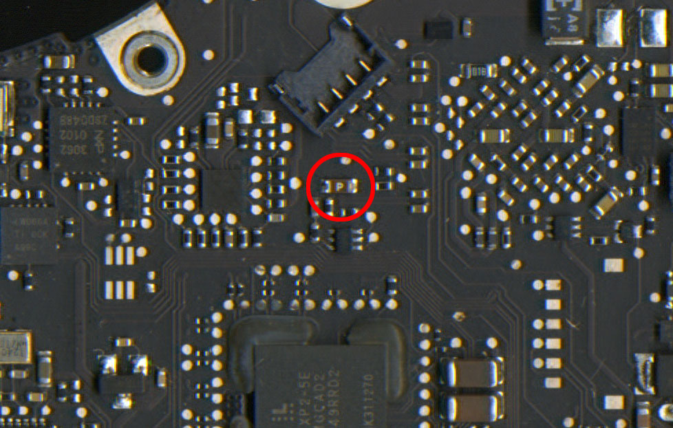

So I wonder if the fuse repair (or a capacitor repair) would fix it ?
I have scanned my mother board, and I found a component with a "P" on it (i circle the area in red on the pic).
I don't have a multimeter yet, is there a way to test if the fuze have failed ?
Does anybody know how to check if it's the WLED driver ?
Where can I buy an replacement "fuze" / driver ?
And which parameter to choose for the multimeter ?
Thanks for the help,
Kiss from France
