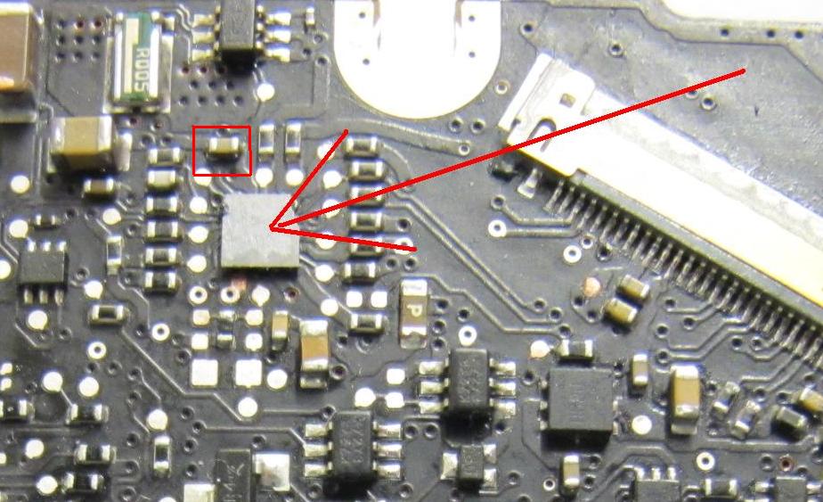

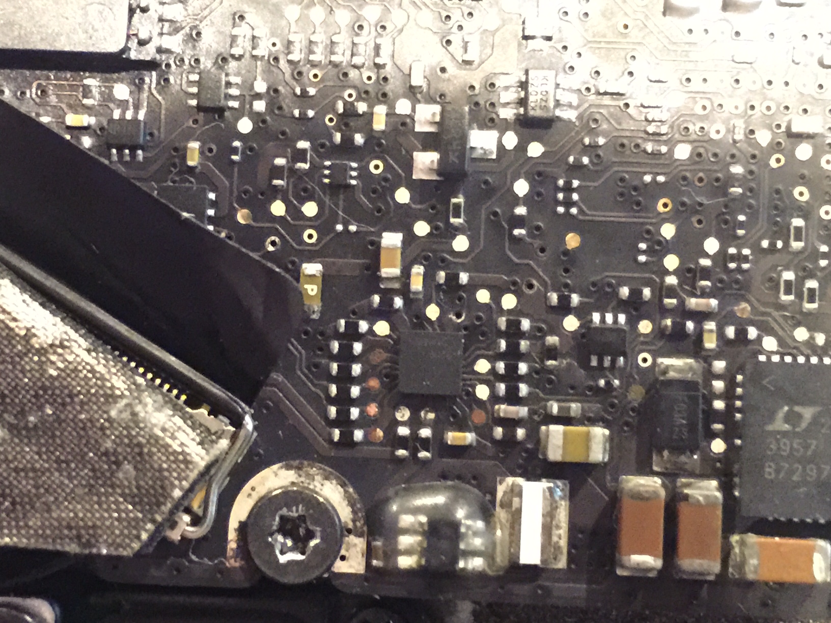

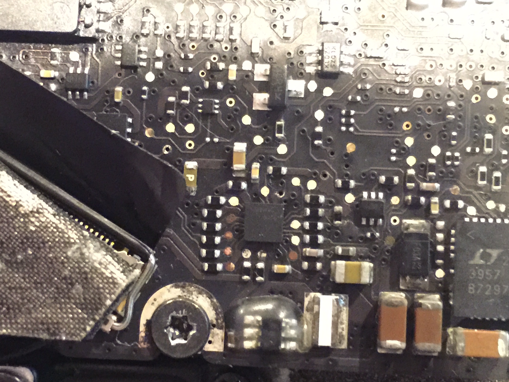

Hi Louis,
Thanks alot for the reply..
The model no of the board is 820-3332-A

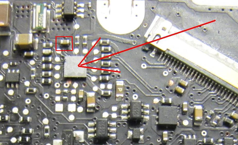

I have attached an image of the the chips around the wled driver chip and the chip itself. I'm not sure if this is the area i should be looking at.
The only problem i have is a condition that doesn't really lend to steady hands like i use to have and micro soldering wasn't a problem. My brain still love this sort of investigation but parts of my body are no longer capable.
If i need to check the WLED driver chip i will need to find someone in the UK to try and fix this for me as its now beyond my capability unfortunately...
Does anyone know of a really good technician that could possible repair this for me, i have replaced the complete top of the macbook rather than attempt to replace just the screen. I could take it into Apple and ask them but they will probably just replace the whole logic board for £600.
There have never been any liquid near this laptop ever, so hopefully it has a better chance to be repaired...

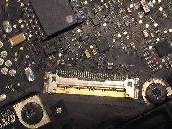

I have a A1370, 820-3024-b MBA with no backlight, firstly I changed the blown fuse and now I'm getting 8v either side, but still no BKLT. I've done some measuring and I've noticed that the Q9706 MOSFET isn't giving out any voltage. Pin 3,4 (in) 8v pin 1,2,5,6 0v. With the Q9706 removed I am getting gnd on the output pins so I'm thinking of changing the LP8550 but before I do, I have a question: The input to q9706 pin 3,4 is 8v, but I'm not getting any output from 1,2,5,6. which in turn sends power to the LP8550. Do you think it could be the Q9706 is at fault?

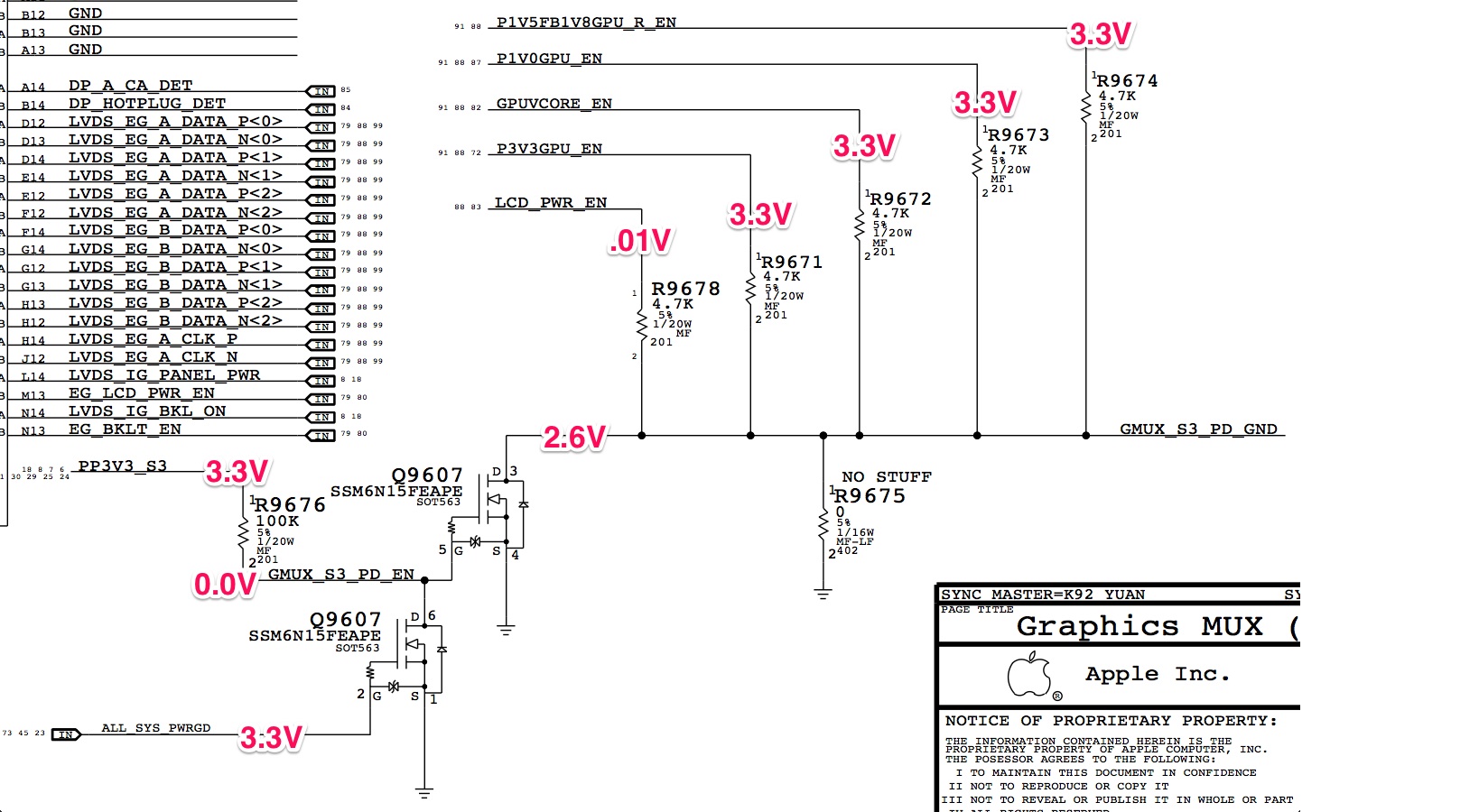

What are these voltage readings telling me about this circuit?

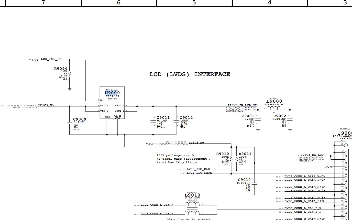

I am backtracking no PPV3_SW_LCD on an 820-2914 board with no video or LCD enable after an LVDS connector, LVDS cable replacement and backlight fuse replacement due to liquid spill.
R9678 and R9676 read 4.7K and 100K respectively.
Any thoughts appreciated.
https://forums.macrumors.com/attachment.php?attachmentid=461410&stc=1&d=1392675210
So now I'm trying to figure out how and when U9600 GMUX generates LCD_PWR_EN.

Thanks for your reply. I originally thought U9000 might be bad because of that .12V i was seeing on pin 1. I have the 3.3V on pins 2 and 3. When I removed U9000 pin 1 was still at .12V.
It looks like that U9000 pin one enable voltage originally comes from U9600 GMUX as an output from U9600 PB19B.
Where I am right now is trying to figure out what U9600 wants to see to turn on the LCD power enable voltage that ends up at U9000 pin 1.
As an overview, after replacing the LVDS connector, LVDS cable and backlight fuse there is no PP3V3_SW_LCD to the lcd.

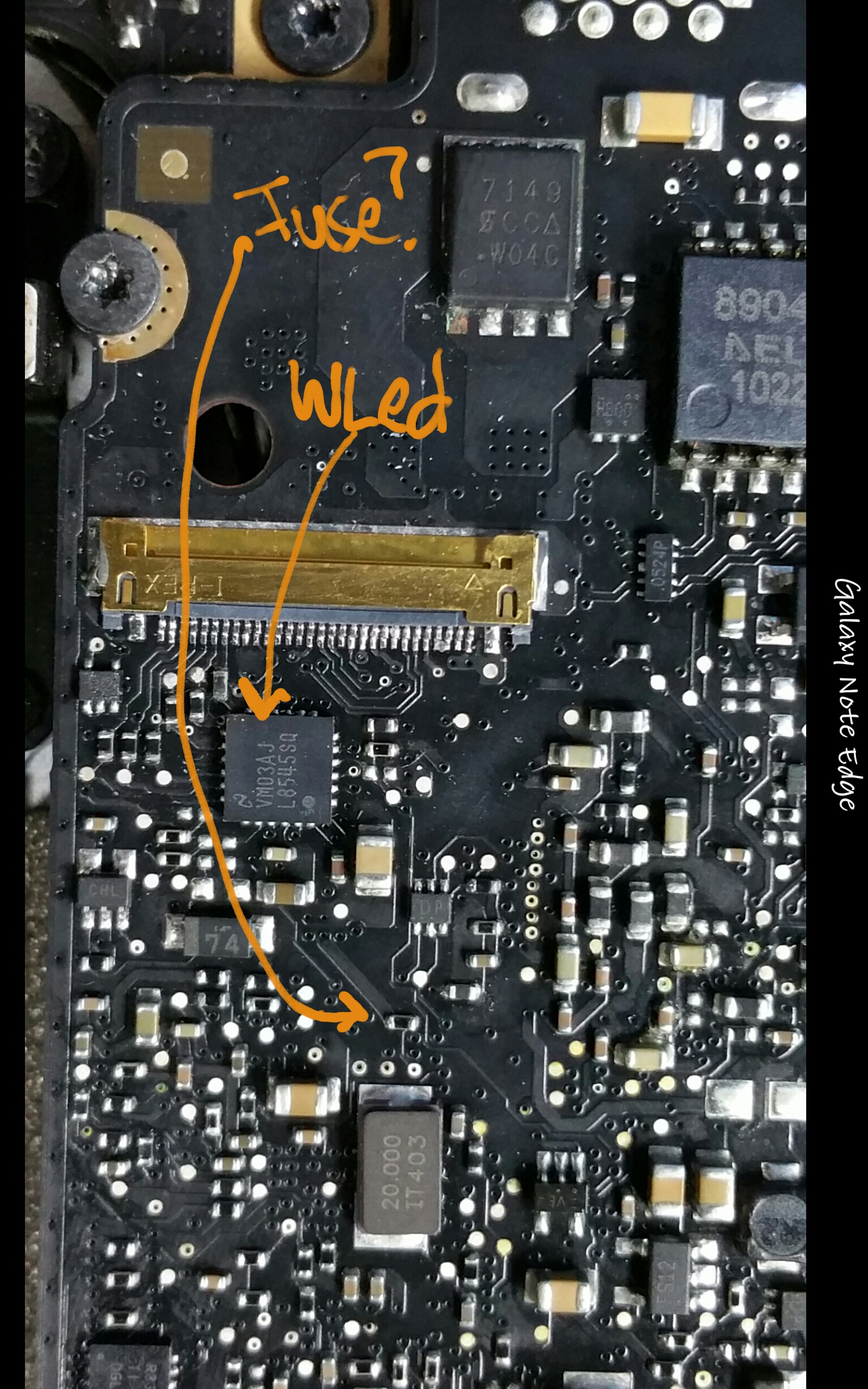

Model not sure but it's a mac book pro 13" 2010
issue video but no backlight
where is the fuse located. My searches found similar pic but the fuse doesn't look the same. Where is it located?

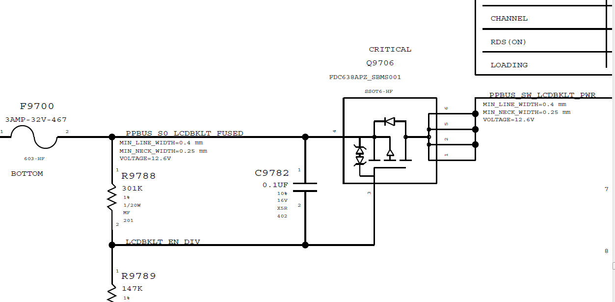

You say that your not getting a bleep from the multimeter so the fuse is blown.
Check for a short on the track. Put you multimeter in diode mode and put you red probe on ground and black probe on both sides of the fuse. Tell me what you get.
Hello Rickkap! It decrease in 0.5V, in one side of the fuse, my multimeter shows 0.4823V and 0.9672V in the other side.
Thank you so much for your time! 🙂
Ok so you don't have a short but with you saying you don't get any bleep then change the fuse and see how you get on.

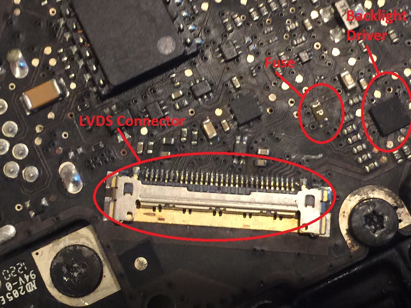

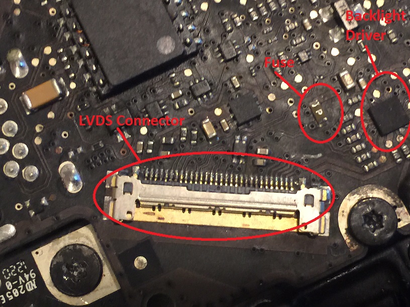

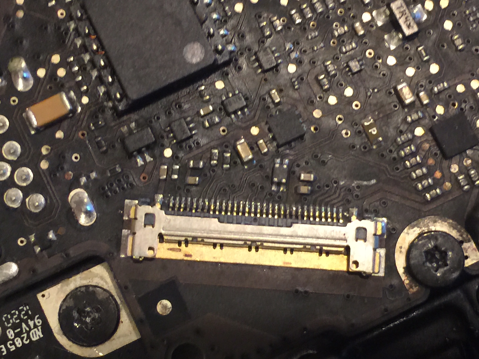

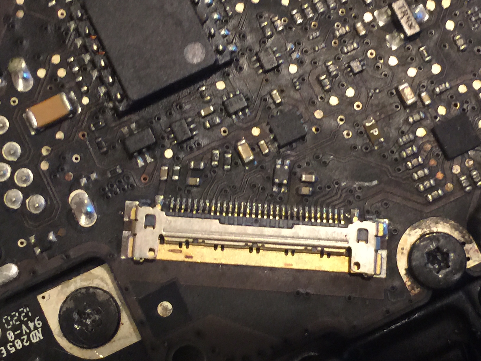

13" Macbook Pro early 2012 A1278 Backlight
This thread is the best I've seen by far. please take a look at the photos I have. where there should be white dots around the chip I have black. There was a small liquid spill. The Screen works (based on flashlight) but the backlight is out. Also the keyboard backlight works, but has obvious hotspots (brighter).. Would this mean I need to replace the chip?
Thanks for the help everyone!!!
Start by checking if the fuse is blown. That is the yellow device with the "P" on top. If it is not zero ohms then replace it with another 3A fuse.
Keyboard backlight is often uneven after liquid spill. You can find new backlights on eBay fairly cheap so just replace it.

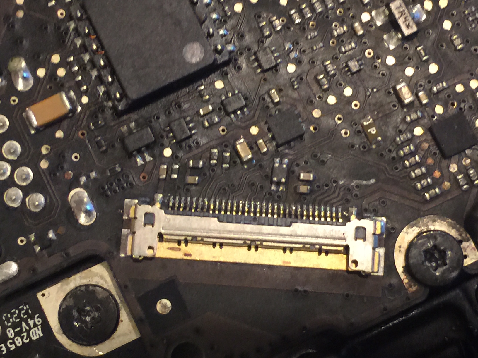

Thank you so much and I'm sorry for the late response. I finally got around to test. The P fuse comes back to 0 which makes me think it's fine. If you look at the first picture there is a row of small fuses that all tested 0 except for the top (6th from the bottom) it's measuring like a 607. Is this a blown fuse? Maybe the culprit?
Dude - There's only one fuse on the board with is labelled with a P on it. The components on the first picture are either resistors or capacitors. You'll need start looking at the schematics and check the value's of them now.
OK, I feel like I've tried it all, is there a way to test the chip? I've tried a second working screen and confirmed the screen is working. Anyone have any other tips? One other thing, I checked a few schematics and on my version it's showing the Fuse doesn't have a P on it.. Is this possible?
Are you sure you have checked the fuse. It has a 'P' marked on it. 2nd picture next to the LVDS connector (large 30 pin connector). You were checking resistors/capacitors.

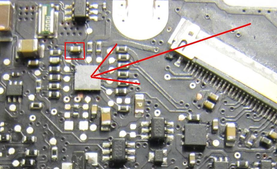

According to the macrumor fuse location thread my fuse is not marked with a "P" Here's the image from the blog.. I did test this fuse location and confirmed it's blown as it's pushing 604.
The arrow is pointing to the Backlight Driver
The square box in your picture is either a resistor or capacitor
None of these are the fuse.
Look at this picture, I hope this is your board, if it is you will need to change or check the LVDS Connector as it look contaminated.
The fuse has a 'P' on it.... check it with a multi-meter in Resistance mode and tell me what you get!"!!"!

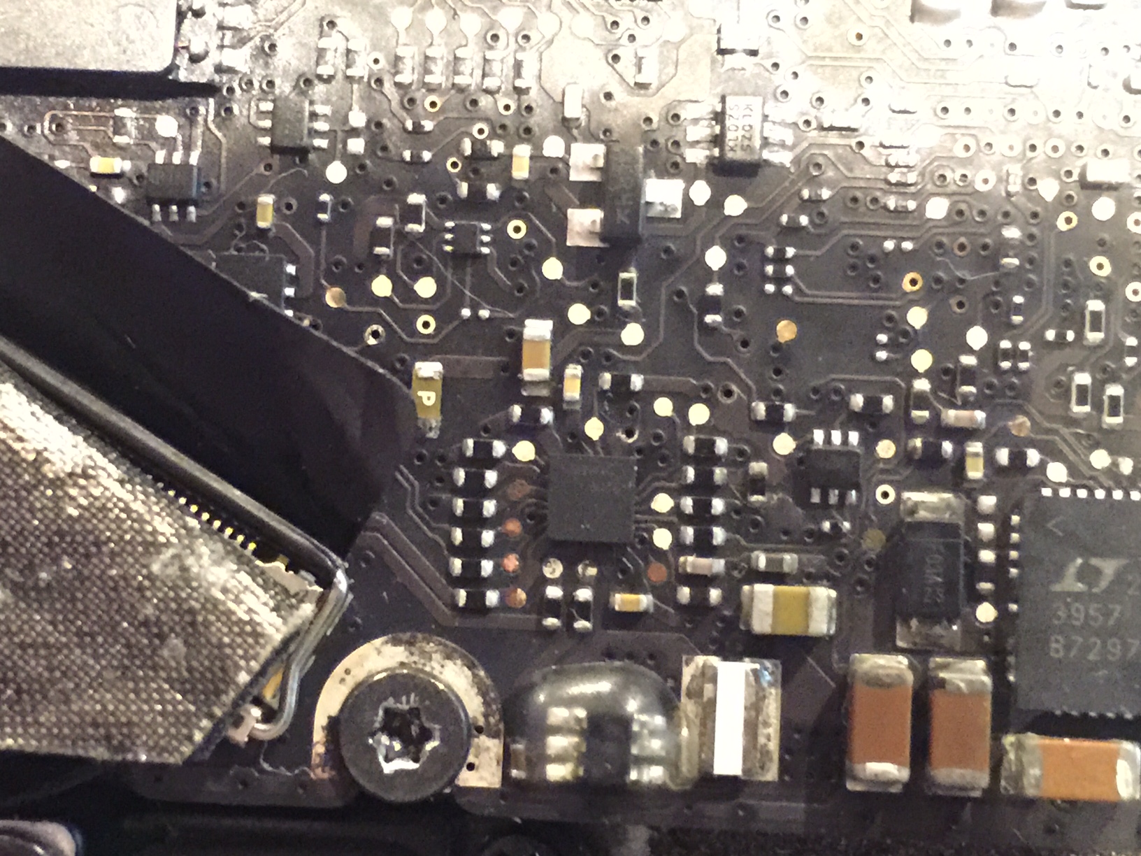

Looking at the board it has liquid problems around the weld chip you will need to replace that, if you have 12 Volts at the fuse 90% sure. to the left of LVDS 6 pin chip looks to have lost 2 legs ? Q4262 fire wire. Do you have hot air station ? you will need this to sort this board.
