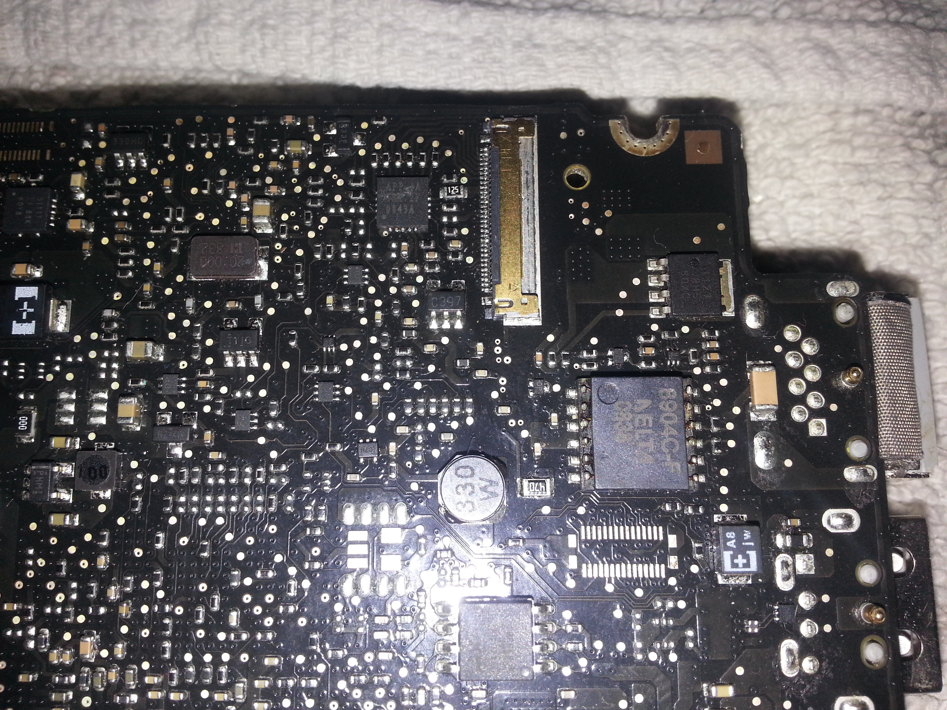

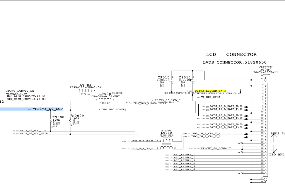

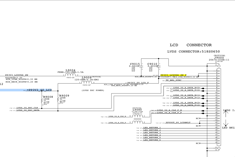

Yes, backlight works but there is no video on screen. I can see bright LEDs glowing behind the LCD panel. External Monitor works fine without any difficulties using a mini Display Port to VGA adapter.
I could not find PP3V3_SW_LCD and PP3V3_S0_DDC_LCD in the schematic/board files. If you mean the 3.3 V power supply signals for the LVDS Connector, then yes, i have measured PP3V3_S0_LCD_F to be 3.47 V and PP3V3_LCDVDD_SW_F to be 3.49 V using an oscilloscope (LVDS Pins 2, 3 and 4). [Schematic reference attached.]

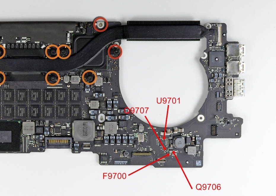

MacBook Pro Unibody - No Backlight - Logic Board Question

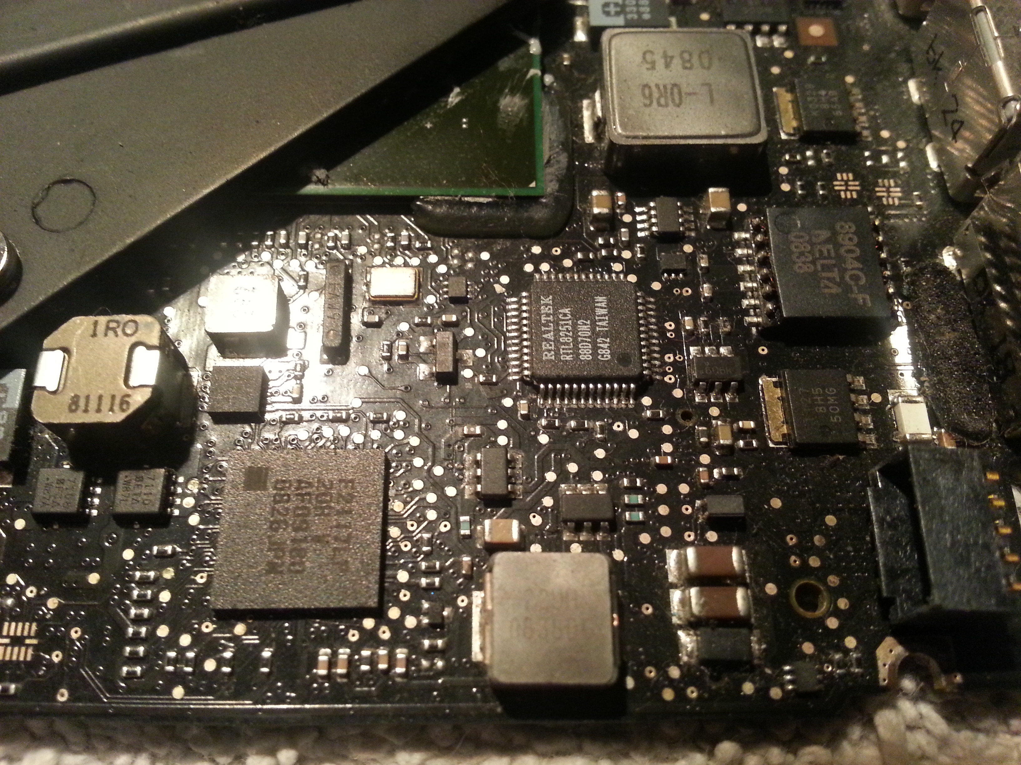

Hi
Just wondering if some one can help me .I have a 2012 MacBook Pro retina a1398 with no display at all. When connected to an external displays it works perfectly. I can't find any trace of liquid damage and all sensors are in tact. Please can someone help me with identifying fuses to check thanks Ian
Sorry I forgot to include a picture
Thanks
Ian
Hi
Thanks
Ian
If you have no image, that is a different issue altogether. Check U9000 area. Is voltage gfoing o the chip, is enable voltage there, and is voltage there on output?

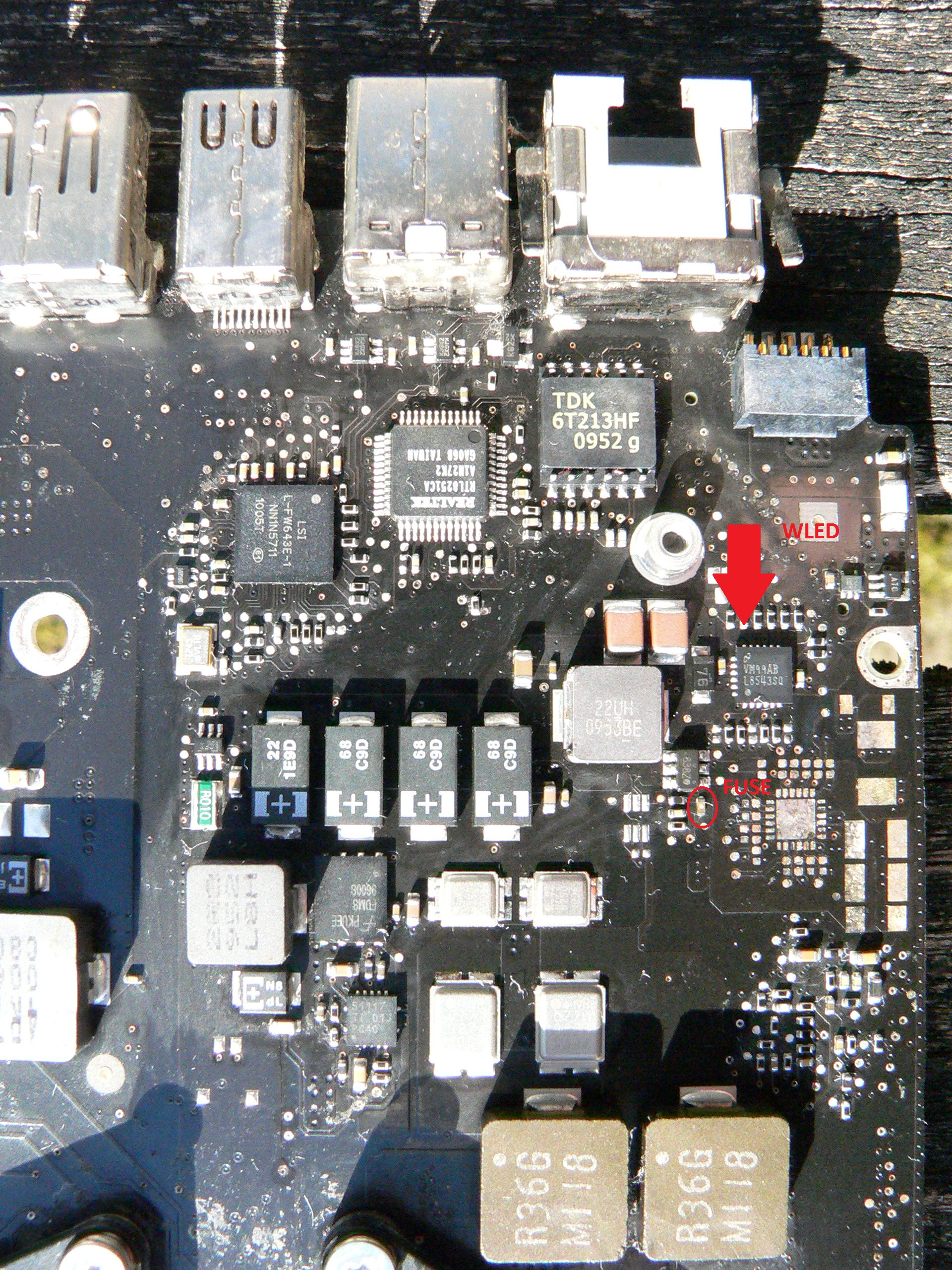

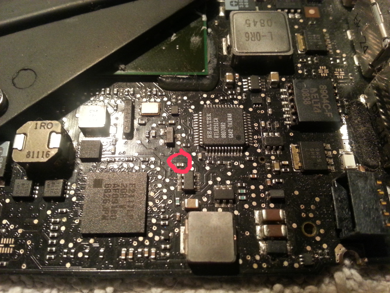

Hi Louis,
Thanks alot for the reply..
The model no of the board is 820-3332-A
I have attached an image of the the chips around the wled driver chip and the chip itself. I'm not sure if this is the area i should be looking at.
The only problem i have is a condition that doesn't really lend to steady hands like i use to have and micro soldering wasn't a problem. My brain still love this sort of investigation but parts of my body are no longer capable.
If i need to check the WLED driver chip i will need to find someone in the UK to try and fix this for me as its now beyond my capability unfortunately...
Does anyone know of a really good technician that could possible repair this for me, i have replaced the complete top of the macbook rather than attempt to replace just the screen. I could take it into Apple and ask them but they will probably just replace the whole logic board for £600.
There have never been any liquid near this laptop ever, so hopefully it has a better chance to be repaired...

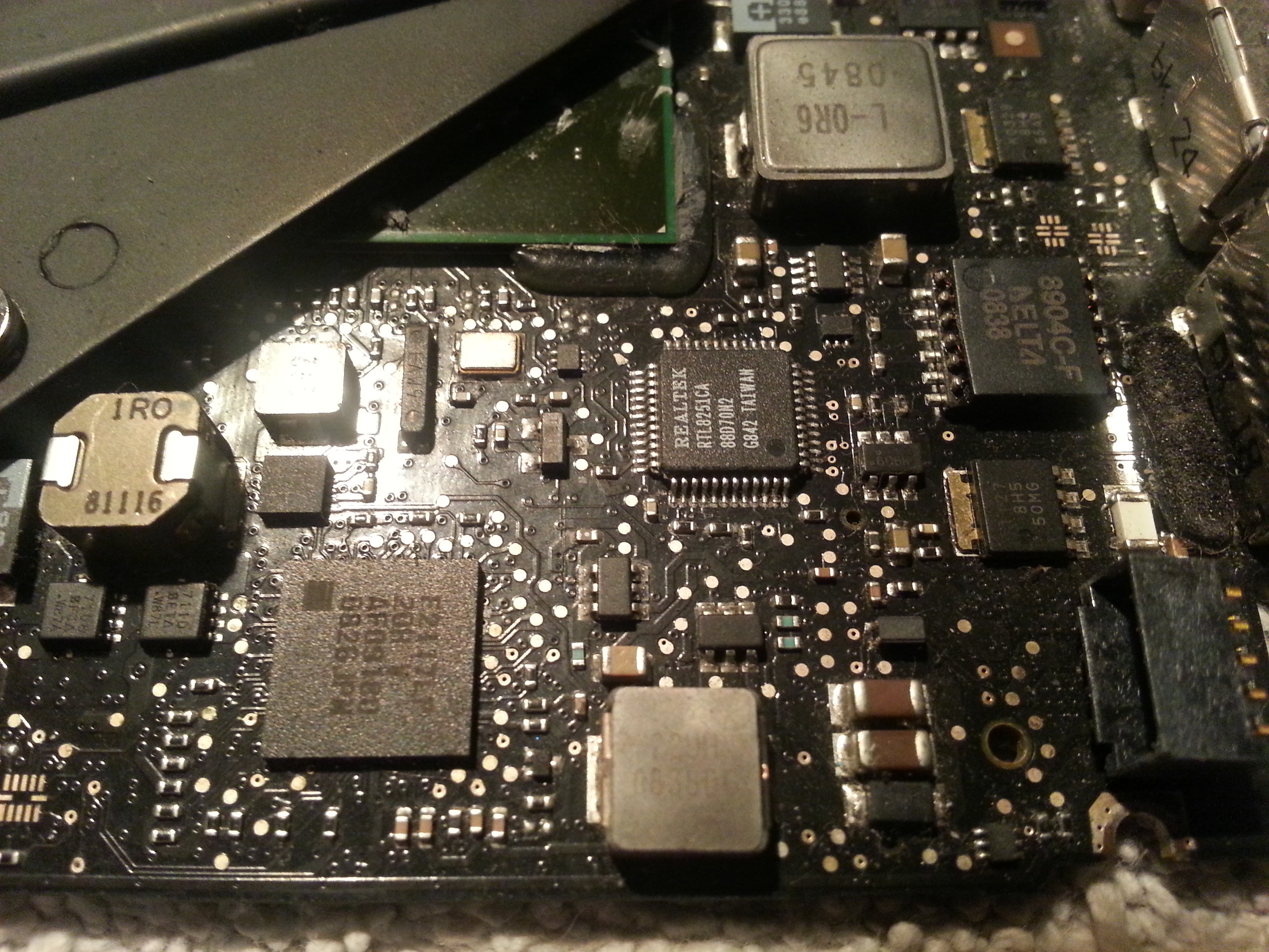

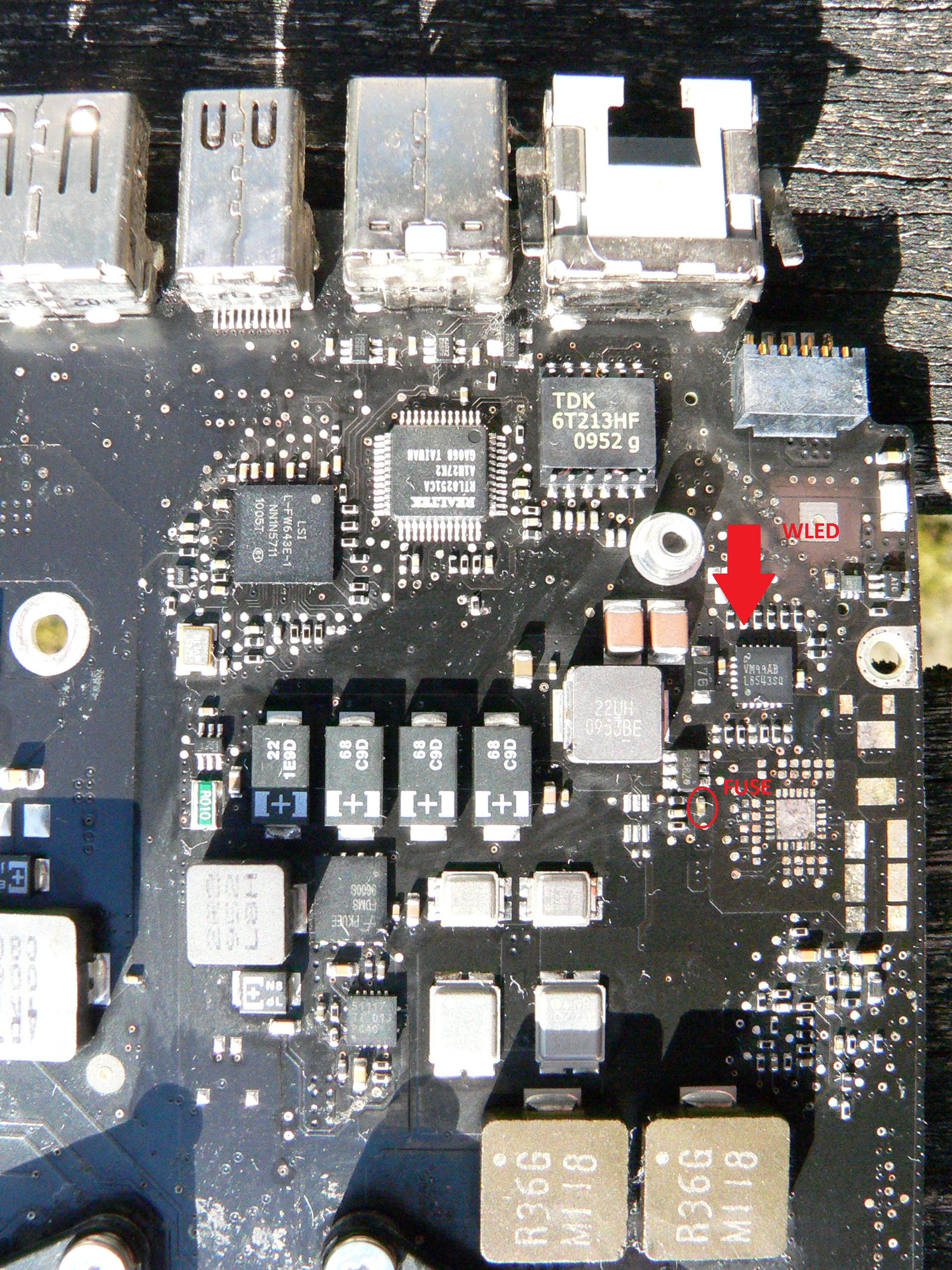

I'm very happy to find this post.
I have a little problem. The backlight on my mac 17" A1297 unibody is faulty. The fuse was blown. I replace the fuse (on backside), but the backlight did not work.
What could be the Problem? Measuring is difficult, it's all on the backside.
Thank you....

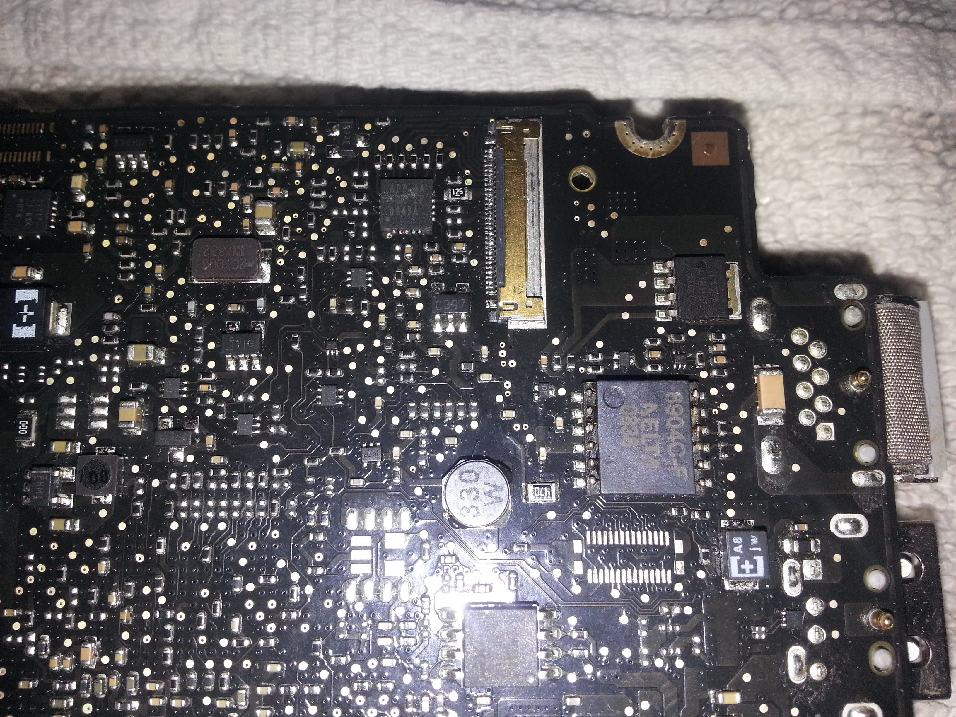

macbook pro 2008
hi i have a backlit issue with my brothers mac that i am trying to repair for him im not sure of the exact model of the mac he just told me it is a late 2008
ok so the display works if i shine a torch at the screen or connect to and external display i have dissembled the mac to see if i can see and signs in blow components and cannot see any damage my problem is i cant find the fuse to check that i have good soldering skill so if it is the fuse if should not be a problem i just cannot locate the fuse or components that could be the problem so am hoping you guys can help me out as my brother really need hi s mac for djing am have included pictures of the board to try help out if these ar not clear enough it is no problem to upload clearer ones thanks any info need just ask as im not sure what u guys may need to know also just now after fair bit of time i have found what i think might be the fuse on the other side of the board i have added photo and it is circled with red

exact, this is the backlight smd fuse.
i have put my multimeter to it and not getting a beep so does that mean it is indeed blown? or should i test other components also iv read alot on the internet people just putting blob of solder to the contacts i dont see how this could be safe or would it be find just to do it to confirm that is all that is wrong then power of machine and get that part and replace
