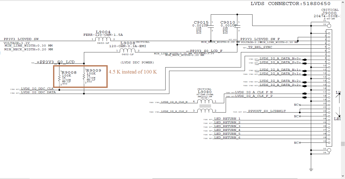

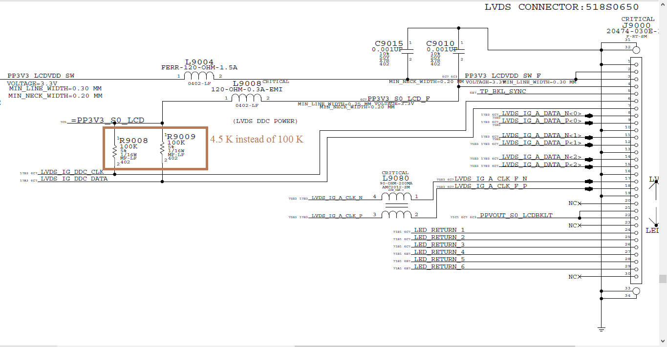

Hi,
Following up on the above Post #247 and #195 (case history), i got inspired by @l.a.rossmann 's Youtube repair videos. I now have the correct Board file and access to an oscilloscope.
Hardware: MacBook Pro 13" Mid-2009 A1278 820-2530 A
As suggested by @Dadioh, i traced back the LVDS Data connections to the GPU. R9008 and R9009 shown in the attachment are 4.5K each rather than 100K (as shown in the schematic).
  • LVDS_IG_DDC_CLK and LVDS_IG_DDC_DATA are always at 3.3V (bad pull-up resistors?)
  • LVDS_IG_PANEL_PWR also has some voltage (i don't remember, maybe 1.6V or 3.3V)

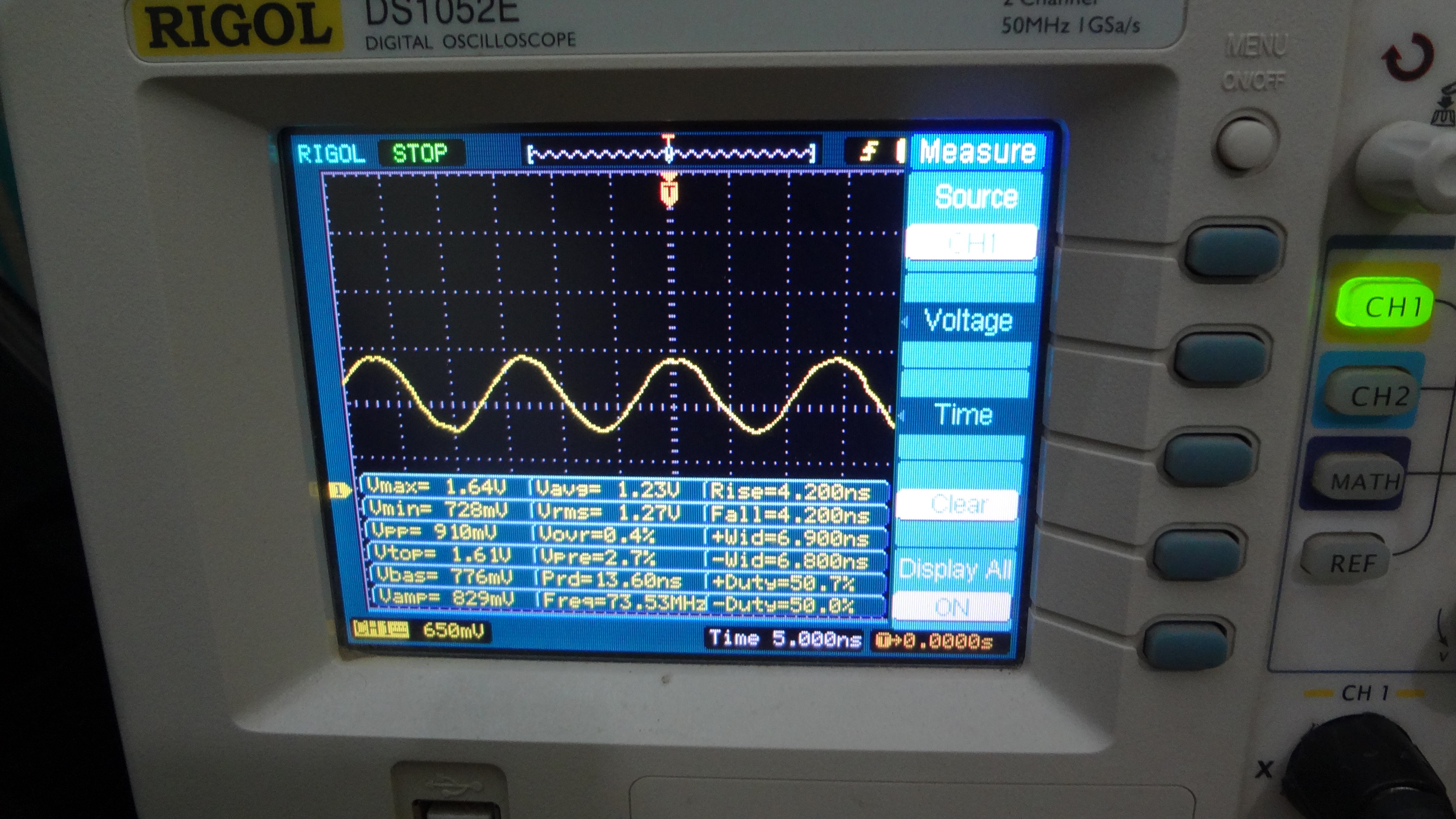

  • PPVOUT_S0_LCDBKLT is at 3.3V
  • All the 6 Data signals show around 1.6V in the oscilloscope.
  • Oscilloscope screen capture of LVDS_IG_A_CLK_N signal is also attached.
What could be the problem? If you people could guide me in the right direction, i would really appreciate it.

Hi,
It is odd that PPVOUT_S0_LCDBKLT is 3.3V. In non-boosted state it should be 12V. The WLED driver then boosts it up to 30ish Volts. Sounds like the WLED driver is bad. Do you get 12V leading into WLED circuit from the fuse through the FET?
