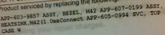

clevin said:
Got it back, altho I don;t quite understand what they replaced, maybe somebody can help me?
from what i have seen on this subject, there is a wire from the thermo that is used to report the cpu's heat that runs right next to the heatsink . when the heatsink heats up it expands and it starts touching the wire from the thermo sensor and eventually melts a hole in the plastic coating on the wire and causes it to ground out and kick the machine off cause its thinking its overheated to a point of damage.
Looks like they replaced your heatsink and your casing. Does the area around your keyboard/palmwrest look more gray than before (i.e. not match the color of white at the bottom of the screen where it says "MacBook")?
yeah, its little bit greener, altho my old one doesn't have discoloration problem..
I know the heatsink, and top case, just wonder what those numbers are, such as, APP-607-0199 ASSY, etc, as well as "BEZEL"
I think the case is three seperate parts. I think the bezel is the area around the screen, then there's the top case, and then the area around the keyboard.
Even though you didn't have any problems with discoloration, maybe your MacBook was made during that run and could potentially have the problem in the future, so they saved you the hassle?
I specifically asked for mine to be changed because it was starting to yellow a bit, and they replaced the same part numbers as yours.
