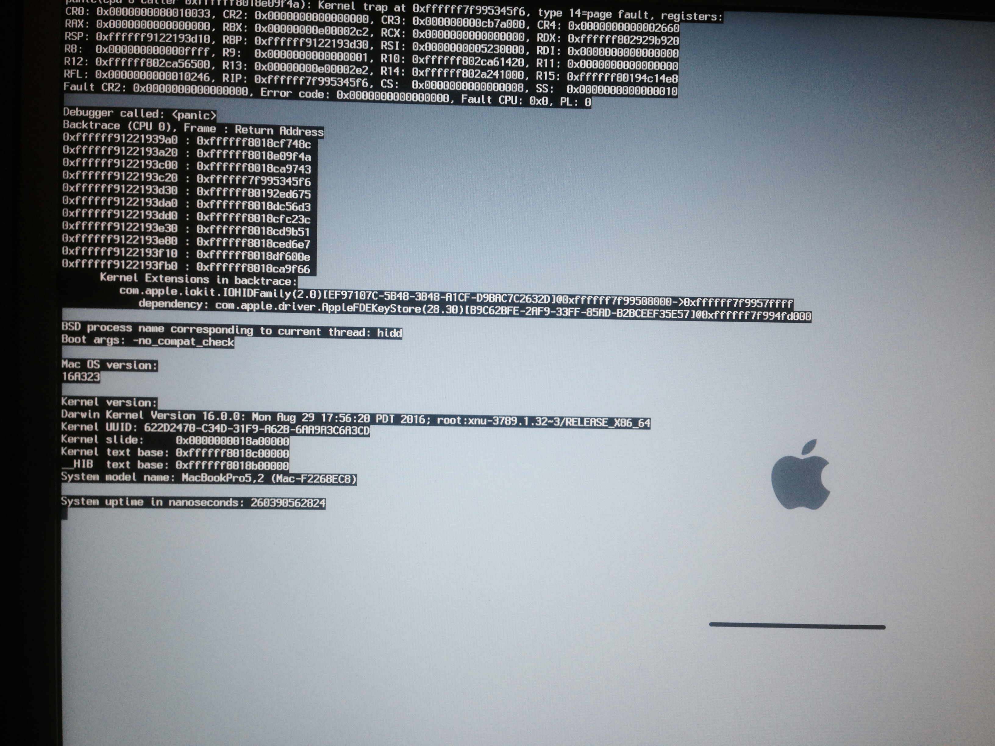

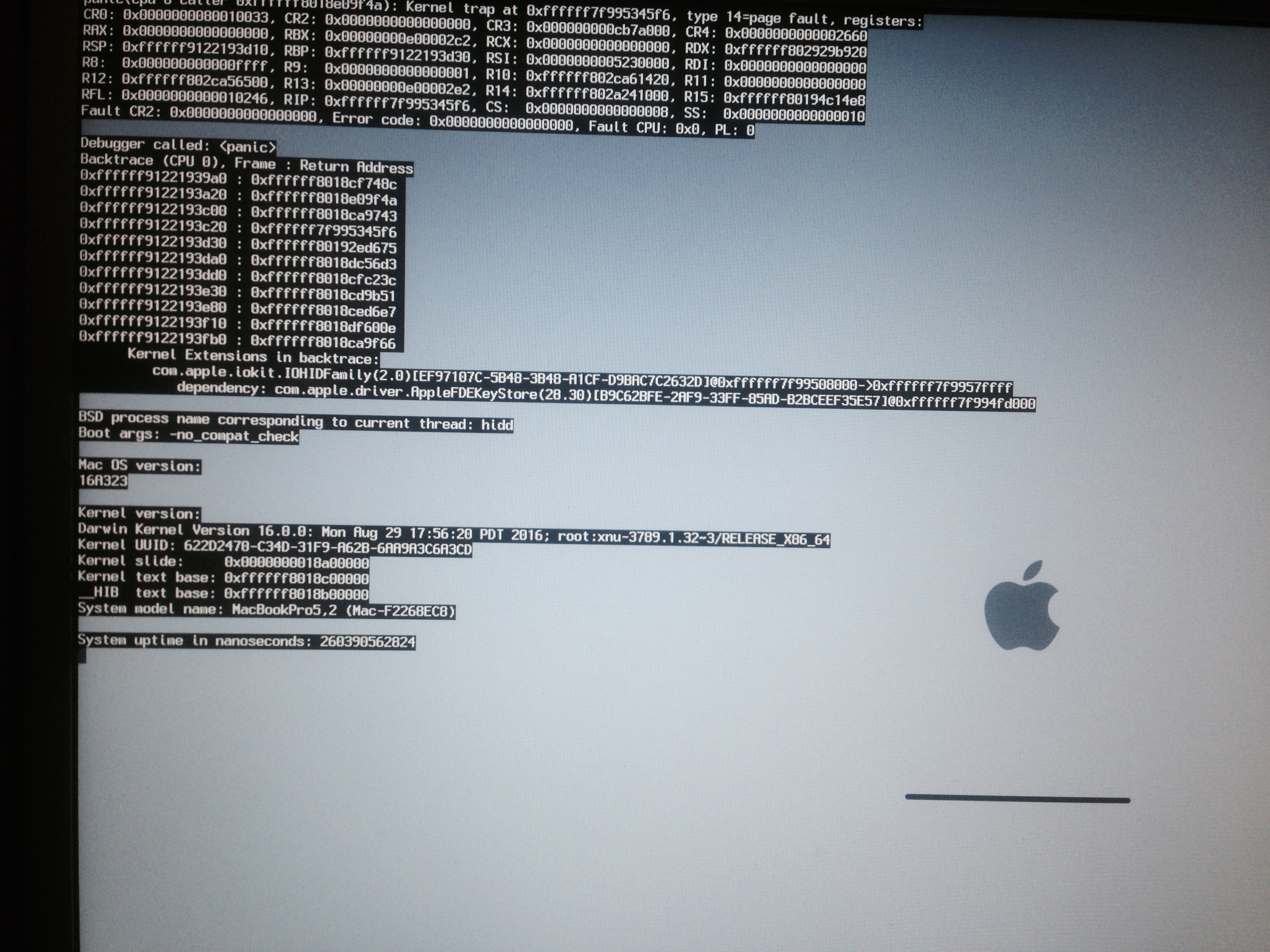

Kernel panic
Can you shot the full screen? I need all the texts. It is a upgrade install over El Capitan? Which El Capitan version? Which folders exists on /Library/Extensions/? Have you any external mouse or keybord? Which brand and type?
