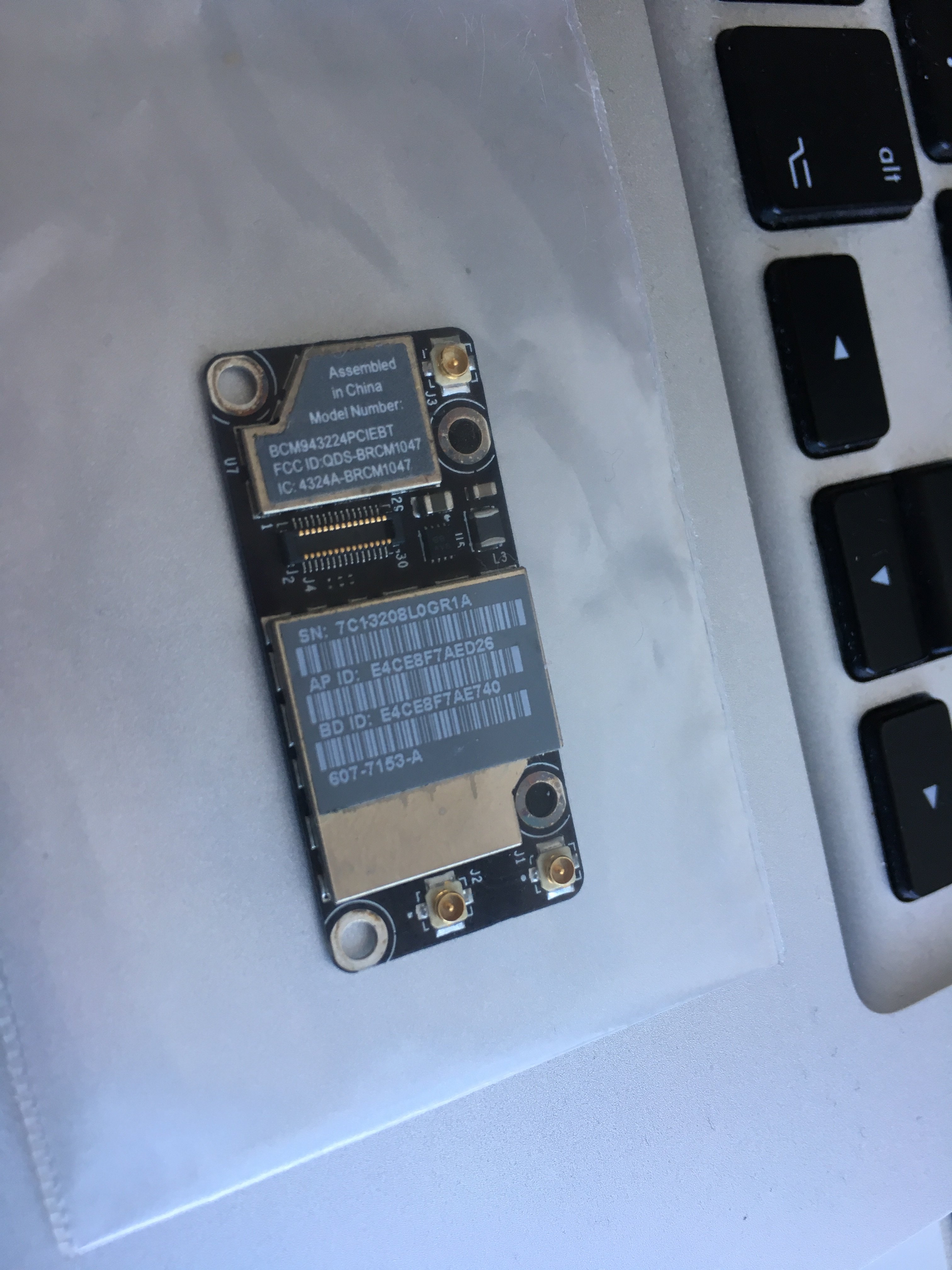

Amazingly enough, had one of these at my place the last couple of days (buddy got it cheap ($69) from one of the school boards - giving it to another friend to use as an HTPC). We didn't put Sierra on it though....dude isn't technical, so I didn't swap out the NIC - don't want another friend to support. 🙂
If I were you guys, I'd find some flat plastic - preferably about 1/8" thick - use the existing card to make a template and then screw the new card to the template. (heard someone did this already....somewhere on here) - seems like an ideal solution. Hell, even an old expired credit card may work, trimmed down. 🙂
