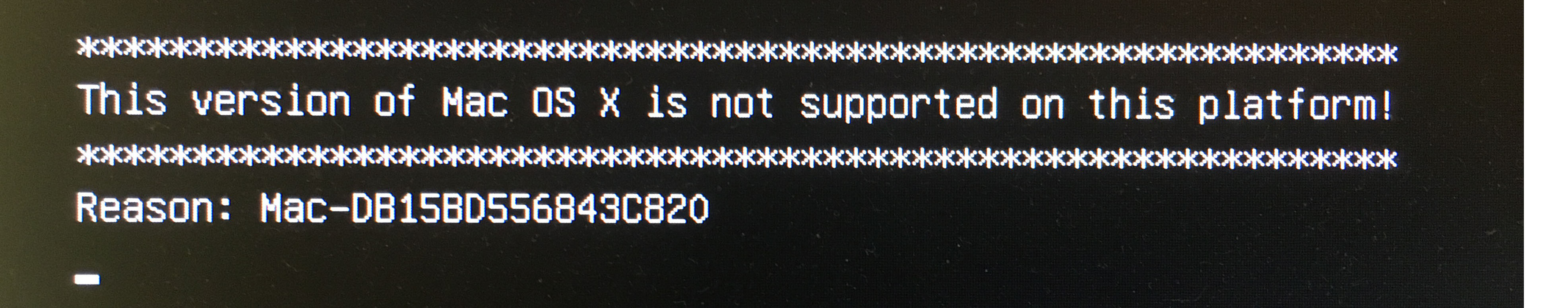

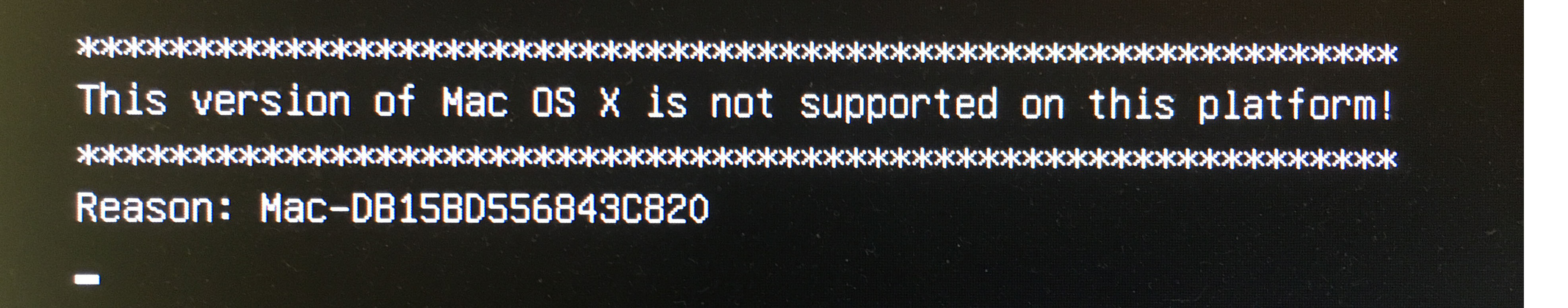

Wanted to express my thanks to @dosdude1, @foxlet, and other contributors whose hard work and patience have allowed me to successfully move to macOS 10.12 Sierra.
My stats:
MacBook Pro (13-inch, Mid 2009) 5,5
Upgraded existing installation of 10.11.6 using @dosdude1's Patch tool (version 4.2.2), the macOS Sierra Installer App linked to in the Patch tool's instruction page, and a USB drive.
After a few successful boots, used @foxlet's AUSEnabler to update to 10.12.2 successfully.
Thus far, I have encountered no issues with running 10.12.2 on the MacBook Pro 5,5.
Notes:
I did want to add something that I might have missed but has been already posted in one of the pages on this thread (I read many, but not all, sorry if this is a repeat): During the initial installation of 10.12, after Step 7 in the instructions, "Install macOS normally on the volume..." I was initially unsure if I was supposed to let the installation try to reboot into macOS 10.12 (if that was part of the installation process), or if I was supposed to preemptively boot into the USB to run the macOS Post Install application.
My questions were answered by simply letting the install run, as I encountered a screen with text reporting something to the effect of "This version of Mac OS X is not supported on this hardware." Note that I always verbose boot via
Code:
sudo nvram boot-args="-v"
The screen/message looked similar to this: image.jpeg (photo credit to leonardoc on TonyMacx86 forums), but I don't think there was an error code on mine. After waiting about 10 seconds, my Mac shut itself down.
I figured this was the point where I perform step 8, booting back into the patched USB and running the post-installation application, and the following steps went as depicted in the screen shots in @dosdude1's instructions.
I just wanted to add this note because I hadn't seen that screen described or depicted in this thread, and it worried me that the installation had been unsuccessful. If you encounter that screen at the end of step 7, I would suggest waiting about 30 seconds before considering a hard shutdown.
Please let me know if I can provide any additional information to help with this. Again, I had a smooth, successful installation, but that screen/message caught me a bit off guard, as I hadn't read anywhere to expect it. Also, sorry for not taking a screenshot.
Thanks again to everyone passionate about this project for helping me extend the life of my MBP 5,5.
