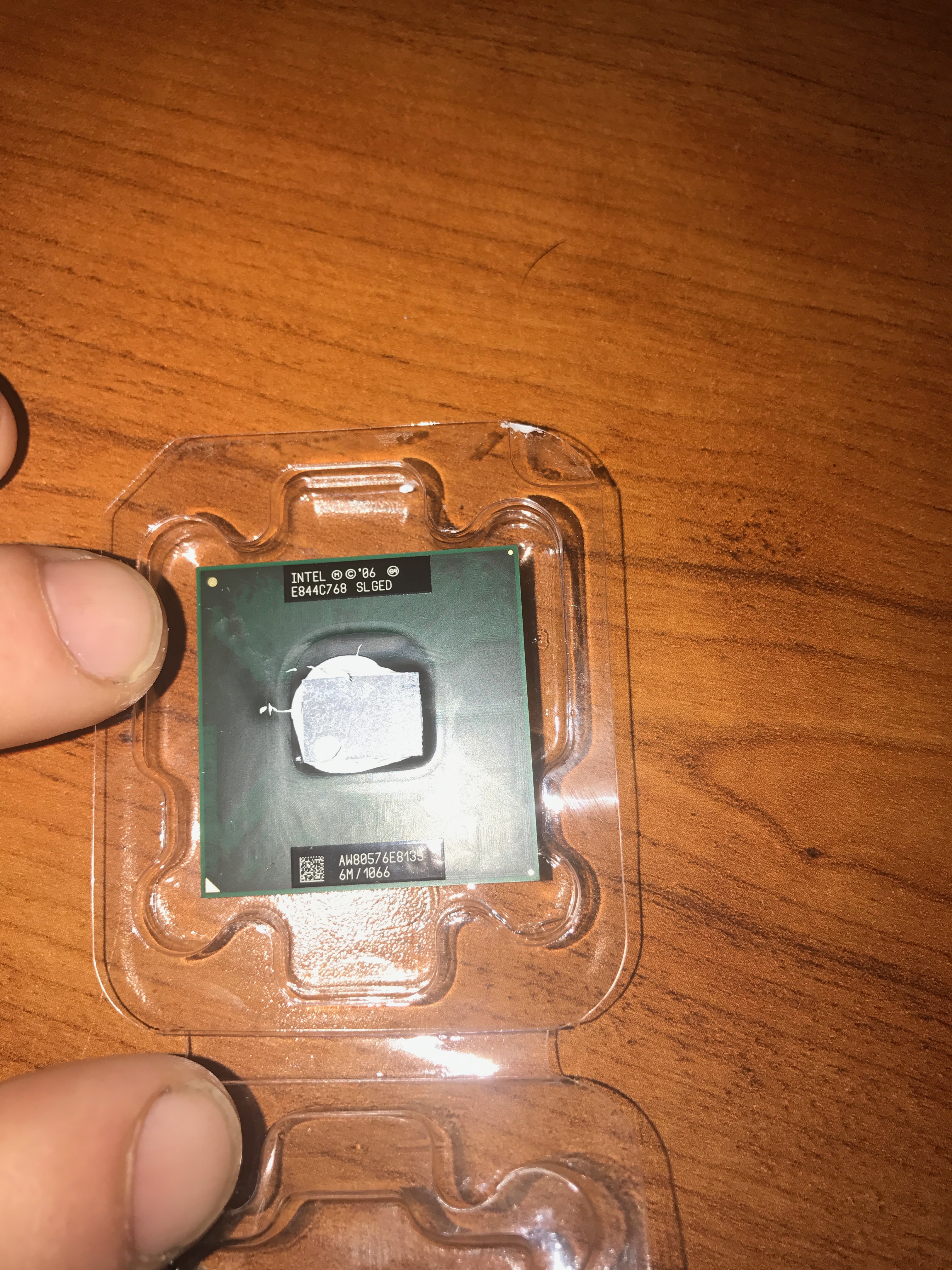

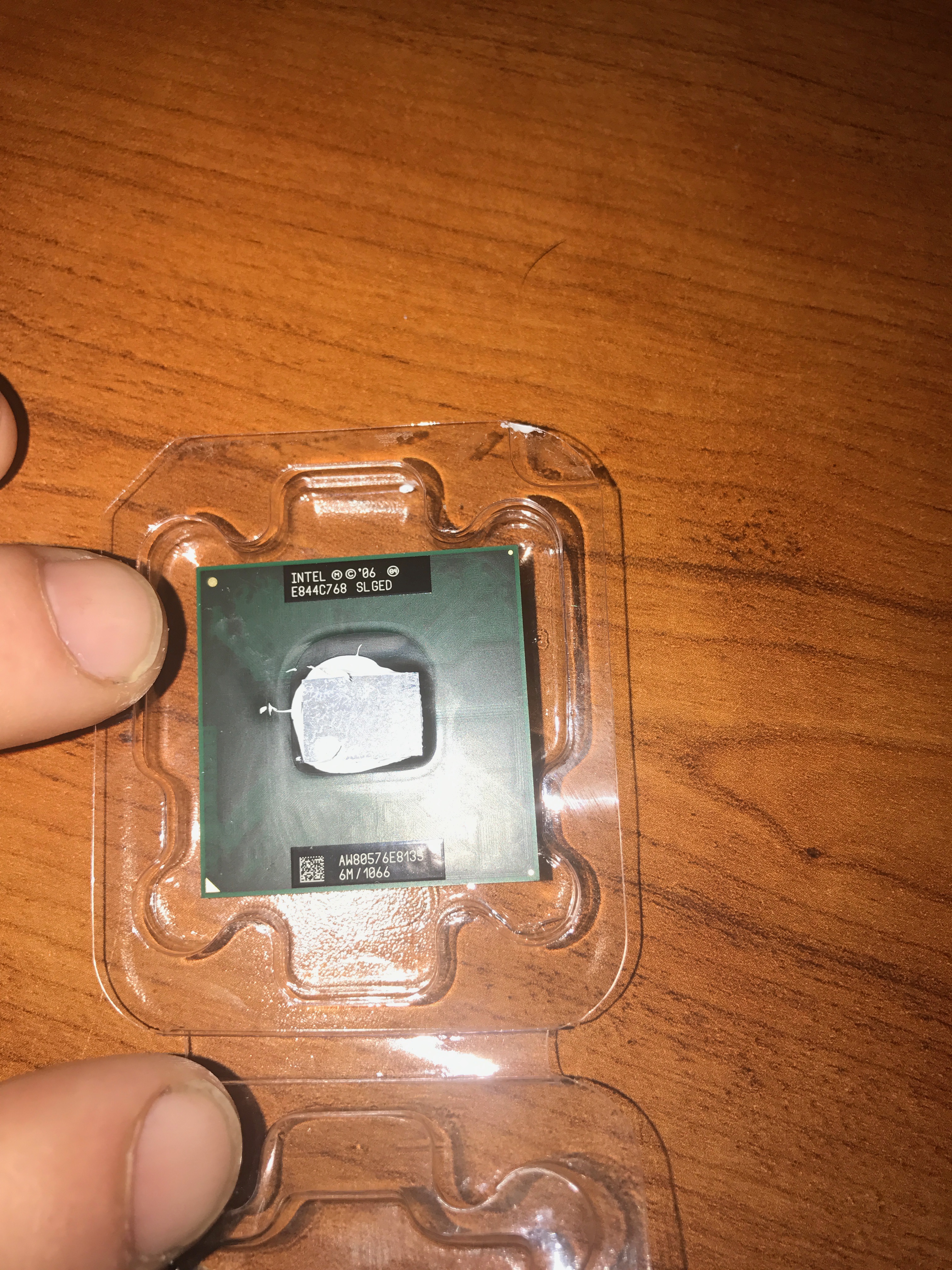

im in the process of upgrading my 20"2007 iMac 7,1 right now with full handoff and continuity support. I have all the parts except the T9300 cpu. Which should be here in a couple days!!!

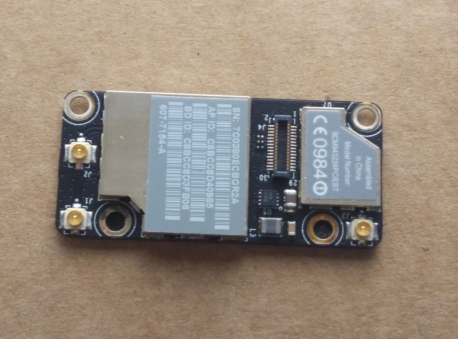

I've a Mac Mini Late 2009 A1283, upgraded with ssd 128Gb and 8Gb Ram.
I want to upgrade to Sierra OS from El Capitan, the only obstacle is the unsupported Airport Card Broadcom 4321.

My question is:
Can i upgrade my Airport Card Broadcom 4321 with this (MacBook 7,1 Airport Card Broadcom 43224) that is full compatible?
Thank in advance for your help.

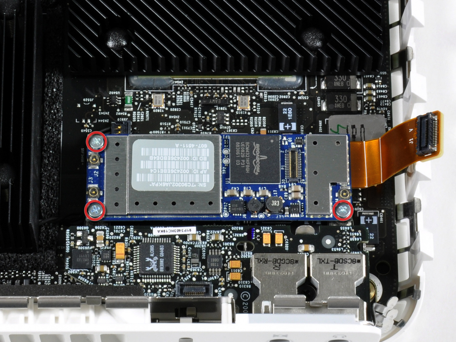

Yep, back in https://forums.macrumors.com/thread...ed-macs-thread.1977128/page-138#post-23758832
dosdude1 confirmed that's the only card that will work as a replacement in the '09 Mini.
That will get you a fully functional wifi stack, but the card still only has bluetooth 2.1, so limited continuity features will be available.
Edit: Also, as the screw holes don't align perfectly, you may want to take an old credit card or similarly sized piece of plastic and make a bracket that you can have line up with the holes on the sysbrd and then screw your new card into, so it's mounted securely.
Reactions: nicco1610

Lucky for you is that I don't think you need to upgrade your cpu to install macOS. But if you do for some reason, I have a E8135 that would support macOS I could send you. I bought it on eBay cheap but it won't work in 2007 iMac because it has 1066 FSB and 7,1 iMac only supports 800
I already checked and my processor is compatible, can you send me links to all of those items and some more detailed instructions on how to install it using the adapters and everything?
