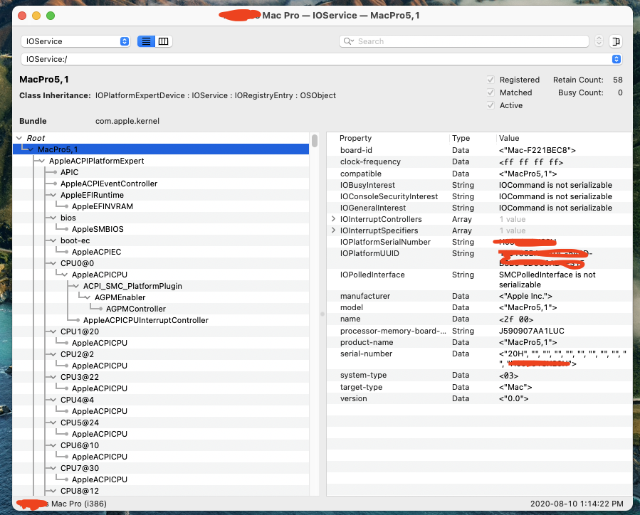

Can you open and operate IORegistryExplorer? Can you wake from sleep?
Just tested both those out and they do work for me. I am able to open the app and use it (go through tabs, menus, etc). Sleep also worked just as well as it did under Catalina. I am using the 144.0.0.0 boot rom. Not sure if that helps.
