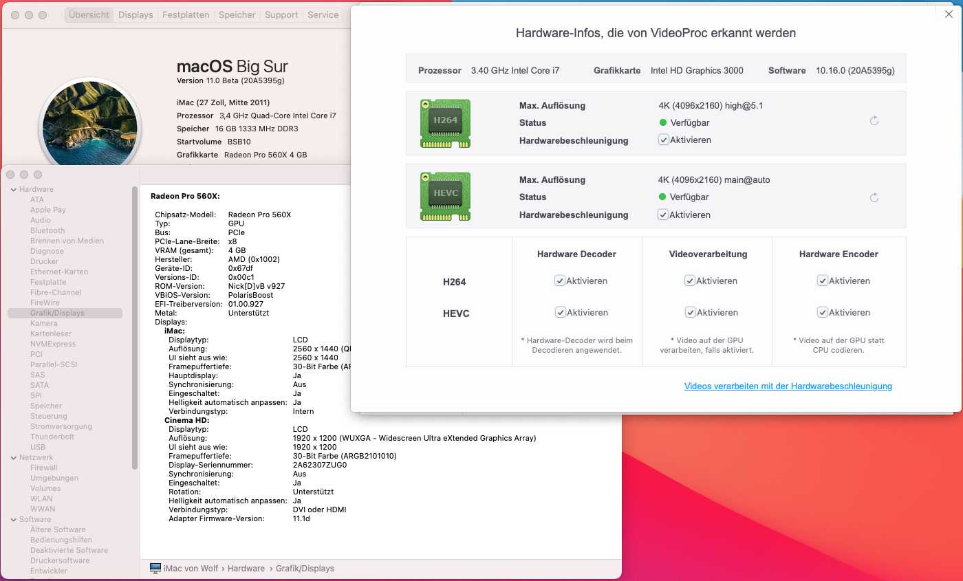

After reboot I figured out that the AMD hardware acceleration is back with B10, you get 4K H.264 and 4K HEVC, used VideoProc to check this.
System: iMac 2011, AMD WX4170, BCM943602CDP WIFI/BT, Big Sur Beta 10, Lilu and Whatevergreen via OpenCore

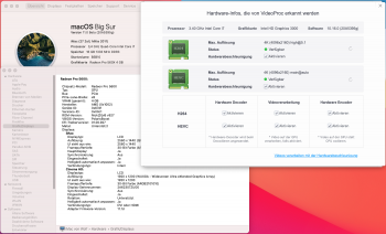

System: iMac 2011, AMD WX4170, BCM943602CDP WIFI/BT, Big Sur Beta 10, latest Lilu and Whatevergreen

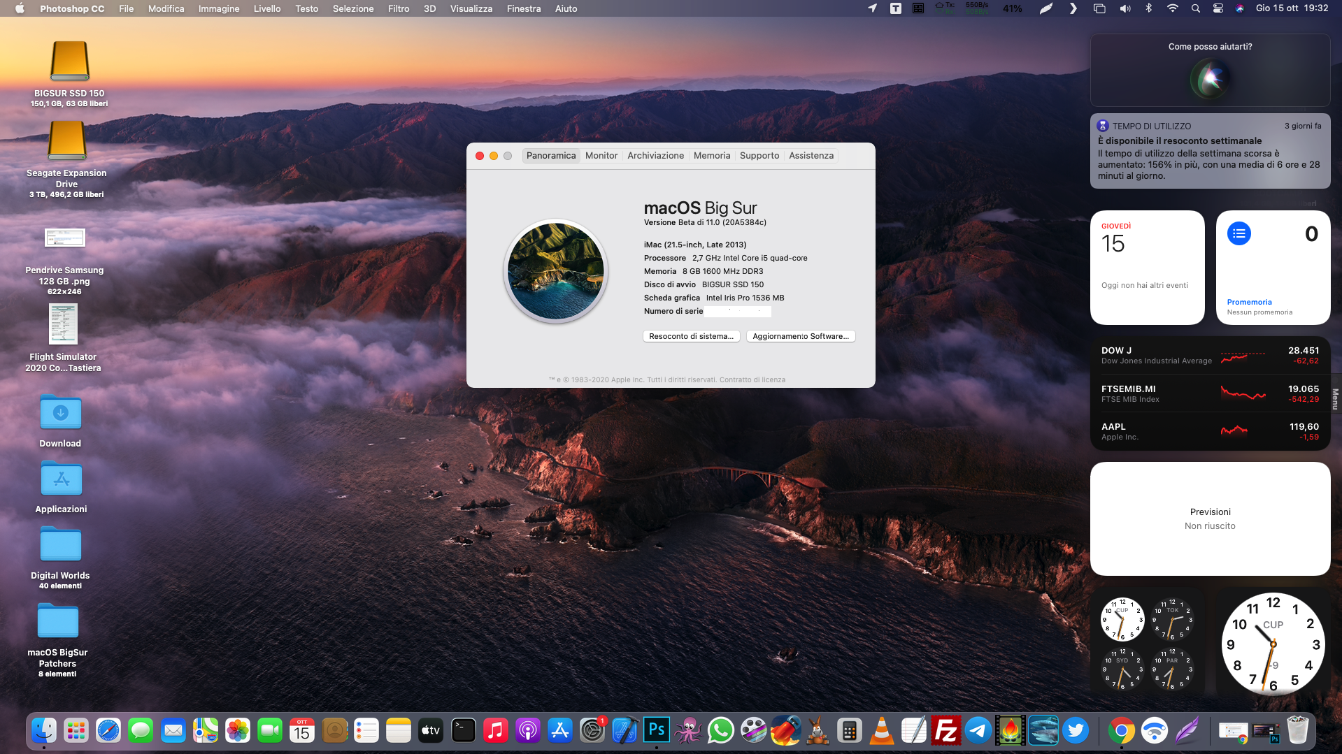

Waiting for the Beta 10 full installer.pkg, I have finally updated iMac 2013 (iMac14,1) Big Sur from beta 3 to beta 9 on my main external SSD Samsung T5, with @Barry K. Nathan micropatcher patched USB pendrive, without using set-vars.sh and patch-kexts.sh on USB Stick, OVER the previous installation, keeping all apps already installed, in only 45 minutes. All works fine without kext patches. Apple has simply choosen to not support it anymore for marketing, but is still perfectly compatible and FAST. You need only an external USB 3.0 SSD (or internal, if you know how to replace it) for optimized performance, but also with the slow original hard disk is usable exactly like the "supported" Catalina. Bye bye iMac Silicon at least until 2022.

Downloaded b10 using Opencore, Installing has to wait until tomorrow, too late to start it now since I need to be next to my computer, bedtime.
Just Updated, twas a breeze, after every reboot I held the option key, then choose Opencore, after first start I choose reboot, after that just open core and my SSD where my normal working OS reside, after several reboots it worked.
The only thing I still have to do is fix my wifi on my 2012 Mac Mini, that shouldn't take long nor too much time.

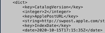

Is there any timestamp on the page, as in, when/at what time was it updated, like to know because I did check it before updating with Opencore just about 1 hour ago.
Edit: There is
But that brings me to another question, what time is this, can't be the time where Apple is located, too early for that time.
And I am pretty sure I checked later than that time here in Mainland Europe.
Greenwich Time???
