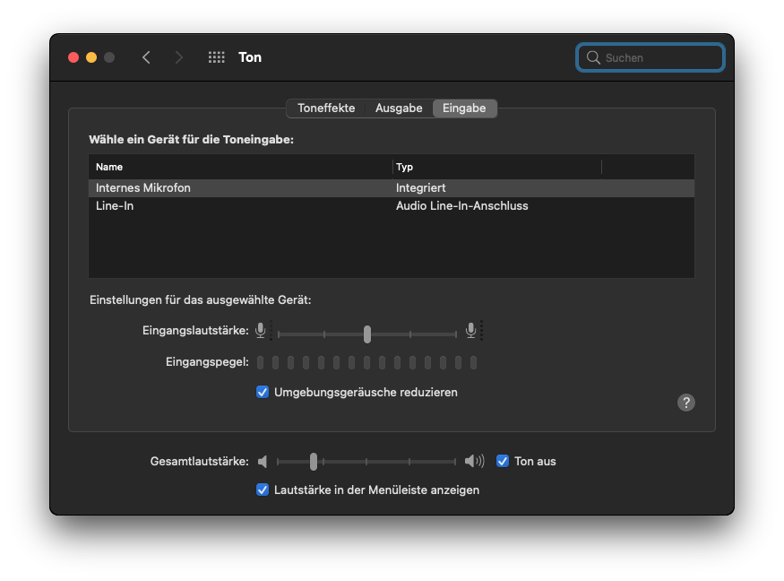

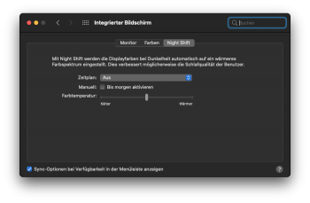

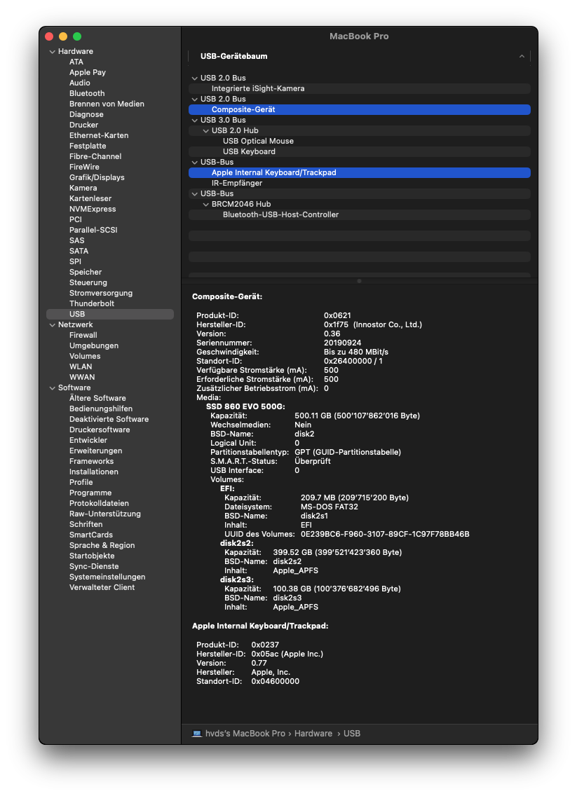

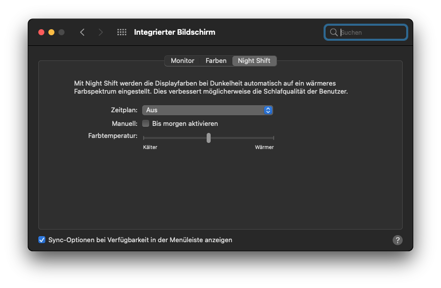

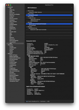

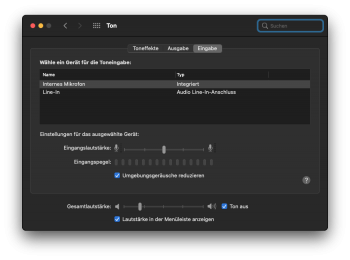

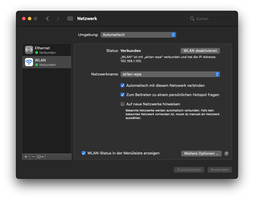

CoreBrightness.framework (and nightshift with it) also working on MBP5,2 with BS beta10. *
Many things in good shape on this legacy USB machine.
I had the problem of Photos.app crashing with all BS betas, but I had always used migration assistant to populate it with all my photos from Catalina. There seem to be one or more with problematic data among them. Without migration (just importing quite a few photos from iPhone) no problems.
* patch-kexts.sh is so well structured that I didn't replace CoreBrightness manually, but found it easier to make a small temporary change/addition to micropatcher 0.4.3 instead.
Thanks Barry K. Nathan and jackluke!

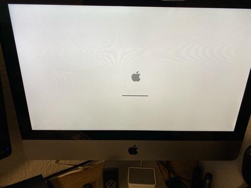

Installing your patched CoreBrightness.framework caused a lot of pain. It gave me a grey screen after 1/3 of the progress bar and no full boot at all. Restoring the original framework from recovery did not work, had to unpatch using the original collections and patch it again.
While doing this I found another incompatible extension (patched AGC does not play nicely with AMD cards, only for AMD iMac 2011) and could repair this. Both files caused the same symptoms ....
Just found an exception:
