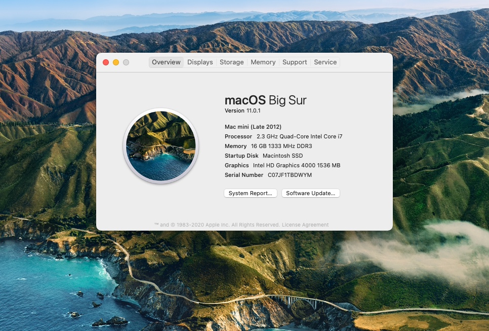

Successful install last night on my Mac Mini 2012!
Funny, hours of fighting with it before I figured out my thumb-drive was crap, put installer on a 2.5" portable HD and everything was smooth as butter. Installed ON TOP of my Catalina install, having performed a SuperDuper backup of my OS drive first. Everything works great!
WIFI: One question re WiFi. Seems like it takes forever to find my 5Ghz network, and prefers and defaults the 2.4Ghz network instead, even though the 5Ghz is set up as a higher preferred network in Network Settings. But not even that, it really takes a while to even find the 5ghz network. Curious, what exactly does mojave-hybrid WiFi patch install? Is it Mojave wifi "drivers"? Or something else?
@Barry K. Nathan - YOU ARE THE BEST!
