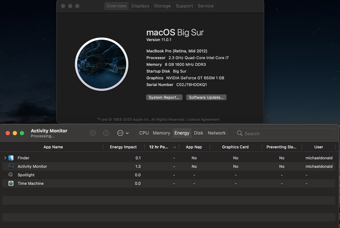

Just on a point of interest I have noticed that in Catalina on my mid 2012 rMBP with just About my Mac and Activity Monitor running the graphics in use is the integrated Intel HD4000 - shown below
However, with the same two apps in use on Big Sur the graphics in use is the dedicated Nvidia card, even though Activity Monitor reports that nothing running requires the dedicated graphics card - shown below.
Can I assume from this that graphics switching is not available for unsupported machines in Big Sur, even though the option is ticked in both power adaptor and battery settings?
It's not a problem - just an observation 🙂
