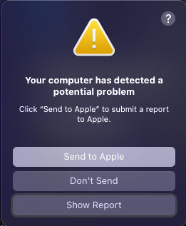

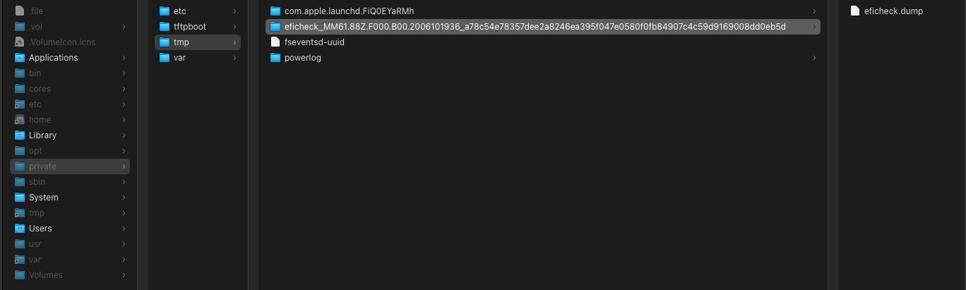

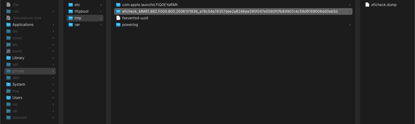

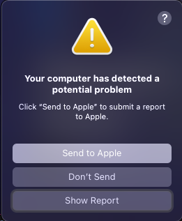

I again got the error below, the third time in about 1.5-2 months, not too worried about it since running BS on a 2012 Mac Mini, so unsupported.
View attachment 1689354View attachment 1689355
Possibly you should use opencore and the eficheck blocker 🙂 or we try to install there very same EFICheckDisabler.kext directly onto the system. Could be an option to my next private patcher version .... if it works.

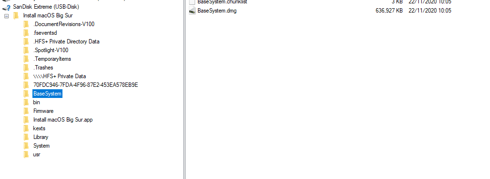

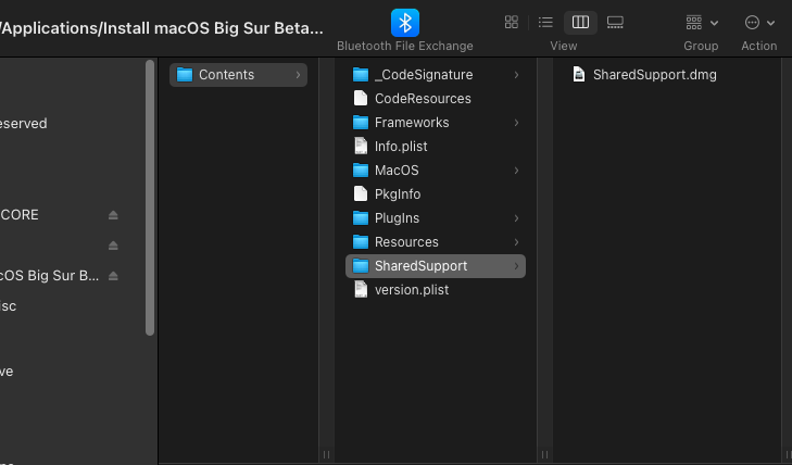

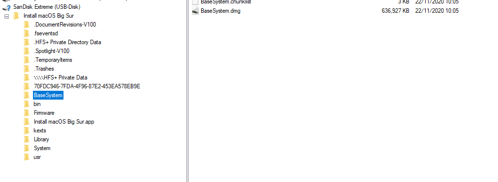

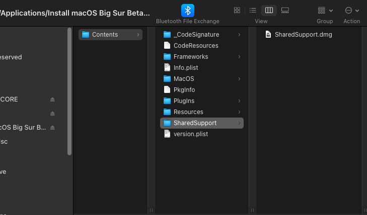

Kind of a random, but important (to me at least) question:
In catalina and before, in the sharedsupport folder, there are a bunch of DMGs, including basesystem.dmg. Is there something like that in big sur? Where? If not, how does apple get around the fact that there is no basesystem.dmg in the installer app?
It is in different place
but before doing this to avoid any annoying "platform not supported (verbose message)" or prohibitory symbol, I removed these files (equivalent to "-no_compat_check"):
I am trying to modify these from within Catalina, but I can't mount those volumes. Any hints how to mount them (writable)
