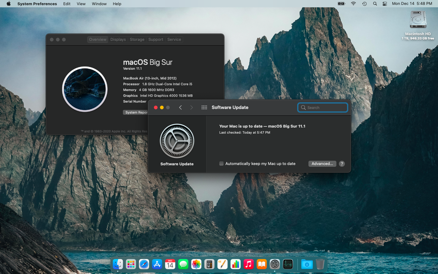

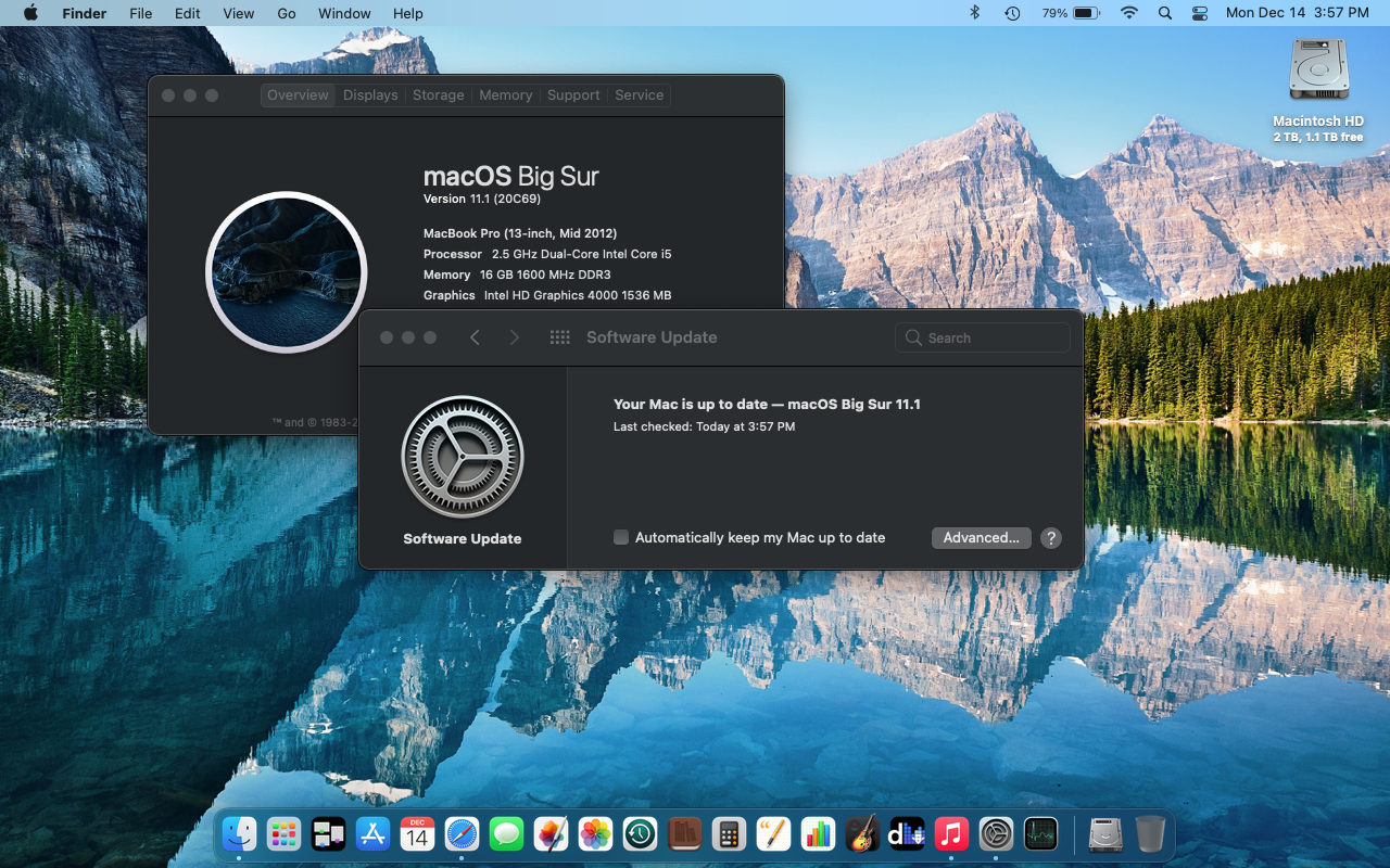

I used gibMacOS to get the release build of 11.1 and used the Micropatcher to update my 9,2. Worked perfectly. Patched Sur is just a UI for the micropatcher which is super easy anyways.I used Patched Sur to install Big Sur on my unsupported MacBook Pro 9,2. Can we install 11.1 via software update? And how can I make clean install by using patched sur?
I am illiterate about coding etc. How did you do that? Can you explain it step by step?
I feel it too. Safari seems snappier.Is this just in my imagination or is it smoother?

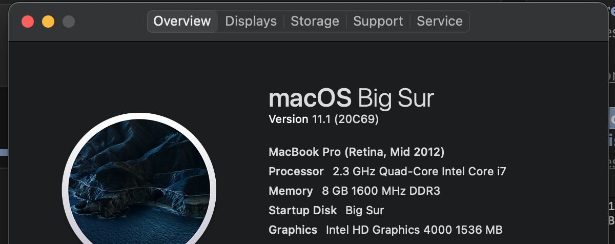

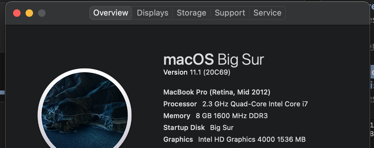

My rMBP mid-2012, 10,1, i7 quad-core, upgraded 802.11ac is almost identical to Quackers device. The install to 11.1 (20C69) was quick (less than an hour) to my internal SSD. I've been using 11.0.1 for my production now and I can say that everything about Big Sur is impressive. The 11.1 version is even better so far. I have had over 100 tabs in Brave Browser and Safari open at the same time. In addition Photoshop was running with more than a dozen 2-5MB files open, plus GraphicConverter running with several 50-75-file folders open in it's browser windows. Plus put Mail on top of all this.Also have a MBP 2012 Retina - still feels extremely powerful to me! Still on Mojave and had no intentions of going to Catalina.
