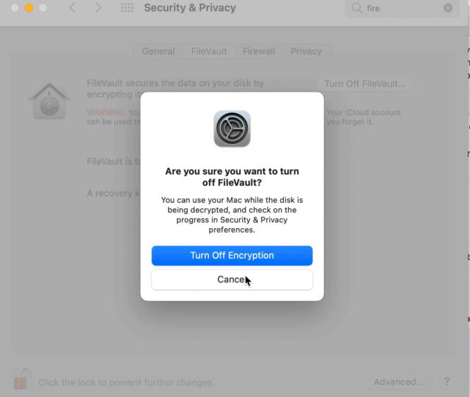

How to disable FileVault?
Can't disable it from system preferences.
How can I disable it using terminal command?
This is a direct quote from BarryKN's micropatcher ReadMe:
FileVault has been buggy throughout the entire Big Sur development cycle. For maximum stability, disable FileVault before upgrading to Big Sur. Once you upgrade to Big Sur, bugs may make it impossible to disable FileVault and may make it impossible to unlock your FileVault volumes when applying updates or booting from the installer USB. (Not to mention, FileVault bugs may also make it impossible to open Terminal on the installer USB.) The best way out of this conundrum is probably to back up the entire Big Sur installation using Time Machine (Time Machine encryption, unlike FileVault, appears to be stable), erase and reinstall Big Sur, and use the Setup Assistant to restore the Time Machine backup.
Not a great option, but entirely predicted problem. Sorry!

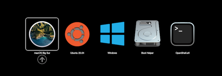

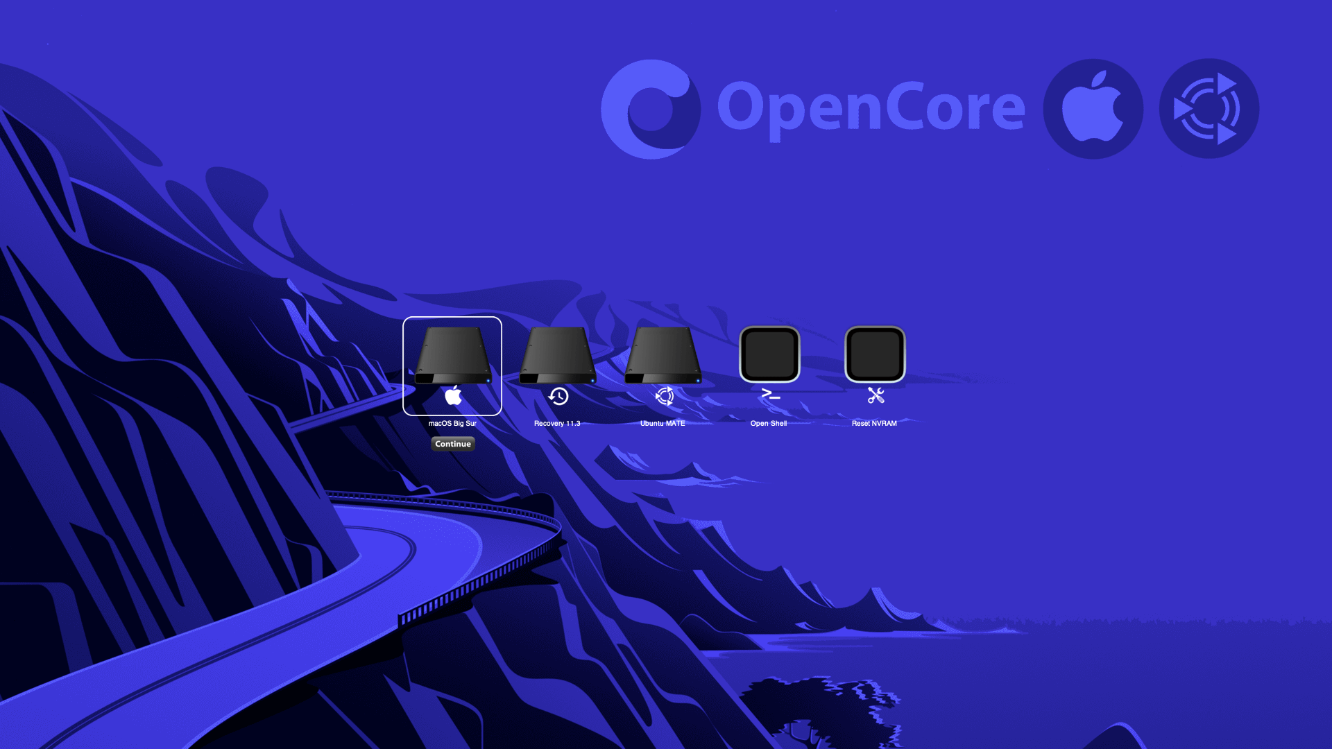

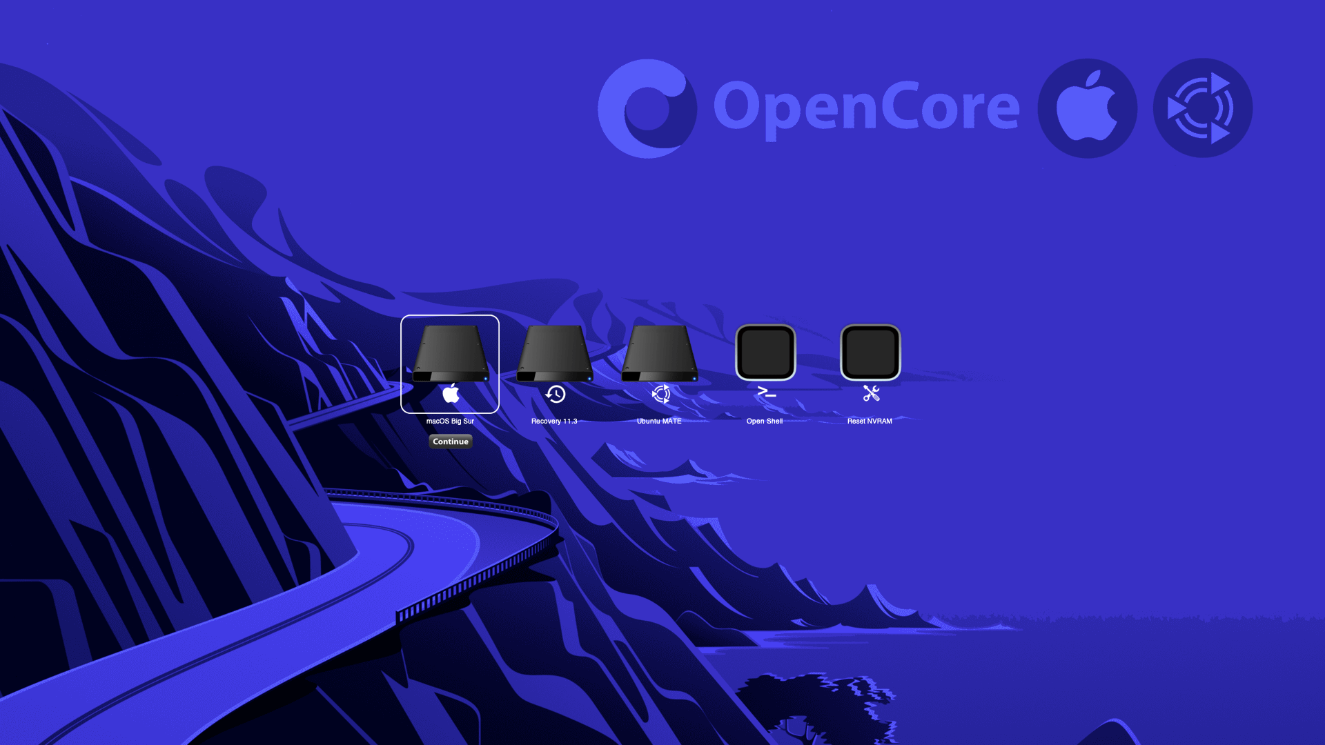

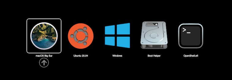

You'd probably just want to turn on the OC graphical bootpicker once you've got everything working (again as per their instructions) - and maybe turn on the lovely 'Modern' OC bootpicker style, which I've only just discovered! :)
I prefer the silent mode, like a real mac, not even showing this screen there, just putting OpenCore on EFI and disabling the OC boot time and screen
Reactions: Bmju
Bonjour,
I also enjoy doing the same thing, however I haven't found a solution to get a more readable (or larger) font.
There is even an explanation on the OpenCore website to create your own fonts, I tried without success...
Edit: although it's not necessary at all, I don't understand why you can't see my Time Machine disk, and I've tried some options.
Edit2: If I understood well it's normal, there is no boot possible on the macOS Big Sur Time Machine. ;)
