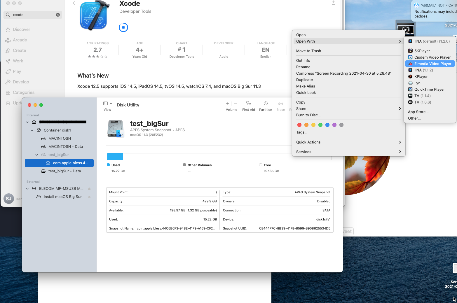

why these apps come in BigSur partition from other OP system Catalina 10.15.7
Start downloading XCODE 12.5 on BigSur 11.3

Spotlight is surprisingly able to index all your disks, partitions and containers and will find data and apps there. This is not sharing, this is mounting. To avoid this you could have asked the bigger search machine just to find out that it is a spotlight privacy setting.

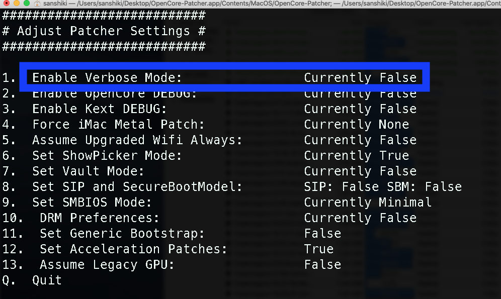

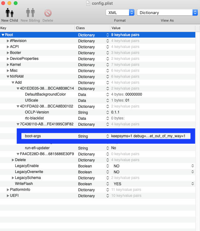

To get a better overview I ask everybody having problems to enable verbose boot adding the -v to the boot-args or by creating a new EFI folder using OCLP with verbose boot selected.

Can you confirm to fix verbose boot area and where can I find list of boot arg keys with full details
and from patch sitting
i want to test but software update jump to BigSur 11.3 so I wait for beta update or I can’t?
