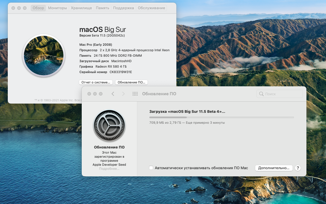

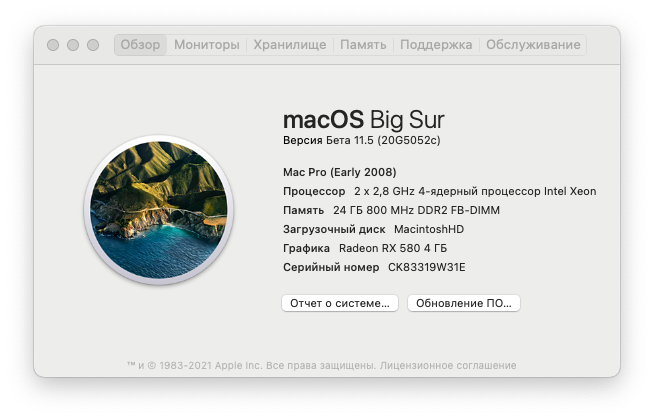

Hi Guys!
Successfully updated my Mac Pro 3.1 from 11.5B3 to 11.B4
OCLP 0.2.2
Issues - forbidden sighn on reboot after update process ended
On a second reboot - boots and works fine.

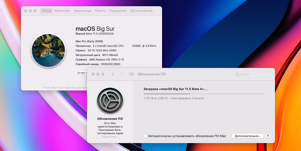

Hi!
Updated My MacPro 4.1 (Flashed to 5.1) to MacOS Big Sur 11.5 Beta 4
I updated my OC config by OCLP 0.2.2 - and get freeze on boot into 11.5b1 (without expansion PCI cards)
After 1st restart - system booted and i started update process, after 1st reboot - freeze and 2 reboots. After install process gets started, all installed and 11.5 b4 booted sucessfully.
After i install my ThunderBolt 3 PCI Adapter - 11.5B4 never booted under OC. With boot-arg "-no_compat_check" - 11.5 B4 boots on native bootloader 2 time freezes, but after 2 reboots loads and it works.
I decide to rollup to old OC config (OCLP 0.1.1) and all boot and works!
P.S. In Verbose mode NVMEFIX got error - unsupported model (OCLP 0.2.2)
P.P.S my NVME SSD 512GB Apacer AS2280P4 [AP512GAS2280P4-1]
