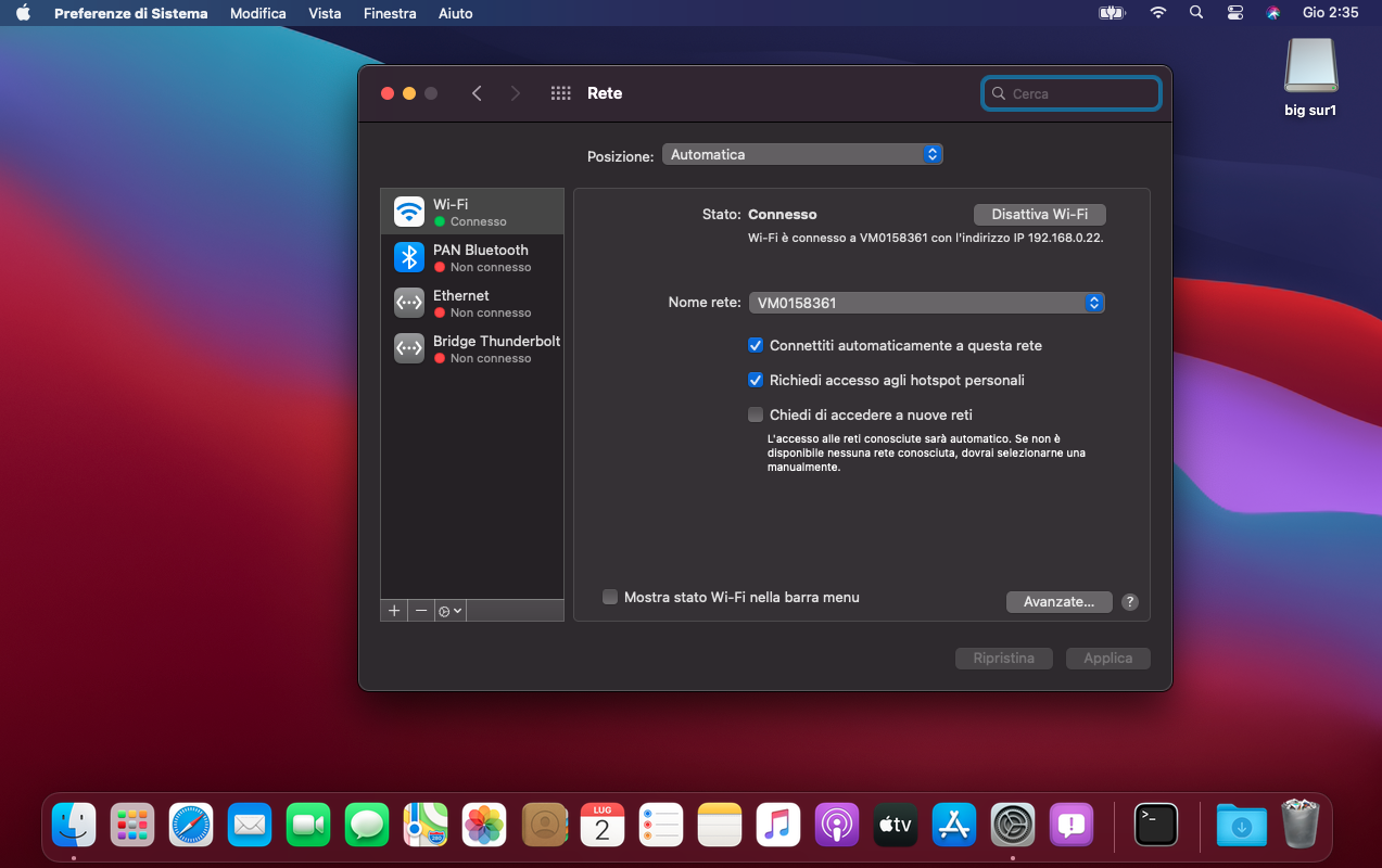

Sorry for my English, in my iMac late 2012 macOS 11 is working very well. The only thing that does not work is the wifi, what file would I have to download and where to replace it to activate it? I have tried a Wifi AC USB and it works! but I don't have AirDrop and Handoff, I imagine these devices are not compatible to have AirDrop and Handoff. I would like to activate the wifi of the Mac to see if I have AirDrop and Handoff available. Thank you very much.
Hello, you have to copy the IO80211Family.kext of Catalina, which is in /System/Library/Extensions of Catalina, into the /System/Library/Extensions of Big Sur.
Follow this guide to mount Big Sur in r/w, then before replacing IO80211Family.kext of Big Sur rename it in IO80211Family.kext.backup :

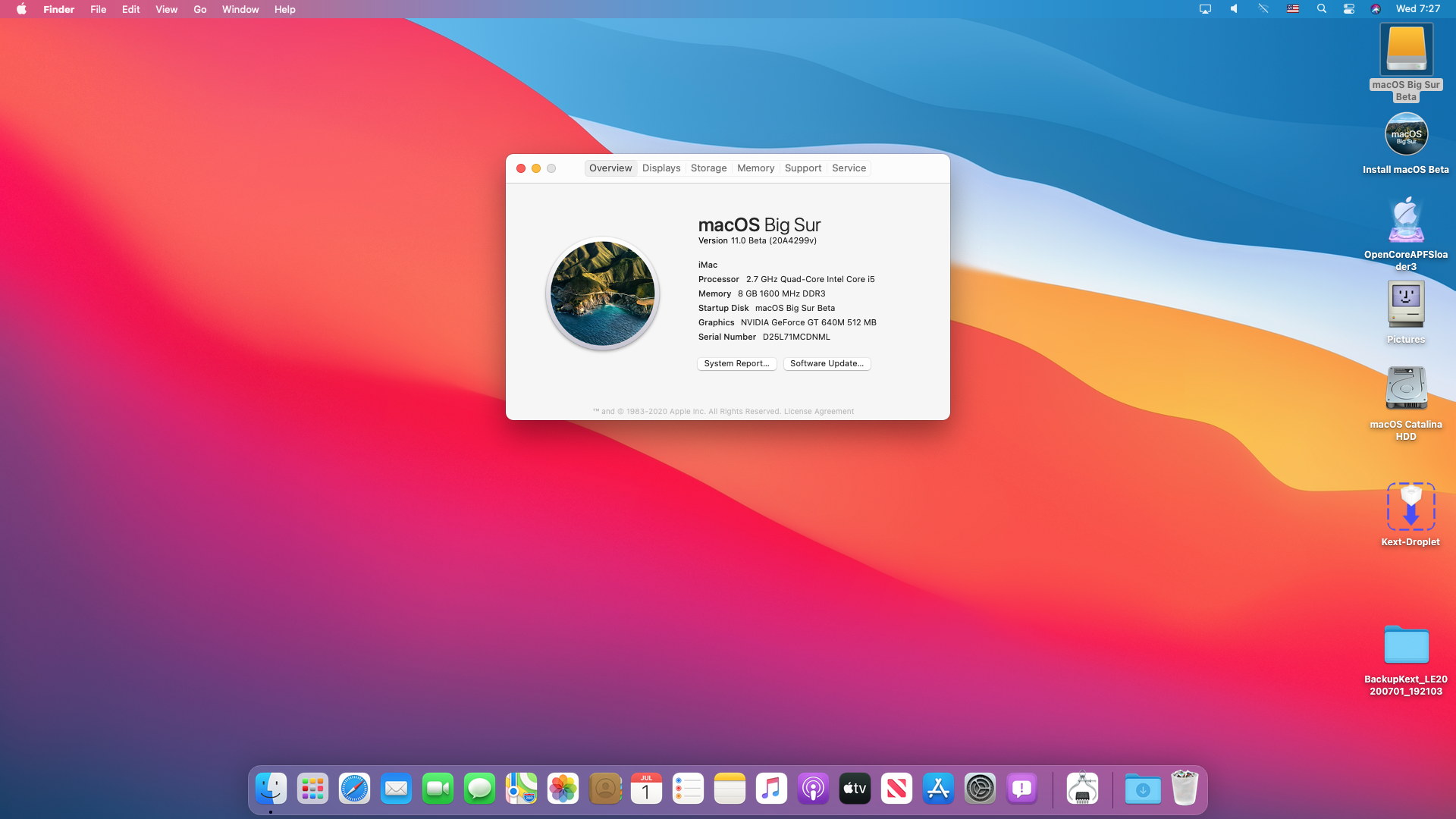

Followed basic steps to disable Library validation, used HAXDIB and Updated Catalina to BigSur. Natively, Every single thing works just better than Catalina. Late 2013 iMac 21.5"
[automerge]1593365837[/automerge]
Everything Works NATIVELY. Updated Catalina to Big Sur. Late 2013 iMac 21.5"
Superb!!!!! Why Apple doesn't support this Mac by default is my first question!!!
[automerge]1593366095[/automerge]
STEPS
1. Download InstallAssistant.pkg from http://swcdn.apple.com/content/down...kxzj3zjshu1srsh4n74a41n4/InstallAssistant.pkg
2. Download hax.dylib and copy to home folder https://forums.macrumors.com/attachments/really-simple-installer-hack-zip.926156/
3. Boot in recovery and disable sip with the " csrutil disable " command
4. Boot back into Catalina and open terminal then run " sudo defaults write /Library/Preferences/com.apple.security.libraryvalidation.plist DisableLibraryValidation -bool true "
5. Then Run " launchctl setenv DYLD_INSERT_LIBRARIES $PWD/Hax.dylib " in same terminal window
6. Then Run " sudo nvram boot-args="-no_compat_check" "
7. Open macOS Big Sur Installer

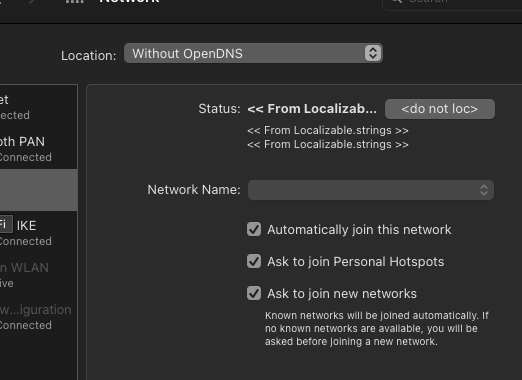

I even found an ethernet cable long enough to reach my router but in Catalina as well as Big Sur it says I have a self assigned IP address therefore I can't connect to the Internet. I can turn on my wifi in Big Sur but its not seeing the network which is Eero
Reactions: Barry K. Nathan
Have you tried restarting the router? I know that sounds dumb but I've seen cases where routers start doing weird stuff with DHCP reservations after a while and restarting the router fixes it, and your Ethernet cable symptoms sound like they might be consistent with that scenario. (That might not fix WiFi, but having the Ethernet cable working would be better than nothing.)
