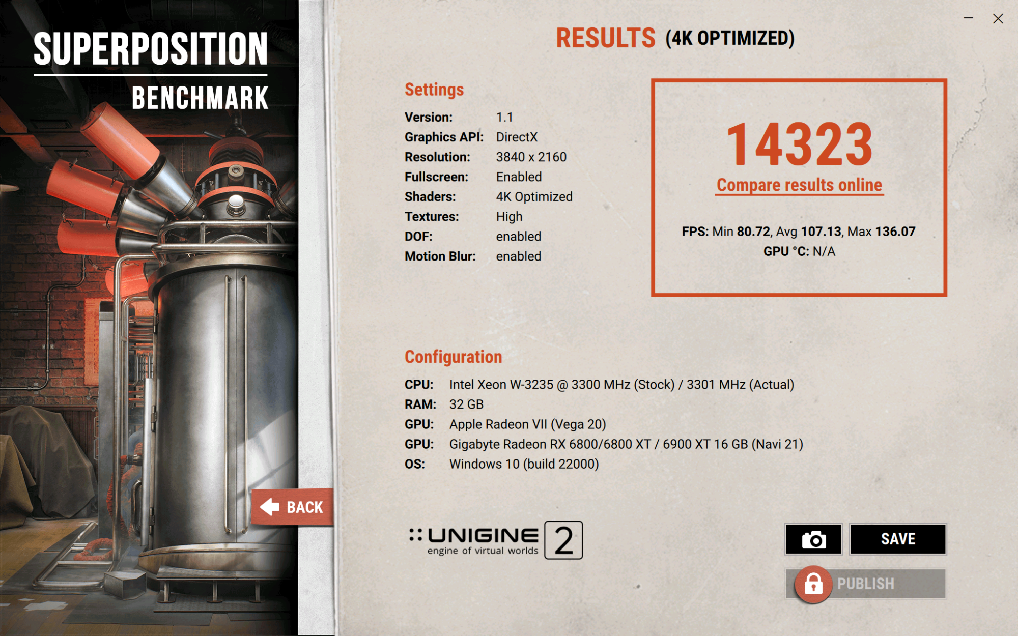

@gank41 @Idgit
Thanks for all of the suggestions -- since this is a Mac Pro, there is no built-in Intel GPU, so I have to use either my RX-6800XT or the MPX module in order to have video output. I have tried Safe mode and using first aid within Disk Util in recovery mode.
I have also stress tested my GPU in Windows 11 using Furmark, Cinebench, and the Unigine test. All reveal no problems with my RX-6800XT, however, interestingly enough, I was finally able to get the AHT to work, and it revealed the following:
"PPF004: There may be an issue with the fan."
Funny part is, I then booted back into macOS and installed Mac Fans Control and tested all fans and the exhaust and all of them ran to max speed fine without causing the machine to KP or do anything weird (was also monitoring activity monitor to see if WindowServer would start overusing RAM and getting ready to crash, or if watchdogd would act weird, but nothing happened) then I watched a 2 hour movie with no issues.
Needless to say, I am still going to take it into apple to see what they have to say, so thanks for all your help.
I'll report back after I take her in to apple.
In case you're curious, here is my Furmark score, and below is the Unigine:
Cheers.
