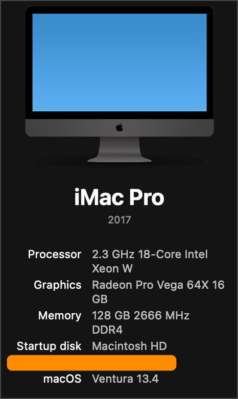

Updated yesterday to 13.4 22FF66 and now my PGUP and PGDN do not work in any apps. Also, PGUP & PGDN seem to break/kill other keystrokes. i.e. I can use the up/down/left/right arrows in every app until I hit PGUP or PGDN and thereafter the arrow keys are dead. Until I CMD+TAB twice. (The first time there is no response. The second time it switches apps and the arrow keys are reenabled.) Until I hit PGUP or PGDN again by habit - something I do in Excel hundreds of times per day. I checked the keys using Karabiner Event Viewer and it indicates all of the keys are working properly (even after using PGUP/PGDN). Tried it using a USB-connected keyboard and a Mac Bluetooth keyboard. Same results. Baffling... No, I'm not interested in doing a NVRAM reset at the current time.
