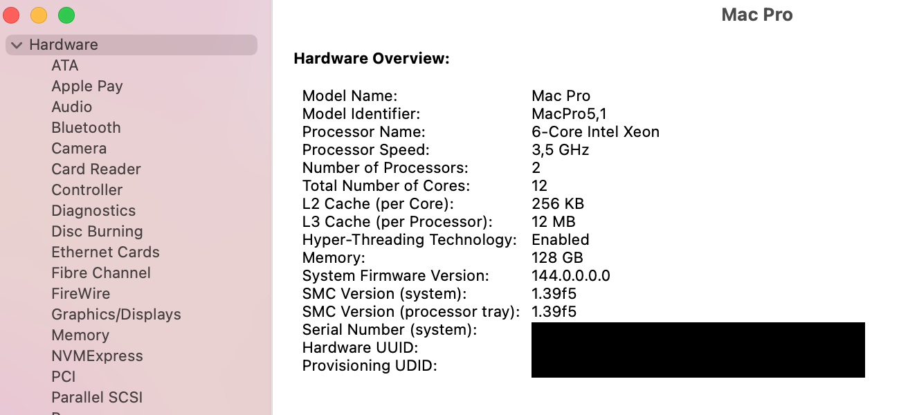

In the about dialog, if you open the system report, you should get something like below:
If your update "worked, you should have System Firmware Version 427.0.0.0.0, and your SMC Version should be 2.16f68. If not, your update did not successfully flash these two firmware parts. There are other parts of the logic board that could have firmware, but this heavily depends on the specific model. My MB10,1 received an update for the USB-C controller as well... It could be that the IO board on the retina mac pros 2013-2015 has received an update that cause that issue.
I have it : Wersja systemowego opr. sprzętowego: 427.0.0.0.0 Wersja SMC (system): 2.16f68
Ok, this are the firmware files that came with Big Sur. Assumption: Big Sur firmware install did go through.
