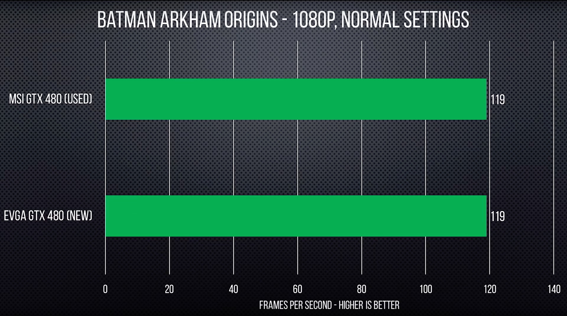

They dont.
"Slow down with age" implies a persistent and permanent performance degradation because of the age of the hardware. If it's reversible just by cleaning then it is NOT slowing down with age, it just means your machine is dirty.
Its an old myth that has been debunked. Thermal compound can be likened to motor oil on cars, where regular replacement is to be expected. (Thats why Apple's insistence on making access to the insides of your machine difficult, like on the imac, is an anti consumer move. You have to clean it once in a while you know.)
Linus did a test a couple of years ago debunking the "slowing down with age" myth, by comparing the performance of a GTX 480 that is brand new against one that has been used for 6 years. The old gpu has been used and abused for the whole 6 years. The results? the performance is identical.
What usually happens is the thermal paste gets dry and lose its efficiency in 5 years time, leading to thermal issues and throttling, giving the impression of “slowing down with age”. Another one is dust accumulation in the fans and heatsinks, further reducing its cooling capacity. Just clean it up and apply a new thermal paste and its brand new again.
Yes, with a little TLC there is no reason why laptops shouldn’t keep peak performance for many years.
The first opportunity for that is usually when the battery needs replacing. The way I use my MBPs, this typically happens after 4-5 years. Once you’ve got the machine open to replace the battery, clean it out, lift the heatsinks/pipes to remove the old, brittle thermal paste and apply some good quality stuff instead. There are lots of good instructional videos around to guide you.
I realise that this isn’t for everybody, but I reckon every Macbook owner can find a qualified service person to do this for them.

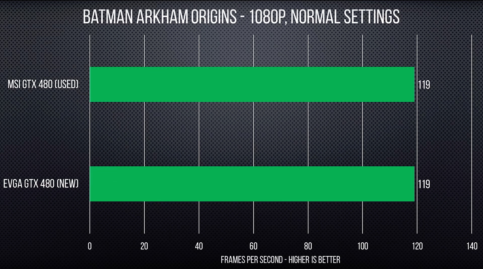

They dont.
I think that “slow down with age” in this case might had to do with spectre and meltdown mitigations for intel CPUs in recent years.
