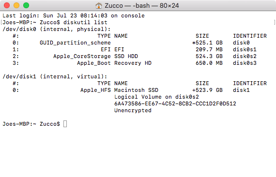

Thanks, I just upgraded the firmware to the latest and still no luck converting. I know this is beta but it's bugging me and I feel like it has something to do with my system or the way I set up the SDD. How does this compare to your setup?
More here:
https://forums.macrumors.com/threads/apfs-and-third-party-sdd-upgrades.2058279/#post-24832185
I removed the APFS volume by booting in with a secondary drive. It's a lot of work. You can't simply format in the GUI Disk Utility. You have to run commands under terminal to specifically remove the APFS container. Then I reformatted in JHFS+ and went back to my 10.12 OS. I ran trim force and it's now ok. So it is clearly a APFS/10.13 thing. I found 10.13 PB3 so buggy anyway. Even Drive Genius that is supposed to work with APFS was really buggy. I kept getting alerts each day from Drive Genius telling me my SSD is about to crap itself and to back up and replace the drive. The drive is fine. It's a Samsung 840 Pro. It's gonna last longer than me. I'm taking a bet now that they release 10.13 GM as a JHFS+ version only. It's a pre-emptive guess I know, but I'd be surprised if they release it knowing so many people have third party SSDs and are having issues doing to APFS transition. They'll do the APFS transition as a 10.13.X update. I mean APFS has trouble with core storage set ups as well (fusion and time machine). So what are all the iMac fusion users gonna do? Split the fusion (like I have on my Mac minis).
