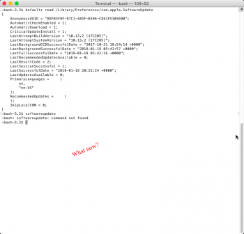

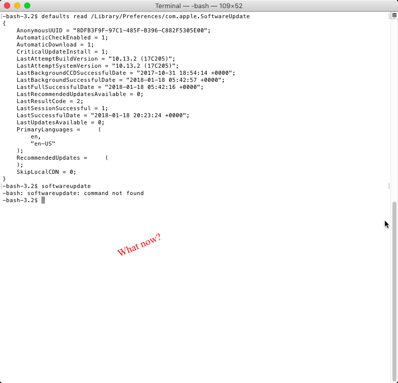

I was able to install 10.13.2 Supplimental to MacbookPro5,2 directly from the Updates tab in the "App Store.app" as normal, without issue.
You can run "softwareupdate -l" in a terminal to manully scan for updates, in case there's something odd going on with the "App Store.app"
You might have to run to the app "/Applications/Uilities/Patch Updater.app" then [View Installed Updates], right click on the [Software Update Patch] row and select [Re-install...] to make sure the modified update service is running.
You can also run "defaults read /Library/Preferences/com.apple.SoftwareUpdate" in a terminal and see some potentially useful info. I'm not entirely sure, but I don't think you should see a CatalogURL listing -- at least I don't, on my machine.
I attempted everything you mentioned. In regard to the "software -l" suggestion, the Terminal keeps saying that it can't find that binary/program. Which is strange because, when I tried ls'ing through the common PATH locations, I couldn't find the binary either 🙁 I also had the Patch Updater reinstall the Software Update Patch/service, which required a reboot. After the reboot, I opened the App Store (again), only to find that there are still no updates available (supposedly). With nothing coming to mind, I went on and ran your last suggestion - "defaults read /Library/Preferences/com.apple.SoftwareUpdate". I've included the relevant results in an attached png, for individual viewing (also for space-saving purposes).
TL;DR I have a feeling that there's something wrong with my MacBook Pro... 🙁
EDIT :: Is there a way I could download any missing files from a secondary source? Maybe I can replace whatever's missing...
