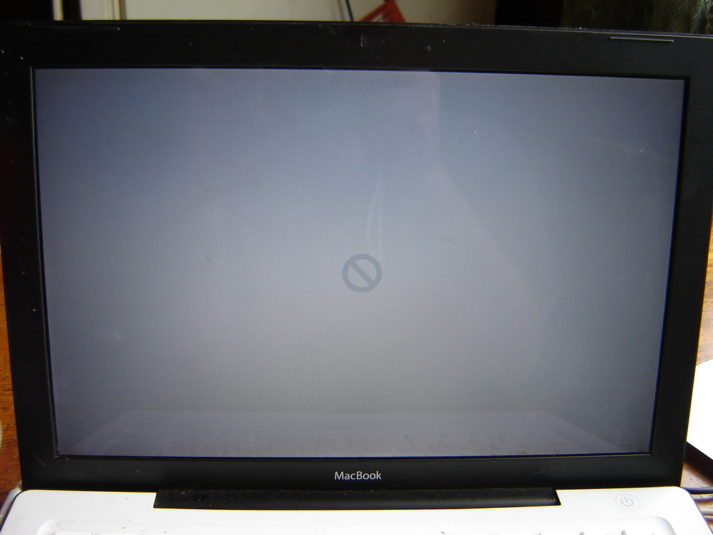

how do you all get the erly 08 macbooks to install 10,13 ? evey time i try it wont even boot the usb im met with this screen. also the first time i try it reboots and then the second time i try it boots from the usb but gives the following screen. what am i missing ?
NOTE: this is the early 08 black modle
That's a MacBook 4,1, this patch isn't compatible with that machine. Only the Late-'08 aluminum model (5,1) and newer are.
