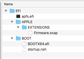

To be absolutely clear, what should be deleted in the System EFI partition in the following screenshot?
Thanks.
Yes, currently the APFS patch must be applied, as it removes the system compatibility check from the APFS preboot volume. I will be releasing a full patch soon that will perform all the modifications necessary. But for now, just do what others have done: Apply APFS patch even after the FW update, then just delete the EFI boot files in your EFI System Partition to get rid of the old boot method. Or, you can just set your startup disk to the APFS volume in System Preferences.

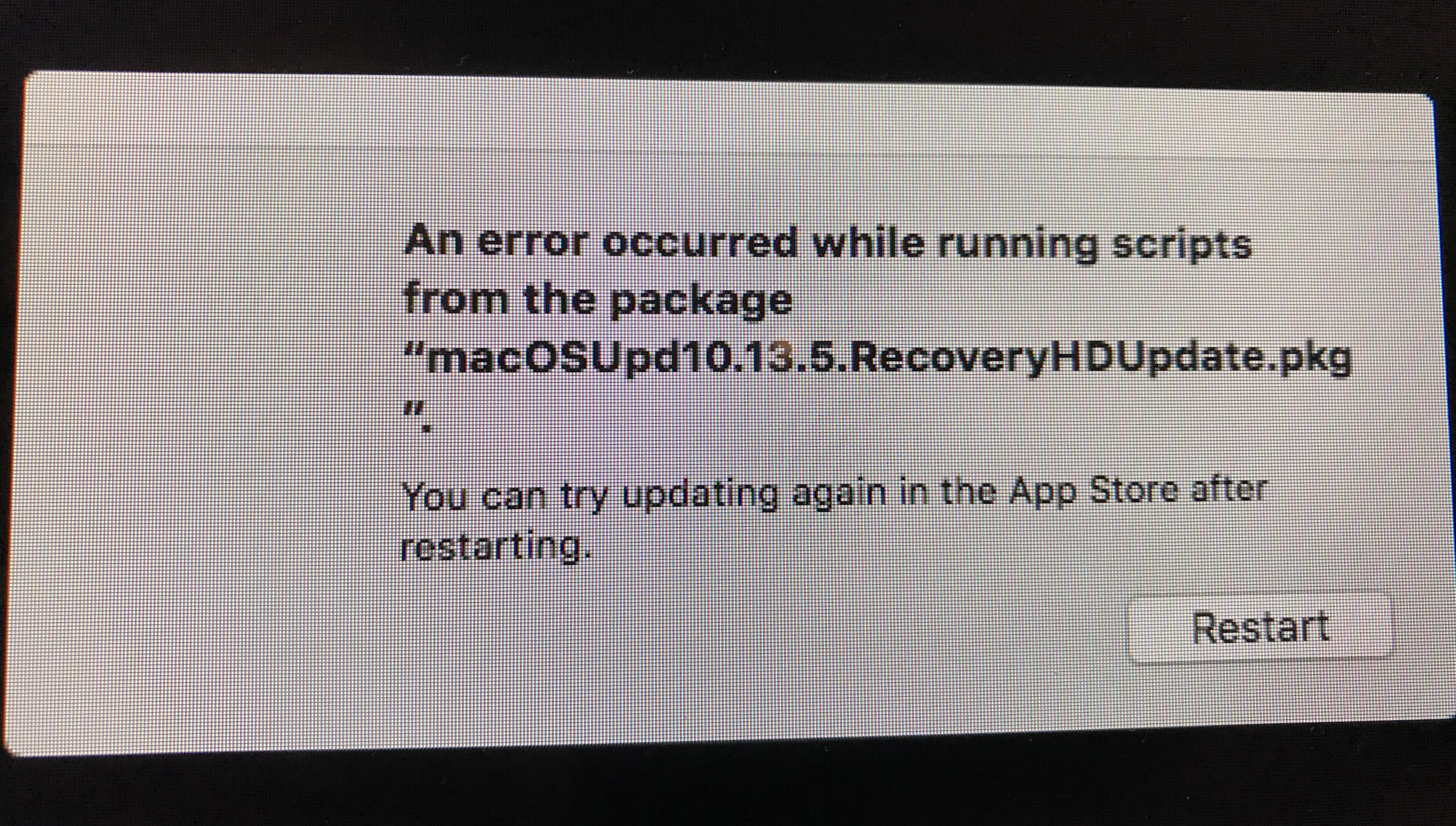

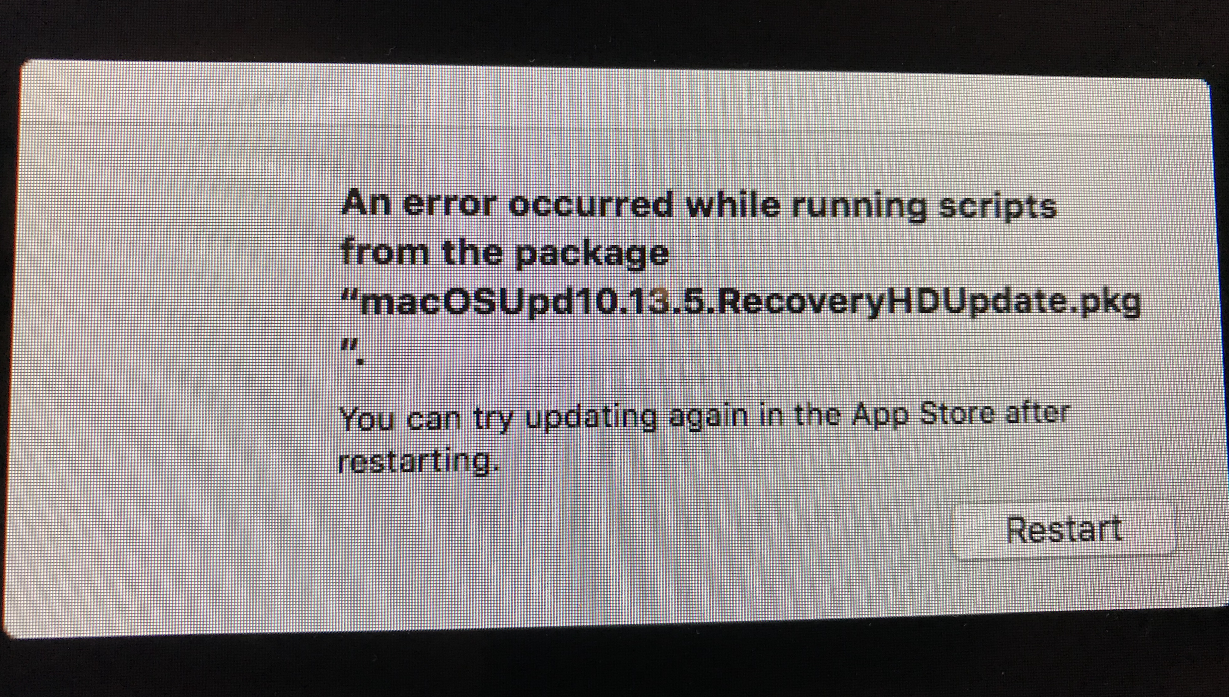

Just attempted to install 13.5 update (iMac 9,1 running 13.4) through the app store and on restart the update got just past half-way and then this error:
And my system now incorrectly says it's on 13.5 and no update available in app store.
