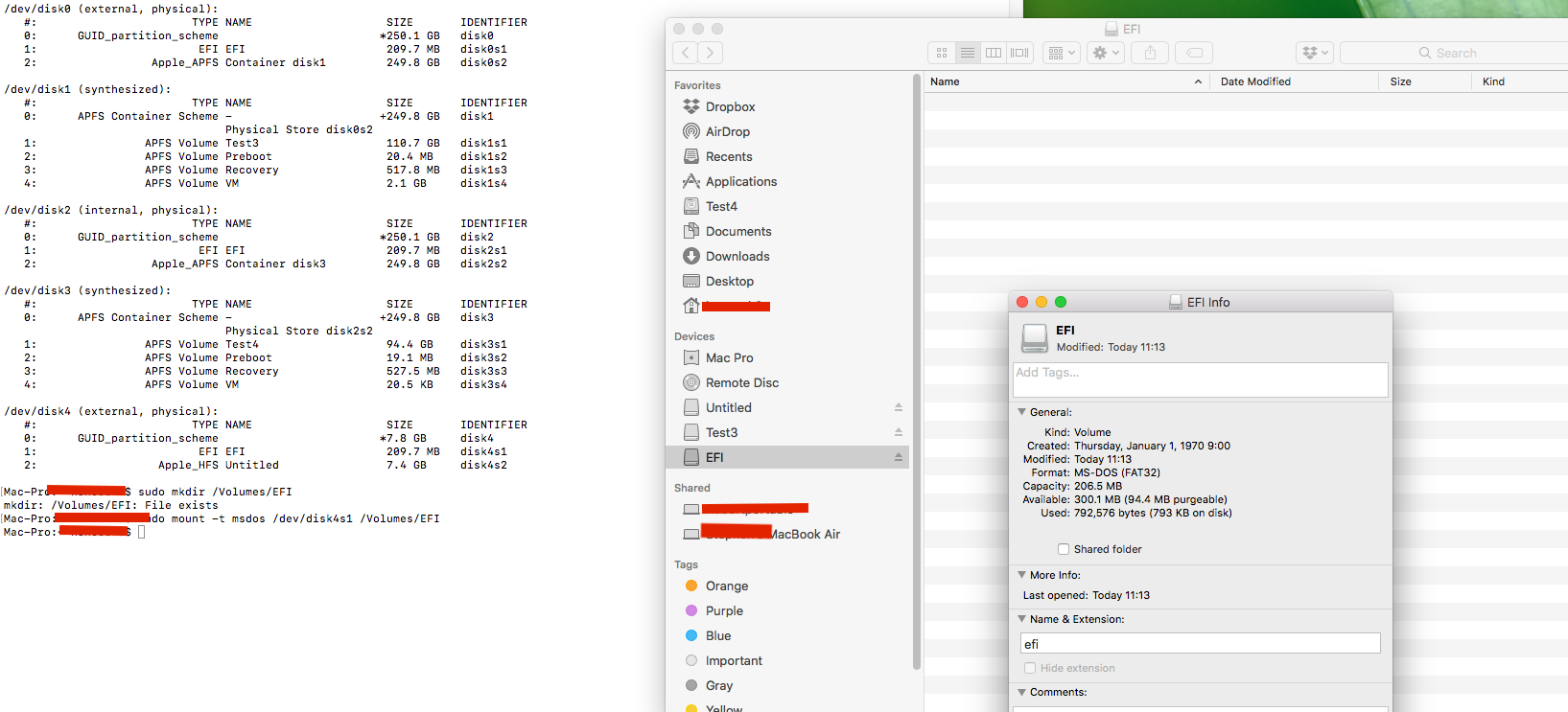

dosdude1,
First, thanks for all your time and efforts. I have a successfully boot-rom-patched MacPro 3,1 but I'm having problems creating a USB installer for 10.13.5 using your 2.6.2 patcher. I've tried 4 times, using both a full Apple 10.13.5 installer directly from Apple and downloaded using your tool (and downloaded this tool twice too). Each time I get a successful build but the US installer does not show in the boot screen when booting with Option pressed. If I move the USB installer to a regular supported Mac, it shows up fine in the boot screen with Option pressed. I have also tried building the USB installer on a supported Mac and on the boot-rom-patched MacPro 3,1. Same issue.
I've never seen this problem before and this USB key has been used previously to build full installers for 10.13.4.
Any ideas would be welcome. I include a screenshot of the USB installer file system—and of the EFI partition on the USB installer, which seems to be empty; is that as it should be?

Here is screenshot of a section of the install log with the Recovery HD error reports. Any ideas on how to get past this.
You guys with the recovery updater problems: did you convert from HFS to APFS with Disk Utility and thus don't have a recovery volume inside the APFS container? I have a normal APFS layout (main volume, Preboot, Recovery, VM) on my iMac7,1 since I installed HS from scratch, and I didn't have this recovery updater issue.
If you don't already have the recovery volume inside the APFS container (or any of the other volumes HS expects on APFS, do a 'diskutil list' in Terminal to be sure) you could try the following in Terminal to add those volumes and see if it works with the updater:
Where X is the disk number of the APFS container not your main HS volume:
Code:
diskutil apfs addVolume diskX APFS Preboot -role B
diskutil apfs addVolume diskX APFS Recovery -role R
diskutil apfs addVolume diskX APFS VM -role V
