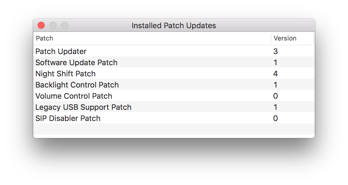

I've upgraded from iMac late 2007 (with High Sierra Patch) to mid 2011 (supported by High Sierra) and now I can't enable SIP anymore.
I installed a fresh High Sierra on the "new" iMac and then recovered all my files and applications from a Time Machine backup. After that, I downloaded from the Appstore the latest updates until the Security Update 2019.1 and it clearly performed an EFI update (the long BEEP, the thick status bar…).
I thought that SIP was normally enabled, but in Terminal I get this:
csrutil status
System Integrity Protection status: disabled.
I booted from the recovery partition, and in Terminal I wrote "csrutil enable" and after that, a message told me that System Integrity Protection was enabled.
I reboot again but in Terminal I get again
Is it possible that the SIP Disable Patch is still active on my system, even after a fresh install? Was maybe recovered from the Time Machine backup?
If I launch the Patch Updater I can see all the patches that I installed in the previous system (see screenshot), but I think this is not really the actual situation of my Mac, or is it?
I can live with SIP disabled, obviously, but since I'm using an EXP GDC Beast eGPU with Nvidia web drivers, I'm doing some experiments and I wanted to check if this setup can work even when SIP is enabled or not.
