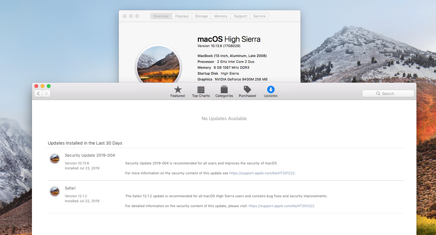

I just did a clean install of HS using a modded dosdude’s installer (recovery partition modded using the standalone Security Update 2019-004), restored from a TM backup and was then able to install SU 2019-004 from the MAS without issues. A bit of a long way around but I wanted to do a clean install anyhow.
so if I am correct here, Security Update 2019-004 can just be installed fine from within the Mac Appstore ?
No need to apply the patches.. ?
This is exactly what I did and it worked great on a MacBook5,1. The only patch that I had to re-apply(manually) is the Night Shift. I am using APFS if that makes any difference. And of course MacBook5,1 is pretty much natively supported for High Sierra hardware wise.

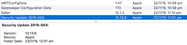

I had a look at the install log and although I don't understand much I picked up some lines that do indicate a success:
2019-07-22 23:57:04+02 MacBook system_installd[703]: PackageKit: Executing script "replaceRecovery" in /private/tmp/PKInstallSandbox.AMrd1d/Scripts/com.apple.pkg.SecUpd2019-004HighSierra.RecoveryHDUpdate.17G8029.n2GS9P
2019-07-22 23:58:04+02 MacBook system_installd[703]: replaceRecovery: APFS EnsureRecoveryBooter: UpdatePreboot: Exiting Update Preboot operation with overall error=(ZeroMeansSuccess)=0
2019-07-22 23:58:04+02 MacBook system_installd[703]: replaceRecovery: APFS EnsureRecoveryBooter: Operation 100.0% complete
2019-07-22 23:58:04+02 MacBook system_installd[703]: replaceRecovery: APFS EnsureRecoveryBooter: Operation fully complete
2019-07-22 23:58:04+02 MacBook system_installd[703]: replaceRecovery: APFS EnsureRecoveryBooter: Operation finished
