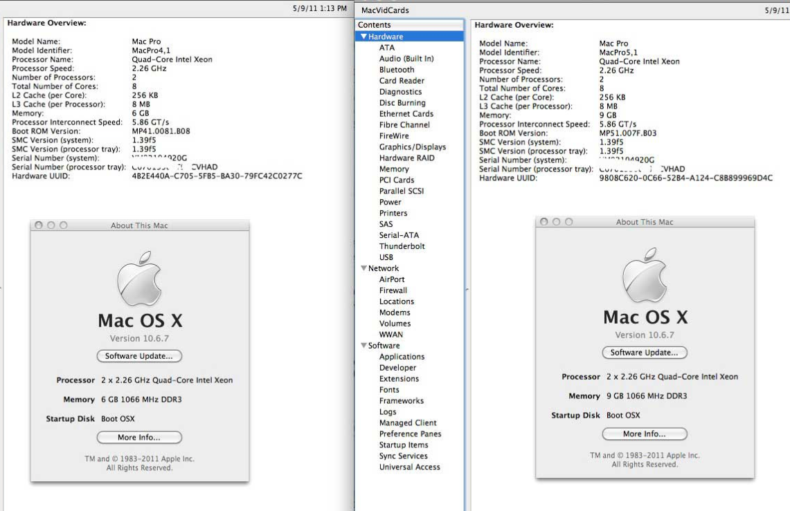

An efi-flashed PC Radeon HD5770 may not be enough because the MP 4,1 shipped with the GT120 as the standard option and the HD4870 as the custom option. Also efi-flashed 5770 cards are not exactly identical to Apple cards.
The best chance of success is to use one of these cards and dosdude1's suggestion.
What is the current boot rom version? Is it B07 or B08?
