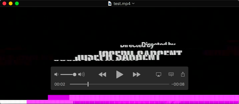

As far as I know, handbrake 1.0.7 for Mac does not use the GPU for file conversion - at least not on Macs as old as mine. So any graphics driver issue for my GeForce 9400M shouldn't affect the conversion. But why does QuickTime only have trouble playing files converted using macOS High Sierra while it does play the files converted using macOS Sierra (and the very same handbrake version!) just fine?
If you'd like to test it, I uploaded a 10 seconds excerpt from the file converted in macOS High Sierra (620 KB) here:
https://www.dropbox.com/s/8ww0rz1g7hwg62z/test.mp4?dl=0
That file plays perfectly fine for me.
MacBook5,1 Core 2 Duo 2.0 GHz with GeForce 9400M and macOS 10.13.1, Safari 11.0.1. It also plays perfectly with QuickTime 10.4 (928).
However, the video in the X on www.apple.com/iphone-x is still garbled for me (and others).
EDIT:
Weird. It played fine in QuickTime fine the first time, but then it didn't.
So, then I logged out and logged back in and played it again in QuickTime, and it was still problematic. I then tried it in Safari again, and it was fine, and then tried it again in QuickTime, and it was also fine again.
When it works fine in QuickTime:
When it doesn't work fine in QuickTime:
The only difference is for the first image, I played it in Safari first directly from DropBox. It always plays fine there.
After I play it in Safari, then it sometimes works fine in QuickTime (but not always).
Very strange.
Weird. It played fine in QuickTime fine the first time, but then it didn't. (...) After I play it in Safari, then it sometimes works fine in QuickTime (but not always).
Very strange.
Very strange, indeed. (But thanks a lot for testing it so extensively!)
Further testing on my MacBook Pro implies that it could be coincidental: I found some other files that don't play properly in QT under macOS High Sierra (while most play fine) – all of wich where converted using handbrake in macOS Sierra or previous versions of the OS. And I found that when I convert files that play fine in QT using handbrake in macOS High Sierra, the result also plays fine. So I still have no idea what causes the problem in QT; but it does not appear to be so that any conversion with handbrake in macOS High Sierra automatically produces a problematic file.
Erratic behavior like this does, however, not build trust ... so I'm still not sure I should continue converting files in 10.13.1 ...
Any idea if tinkering with the NVIDIA-kexts could help? Like replacing them with with old ones from macOS Sierra? However, I don't really know where to start with something like this, I'm afraid.
