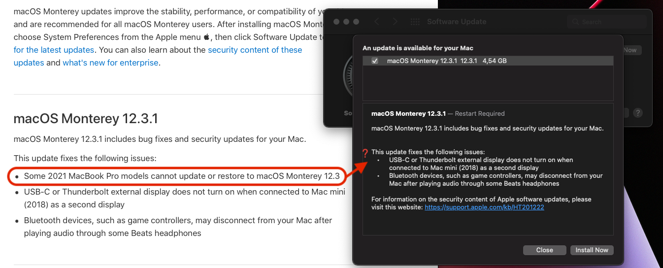

Ok, Before I click, I'd rather ask you. I wonder why on the list in system preferences (software update section) there is no this point about MacBook Pro issue from apple site. This point is related my MBP 2021 M1Pro issue. Is it the same patch or can i download it from another source?

My own experience: after multiple failed attempts to update to 12.3 the update to 12.3.1 was successful. I hadn’t had a logic board replacement, but firmware had been updated by Apple in January.

JakubZ I am happy to report that I, just now, was able to install the 12.3.1 with no issues. And, to be clear, the 12.3 update did brick my 14" M1Max MBP, and it's logic board had been replaced prior to attempting to install 12.3.
