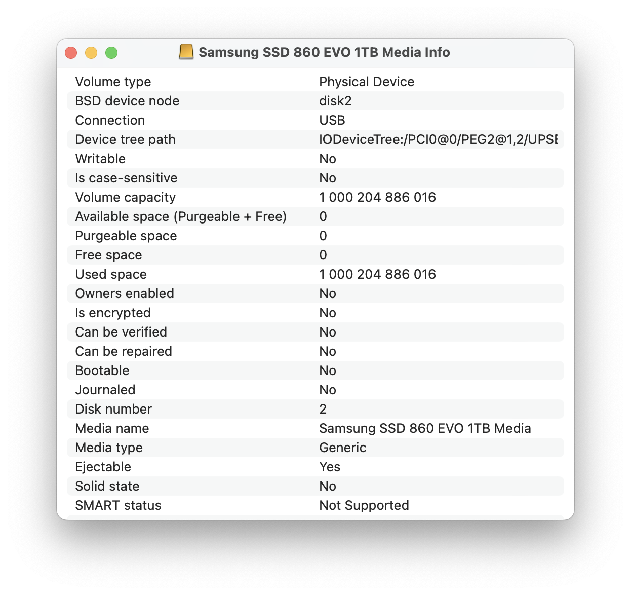

Second last line. I can post lots of more of these, if you need.
I assume this comes down to the controller chip in the USB enclosure.
It does not even support the S.M.A.R.T status - have you tried a different adapter?

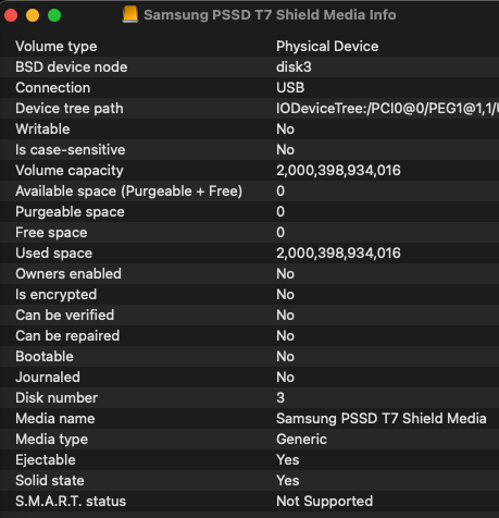

I didn't think SMART worked on external disks? I have a 2018 Mini with a bunch of USB external SSDs, three are always connected, they are properly identified. Here's what I get with a 2tb Samsung T7 USB SSD.

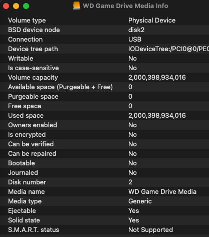

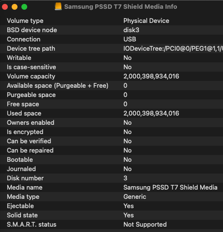

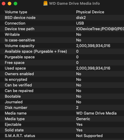

This is a 2tb WD Black USB SSD
