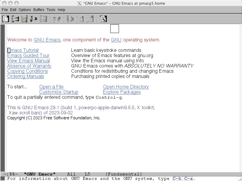

I spent a couple of days tinkering around, and I've finally gotten a modern version of Emacs (29.1) to compile again on PPC. It currently doesn't work due to some missing functionality in legacy-support, but I submitted a patch that works around the issue. If anyone would like to try it early, let me know and I can write a guide on installing it.
As a side effect, it should (I can't personally test since I don't have an Intel Mac) also restore Emacs support for 10.6-10.8 as well, which seems to have been broken for a while now.

Unfortunately, I'm only able to get the terminal version working at the moment, the GUI part indeed uses a bunch of Obj-C code that seems to rely on functionality introduced in Snow Leopard.

Unfortunately it appears pkg-config didn't detect a lot of the dependencies I had installed. I'll have to take another pass at this.
Also the icons appear corrupted.
