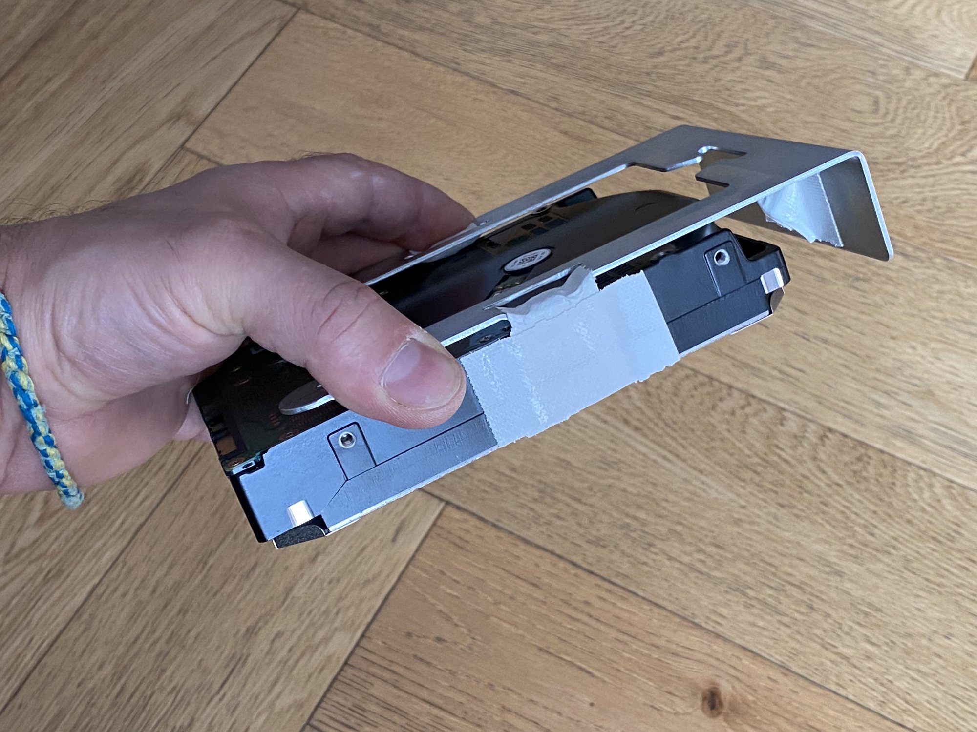

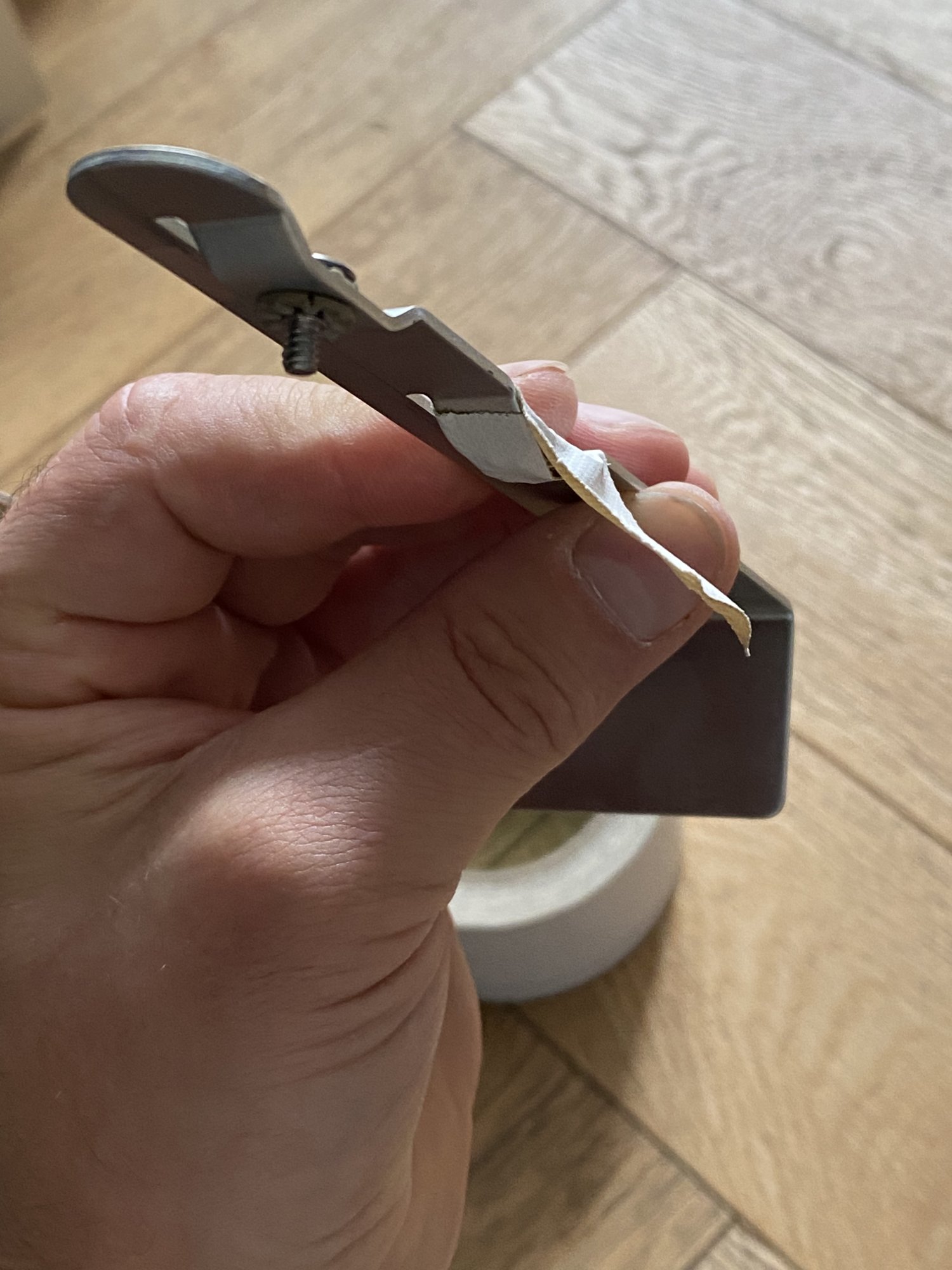

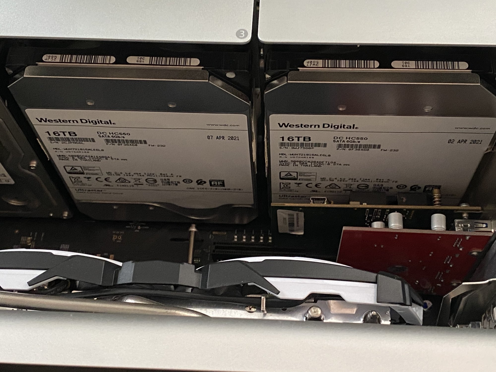

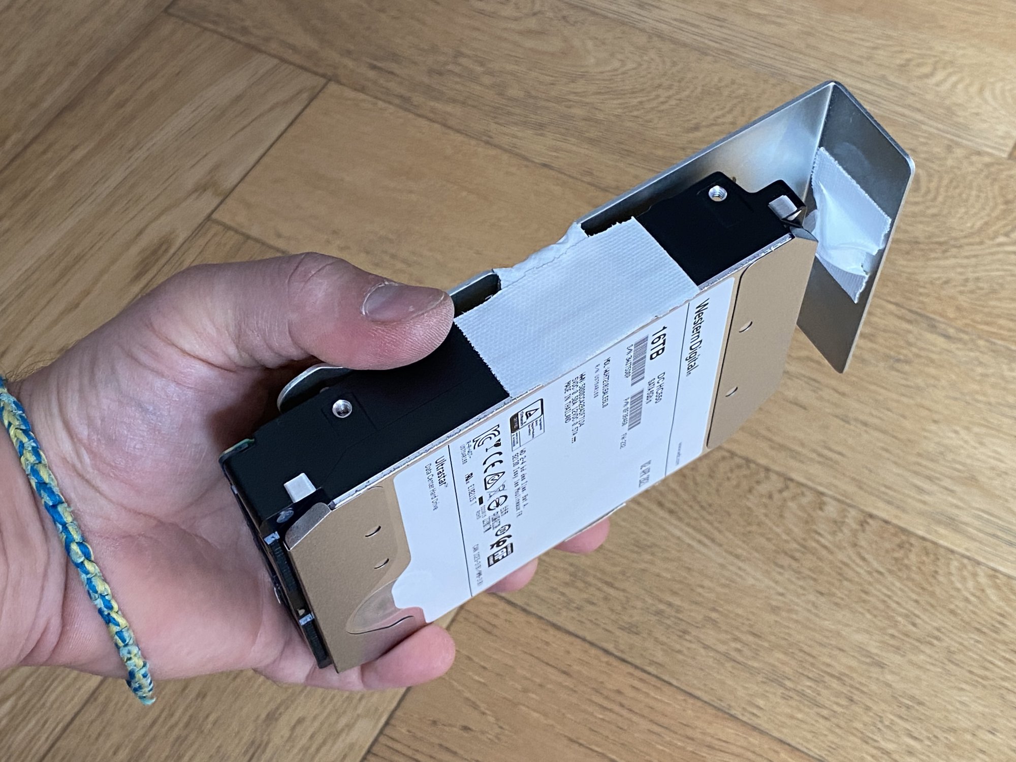

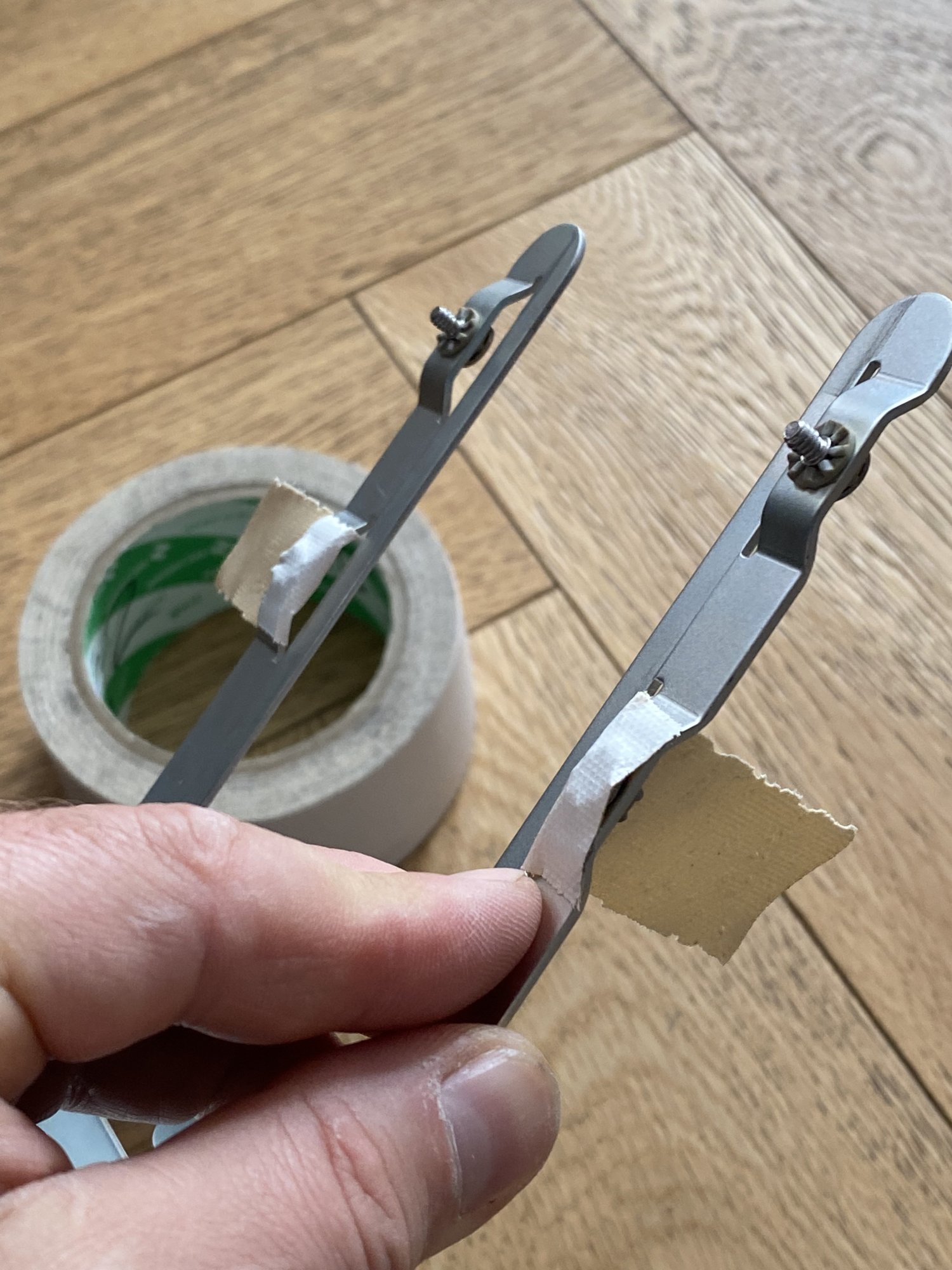

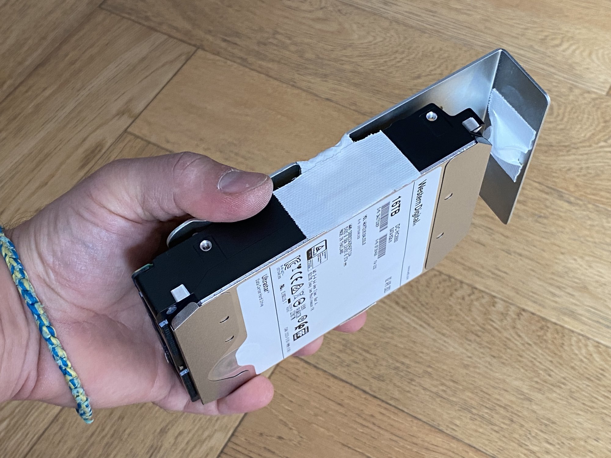

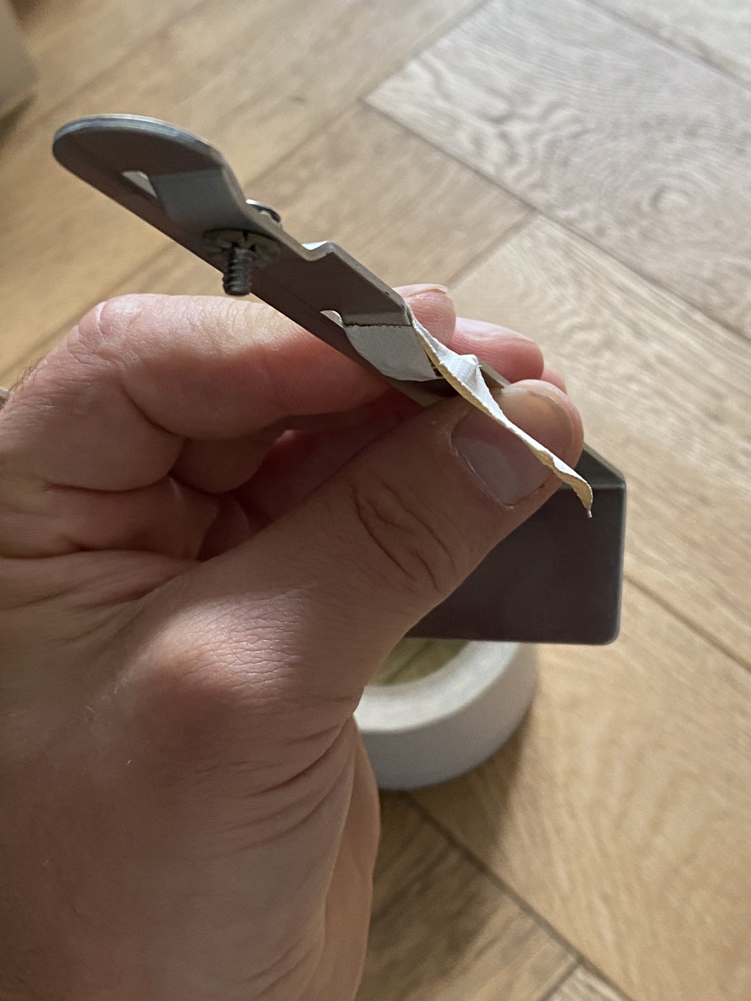

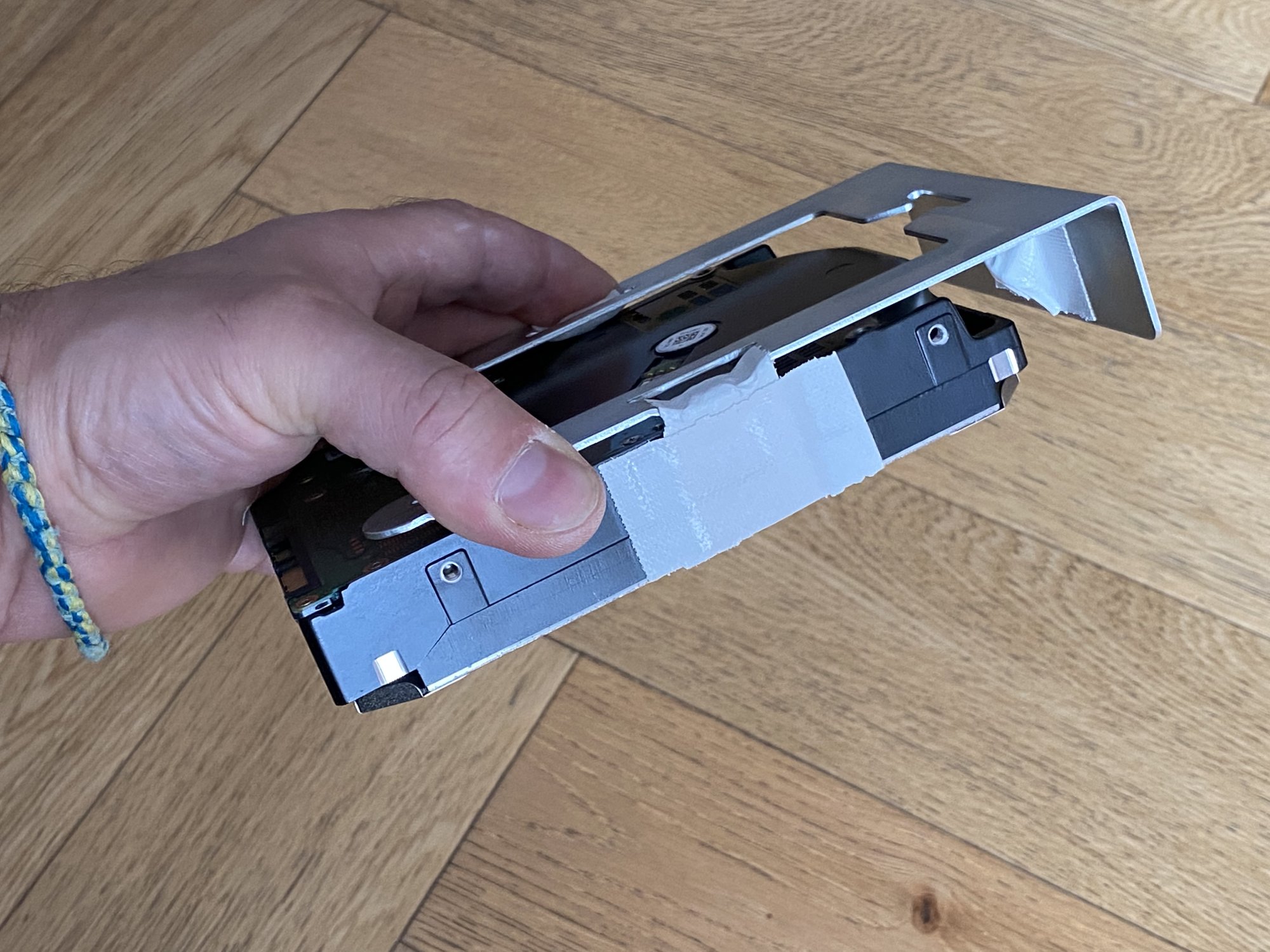

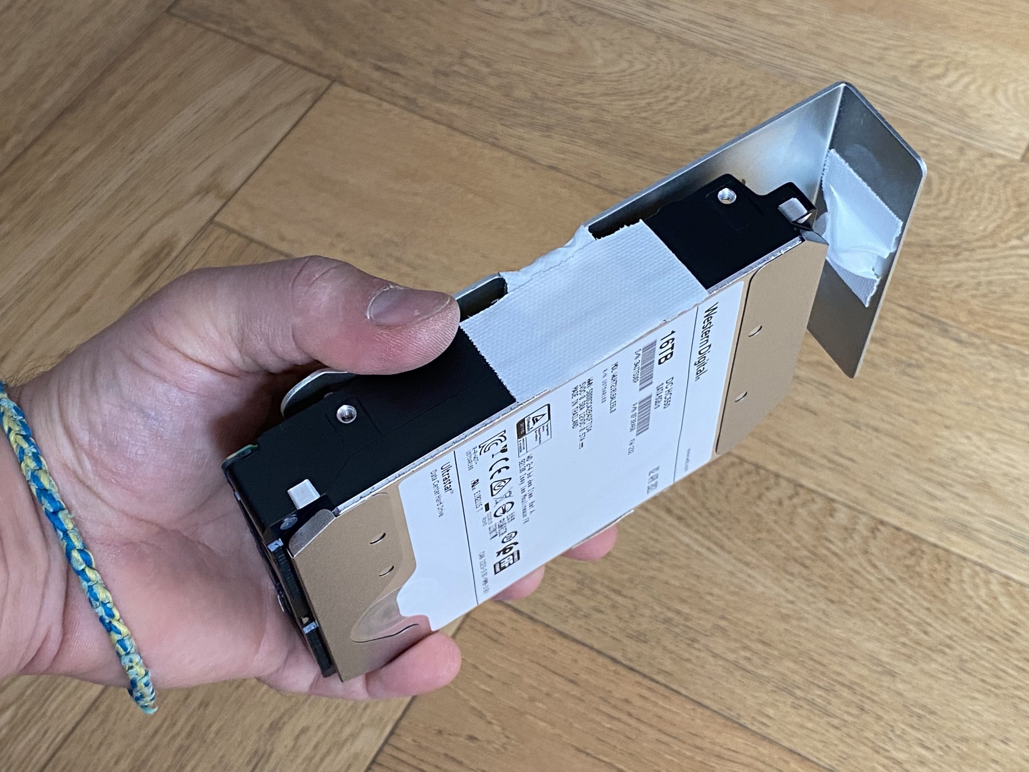

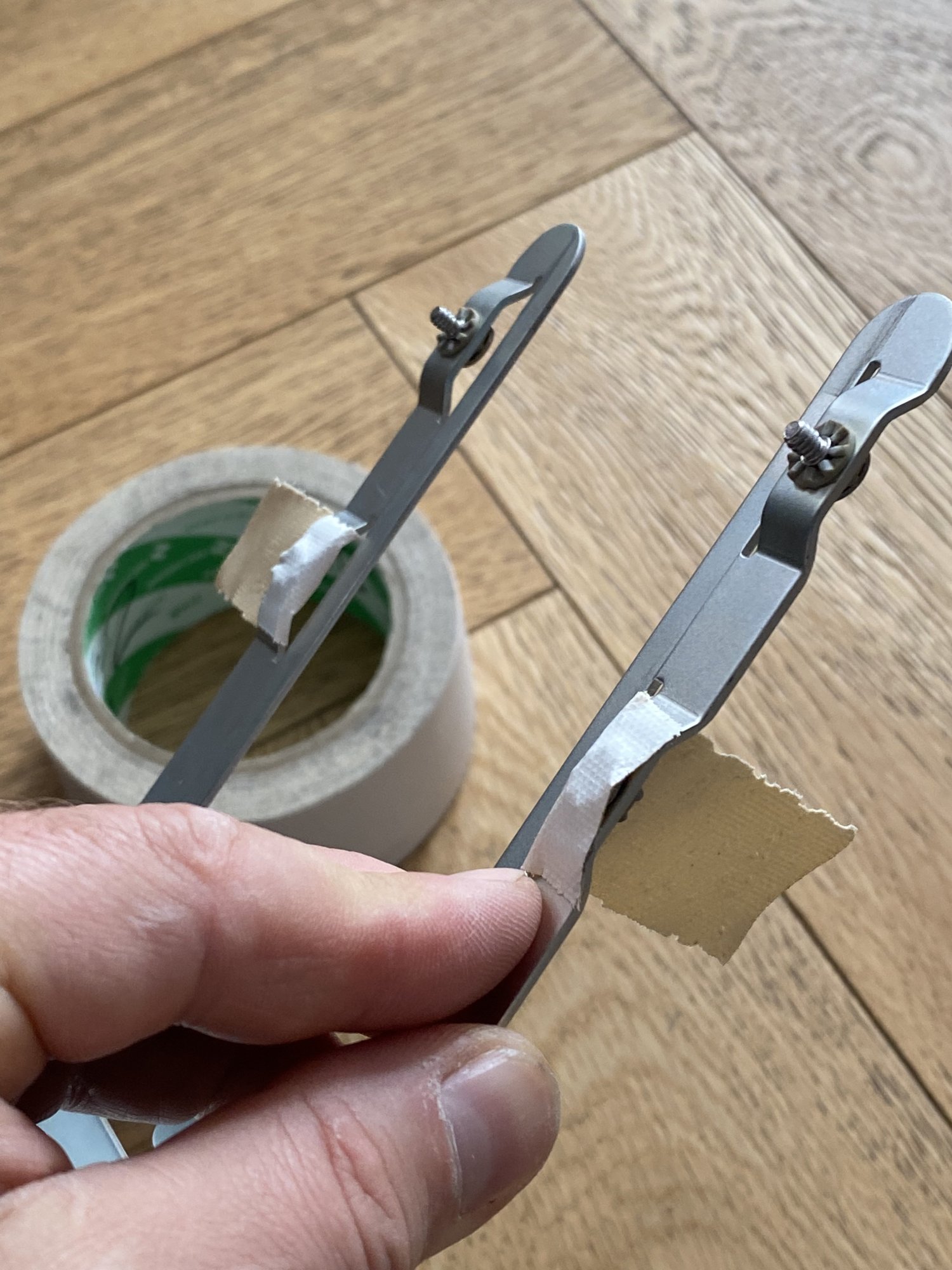

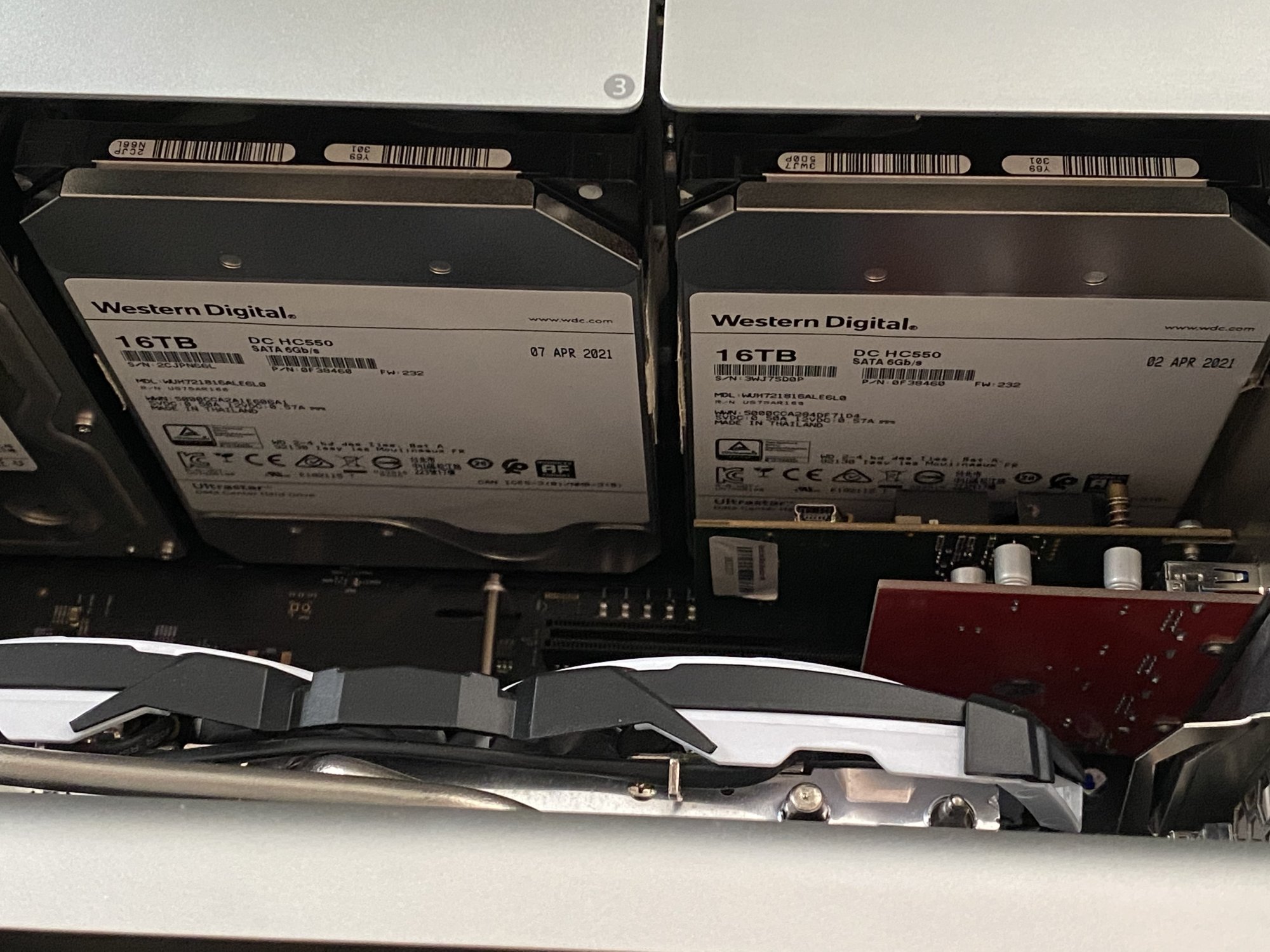

Just installed 2x 16TB Western Digital Ultrastar DC HC550 (SATA 6Gb/s) WUH721816ALE6L0 512e ISE in a JBOD softraid with Raid Assistant. Upgrading from 4x 6TB HGST which worked fine for years.
All works on a cold boot but not on a warm one. Used gaffer tape for mounting with the traditional sleds. Placed the redundant screws also with piece of gaffer behind the handle. All works fine on Monterey 12.5.1 😎
Cheers!

Thanks, I like the gaffer tape idea with the traditional threads. Any long term experience with how that will hold up over time? Or I guess we'll find out. I'm not sure what you mean by them not working on a warm boot though.

I do not recommend this approach.
Tape adhesive does not hold up long term, especially in situations where it's exposed to heat or oscillating temperature changes. Over time, that tape is likely to fail and the drive will fall loose from the sled at an angle, which will torque the drive connector on your backplane/main board and destroy the board, your drive, your data, and possibly other components in your system in the process.
If you're going to use a poor man's solution like this, try wrapping the drive tightly in a complete circle of tape (more than once) so the length of tape acts as a restraint (or safety net, if you will) against the drive falling. Better, but still not a great solution.
A great solution: Buy a new tray. They cost less than $20 and that's a tiny investment to guarantee the safety of your (very expensive) equipment and your data!

Hi Soba, I know from experience that proper gaffers tape will hold, even if it will get hot. But you have to use real Gaffa tape, preferably from a brand like Nichiban not a fake one like duct tape. The difference is described here:
Of course a dedicated tray is a better option, but this solution works fine for me atm. Cheers!

Thanks for responding. Yeah I know it’s looks ‘crazy’ to use Gaffa tape, but you would be surprised how often tape is being used in high-end applications nowadays. And I don’t want to spend money just for cosmetical reasons while this works perfectly. Remember, the drives are still in place by two screws, the tape is just to hold the drives ‘up’ and it does the trick great. Personally being a fan of DIY solutions I prefer to stick 😉 with this method, but anyone is free to do otherwise.

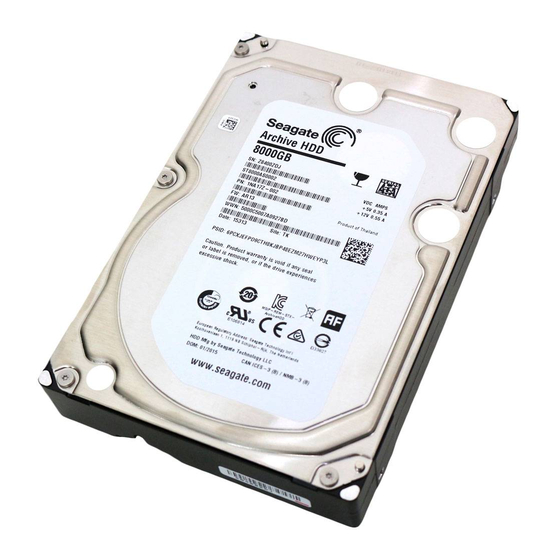

Short of going through the 300+ posts here, is there a 'rule of thumb' as to which capacity drives have the holes in different positions. I am looking at Seagate Baracuda 4TB/6TB/8TB HDD, and want the largest without a new bracket.

I remember reading due to the additional sealing requirements all helium drives moved said holes away from the middle.
That doesn‘t mean there aren‘t also non-Helium drives with the new holes (to fit slightly larger or more platters) but Helium should be a dead giveaway.
edit: seems like 4 disks is the limit for Seagate:
- The 3 disk 6TB ST6000DM003 and the 4 disk 8TB ST8000DM004 have the standard mounting points
- Both 6 disk 6TB ST6000AS0002 and 6 disk 8TB ST8000AS0002 have the new ones
