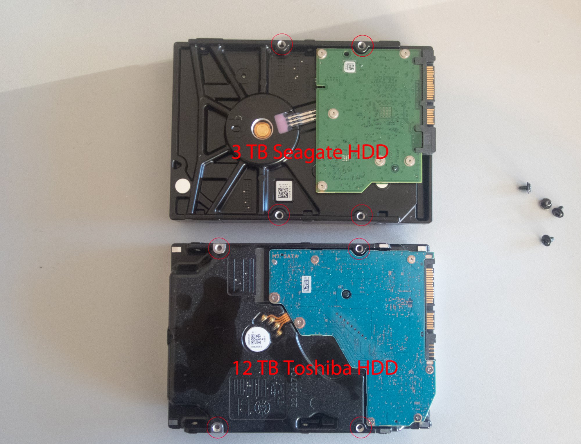

An update: I purchased 3 of the new style drive trays from OWC Europe (costing me quite a bit though: around EUR 94/US$ 106 with shipping/import duties), but at least I don't have to worry about the drives falling off 🙂
They were indeed a little "off" lengthwise compared to the original Apple trays, but I haven't experienced any "bulging" towards the computer's side panel. I've so far only mounted two new trays, but hope I won't experience the problems others have had in this thread.

Regarding the "new screw-hole layout" sleds: I bought mine from the OWC European store and they were also slightly off-spec as described earlier in this thread. They probably all come out of the same production moulds/machines anyway.
The problem is that because they physically touch the removable Mac Pro side-panel, the spinning HDDs sometimes transfer vibrations through them (the original sleds don't). That's my experience anyway.

As far as I remember it used the "new style" screw hole layout (hence the need for replacement drive trays/sleds from OWC) and there have been no issues with it (although DriveDX has reported 1 instance of "Overlimit shock events". From what I've found out this means it might have gotten bumped while in use or something, but I've never had any rear/write problems or anything like that.

My Sharkoon BayExtension adapter (see photo in another posting of mine) turns out not to screw holes for the "new style" layout which my 12 TB drive uses, but only takes "old style" HDDs:
So I either need to precisely (not very easy without the right equipment) drill two new holes or get another mounting adapter which does take "new style" HDDs, and attach it with those thick rubber cushions.
Judging by the photos it appears your Orico mounting adapter is similar and doesn't take "new style" HDDs either. Correct me if I'm wrong.

Yep you are correct, the holes in the Orico are closer together....unfortunately.

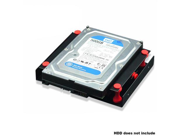

I did come across an interesting one though, in the context we're talking (mechanical noise reduction): a shock absorbing 5.25" to 3.5" adapter which I'm pretty sure would help:
(photo taken from Newegg.com)
The HDD appears to be mounted from the sides. I'm not sure if the screw-hole spacing is the same or different between new and old HDDs, but might be worth looking into if the underneath screw-holes for "new" style HDDs aren't available.
