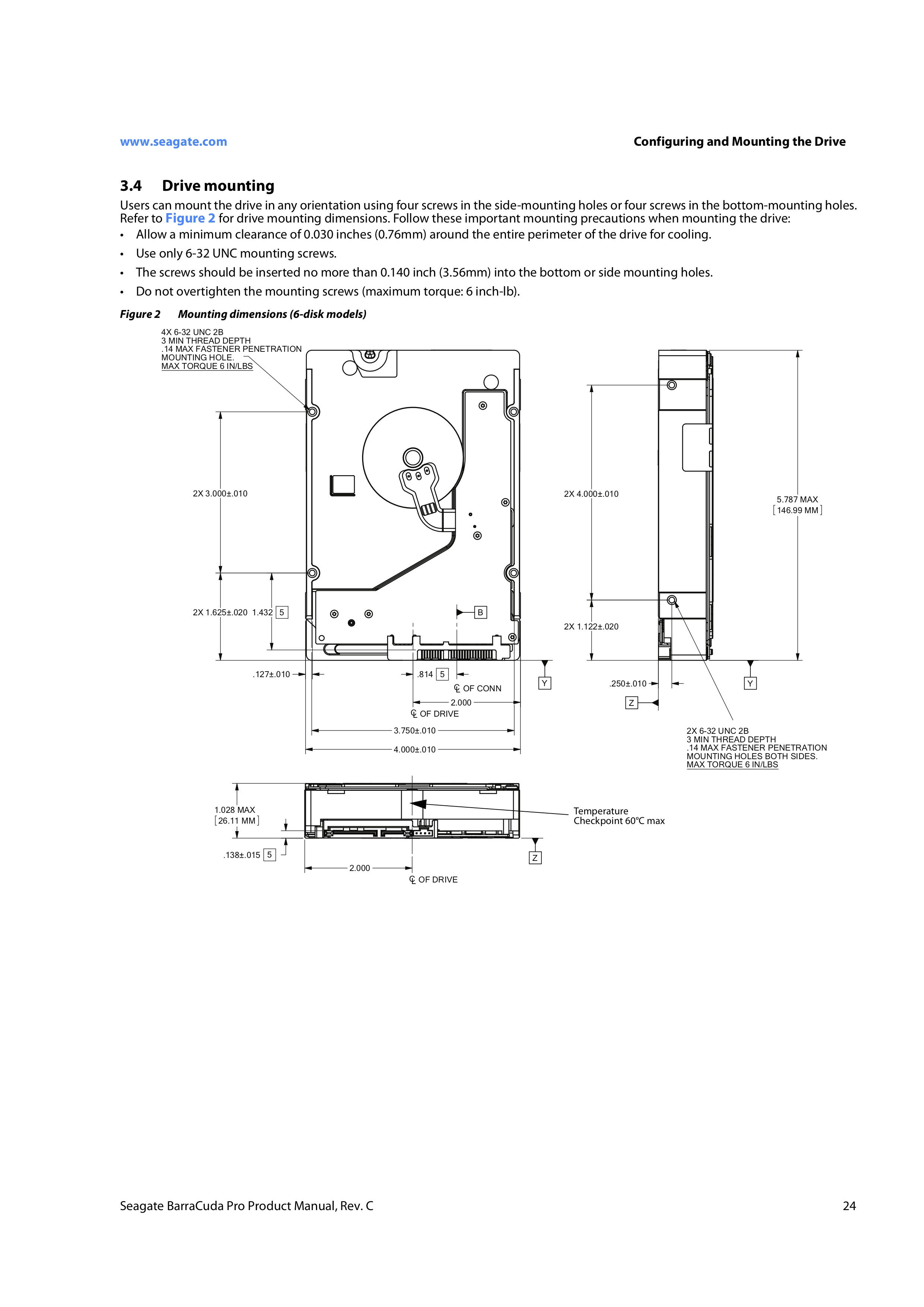

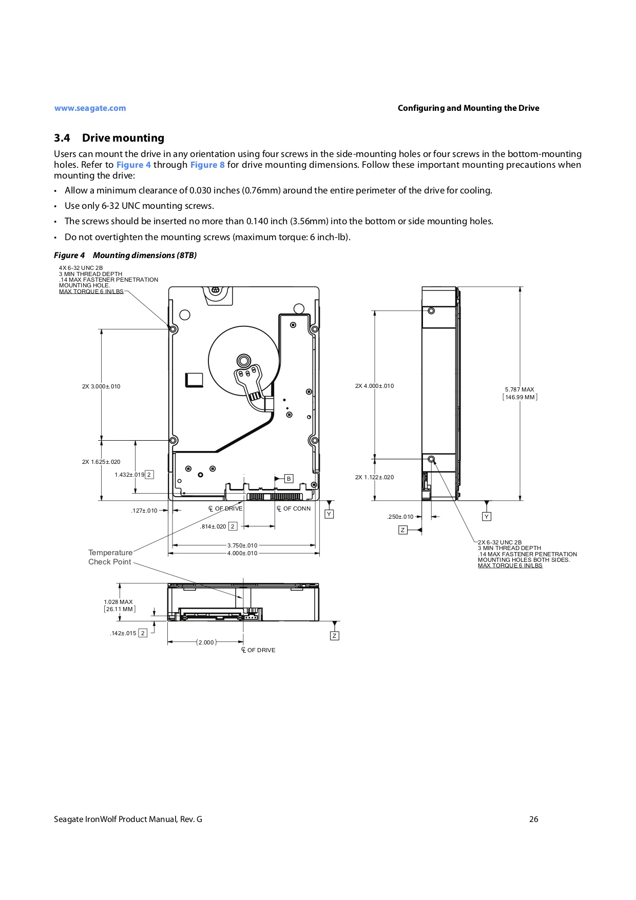

Edit: I'm note sure the 8TB barracuda pro will work, as I see the hole (on seagate's website, user manual for 8TB) exactly like those of the ironwolf.
Smaller barracuda pros have different screw locations than the bigger drives.
Am I looking at the wrong image?
Not 100% sure, but that would be consistent with high capacity HGST drives made in the past few years.

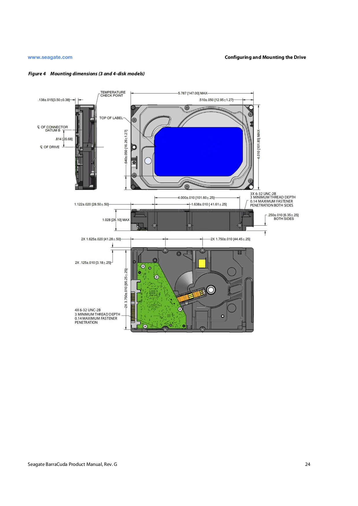

Thanks for correcting me. I double check my work and know what's wrong now. I was actually looking at the BarraCuda 8TB manual (not the BarraCuda Pro 8TB).
