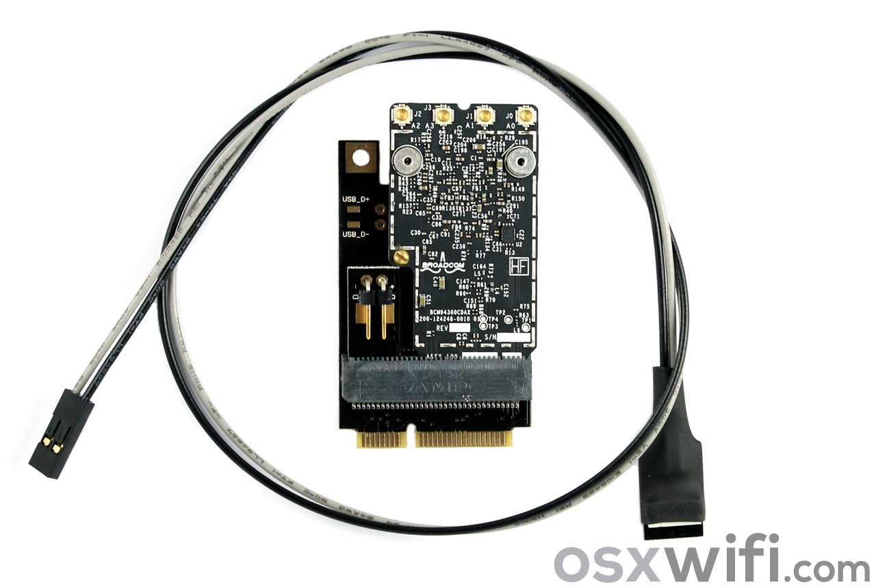

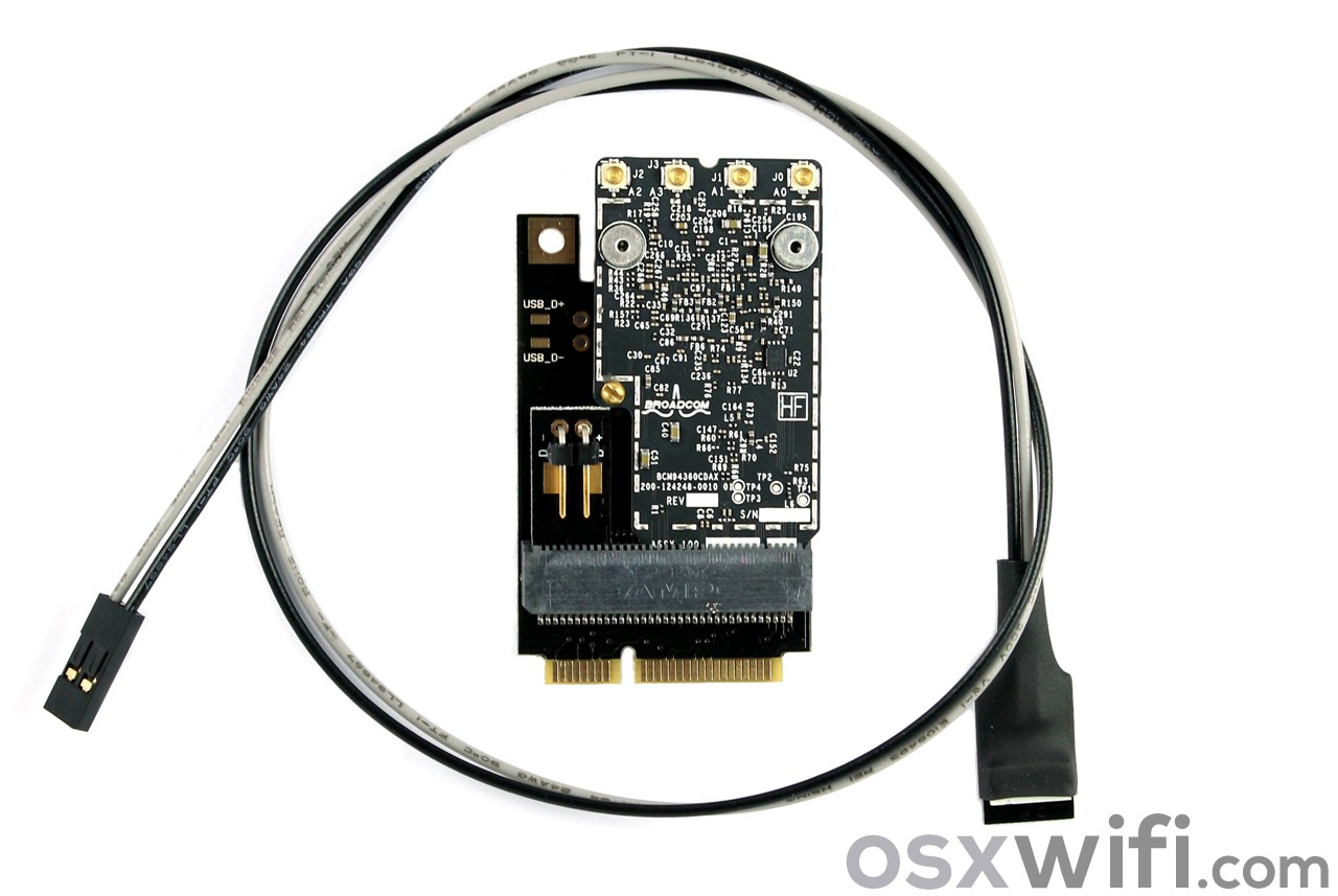

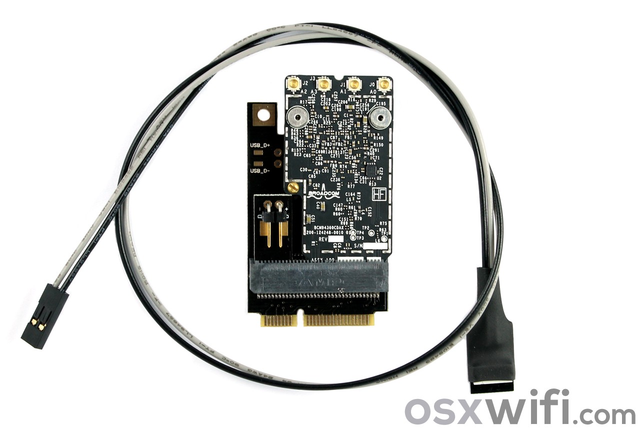

The Bcm94360cd card requires a special form factor adapter with a power cable connection to connect it's BT to the factory's motherboard BT power connector . It also requires a BT antenna extension cable to attach to the chassis' BT antenna .
Wow. First I've heard about a power cable. I have thought about buying a 4,1 or maybe 5,1 and use it for parts, but what are the chances that the part that is failing in mine has already failed in a used one. Hmm...
