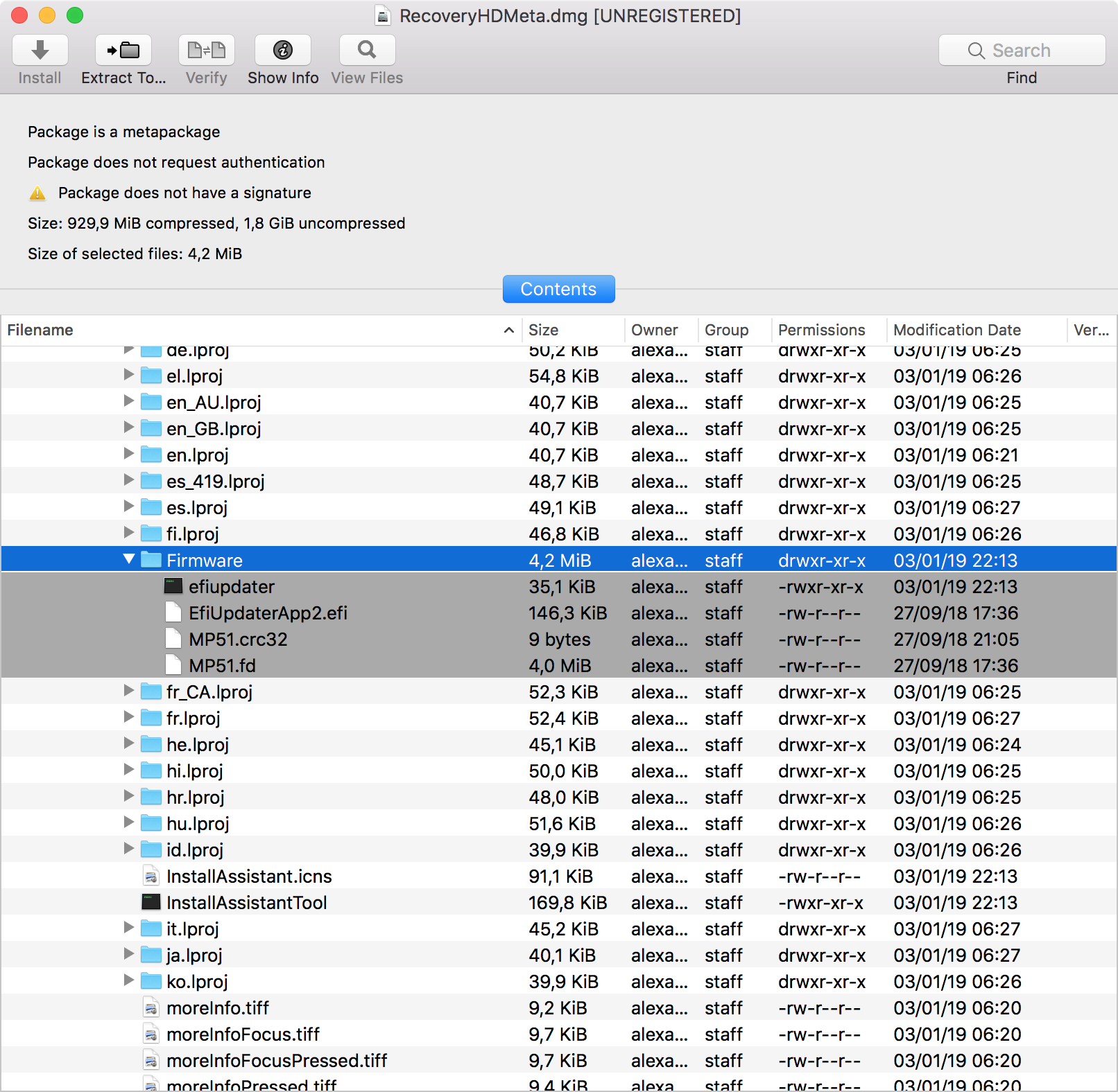

Thanks Alex, so I guess I can flash the firmware to 140.0.0.0.0 simply by doing a reinstall of Mohjave from the App Store!?

Today's 10.14.3 DP3 still has 140.0.0.0.0:
When I'm not busy, I usually read all new posts into the Mac Pro area. I started to notice in the last two or three weeks a lot of people having unbootable Mac Pros, probably some bricks too. Could be totally unrelated to the BootROM and just plain hardware failure and since most, if not all, are users that can't provide dumps from the SPI flash, we probably will never know for sure what is going on - but this is getting me a little worried that something weird is happening with all this Mac Pro problems.
