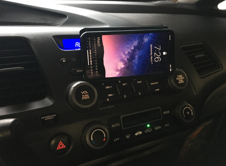

As I implied in my previous post, I gave up on caseless magnetic qi charging. I went with the iPitaka case combined with the Mophie power station mini charger. See this video. I didn't do the iPitaka charger because I don't like the aesthetics.

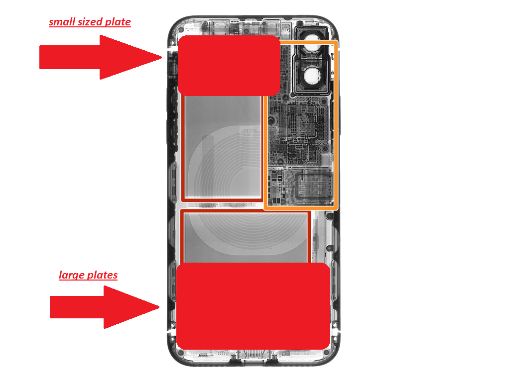

I find my TPU case with a steel plate on the back will still charge via Qi, but the plate gets extremely hot and very concerning. I stopped charging it after that.
It was hot enough to cause a burn or melt plastic.
Where is the plate located? It should be on the bottom.
Reactions: nokkynuk
That's what i figured. Its in the center of the case on the outside (not on the phone itself).

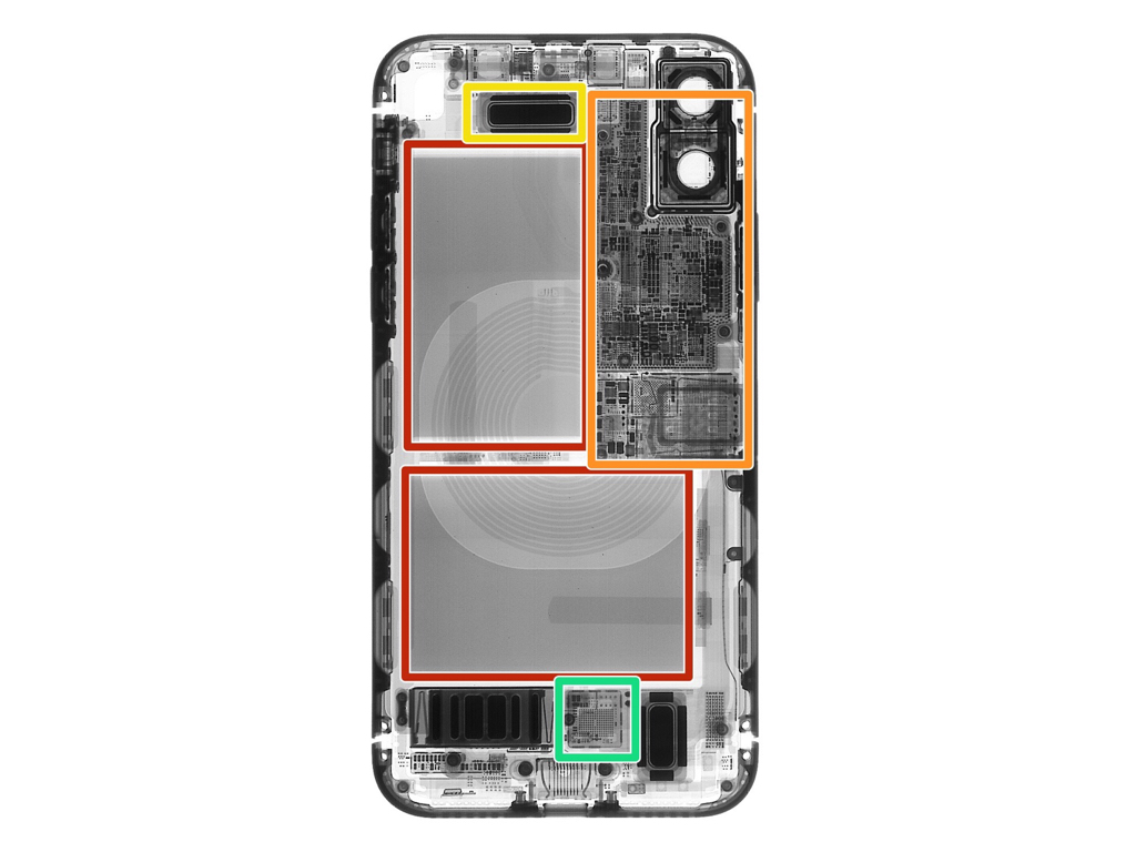

You want it below the Qi charging coil. It’s also ok to put the plate inside the case. If it’s a clear case, tape to the phone instead of the case.
Thanks for the advice! I'll try it tonight. I have several more plates i can try to strategically place around to avoid this issue.

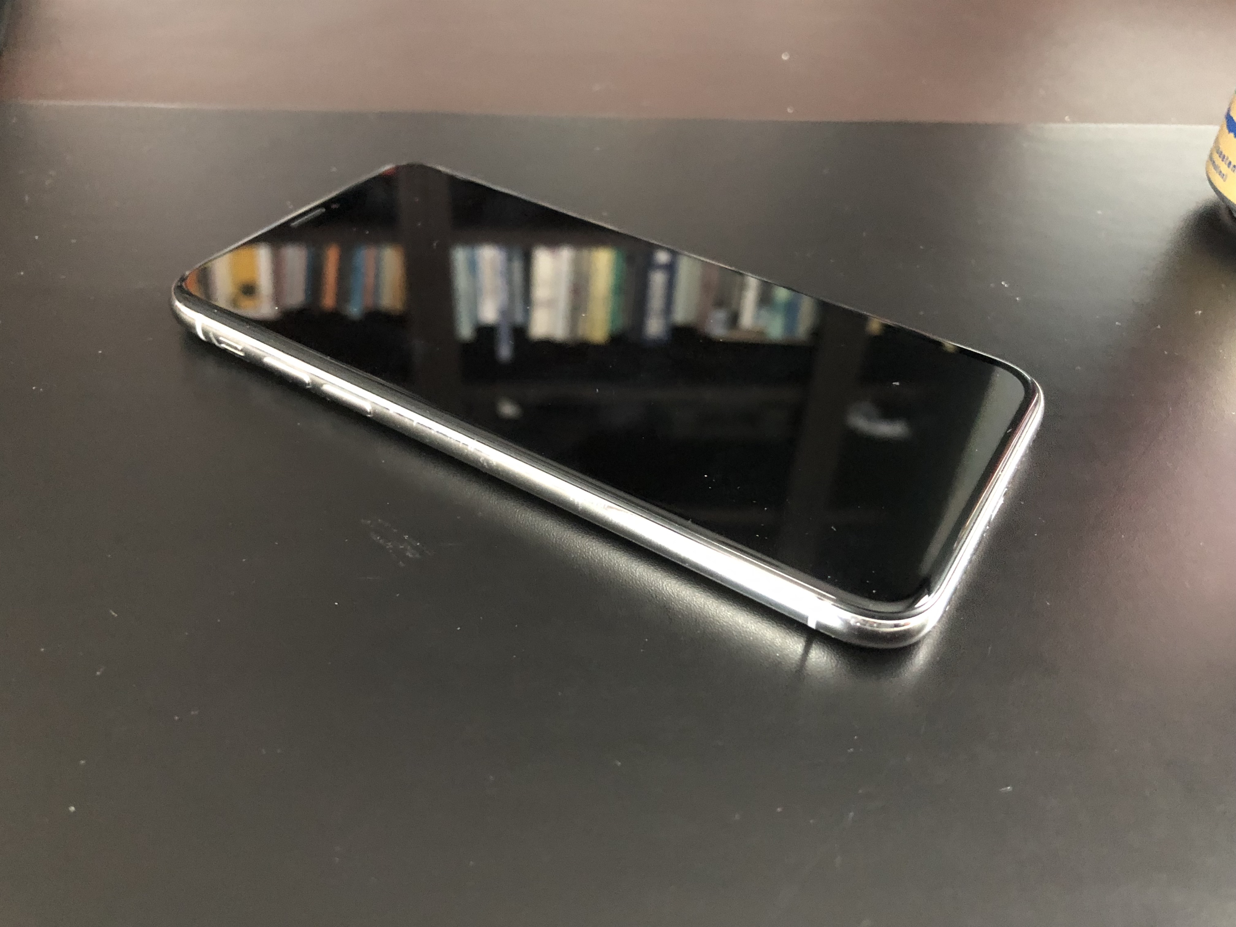

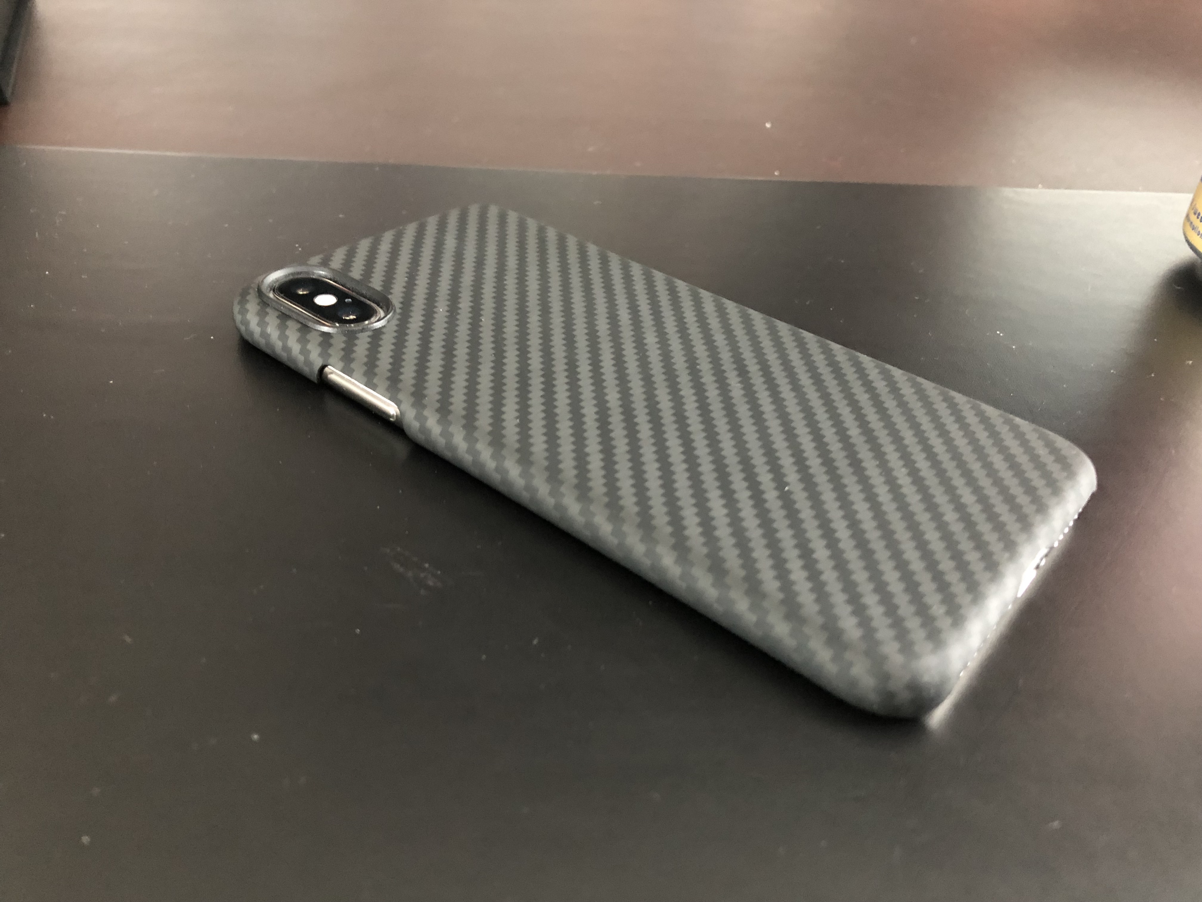

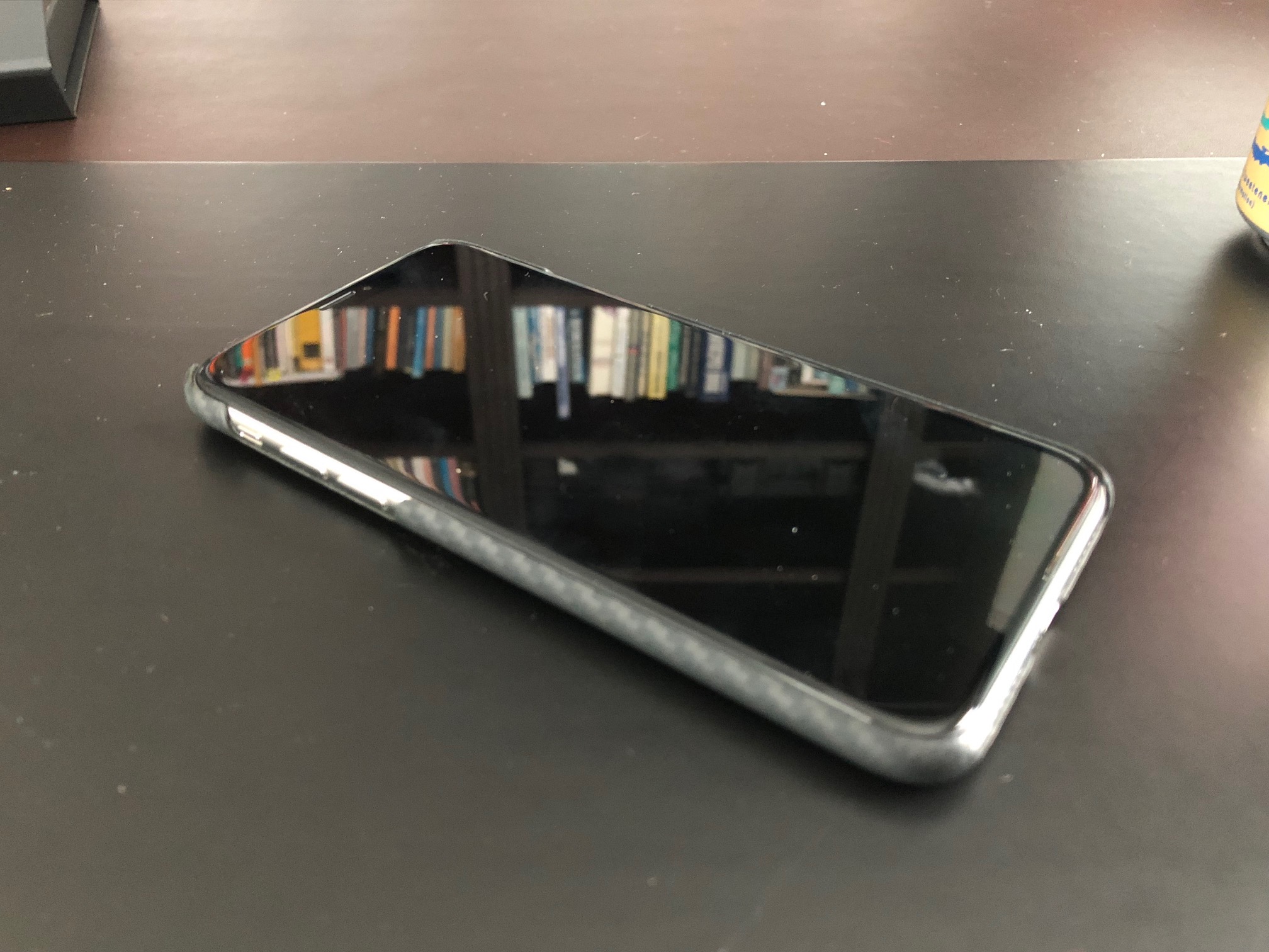

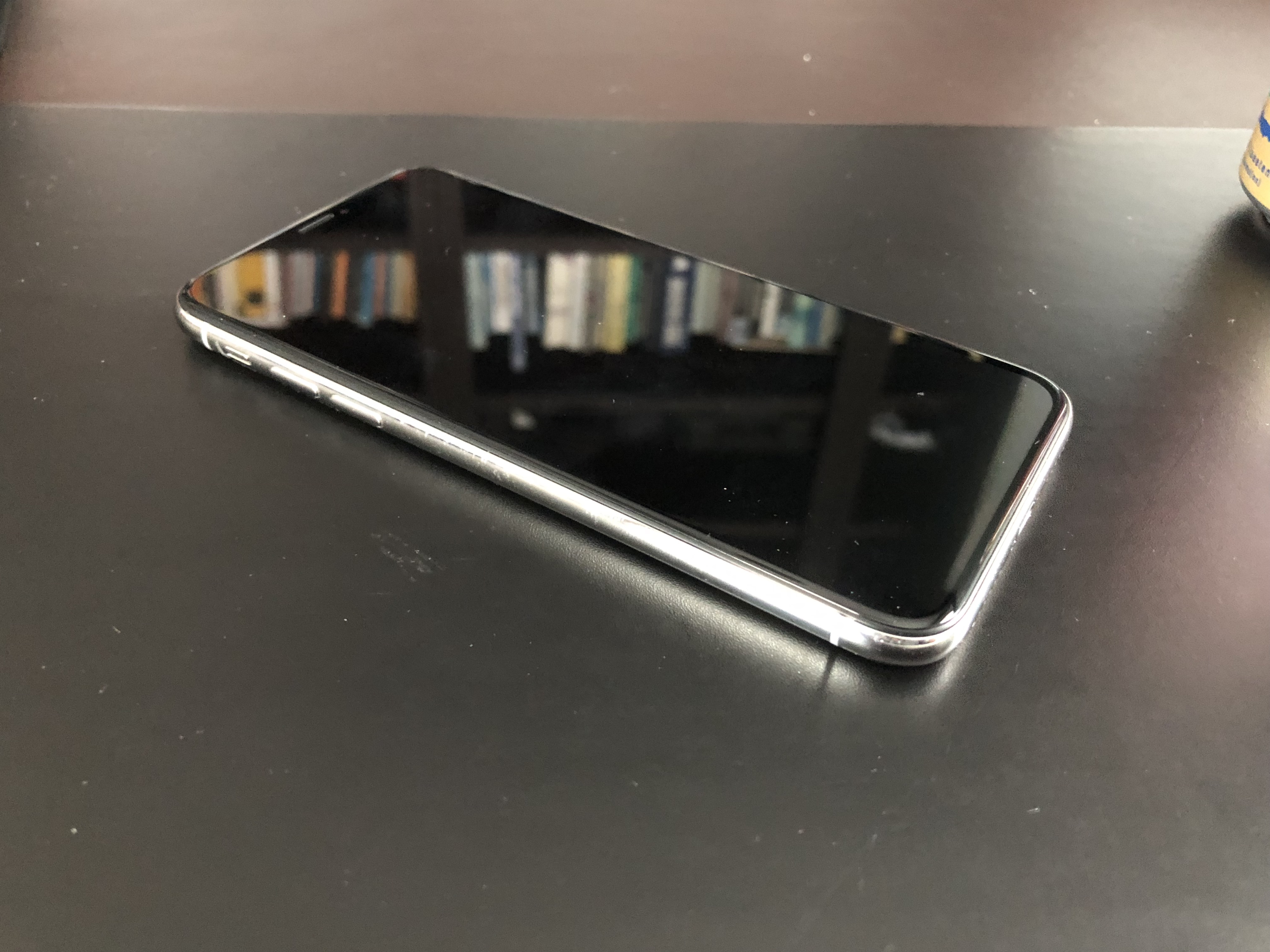

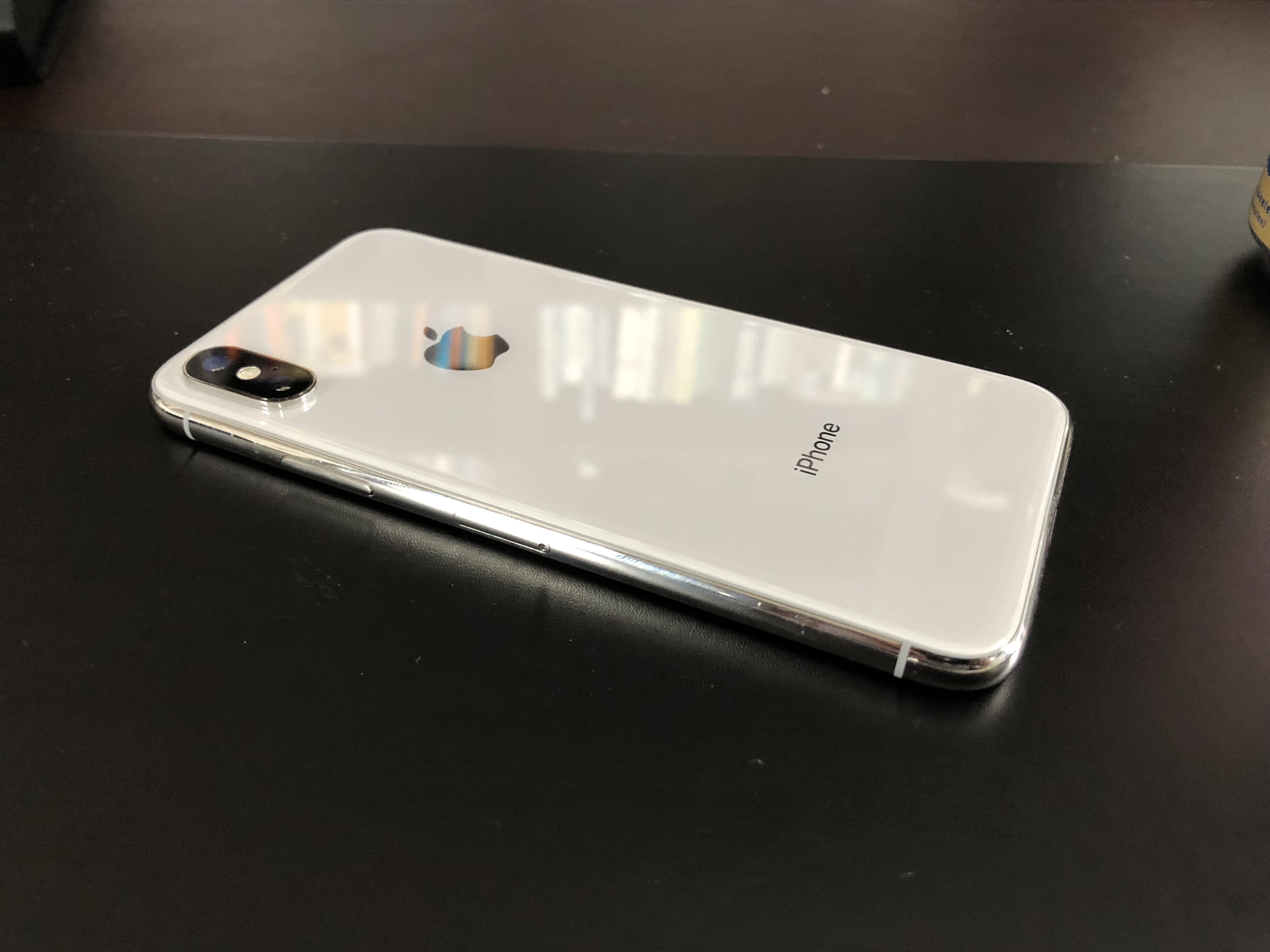

Hello Sarah

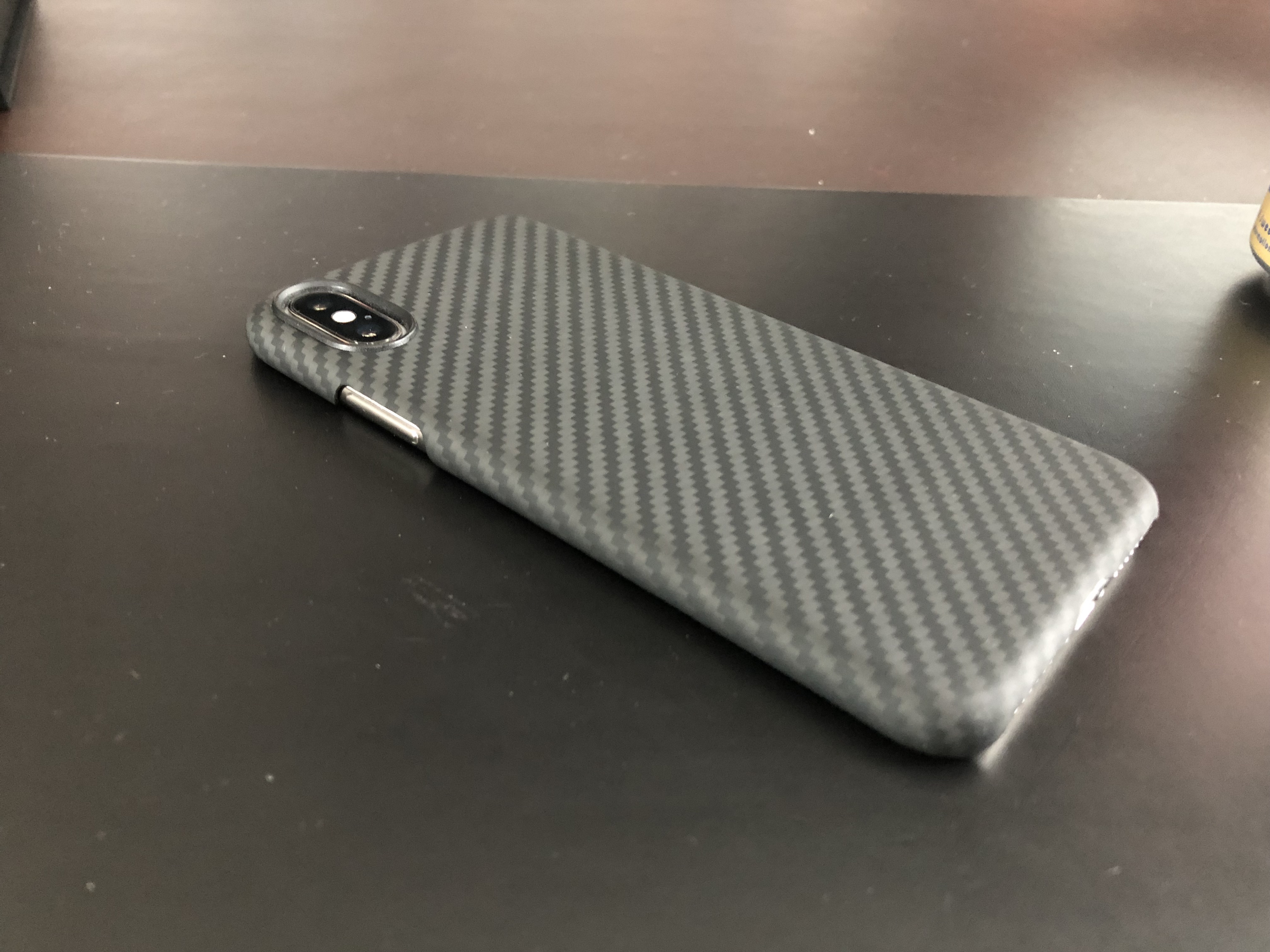

I have the iPitaka case for iPhone X. I like it from a functionality standpoint because it does support both magnetic mounting and qi charging. And I have been using it because it is the only option I found which allows me to use it on a magnetic qi dash mount.
However from an aesthetic standpoint I don't like it because it takes a beautifully designed phone and makes it ugly. If you look at these pics, for the white/silver iPhone X it completely ruins the appearance. The sides look bad because the chrome clashes with the black, and the back is completely unrecognizable.
What would be nice is if you could make a similar case with either a clear back, or a partially clear back which has white metal pieces inside or is opaque to hide the metal pieces. Also make the sides of the case chrome to match the actual iPhone.

Totally understand your point. But is a matter of the material. Aramid fiber can't be clear. And most clear cases out there are made from plastics/silicone. We got to shift our material. That will be a big change.

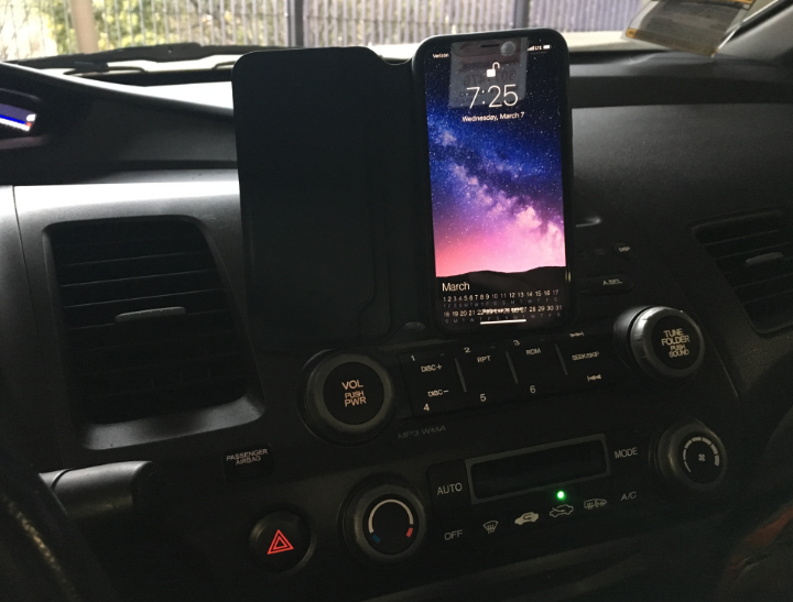

I have my plate mounted on the bottom, and it works fine with my magnetic mount in portrait, but I like to look at my maps in landscape. The magnet is not strong enough to hold the phone securely in this fashion. I am wondering if adding another plate would do it? Has anyone tried this?
Pitaka case and mount is by far the best I tried, and I tried several...

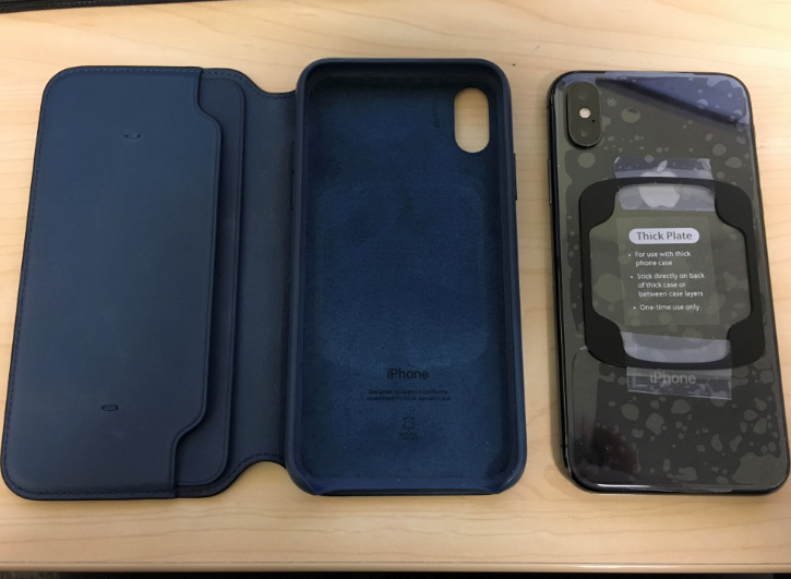

Yeah. But it’s a case that I’d prefer not to use. Not into carbon fiber and prefer to use the Apple leather folio. I ended up getting iottie magnetic plates and this ended up working for me to a degree.
Sorry for the terrible pictures but wanted to share my solution that seems to work. I just wanted to use my leather folio with my koomas magnetic cd mount. No wireless charging in car yet, but soon maybe.
I use the iottie metal plates which have a shape to not block the conductive area in the center of the phone.
Right now, I have it on the original plastic from the phone I cut down for testing purposes. Works well in both orientations and allows me to wirelessly charge on my pads at work and home. Now that I know it works, I will adhere the plate in a nicer fashion lol.
