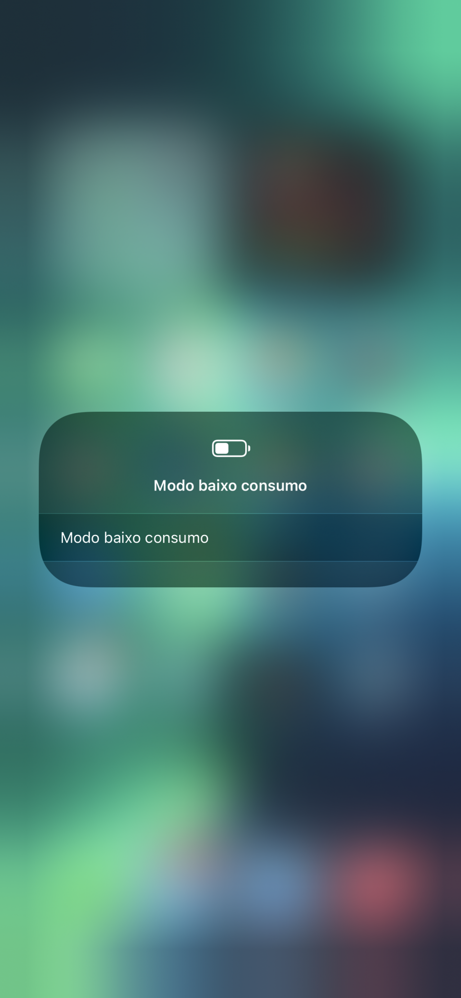

My magsafe battery has already updated to the latest version.
However, I have no option to limit the charging of the iphone to 90%.
The magsafe battery charges up to 100%.
who already has the latest version confirms that the 90% limit no longer appears in the low consumption mode icon?
Thank's

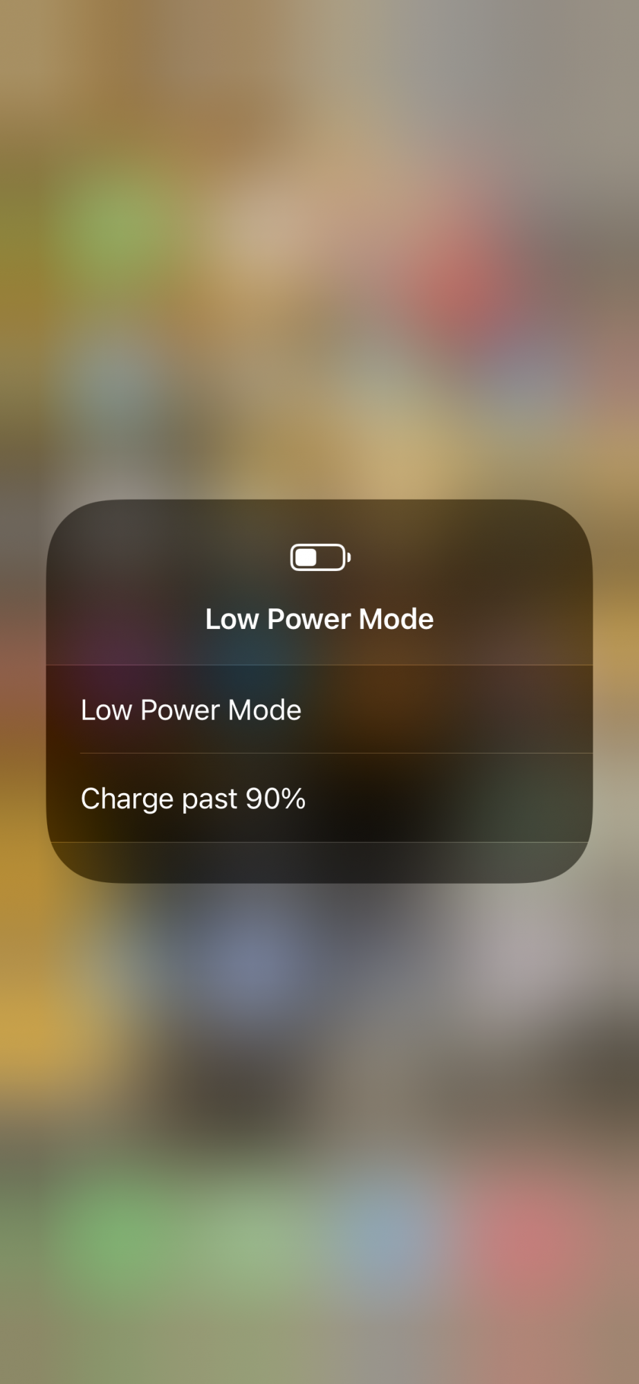

Still there.
Finally! it's so strange that the pack wasn't able to charge the phone while operating, only when it goes to sleep since 5w wasn't enough. more reasons to go back to iPhone mini..
Actually the reason it doesn't completely charge your iPhone to 100 is that it intentionally stops charging at 90% for battery health reasons. It'll continue doing this with even 7.5W charging. But you can force it to go to 100% if you go to control center, hold down the low power mode icon, and press "charge past 90%"

the option to charge after 90% does not appear in the option on my iPhone 13 pro max. always loads to 100%, with no option to limit to 90%. I've also tested with Iphone 12 pro and the same thing happens. with the battery connected to the iPhone I don't have that option. Attached photo.
