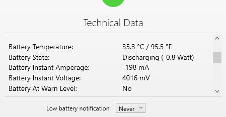

The magsafe battery with the latest firmware actually charges at 7.5W :)
Attached image with 1500mAh charging rate.
It is also possible to see that it controls the temperature quite well, when the battery reaches 36ºC, it suspends charging and starts charging again moments after it drops to 34ºC.
However, I still have no option to limit loading to 90% :( :(
Attached images. battery_magsafe_charging_7.5w.pngbattery_not_charging_hot.png

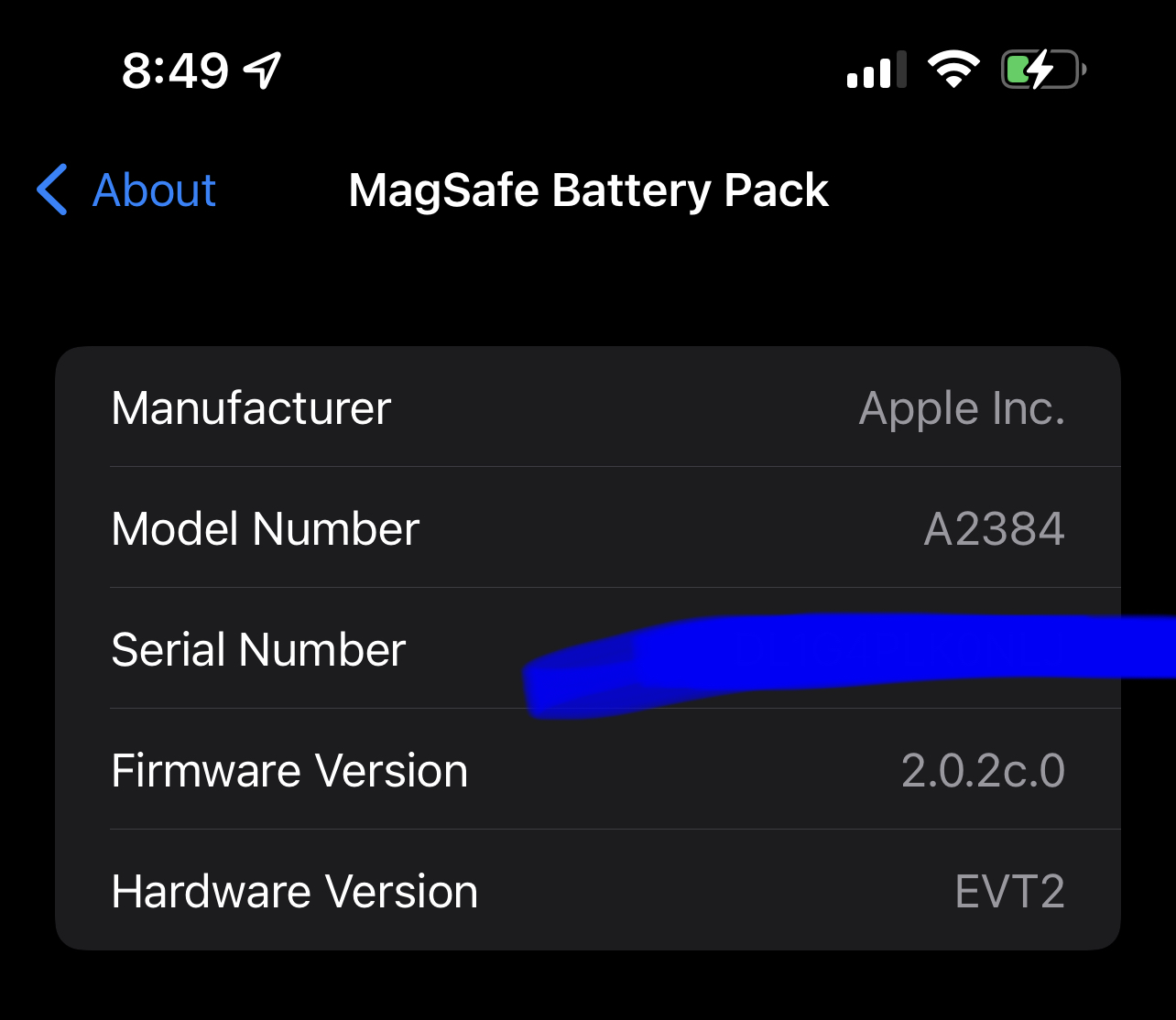

How do you check the firmware to know it’s updated? Mine arrives tomorrow as thought I could use it for those long days away

wireless charging always generates more heat than with a usb cable.
However, most of the heat is caused by the induction coils that generate heat with the transfer of energy.
The heat that stays on the back of the iphone is not the same as the heat that reaches the battery, as I have been monitoring the temperature of the battery and after the temperature reaches 35ºC, charging is interrupted momentarily until the temperature drops and it resumes automatically again.

Here is how you manually update the firmware:
All you need to do is to connect the MagSafe Battery Pack to your Mac via USB-C to Lightning cable and leave it connected for a few minutes. Make sure you are on the latest macOS, it will automatically update the firmware. (Also works with iPhone and iPad, but you won't be able to easily check for progress as on Mac.)
If you are interested, you can open the console and filter "updater", you will see a few processes in the background checking and updating the firmware for your MagSafe Battery Pack.
You can also check look for the firmware update file located at "/System/Library/AssetsV2/com_apple_MobileAsset_UARP_A2384/"
